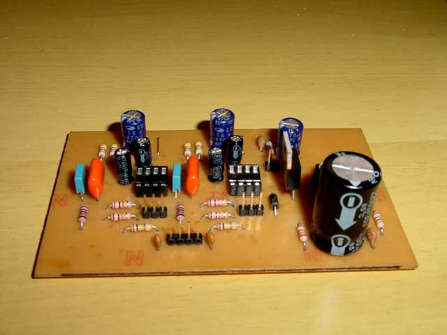

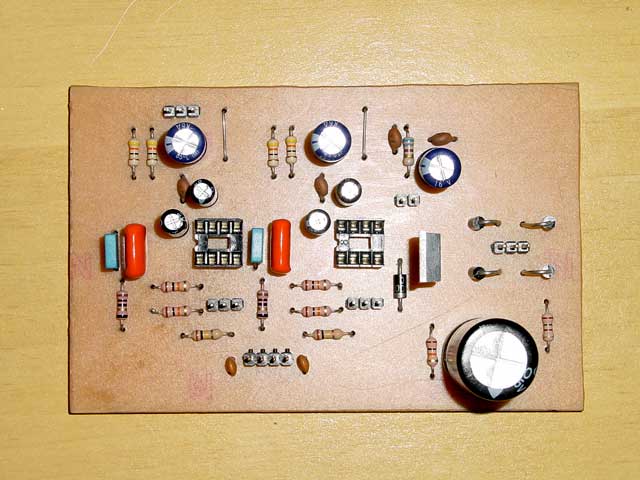

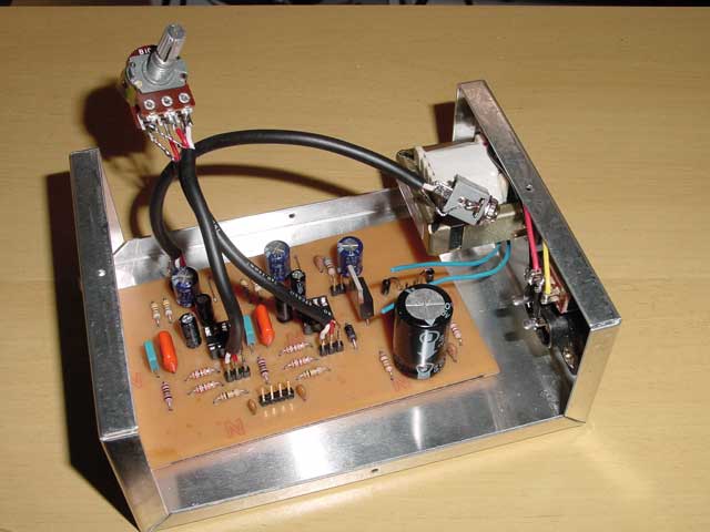

By the way, the board is up and ready to kick, now i'm finishing out the aluminium box that I've choose to be the last home of my Super Headbanger. :p

Hi Wellington,
I'm glad to see that you are using proper shielded cable to your volume controls!
That 6VA transformer looks huge! Don't drop it on your feet.
Hi audioguru!
Audioguru, i've used that shielded cable on the **broken link removed** too, they are the same type and from the same reel :lol:

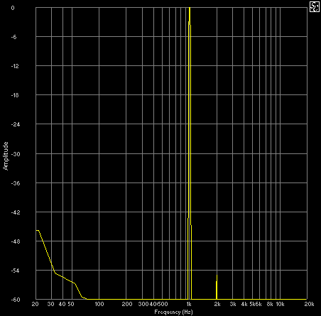

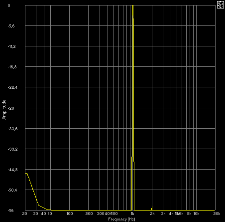

Now that the circuit is done and finished, here is the plot that you have asked:
(Tone 1 = f1) = 1001 (Hz) = 14,5 dB rms
Freq.(Hz) Harmonic Value (dB rms)
2003 (2*f1) -55,0
3047 (3*f1) -66,7
4005 (4*f1) -71,7
5125 (5*f1) -83,3
6105 (6*f1) -69,7
7074 (7*f1) -85,4
8118 (8*f1) -83,0
9076 (9*f1) -81,1
10185 (10*f1) -83,7
THD = 0,0767%
1.2V RMS
40 Ohms load

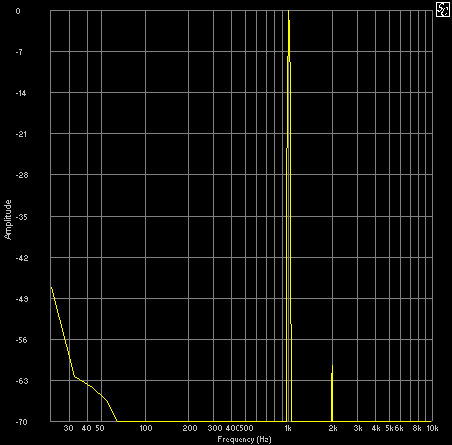

Hi Wellington,
Most numbers seem to be shifted upward by 14.5dB. The reference, Tone1 should be at 0dB and all the harmonics measured downwards from there. For example, Tone2 should read -69.5dB, which is about 0.03%. The total distortion of only 0.0767% should remain the same.
Your graph looks good, but now you are cheating and not showing how good your circuit is. Your new graph stops at -50dB at its bottom, which is about 0.3% distortion. If you change the graph's range so that it stops at -60dB, like it did before, then it will show that your circuit's distortion is less than 0.1%, which is true. If you extend the range to -70dB (0.03%), then it will barely show a tiny blip for Tone2, which is also true.
Hi audioguru!
Sorry my fault, i was not trying to cheat no one, the recording levels was all mess up (14,5 dB is too much), now with the recording level with 50% (as the program manual ask to do) this is what i've got.

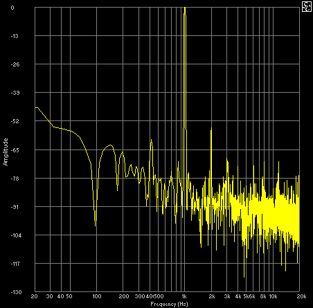

Also, here are the same plot at 0-56, 0-60 and 0-130 range.

Hi Wellington,
Tone1 is lower, but is still not at 0dB. So turn the recording level down even more.
Also make certain that the output of your circuit is still at 1.2VRMS and that it is not clipping.
Doesn't your analyser's graph have a 0dB to -70dB range?

(Tone 1 = f1) = 1001 (Hz) = 0,3 dB rms
2003 (2*f1) -62,5
3101 (3*f1) -80,3
4005 (4*f1) -74,4
5039 (5*f1) -94,1
6105 (6*f1) -76,5
7149 (7*f1) -93,7
8096 (8*f1) -92,1
9119 (9*f1) -90,4
10153 (10*f1) -91,7
THD = 0,0767%
Here is some more information that i could measure from circuit at 1.0V output, 40 ohms load.

Hi Wellington,
You have the analyser close to 0dB now. I don't know why you can't get the Tone1 reference at exactly 0dB, and I don't know why your SCpro oscillates when you try.
Your measurements show that there is no voltage drop across R7/R8 and R12/R13 so you must have measured without a load. That will also affect current consumption, but music is never "full output always" anyway, so the average current consumption will not be much more.
Your voltage measurement "before R1" is much lower than I expected because R1 does not allow C2 to charge to the peak voltage of the sine-wave, and therfore the voltage "before R1" has a lot of ripple on it and measures low. That is fine with your 12VAC transformer.
Your addition of R1 and D1 to eliminate hum is probably because the rectifiers radiate a "buzz" sound when they switch. Your nearby circuitry picks-up this radiation, but with R1 and D1 then the ground voltage also picks up this radiation equally to the rest of the circuit and the buzz cancels. Also, R1 limits the charging current of C2 which substantially reduces the peak switching current through the rectifiers. Frequenly audio circuits have capacitors of 10nF to 100nF wired across each rectifier diode to eliminate this radiation.
Your circuit is very good and has nothing wrong with it.
You did a fine job.
