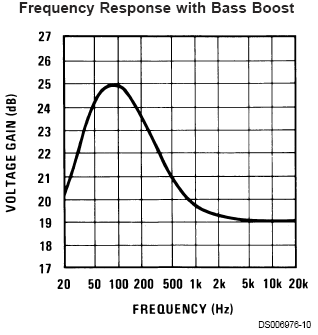

Hi Wellington,
Your circuit is very similar to the one in National Semi's datasheet for their LM386, attached here.
"Snapback" distortion is shown in a 'scope pic by the Japanese gentleman. A piece of the negative-going part of his sine-wave is missing. It makes even-harmonics distortion throughout many octaves.
All headphones are wired with only 3 wires: left, right and a common wire for both channels. A bridged amp must have the channels to be completely separate, without a common connection, so both channels in a headphone will need 4 wires.

For the frequency response to drop 3dB in an RC circuit, the formula is:
----1-----
2 pie RC
but I use almost the same:
.16
RC
So, National Semi's circuit drops 3dB from its maximum at 91Hz. Since their 10K/33nF network is still boosting a bit at 91Hz, their response at this frequency is down less than 3dB, then rolls off below it.
Your output capacitor is huge for use with its 64 ohm load, so drops 3dB at only 5.4Hz. Therefore your response doesn't have the peaking of the National Semi circuit. This is what I think your response will look like:
Hi audioguru,
Thank you for the formula :D
I have one question:
- Do you think that if I change the capacitor 33nF to 15nF, this could increase the noise or harmonic distortion some how?
Thanks :D
Hi Wellington,
Changing the 33nF capacitors to 15nF will not affect noise but will increase the distortion at very low frequencies just a little bit. The low frequency boost will sound louder since it will be shifted up about 1 octave to frequencies that you can hear better as I show here:
