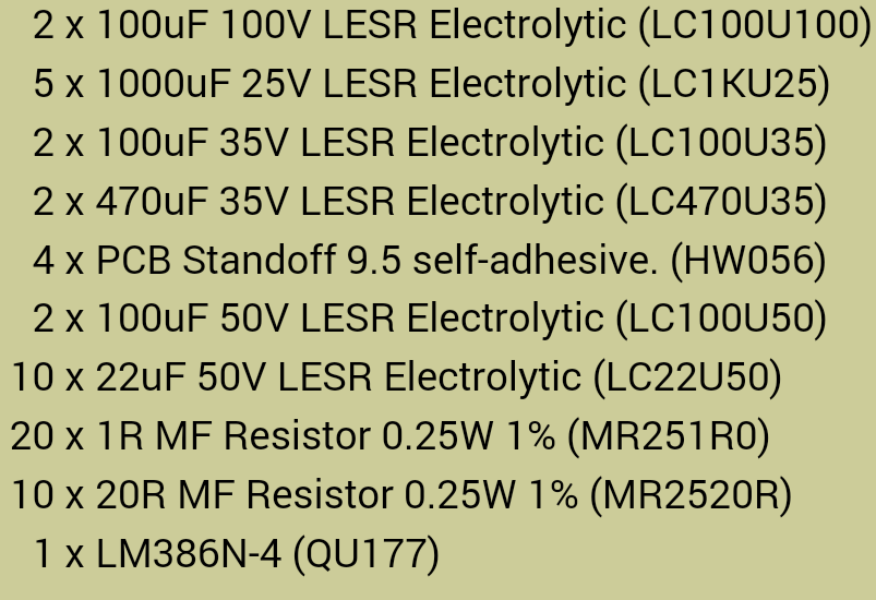

Ordered a bunch of low ESR electrolytic caps today from Bitsbox, they have some of the Panasonic ones, the rest are Nover RX series, I think, the data sheet for them shows good results, my own ESR measurements suggests that their actual ESR might be even lower than the data sheet. I expect the data sheet values are worst case ( it didn't specify )
I've still to try out the TI and ST variants of the mc34063 to see if there's any differences to that of the On Semi type that I've been using.
I also bought an LM386N-4 as I came across a design for a dcdc converter using an lm386 and schottky diodes and capacitor. Want to have a go and see how this compares with inductor based converters, I expect it won't be as efficient, we'll see!
