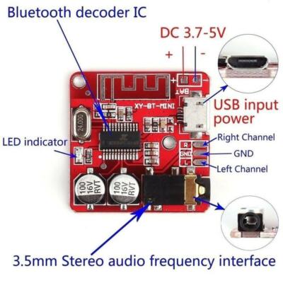

Amp will be used for videogames, connected through 3.5mm to monitor. I am trying to convert stereo amp into mono but keep the volume knob. pins going in and out of the potenciometer are marked yellow, where i want to join L and R with resistor is marked red. So i am wondering, instead of putting separate resistor on each channel, could i just use 1 to bridge L and R channel (marked with red R) ? It wont be perfect mono, but for video games .., and i at least i protect the channels a bit and get to keep the potenciometer. The potenciometer when turned all the way has 1.2 ohm.
edit: Amp will be connected only through 3.5mm jack, so bluetooth wont be used. Would it be easier to just make mono using the pins around 3.5" ? Desolder the pins and put 50 or 100 ohms on each channel ?

Just join left and right on the 3.5mm socket pins - it's so simple as not to need asking.
But then why was i instructed to put resistor on each channel in the other thread when it was about bluetooth amplifier ? Was it to protect the bluetooth receiver and it doesn't apply now since i am using 3.5mm instead of bluetooth, and using 3.5mm turns off the bluetooth receiver anyway ? See scheme

A small number of people here seem to repeatedly make such a suggestion - based on the HIGHLY unlikely idea that the source has zero output impedance, or has a standing DC voltage on it, both of which are extremely unlikely.
If you want, add resistors - it's just a waste of time and two resistors.
If you don't know the details of the output circuit supplying the audio signals, a series resistor in each channel is the prudent thing to do. As a guess, something in the 100 ohm to 1 K range. Lower than that and you might overload the output circuit. Higher than that, the signal might be attenuated a noticeable amount.

Thank you ! That is indeed good news. But now i am just paranoid enough that i cant decide what to do. Maybe i can do what i do when im unsure - just add a resistor of such a low value that it wont do any good, but will sure make me feel better. Something like 10 ohms between channels xD Usualy i added something like 30 ohms. When i tried 100 ohms i could certanly hear the difference, i am very sensitive to it, even if its just a few % SPL
Just out of curiosity and to learn something new. Is the theory behind adding a resistor the fear that when 1 channel is playing nothing and 1 channel is blasting at 100%, the signal will go from 1 channel to the other on the receiver and damage it, instead of going towards the amplifier ?
The imaginary 'fear' is that you're shorting one low impedance output to another, so if you directly couple the VERY low impedance outputs (probably much lower than 0.1 ohms?) of a stereo amplifier together, one output could go high, while the other goes low, and cause a huge amount of current to flow.
In practice, you wouldn't join the outputs of a stereo amplifier (unless you also joined the inputs). Headphone outputs, preamp outputs, bluetooth outputs, etc. are relatively high impedance, so you can join them with no issues.
But feel free to add resistors if you wish (they are your resistors to waste), if it's lowering the volume slightly, just turn it up - how would you possibly know it was quieter anyway?.

First, your question about combining left and right.
Since the amplifier of each channel of your source audio likely has some feedback circuitry to control output, you need at least as much resistance as your amplifier was designed to drive if you are supplying from your speaker wires - otherwise you'll have a dead short to two different voltage levels when the two channels are not playing the exact same audio.
If you are supplying line voltage, add a. 100 to 4,7k in series with each + output. Since most of these class D amplifiers are using JFET inputs, the current limiting of the resistor is not changing anything since no current flows into the gate of the jfet (input of the op amp). Add the resistors - it's not a waste of time if your source music is truly stereo.

And, since we don't know how these $40 $8 (updated info in post #21) Bluetooth + class D amplifier boards are well designed by famous electronics companies that want to uphold their reputation like " " (no name on the circuitboard), I'm sure they add a bunch of protection circuitry to their designs. I'm sure the $20 including shipping has more than enough margin to cover the extra board space and components.
Which is already included in any even slightly competently designed line output
But who is using that type of gear?
Most small devices such as phones and audio players - and many audio "gadget" modules - have headphone-compatible amplifiers for the audio output sockets or connectors.
Those are intended to drive relatively low impedances; they are not "Line level" audio on HiFi separates or professional gear.
And note the common "JL" bluetooth ICs such as in these do specifically have headphone amps for the outputs!
eg.
Common 24 pin JL Bluetooth IC datasheet, via a link on eevblog:
From that, a direct headphone driving application should have ten ohm series resistors in the outputs - but do the module makers bother? Not the ebay one that I can see, and I doubt it very much when they are connecting to a volume pot on an amp module!
A couple of resistors as a stereo combiner do no harm but do reduce the possibility of introducing (easily avoidable) distortion.

No, they are designed for the outputs to be shorted together if required, and headphone outputs are particularly high impedance (due to the 'nanny' state) to make them dead quiet. As I mentioned above, my CD Walkman only outputs 100mV p-p.
