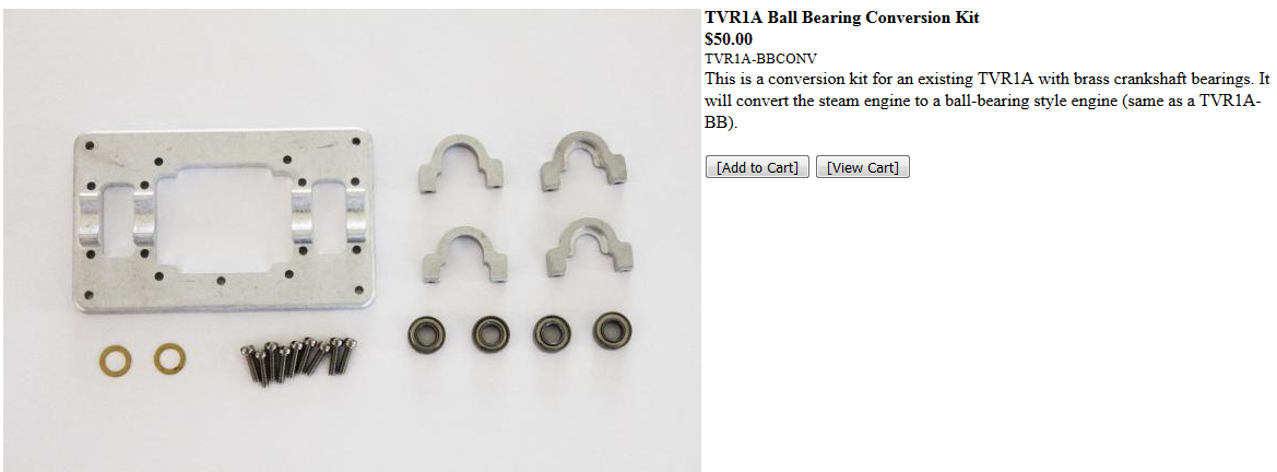

BTW, only dual (or greater) piston steam engines are self-starting: the reciprocating type need a spin-up to get going...
Well, I do have the boiler I made for it. Might as well send it also since I'll have no use for it. I was going to use Butane as the fuel. It has a pressure gauge (no idea how accurate) but no pressure regulator. I have no idea of its bursting pressure, so use at your own risk :woot: !!
This engine also has a shaft with NO ball bearings (look at the pic above of the TRV1A, above), so it has to be oiled regularly. There is, however, a ball bearing mod available:
I will say that the darn thing was a lot of fun to build and play with :happy:!
