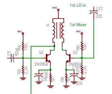

I looked in an older ARRL handbook and they listed a "40673" but I could not find it in on Datasheet catalog for integrated circuits, diodes, triacs, and other semiconductors, view
An FET would have a higher impedance. Could be prone to pick up noise. The mixer is so important and often times non-active mixers are recommended because of the gain loss. I myself like a BJT. I have had great success with common 2N3904's. Though diode rings also do very well and come highly recommended. Some 1N914's work rather nice.
I am happy to share this one I created with you. The output is taken off Q2 and the rf input goes to the base of Q2. The local osc. input is marked. You can control the gain with the emitter bypass caps. I found they should be the same value for both transistors. The transistors share a .37 inch ferrite core. I use Amidon FT-37-43 It works very well for me. You might want to try it.

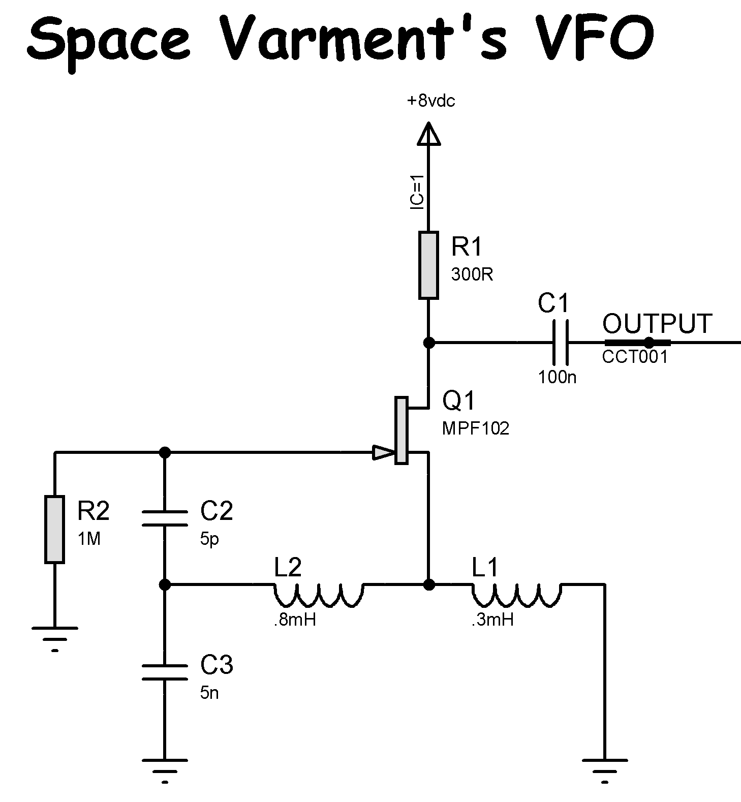

I think you said you don't have a signal generator. You could use this VFO for one. It has a very wide range and is quite stable, runs very cool. You could use just wire for the coil. I have made some with a thicker gauge, say around 26 and wound on a round pill bottle. Then rub some Elmer's glue on it and let it dry, then slide it off. The tap should be about one third from hot side of coil for maximum range. Just something to give you a head start. You can use any small signal JFET. I used a 2n5486. This circuit is very universal and will work well as your main tune and BFO and or 2nd local oscillator.

SV, what reactance am I looking for for L1?
or the FET source impedance range.
I need something to get me started choosing components for the tuned circuit.

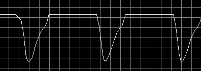

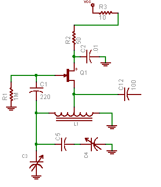

Playing around with SV's VFO, what I have so far.
The two caps under L1 & L2 only provided parasitics.
They did not affect the wanted frequency. Since a buffer would be used after the osc. R1 can be much higher in value than 60 ohms (50+10) for a greater swing.
This should also allow a smaller coupling cap to the buffer.
For the buffer I'm thinking of another FET (for now).
I've played with all the components and the frequency, wave shape and gain (except R1) are almost completely dependent on L1 & L2. Putting caps across either one or both only causes problems. A small C2 works best and only 1M works for R2.
The wave shape is terrible! I can't manage to improve the upper part of it. It remains flat no matter what I've tried. What I guess is needed is better DC biasing of the FET. I have done no designing of FET amp or osc. circuits.

Well, although I've no confidence that anything SV throws together would be any good, and I've not tried this circuit, you appear to have changed it considerably from the circuit he showed.
L1 and L2 aren't separate coils, they are a single tapped coil, and the circuit operation is heavily dependent on that - also you have added a resistor in the drain, and taken the output off there, rather than the source, and a 5pF looks way too small for the capacitor feeding the gate.
I've no idea what configuration it's supposed to be, it looks like a combination of a number of different configurations (half Hartley and half Colpitts perhaps?) - don't really see why he didn't just use one of the number of existing correctly designed VFO configurations?.
Personally I've always been fond of the Colpitts design, as you don't need a tapped coil.

Your right, Nigel, it is so different than what he suggested that I can not call it SV's VFO.
I will try his circuit again if I can get Proteus to give me a tapped inductor. I did not find one so used two iductors in series.
Why is that illegal? Something to do with mutual inductance?
I did not notice my mistake about not bypassing the drain and taking the signal from the source. Very sloppy!
The 5pf worked well. Tried many values. 3pf did not work.
100pf or 50pf did not work better.

A tapped inductor is a transformer, two inductors in series isn't a transformer.
It's the fact it's a transformer that makes a Hartley type oscillator work.

As you don't have a transformer in the circuit it's operation will be fairly random, I doubt it will have much simularity to real life either.
I will try his circuit again if I can get Proteus to give me a tapped inductor...
...The 5pf worked well. Tried many values.
Hold on a minute, what worked well?
Reality check here, this is not radio it is a computer game!
Dump the simulator, get the soldering iron and some real components, connect them up on a breadboard* and try it for real.
* Before the pack howls, I dont mean one of those things where components can be plugged in, although they are very useful in some areas, a mean a sheet of plain copper clad board.
Try some "ugly construction" or "Manhatten", very effective for RF prototyping.
For a tapped inductor you need to specify some mutal capacitance between the two inductors, not sure what the coupling factor would be. I don't know how closely it will follow a real world inductor either. I've never had much luck inductor simulation in Spice.
