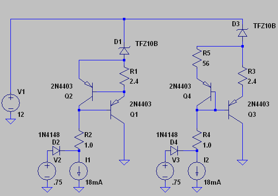

R-led; LEDs are not like resistors at all. They are Zener diodes.
Resistor; When the current is cut in half the voltage drop is also 1/2.
LED; A 2:1 change in current results in about 5% change in voltage. (depends on part)
ccr_2pnp_schematic-png.98307
R2 reduces heat in Q1. Good but reduces the ability to pull down if the voltage is low.
R1 reduces the ability to pull down when the voltage is low.
DC(0.018) current source. In LT-Spice the current sources will pull negative. This fooled me at first. The voltage between the current source and R1 when to -2 volts. This is not real life. It make the circuit look like it would work at lower power supply voltage. Watch out!

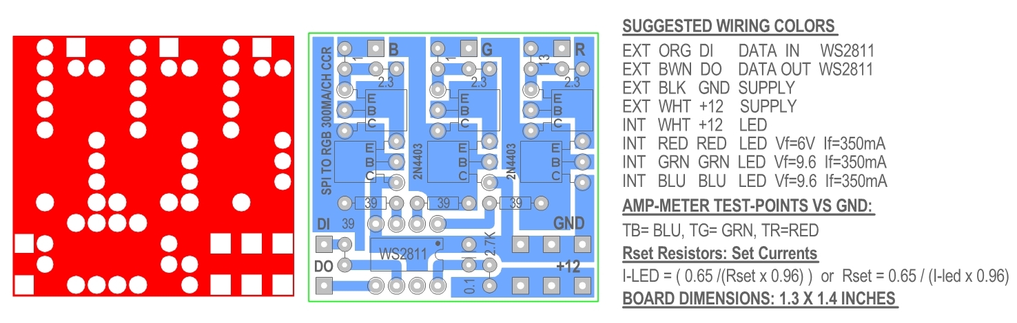

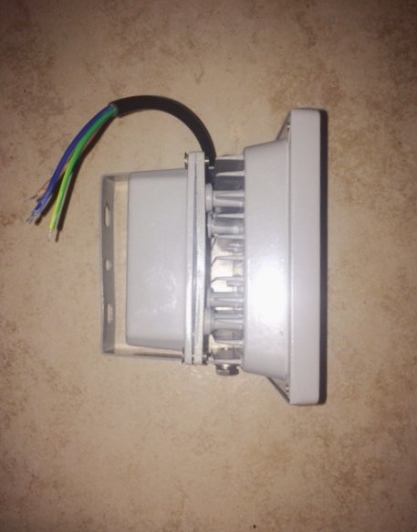

As for R2. I can lower it a bit so Pq1 is around 500mw. But I am using T0-92 package at 625mw max for the purpose of keeping the dimension of the board small. I know I can go to T0-220 package and change to PMOS but then again I was trying to avoid large PCB pads or use of bulky heat-sink.
See the picture on my post below. There is not that much room in those aluminum cans.

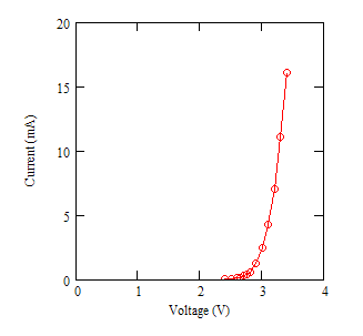

Here is something I put together on Excel for different led colors. Hope you find it useful.
I know LED vary from one manufacturer to the next, specs of LED, and even bin to bin. But this is a good approx. based on the data points I collected and formulated into:
If= A * (B^Vf)
Ron
I thought about your comment on Vdd. When you consider Grn/Blu require roughly 9.6V for Vf, and you need 1.4V overhead (Vbe1+Vbe2), you have already used up 11V for full brightness with 1V wiggle room.
You call it a bad thing to have such tight voltages, I actually like it since it has less power loss in heat. Not a big deal if the Vdd drops a bit, the LED will be slightly less than 100% brightness. If it really bothers you, we can change Rs to increase the current to compensate (we have the gap between 300 and 350ma to play with). Once Vdd is set, I am not concerned with voltages since constant current sinking of WS2811 will take over setting currents thru use of PWM. If you expect both transistors to saturate instantly (Vdd=low volts) and level off at saturation at Vdd=6-7 V, it will not happen. This is not a constant current to be utilized for all voltage ranges although can be modified to do so. It is specifically designed for 12V supply with 300ma LED. Function of the two transistors are to keep the currents in check in case LED decides to heat up while WS will do its thing.

Left circuit; current is 18mA + (B-E voltage across a resistor) The B-E voltage changes with temperature. Q1 will run very hot. Inside the box all parts will be hot.
Right circuit; 18mA causes voltage across R5, The same voltage is across R3. Current = IR5 + IR3. The B-E voltage has little effect.
In both circuits the base current causes some errors in the formula.
Voltage Base to Emitter of Q3 will be 5% larger than Q4 because the currents are not the same.
Again, don't make changes. Just something to think about.

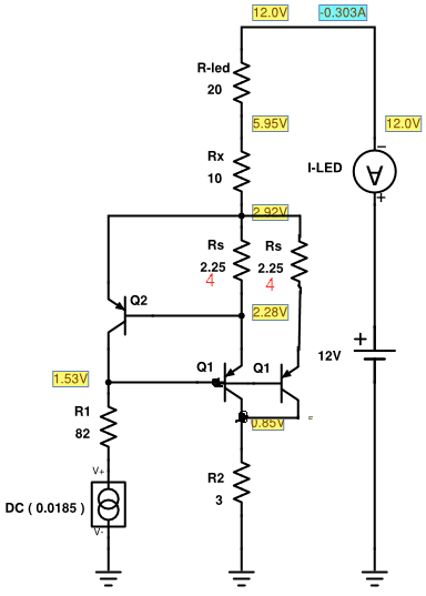

Please help me understand what you are trying to do. Looking at the left diagram: Ie2= 12ma while Vbe2 is fixed at 0.65. This equilibrium is achieved when Q1 gives Q2 a negative feedback. Q2 will run cold since it only uses about 7-8mw. Let's say its Vbe rise a bit due to temp. That increases Ie1, increasing Ib1. This pulls up the base of Q2 and decreases the flow of Ie thru Q2! To complete the cycle, Ie2 reduces, Vbe2 decreases, Current thru Rs (Ie1) reduces, Ib1 reduces, Vb2 reduces, Ie2 goes up. This is why Q2 (setting transistor) does not reach saturation while Q1 (load transistor) does. Here are some numbers my spreadsheet produced when I ran the layout and cross checked against datasheet of 2n4403:
Vbe2=0.65(turn on voltage), Vbe1=0.75(saturation), Ib2=1-1.2ma (turn on current), Ib1=7.5ma. Since IR2=18.5ma and Ib1=7.5ma then Ic2=11ma, Ie2=11+1=12ma, hfe=100 @ 10ma, hfe=40 @300ma. We know Ib=Ie/hfe. Therefore Ib1= 288/40=7.5, I thought Ib2=12/100 but the graph on datasheet of 2n4403 says turn on Ib=1+ma. Current sunk by WS=18.5=Ic2+Ib1 (not Ie1)
PQ2=0.65vx12ma=8mw, PQ1=1.45vx288ma=418mw (these are based on my updated schematics reloaded at original post).
If I am missing something please try to explain it another way as I am open to suggestions. I am concerned a bit, if running IQ1 somewhere around 500ma it might heat it up horribly since it does not have a heat sink. That I have to physically build and test out. I might have to switch to darlington or PMOS after my testing.

I don't see that darlington or PMOS will help. You have voltage and current that makes heat. It is more a function of getting the heat out of the part and into air then to the box.
If the output transistor is too hot think about this. Using two Rs will cause the current to share well. ( Rs= 4.1 ohm ) So Q1a and Q1b will have about the same current.
I know Q2 is only watching the current in one transistor.

I have always read in engineering discussions not to parallel transistors even if they are perfectly match as one could easily take the whole load
That is why there are two emitter resistors. (with out resistors they will not share well) With two resistors they will share. If one transistor takes too much current its B-E voltage will drop. The transistor with little current will have more B-E voltage. It will balance out. Because you have 0.7V on the emitter resistors they should balance well.

Here is an updated pcb based on my last post. Traces thickened on Bottom side, pads added to bottom side, transistors are bent 90 degrees to touch the board, and the entire top copper can now be used as a heat-sink with heat-paste.

Several ideas.
a) Connect RED to ground. Remove all BLUE grounds. (feed throughs on ground leads) With the blue ground removed there is more room for heat sink on the blue side.
b) If SMD then all traces and parts can be on blue. Red can connect to the box with goop. The box is a real good way to dump heat.

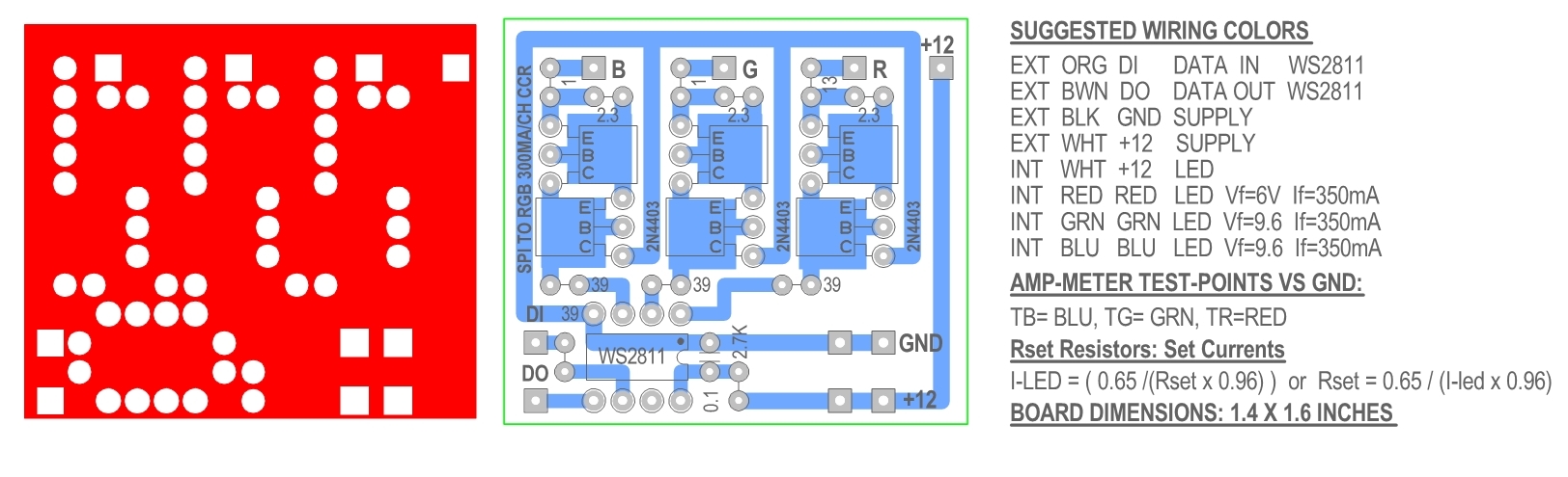

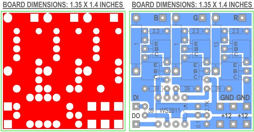

I took your suggestions and took it a bit further. See attached PCB. The 39 ohm resistors are now flat and all grounds fed from bottom.This actually reduced the size a bit! Cheers.

I don't know your CAD program.
In Eagle there are reg and blue traces. The green pads indicate both sides.
In your pictures there are no pads in the red layer.
Are you planning on using a double sided with no "via"s? VIAs are strong and keep the pads from lifting.
Maybe you want red pads but the software is still thinking in 1 layer mode.
Good Morning. I am using double-sided board. My software is PCBArtist. Great for such projects but its output is not standard Gerber. I use it for at-home projects.
This software is very user friendly and allows me to set colors for anything I want. In this case Grey is pad on both sides. As for top copper (red) when I poured it, I intentionally removed spokes. So it is a free floating plane. The advantage is that I do not have to worry about parts shorting on top and the whole thing is one copper pour for a great heat sink. I think this last version below does everything I want and provides for copper pours on top and bottom so all parts stay cool. A drop of heat paste under each transistor and power resistor on top. If I put rubber pads or mica under each corner for isolation, I can place heat paste under the whole board to casing and hot glue the corner to stay in place. So it will be air cooled from top (red) and case cooled from bottom. I am liking this more and more.
P.S.: on my pc, all the layers are on top of each other. For your viewing i separated red on top so that you can see below it.
