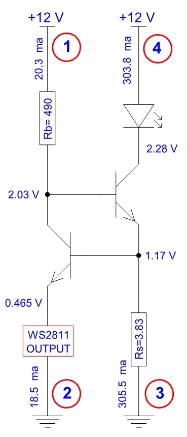

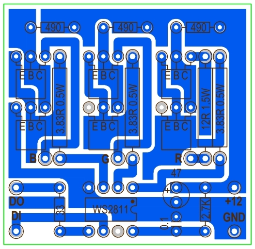

If you draw an imaginary vertical line in the middle of circuit, looking at the left side you have 21ma coming in, less transistors base currents going out and in (net 2.5ma), you get 18.5ma going out thru WS. On the right side you have 300ma led current coming in plus net base currents (2.5ma) going out. This current of 302.5ma is set by Rs, the resistor at the bottom right hand corner. The top left corner current of 21ma is set by ((12-Vbe1-Vbe2-Vws)/Rb. For red led I added a resistor in series with the led to pickup the slack between 9.6v and 6v Vf differences. This resistor is not necessary for constant current but is used to lower the transistor power dissipation. In a sense making red, green, and blue behave similarly in the circuit. Pd of load transistors are less than 300mw!
If Led gets hot and wants to misbehave, or if we allow for manufacturing variances of Led's Vf of 10% (1v), the current remains constant within a few ma from 11v and 13v supply voltage. In another words if Vf fluctuates by 1v +/- , I-f will vary only by about 3ma up or down (1%).

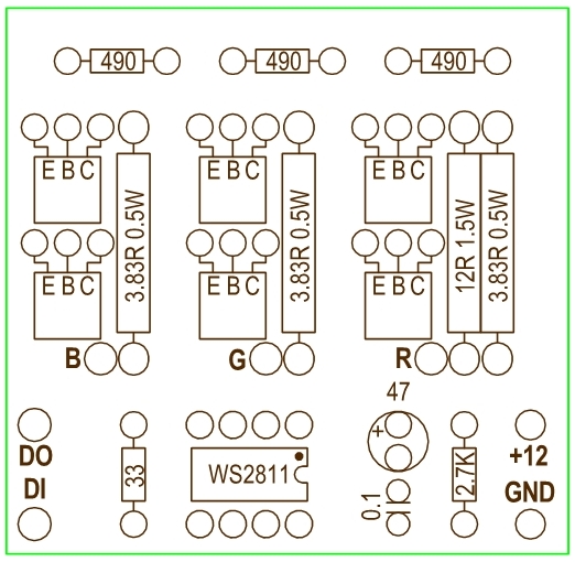

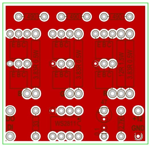

Here is the updated design. Entire top copper is a ground plane acting as a heat-sink for all the components thermally touching it, without a need for any external heat-sinks. Maximum power dissipation of load transistor is about 337mw allowing room for operating temperature above 25 degree Celsius. Components are selected as such to reflect availability of parts in real-life. Additionally an electrolytic capacitor is added to the supply voltage (Vcc) to filter any unwanted voltage spikes.
Parts recommendation: For the most part common components can be used in the circuit. It is recommended to use transistors that have a power rating of 625mw and higher (with no heat-sinks required) with Vbe(on)=0.65, Vbe(sat)=0.75. Rs is set at 3.83 Ohms 1/2 W with 1% tolerance preferred. Rb is a standard resistor with tolerance of 1-5% with power rating of 1/8w or higher.
System Tolerances:
Rb (Base Resistor) tolerance of 5% is sufficient and fluctuation in its value changes the LED current by 1ma up or down. With a resistor tolerance of 1%, the changes to the LED current is insignificant.
Rs (Setting Resistor) tolerance of 5% causes the LED current to fluctuate by 15ma (5%). While tolerance of 1% (recommended) changes the LED current by 3ma (1%).
Vf (LED Voltage) tolerance of 10% causes the LED current to change by 3ma (1%). This applies to manufacturing tolerances as well as when LED heats up during long operation.
Vcc (Supply Voltage) changes of 15% causes the LED current to fluctuate between 278ma and 307ma. While 10% change in Vcc sets the LED current between 295ma to 304ma. As the supply voltage increases, the LED current changes by 1ma for every 1v above 12V supply. LED turns on at about 3.3v for Vcc (roughly LED Voltage of 1.8v) and ramps up exponentially until Vcc reaches 11V at which the LED current is about 300ma. From this point on the LED current is almost a flat-line with very little changes with increased Vcc as expected for a constant current device.
Changes in WS2811 voltage drop during ON time at 100% duty cycle: In this circuit Vdrop is assumed to be 0.465v. If this voltage is increased to 0.7v then it will reduce the LED current by only 7ma (2.4%) assuming constant current sink of WS2811 is maxed out at 18.5ma. Otherwise changes in LED current is insignificant.

First set of testing did not have good results. I could not get an accurate voltage drop on WS output using multimeter since it does PWM. But I did run it for long enough to notice the lowest level was about 0.4v. The simulation model was not a good representation of outcome of actual test. I was able to achieve proper bias voltage and current to led at 300ma, 9.5v, but could not get the constant current engaged as the closer I got to control the current the more the feedback forced the led into flickering and eventually to a rhythmic flashing like an oscillator would do. So not much of improvement over having a simple series resistor at this time. I will run some more physical trial and error to see if I can achieve the constant current.
Success at last. A simple solution.

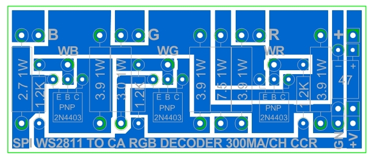

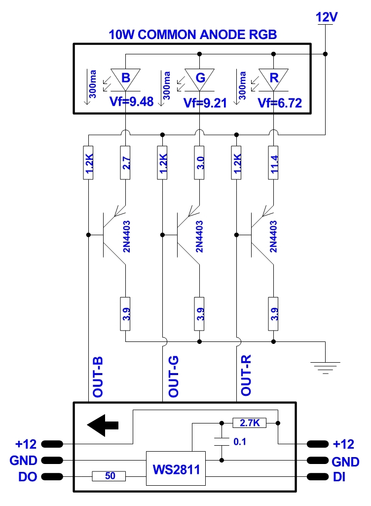

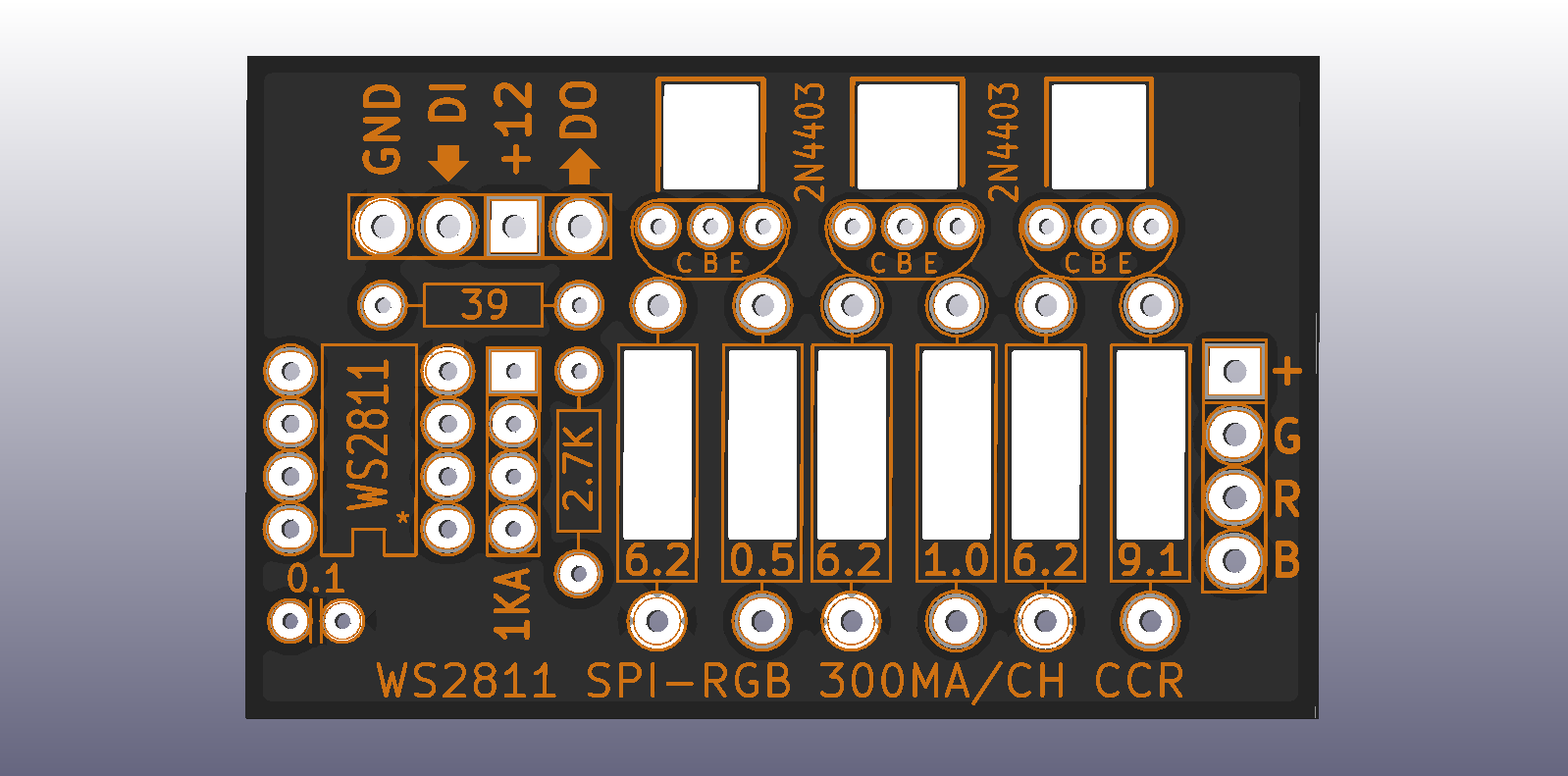

Here are the final Schematics and PCB Layout. Board size 1 inch x 2.45 inch.

Based on real-life measurements the average sinking current of WS2811 is around 16.5ma (not 18.5 as indicated in the datasheet). In an outside circuit with series resistor value of 610 ohms allowing 20ma, voltage drop of WS2811 to ground was measured at 0.62v with Iws=16.5ma.
In the main circuit approximate average hfe=Ic/Ib=50, Ie/Ib=49 with Vbe=0.7
Rc=6.2 ohm 2W, Rb=1k 1/4W, Re(r)=9.1 ohm 2W, Re(g)=1 ohm 1/4W, Re(b)=1 ohm 1/4W. The selected resistors are more common resistors which are readily available.
There are a few simple relationships that hold true in this circuit. One can modify resistors as long as certain balance is maintained.
1- Ib=Ie/(1+hfe) (set LED current and then calculate Ib, Ie=I-led)
2- Ic=Ie-Ib
3- Iws=16.5=Irb+Ib (with Ie=300ma, Ib=6ma and Irb=10.5ma)
4- Vrb=Vbe+Vre+Vf (note that this relationship is independent of Vcc, for Vbe at or near saturation =0.7)
5- Vb(min)=0.65
6- For the batch of 10W Common Anode RGB used, average Vf for red, grn, blu were 6.85, 9.3, 9.54 respectively at their individually set I-led (305,293,289).
7- Vce needs to be at or above 0.3v and preferably below 1.4v to keep the transistors from overheating. (TO-92 Package)
8- With Vb-min at 0.65 and Vbe of 0.7 then Ve>=1.35 and Vc>=0.95. To tailor the circuit to your specific currents, decide on individual LED currents for color balancing near 300ma, pick a starting voltage for Vb above 0.65 volts, calculate individual Ib=Ie/50 and Irb=16.5-Ib, set Ve=Vb+0.7, Vc=Ve-0.4, and then calculate resistors (Rb, Rc, Re) based on Vb, Ve, Vc, Irb, Ie, Ic. Side note: With everything biased and fixed, Vce changes with WS2811 current sink (0-16.5ma).
9- Once bias has been achieved Vcc cannot be increased more than 1v or transistors will overheat and will be destroyed for long exposure to this voltage. Vcc can range between 11.8 to 12.6v (Ideal Vcc is about 12.2v). The beauty of this circuit is that it is a constant current and constant voltage. If Vf increases due to overheating, Vrb is increased, Irb is increased and the transistor's Ib is pinched to maintain 16.5ma for Iws. This causes the LED current and voltage to drop, keeping the LED at a constant current. Similarly small drop in Vf causes the reverse effect, increasing LED current to compensate. The circuit will maintain a constant current for Vcc between 11.6 and 13v. For long run of wires between pixels, It is recommended that Vcc is set between 12.2v to 12.6V to avoid noticeable dimming of pixels since voltage drop of 30 feet run of wiring is about 0.6v).
10- LED currents were intentionally selected as such to produce a slightly warmer white with good color mixing for yellow, Magenta, and Aqua-Teal. Power Diss. of Transistors are less than 250mw with no need for any heat-sinks as long as Vce is kept in check (<1.5v).
2N4403: TO-92, Vbe(on)=0.6, Vbe(sat)=0.7, Vce(on)=0.3, Vce(sat)=0.6, Ic(max)=600ma, Pd(max)=625mw
Op-amp, NPN, Voltage reference and Resistor below it represent the constant current sinking of WS2811. With a simple modification this circuit can be used as a dumb constant current driver for high power RGB. Remove WS2811 from the circuit and replace it with a Quad op-amp with a simple voltage divider to produce individual voltage references for the op-amps.
Added resistors to achieve the appropriate bias increases power consumption by only 3.4%. This extra power consumption is mostly compensated by running the LED's at their optimum currents below their maximum ratings, increasing life of LED's. Total circuit current consumption including WS2811 overhead is about 1A per RGB pixel which translates to an approximately 12W in power consumption per pixel. The pcb board is small enough to easily fit inside the metal casing of power LED (1-inch x 2.25-inch). Total part cost including pcb is about $1.50 which meets the original set requirements of this post. The ultimate goal of this project is to utilize a low cost interface to convert a "Dumb" 10W RGB Pixel into an "Intelligent" Pixel while providing the Pixel with a constant current. This allows the user to control a large number of High Power pixels by setting individual brightness and colors, utilizing some of the more common SPI and PC based controllers available on the market.
