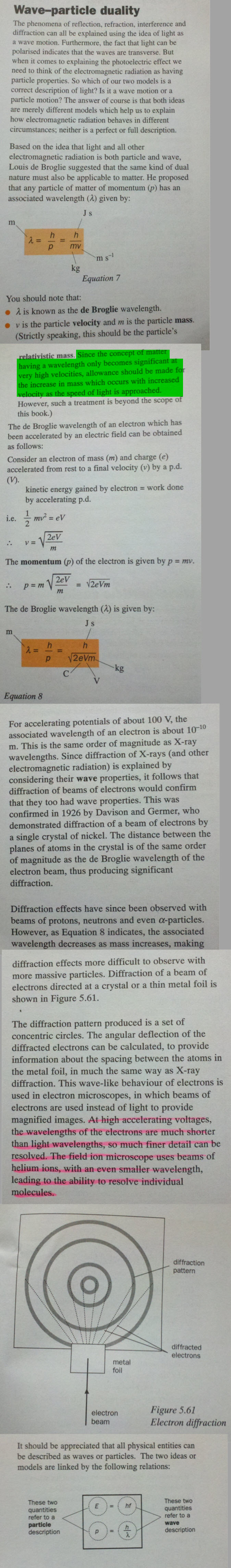

I think a small discussion about wave-particle duality is in order here. I will be using this text. The wavelength for a particle of matter of momentum, p, is given as:
[LATEX]\lambda =\frac{h}{p}=\frac{h}{mv}[/LATEX]
The de Broglie wavelength is inversely proportional to both mass and velocity of the particle. The value of Planck's constant is 6.63 x 10^-34 Js or J/Hz. Also note that relativistic mass is given as:
[LATEX]m=\frac{m_{o}}{\sqrt{1-\frac{v^{2}}{c^{2}}}}[/LATEX]
Q2:
A moving stone will have a very, very tiny wavelength. As the wavelength is inversely proportional to both mass and velocity, therefore decreasing any of these quantities will make wavelength longer and more easily observable, right? But the document says that the concept of matter having a wavelength only becomes significant at very high velocities, why is so? Why isn't it significant at lower velocities? This means that though one can reduce the mass to make the wavelength more observable, reducing the velocity won't help at all.
This begs another question that will increasing the velocity help in any way? It's obvious that the wavelength will become smaller if the velocity is increases. At this point, it should also be noted that relativistic mass becomes greater as velocity is increased.
Q3: Everywhere the de Broglie wavelength of matter particles is discussed, no one ever talks about amplitude or period of the particles. I think these two parameters are equally important. For example, when amplitude is very, very small then wave motion won't be easily apparent.
Q4:
In diffraction experiments such as the famous Young's double-slit experiment, the size of the slit shouldn't be much larger than the size of the wavelength of light under observation. If the size of slit is larger then interference pattern won't be sharp and only a few fringes are formed. If we are to perform diffraction experiment on electrons then should the size of the slit (I think in this case some crystal will work as a diffraction grating and distance between the molecules will determine the size of the grating) reasonably close to the wavelength size of electrons? What if the size of wavelength is larger than the diameter of electrons, this way electrons won't be able to pass through the slit? Thank you.
