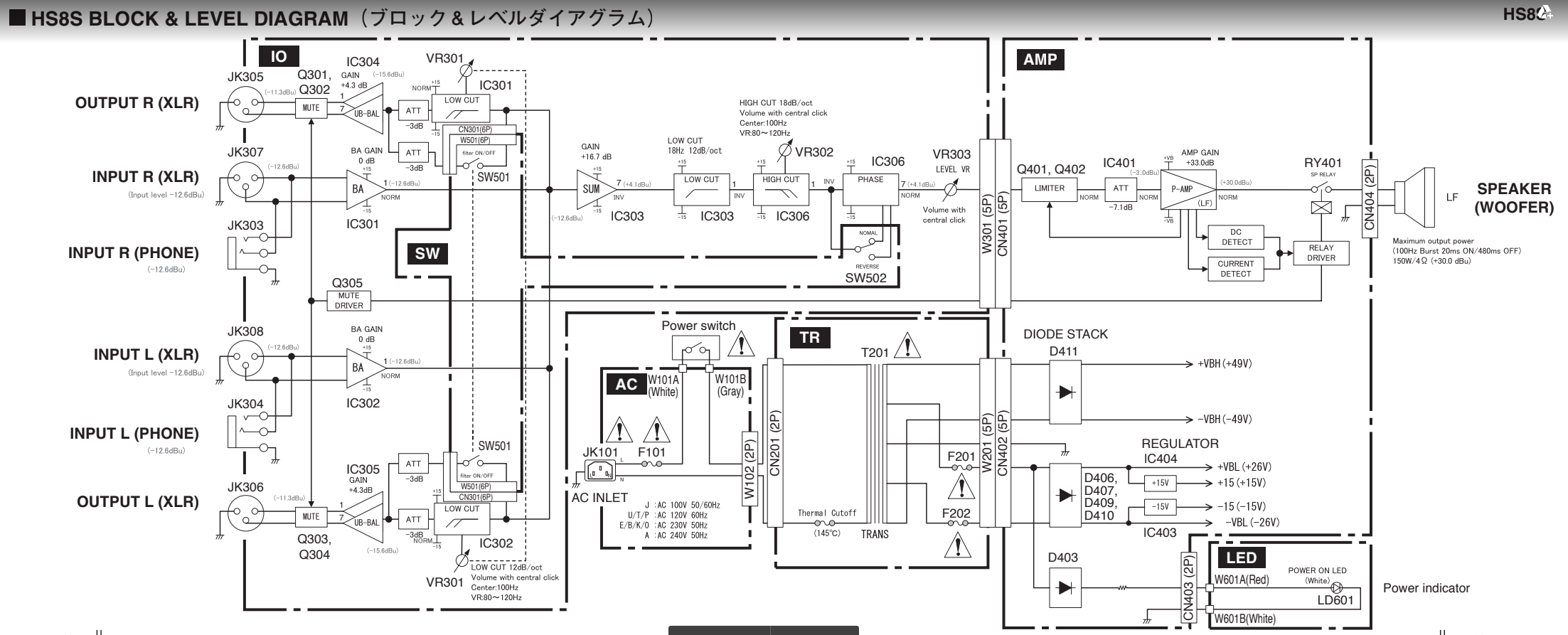

I got the service manual. The issue is in the right channel. Is the issue more likely to be the filter switch or phase switch?
EDIT: actually, SW501 and SW502 aren't relays, just manual toggles. They're never switched so could they still be the issue? The only relay is RLY401 but that is for the sub speaker. The "mute" switches (Q301/2/3/4) are driven by the sub relay driver it looks like they are listed as transistors in the parts list.
It turns out it was SW501, the lowpass filter cutoff. I guess the pole for the right speaker got oxidized. Switching it back and forth once got rid of the issue...for now...

I've never observed that from a device before just sitting in my house in dry conditions, unswitched. Was fine that morning and just started happening the next time I turned it on after work. Over the next 2-3 days the volume required to "punch through" just kept getting louder and louder. Is there anything I can actually do about that? I don't want to have to open up all my speakers and subs, and then open up each switch and relay (if it's even possible) and apply some protectant to it. I'm actually kind of surprised those switches are directly in the signal path and didn't realize they were until I got the service manual. I thought they just toggled some control signal to something elsewhere.
Small squirt of WD40 in each switch, and work it back and forwards a few time, job done.
WD40 tends to be far better for such purposes than expensive 'switch cleaners', and we used it professionally for decades at work.
