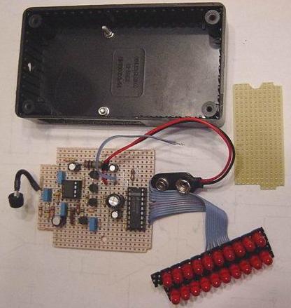

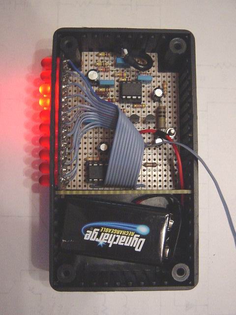

I designed one that has extra features that makes it fairly complicated.

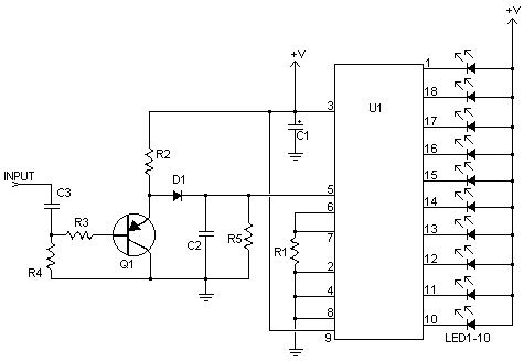

Here is a simple VU meter project that i fixed:
Sound Level Meter
Hi AG,
Thats a fairly neat construction. Can we have that circuit with extra features you designed?
The LM3915 has a range of 30dB. I added automatic-gain-control to increase the range to 50dB so it indicates a pin dropped on the floor in the next room and it indicates the TV or stereo playing very loudly. My project has a microphone.
It has a "9V" rechargeable battery for short duration demos but usually operates from a wall-wart charger.
It has a peak detector circuit so that the peak levels are clearly shown.
Each output has two LEDs in series that look like stereo but are actually mono.
My project is here:
Sound Level Indicator
Ok now that i think about it the first vu meter that you posted two above this one is something that i would like now. But now that I have changed what i wanted there are sadly more questions to follow.
1) What do i do about the two V+, attach both to the 6V wall wart?
2) Where does the negative wire from the wall wart go to?
3) Is ground considered the negative wire of the wall wart? (I thought this because if the potential difference was 10 V, 5 V above and below zero, then if one was set to 10V then the other could be set to 0V, or ground. This may also be insane thinking b/c im only in physics II right now)
4) Isnt there more than one wire that is in the input for the audio jack, making it more complicated than just straight from capacitor to input?
5) What are the values of the R1, C1.... and is the transistor that NPN TIP31 that I keep seeing in relation to this audio sync with lights?
6) Could I make two of them to have one for each speaker or do they both run on the same channel?
7) What voltage leds should I use and i saw a post somewhere not to have blue VU meters for blinding reasons so could I have one that has the first 7 purple and last 3 red?
Sorry for the bombardment of questions I know its a pain but I just wanted to get them all out of the way. Shouldnt have changed my mind half way into it but now that I see these are not too difficult to make are feel like I must make one(buying one is just not to satisfying).
Your sketch would simply blink the left and right channel groups of LEDs. It is not VU meters.
1) The VU meter circuit has only a single +6V but two are shown on the schematic so that the wires are not running all over the place. Join the two +6V together.
The +6V can also power the other channel.
2) The negative wire of the 6VDC wall-wart connects to 0V (ground) on the circuit. Join together all the grounds.
3) Ground is usually 0V in a circuit. The circuit does not use a negative supply.
4) The input is in series with the input capacitor. A 0V wire (ground) is also needed at each input.
5) The link has the entire project including a detailed parts list.
6) You can make as many circuits as you want. Use two circuits for stereo or use 5 circuits for 5-channels home theater.
7) You can set the brightness of blue LEDs lower by reducing their current so that they are not blinding.

So this is not a VU meter that is set to the input? (as in it doesnt only flash but lights up more at the dB get higher?) Lets say that mentioning the VU meter has made me want to change to making one of those instead now, couldnt I just do this to make it a VU meter with the audio jack input?
And you stated that the parts listed are all in the link, the link is for the microphone VU meter, are they the same parts for the picture above?
by the way thanks for your help
EDIT: oh, and i actually want the 7 purple led's with 3 red at the top now so no need to keep em dim
Actually couldnt I take that second picture shown and somehow put the same electret microphone instead of the input to the computer? (to make it more of a moveable meter)
The VU meter schematic you posted twice has its parts list in its project. The project is here: Sound Level Meter
It doesn't blink the LEDs. It lights them in a bar where the length of the bar represents the level of the sound. Loud sounds make a long bar.
If its pin 9 is disconnected from its power supply then it makes a moving dot of light.
Its 10th LED lights when the peak input voltage is +1.25V. Your MP3 player's line output might not go so high.
The circuit will not work from a microphone because the output of a microphone is too low at only 0.01V. A preamp is needed to amplify the output from a microphone up to 1.25V.

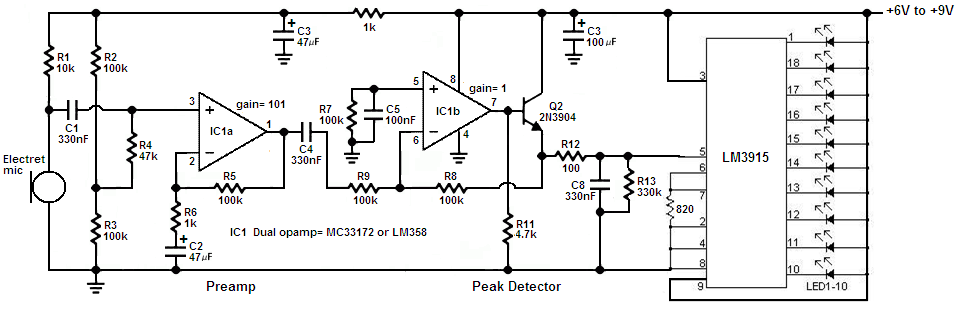

My project has a microphone and uses an opamp as a preamp. It uses another opamp as the peak detector. The LEDs use a lot of power when they are set to be bright so my 9V rechargeable battery lasts only 10 minutes for a charge.
Ok I found the parts list and I have gained interest in you project with the microphone. Is it possible to only have one opamp in it for simplicity's sake? If so what components would I have to remove? I feel like I could avoid a few questions of trying to make the circuit in LTspiceIV, do all i have to do is try to arrange the parts so that all of the parts recieve the correct voltage?

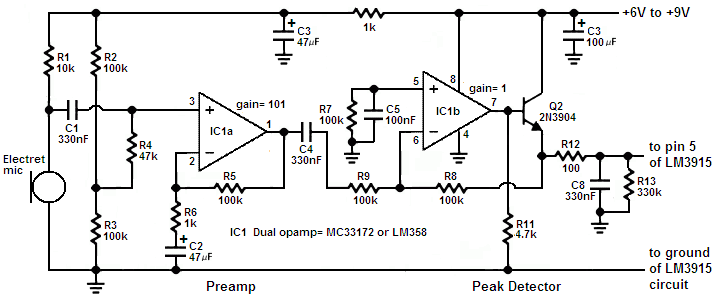

Here is the preamp and peak detector circuit of my project.
Then the VU meter circuit does not need the input transistor peak detector and its parts. The special dual opamps eliminate some parts.
When you say "to ground of LM3915" for the wire running on the bottom right of the thumbnail does this mean that it connects to pin 9, or the combination of pins 2,7, two more pins as in the previous schematic that I had to almost identical ones posted of?
Pin 9 of the LM3915 never connected to ground. It connects to the positive supply for BAR mode. Leave pin 9 disconnected for DOT mode. Pins 2, 4 and 8 connect to ground.
