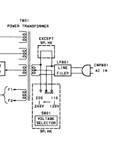

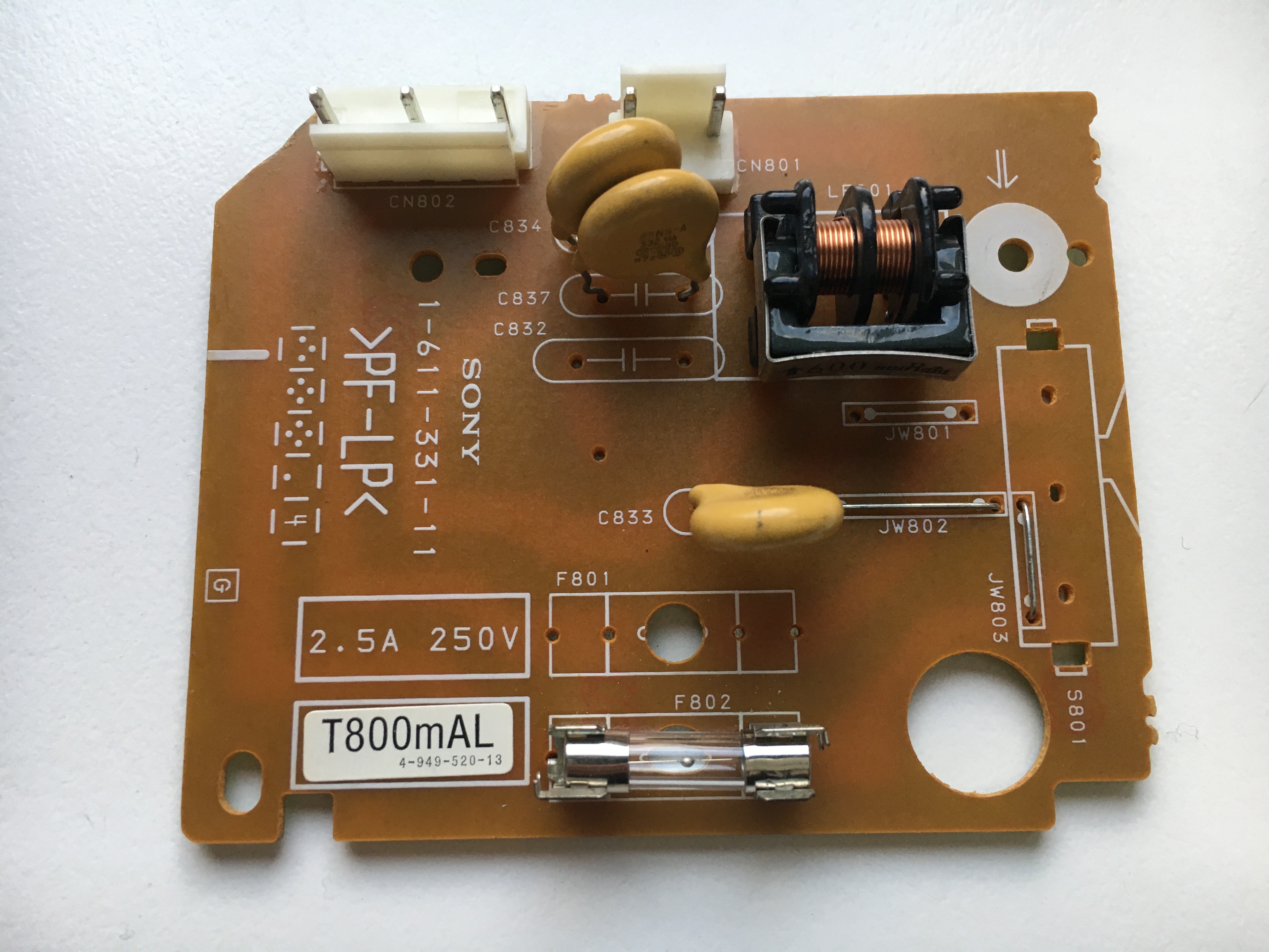

The thing is always on and shows a the time. I checked the AC-board and AC is coming in, but nothing passes through the fuse, so the problem could well be in one of the components of this tiny board

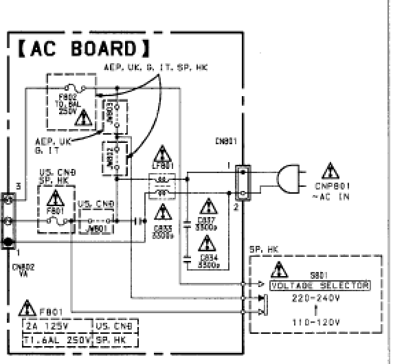

This is a picture of the AC-board, then the diagram form the service manual.
In the manual diagram there is a switch to change from 110 tot 220. In reality this is absent on my device. It is setup for use in a 220 world only.
So the AC-board no longer has this function it only serves as AC entrance and delivers the power to the transformer.

It is possible that there are two transformers, One very small one supplying the clock/timer part and a larger one that powers the main part of the unit. Posting the full schematic would give us a much better idea of what area the fault lie in. It would also show if my guess of there being two transformers was right or wrong.

That was quick. In Belgium we are diving into the night now. Here is the service manual so you can study the workings. I really hope that, with you're help, I can get the beauty running again.

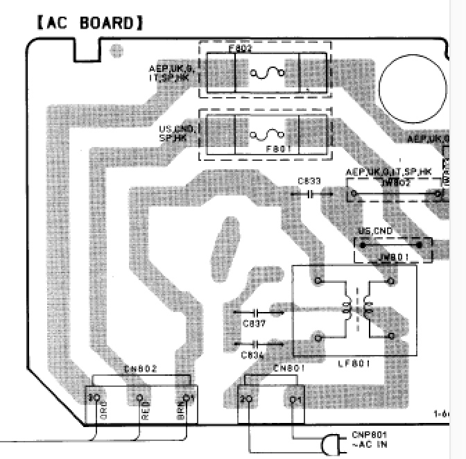

That board should have direct connectivity from the two input terminals to the two outer terminals on the three pin connector.
Do you have a multimeter you can use to check continuity of the fuse and filter choke, measuring from the underside of the board?
The choke should show as a short circuit, zero ohms or nearly so, if you measure between the top and bottom pin at each side.
The only other possibility is a dry joint, but none look particularly suspect. There are some shadows under the connector pins that make those joints difficult to see.

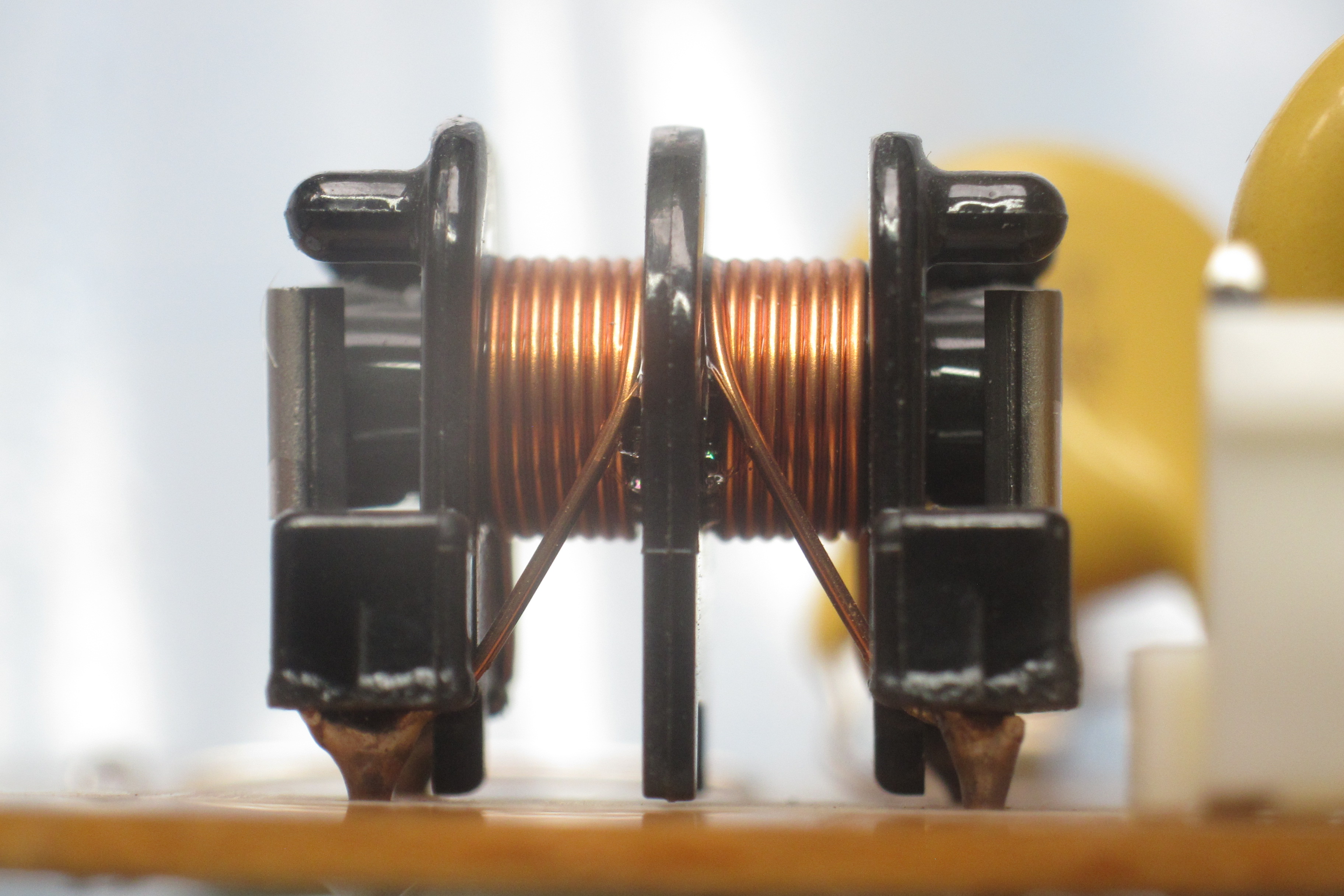

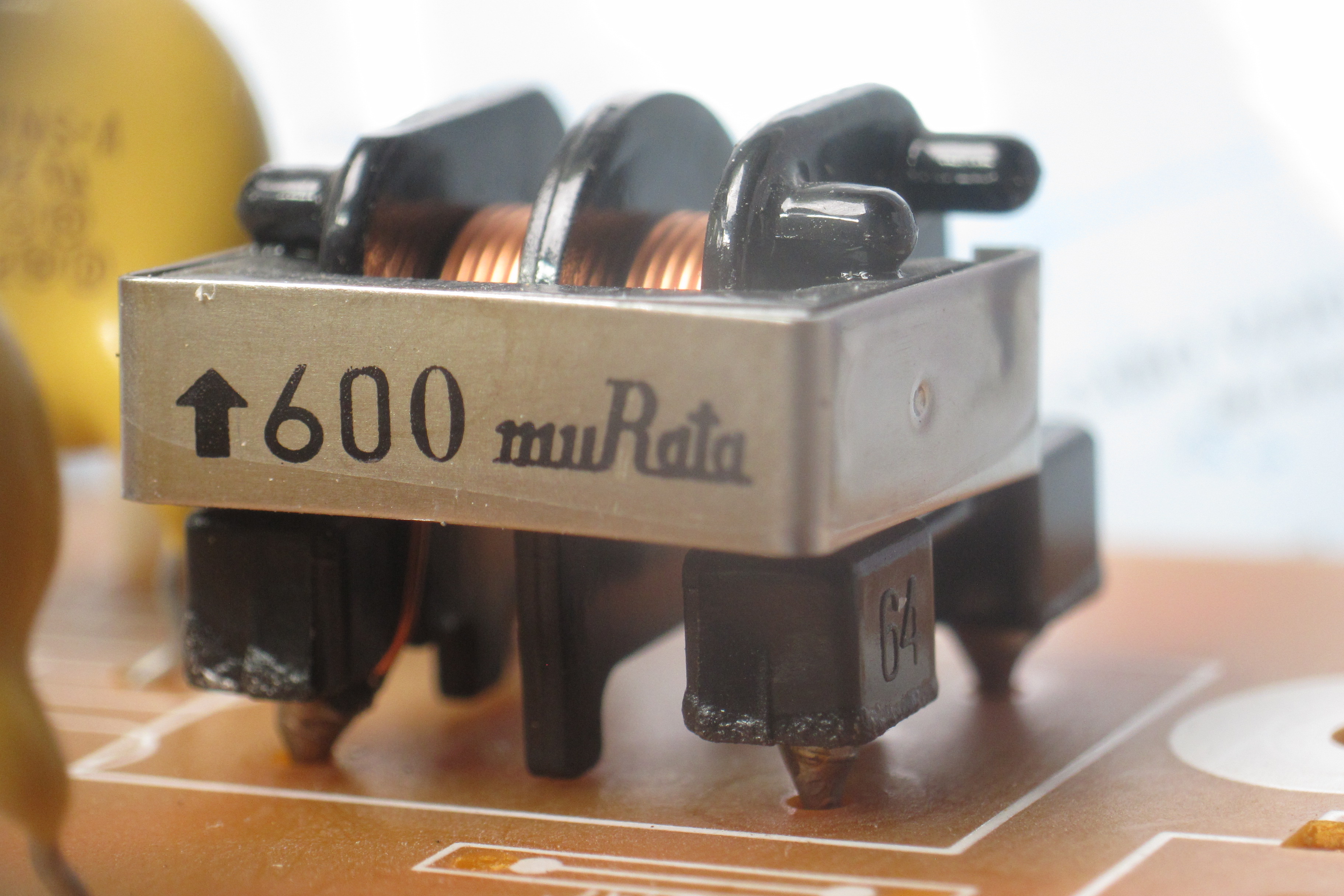

Yes I have a multimeter and I'll check for continuity. Even with a magnifying glass I can see no dry joints, but the little transformer thing smells burnt and the plastic around the feet looks like melted or scorched. What puzzles me is that the fuse is ok, that makes me think that the standby circuit, clock display, is dead, but the power circuit may still be alive, as Les says.
Can this power board be safely bypassed ?
What is that filter choke ? Is it to filter current spikes ?

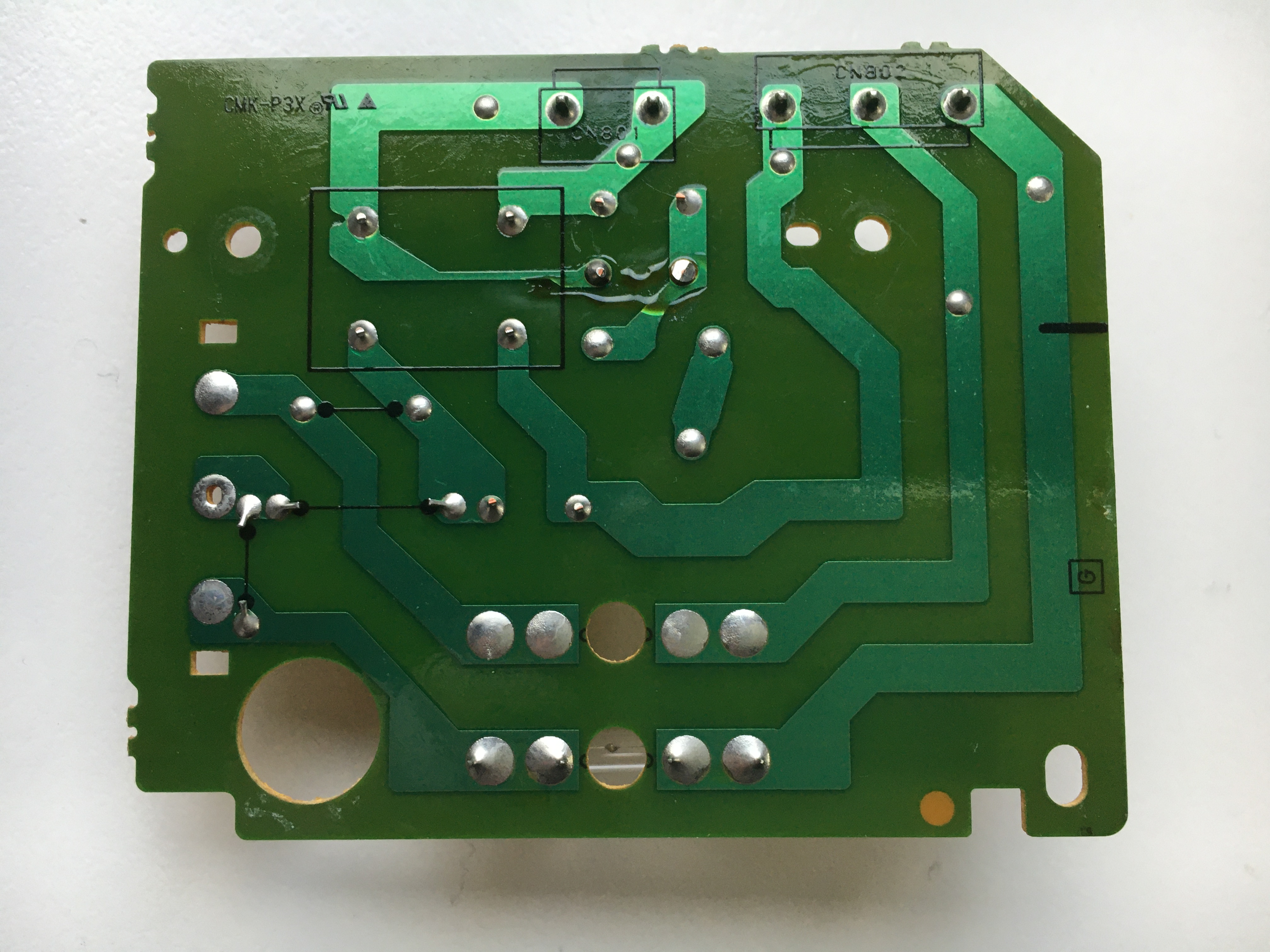

First thing, just check continuity from the input of the PCB to the output.
Call the connector pins one through five across the board, starting at the two pin connector side.
Pin one should connect to pin five and pin two should connect to pin three; nearest and farthest across the two connectors in other words.
Look at you underside photo of the PCB:
The nearest inside pins connect only through the choke, the outside ones go via the fuse, some jumper links and the other side of the choke.
The choke is a "common mode filter", it's to reduce electrical noise emitted from or passed through the power cable.
I'm guessing the scorched appearance is from the original manufacturing, when the coil wire ends were soldered to the bobbin pins, possibly by dipping or wave soldering. If that process did not fully burn off the lacquer insulation on the wire at some point, it could be causing a problem.
Check continuity through the entire board first, then the inductor if one of the board circuits is open.
It's VERY, VERY unlikely to be that, they basically never go wrong - there's nothing to go wrong really.
I agree completely - but the OP says the board has power at the input terminals and not at the output terminals, some something must have failed!

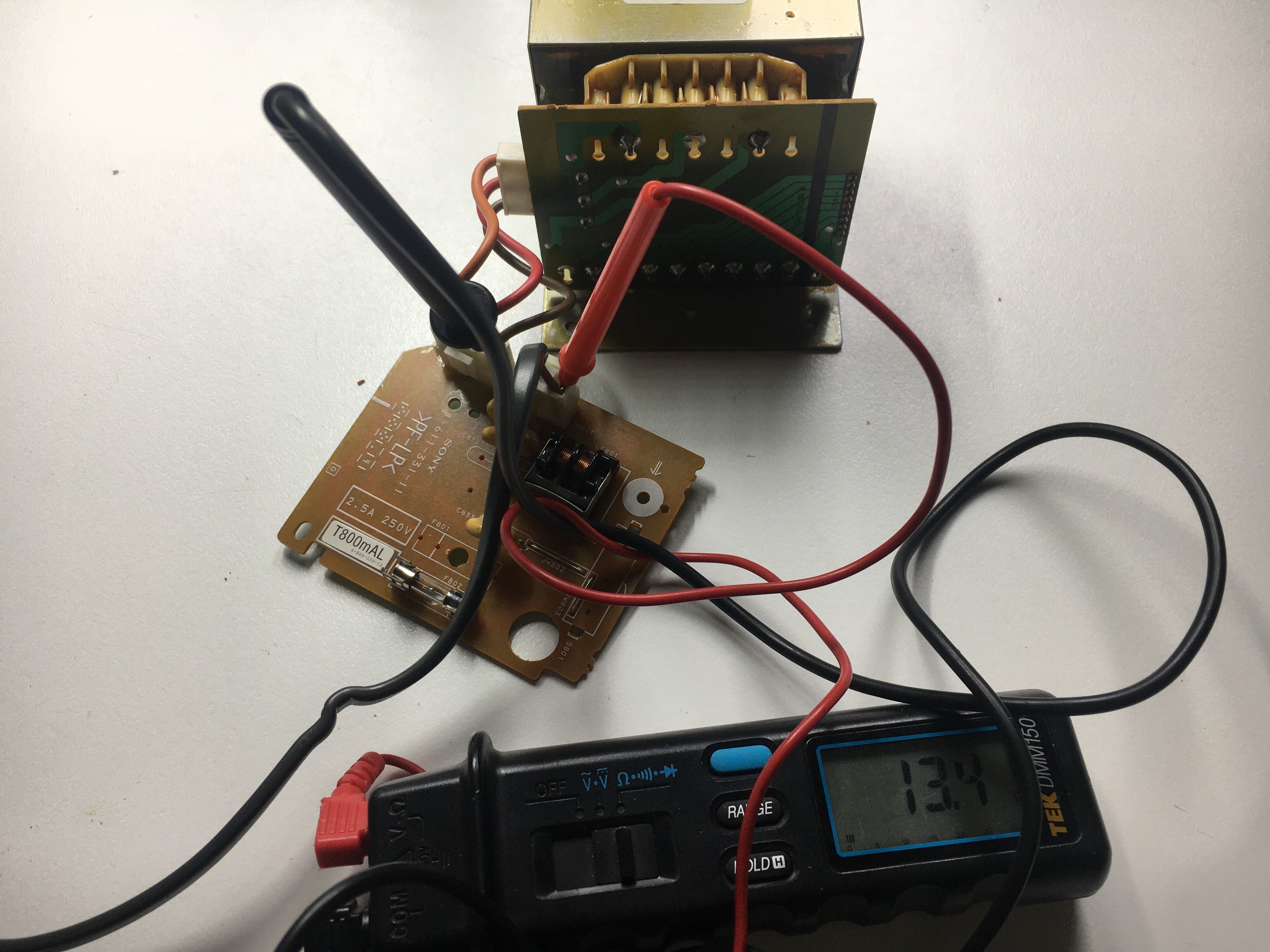

Just use your meter on the low ohms range (200 ohms FSD?) - DON'T plug the unit in the mains.
Without touching anything the meter should read 'over range', on my meter here that is '0L.' - if you then touch the probes together it should the read near '00.0' (mine reads '00.3').

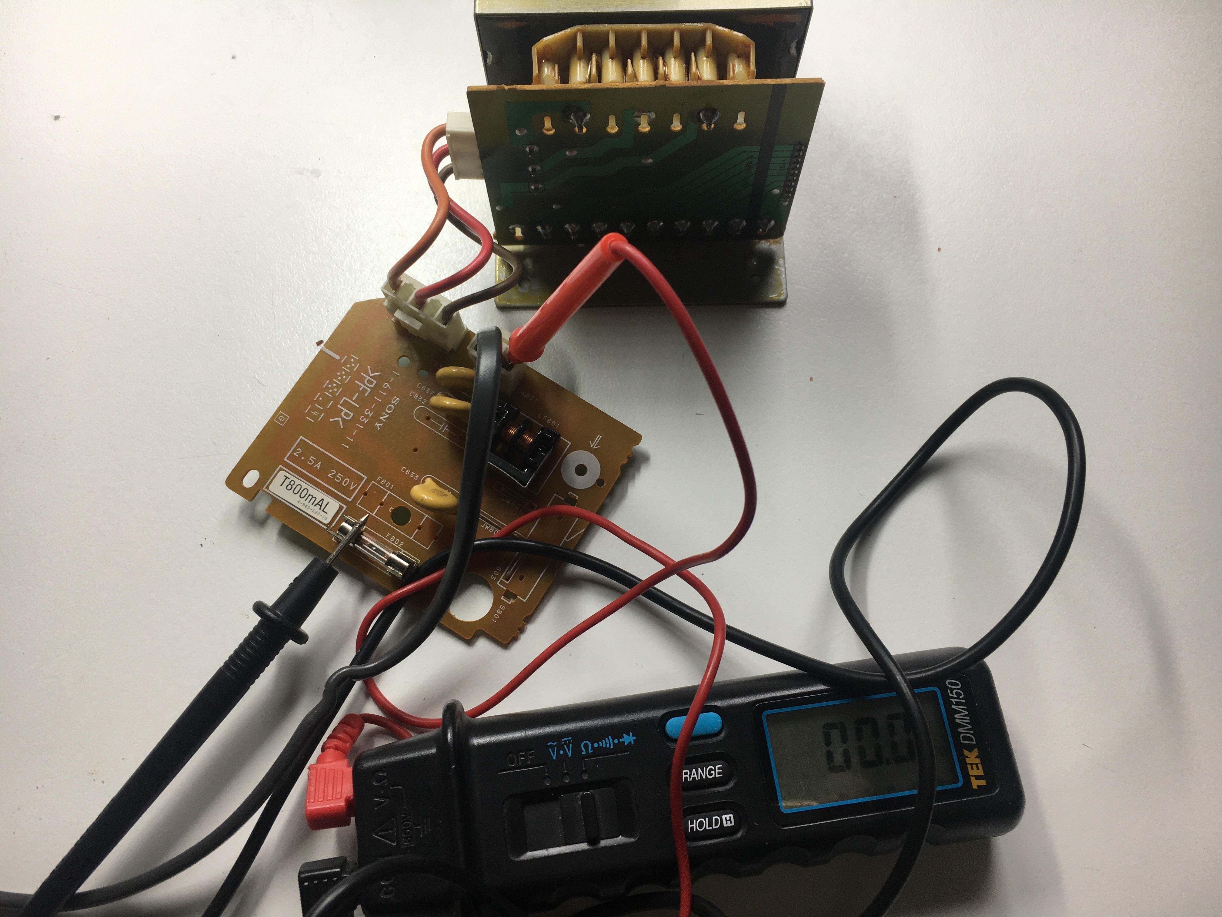

On the AC board there are two connectors, a two pin (CN801) and a three pin (CN802) you should be easily able to get your probes in the top of them. So place the probes in CN801 pins 1 and 2 - if it reads over range, then there's a fault. Now try the same on CN802 pins 1 and 3, again does it read over range or a low resistance (anything less than over range). If it reads over range it's likely the thermal fuse (non-replaceable) inside the transformer has failed.
But if it reads low, then the transformer should be OK. In which case put the probes in CN801 pin 1 and CN802 pin 3, this should read low - if not try from CN801 pin 1 to the fuse (F802), it should read low to both sides.
So try that and report back.
Robert, I’ve checked the power board and the multimeter happily beeps. So what goes in, goes out. Problem must be down the road..

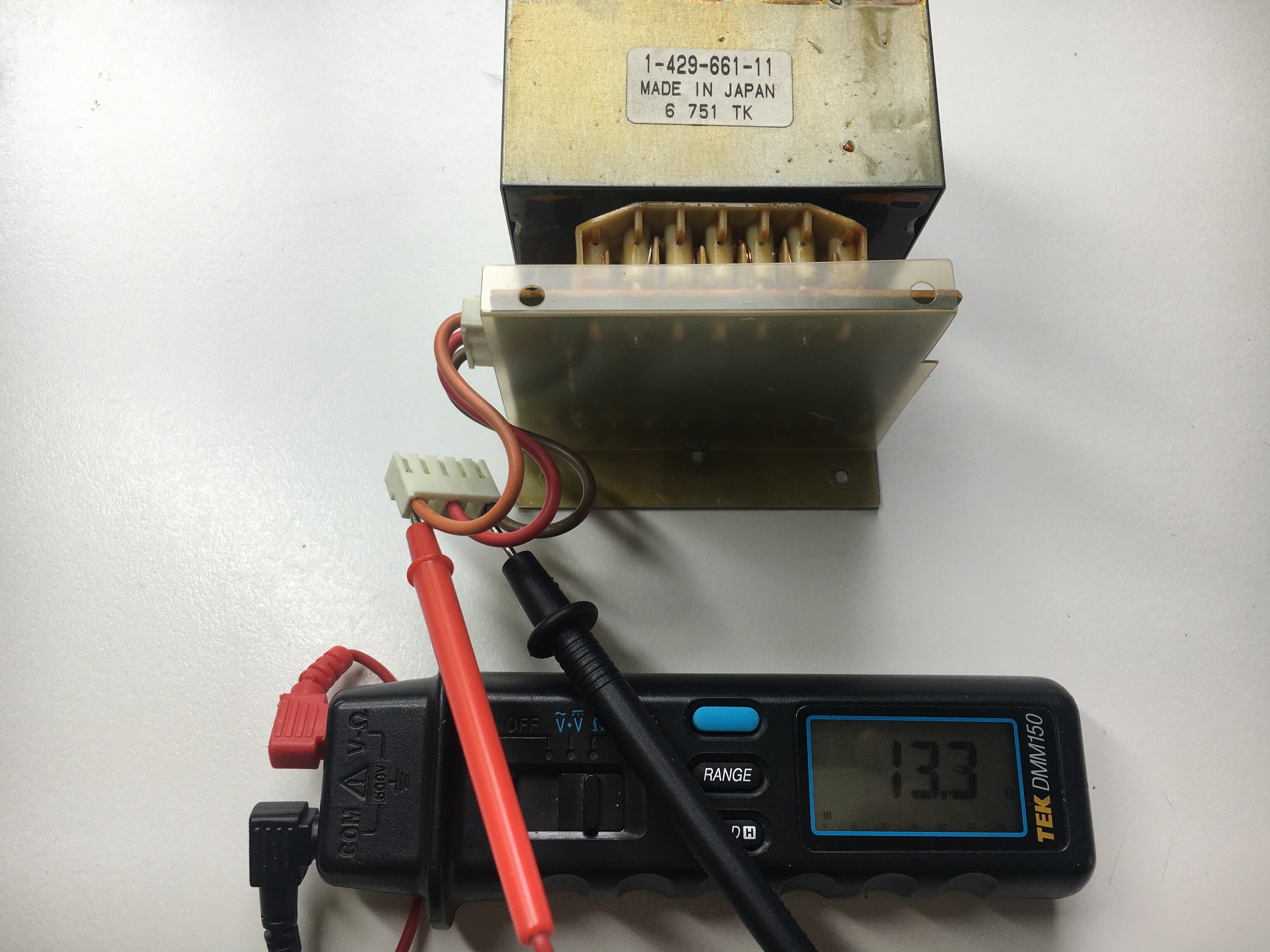

What do you mean by 'power board'?, do you mean the AC Board (as it's called on the circuit - the one with the fuse on). If that board is removed, you could test the transformer by putting the meter across the pins of the plug that goes on CN802 (pins 1 and 3).
Yes, I said power board, but I is the AC-board. Now I'll do the test on the transformer and hope for good news. Because in the manual they take about a 'non-replaceable item'. As with many old things, I would like them to work, even if I never, ever use them again. Must sound familiar to most tinkerers.
I'll report back.
Brushed my teeth, combed my hair and took the transformer out.
I measured the outer pins of the input plug and this is what I got :
No smell, no sign of heat, look brand-new to me.
What does that tell you ?
Well you didn't need to take the transformer out :D
The transformer looks OK then, so put it back in, and put the other board back in - then do the tests I mentioned in post #13
Thanks. At least I could visually inspect the transformer and it looks ok. I attached the AC board and did the test of post #13.
First CN801 pin 1 on CN802 Pin 3
Then CN801 PIn1 to fuse
