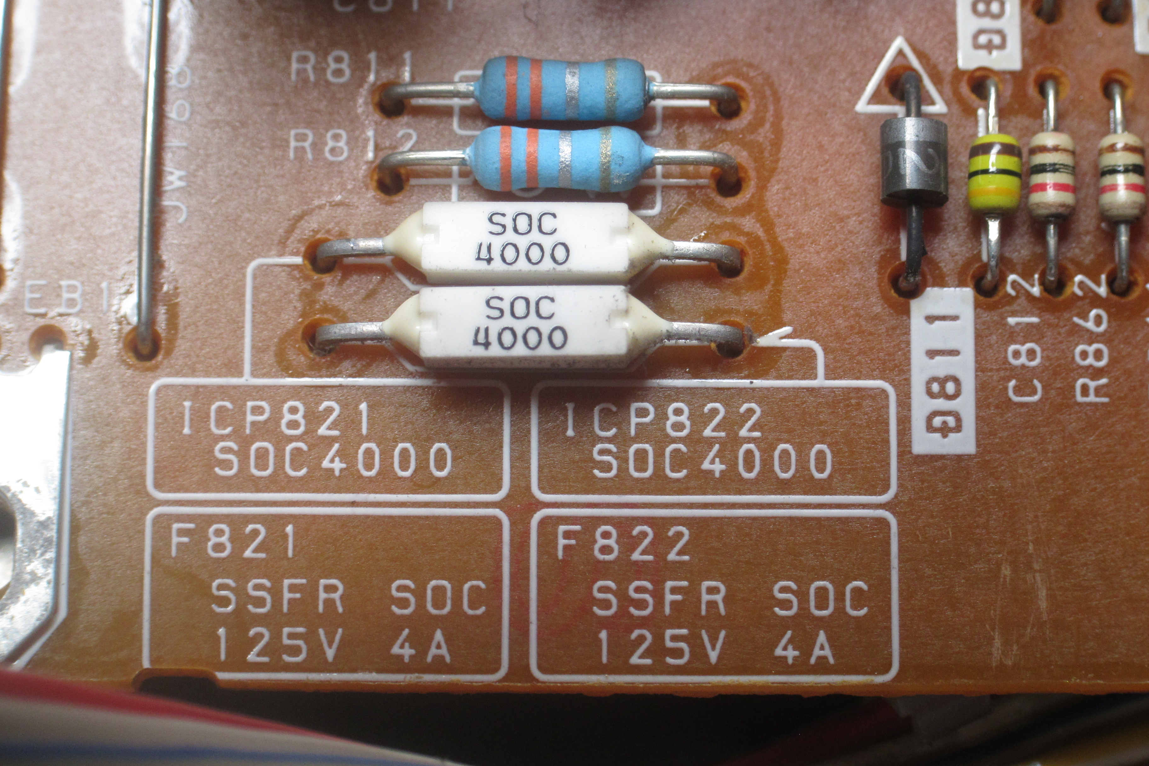

Edit. You are correct these two fuses blow if anything drawing power from the 10 volt winding on the transformer draws too much current. I would suspect the the bridge, the two voltage regulators fed from the bridge output, the capacitors on the input and output of these regulators and possibly anything fed via R716 (0.33 ohms).

Circuit protectors commonly fail for no reason at all - with the OP's lack of electronics knowledge his easiest solution is simply to replace the circuit protector and then see what happens, most likely it will cure the situation. If not, it will simply blow again - and we can discuss it further if that happens.
Assuming it blows again?, most likely cause would be the bridge rectifier (D821) - the voltage regulators and capacitors etc. are very low probability.
This is from the part list in the service manual
< IC LINK >
ICP821 1-532-845-21 LINC, IC (4A 250V)(AEP,UK,G,IT,SP,HK)
ICP822 1-532-845-21 LINC, IC (4A 250V)(AEP,UK,G,IT,SP,HK)

F821 1-532-782-11 FUSE, MICHRO (4A 125V)(US,CND)
F822 1-532-782-11 FUSE, MICHRO (4A 125V)(US,CND)

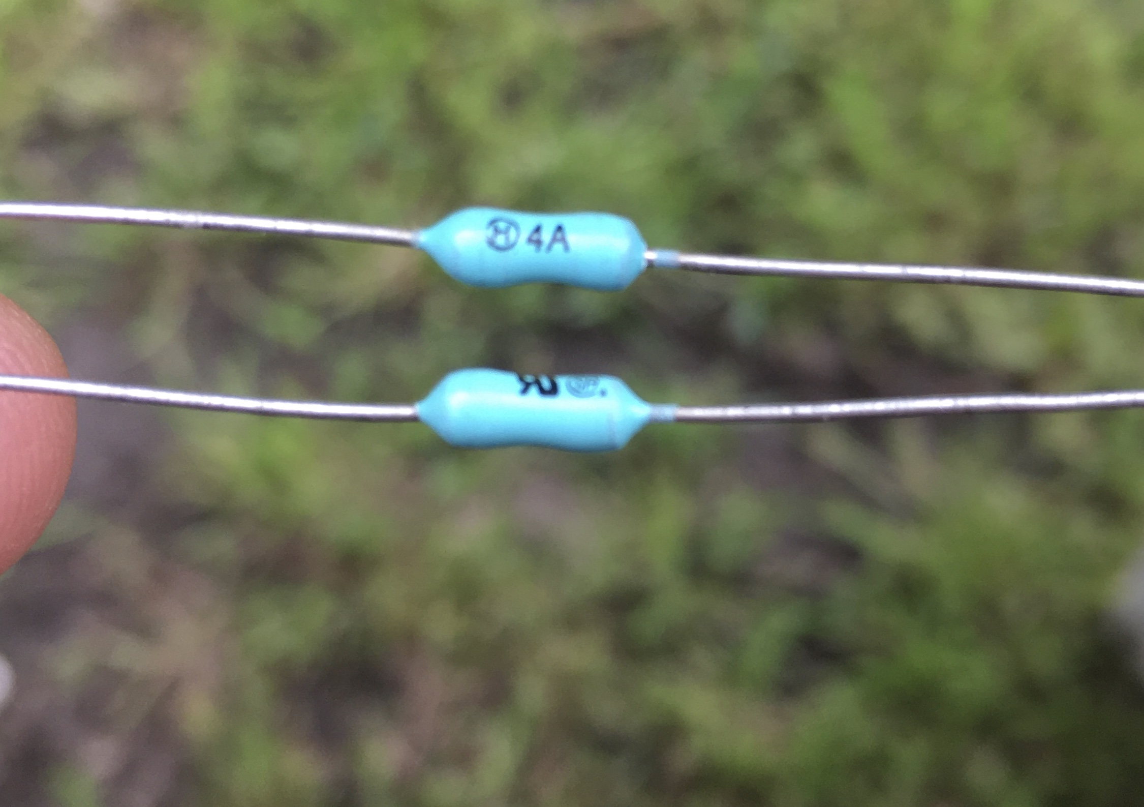

Have a look through the 4A ones on here, with axial leads and rated 125V AC or above; Slow blow / time delay types are appropriate for feeding a rectifier and capacitor setup.
Some may be too long, so check the dimensions.
You can see some are literally just conventional fuses with leads attached to the end caps.
The difference between Europe and USA is likely down to differences in equipment regulations.
Find the cause of the failure before fitting the solder-in fuses, though.

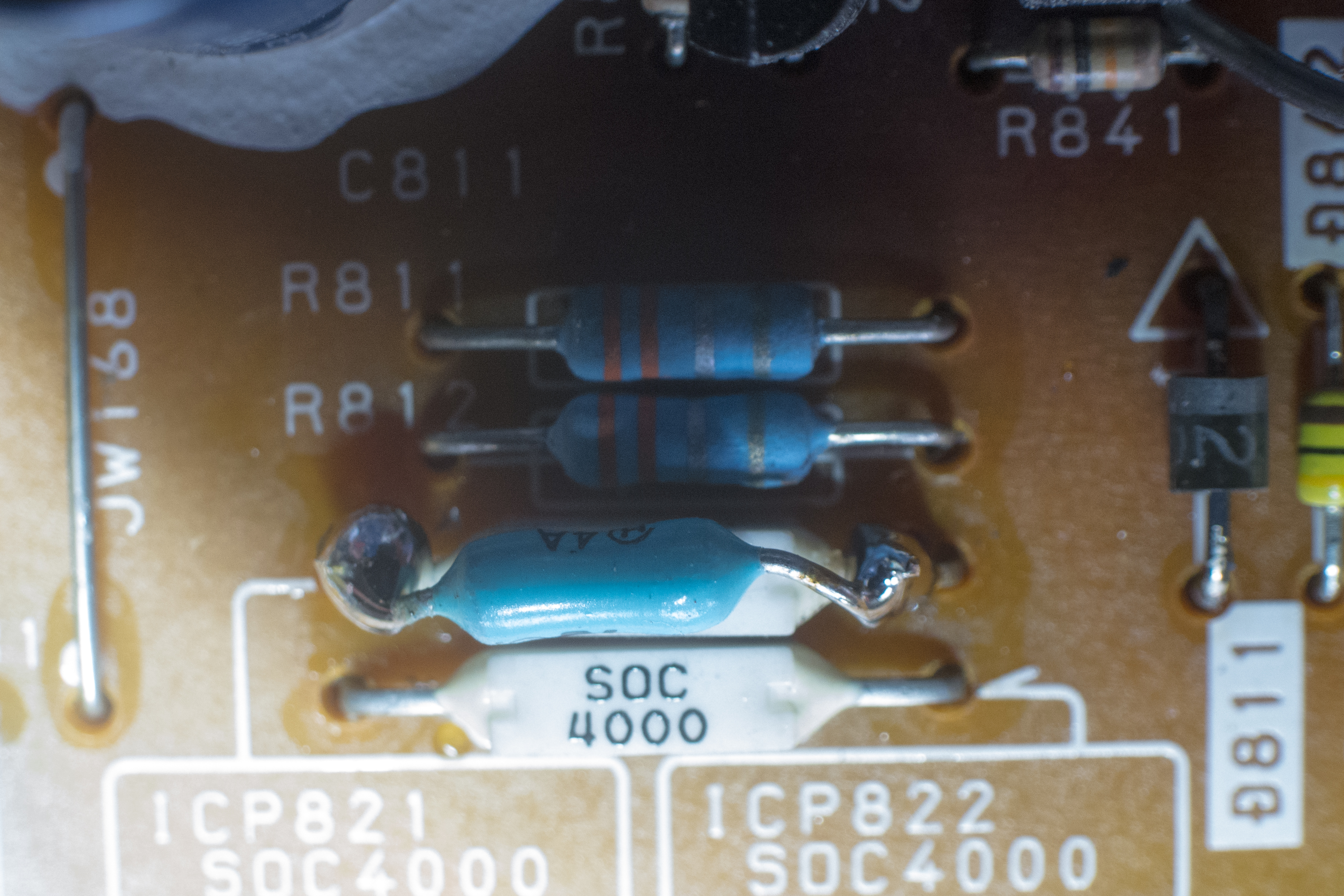

As I mentioned above, they commonly fail for no reason - so with his lack of electronics knowledge it would be MUCH easier just to replace it and see if it blows again.
Even as a long time professional engineer that's what I (and any experienced engineer) would do - and that picture above shows it's REALLY simple to do, that style of circuit protector means you can just tack in on the top of the faulty one to test it. Or, looking at that image, even use miniature croc clip leads to connect one across it. Obviously it helps if you have them in stock - but if you're ordering one, order 2 or 3 instead :D
We also didn't stock that exact style (we kept three different types though), and would have replaced those with a plastic 'BC557' shaped circuit protector.

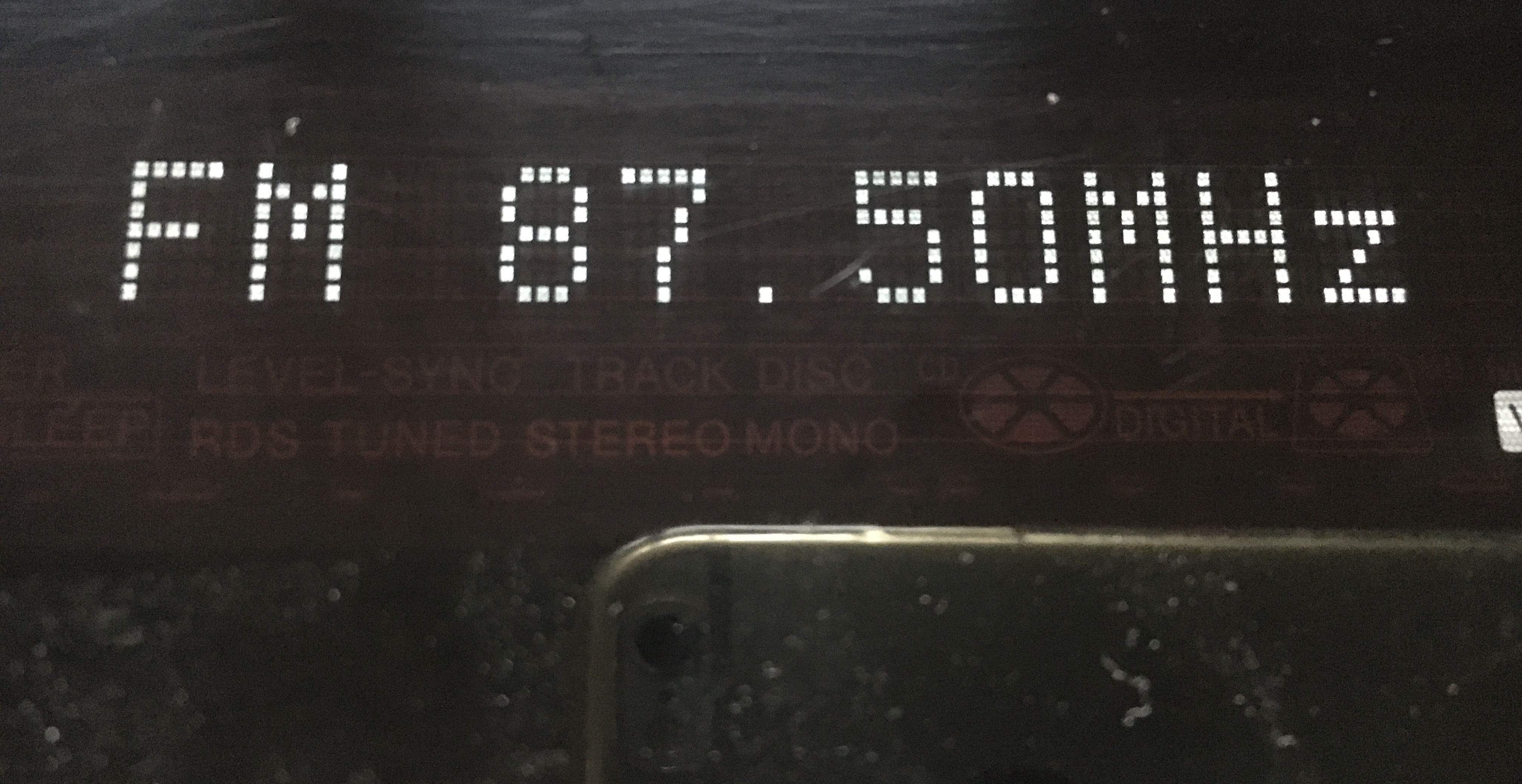

It works !! The Sony is back and I just had Christmas, new year and birthday at the same time. And yes I tacked it on the old one as Nigel proposed.

Well I’ll leave it like that, it tells the story. How Nigel took an electronics toddler by the hand and guided me through the wood. Honestly I learned a lot this time. Thanks to your knowledge and patience. Here in Belgium we say : let’s have a beer together. Do I go to my fridge and you go to yours. Cheers.
But I thank also Les and RJenkins who were the first to save me from drowning. From the AC-board to the transfo, to the 14 pins on the main board and finally the blown soldered fuse. I won’t forget the trip in Covid time.

Instead of a beer I continued reassembling the Sony. All fine, but the mini-disc auto-loader was not working, there was a disc inside which didn’t want to eject. Damned. I opened the thing again until I could manually turn the mechanism until the disc was free. Done this before, because the initial repair last year was replacing the rubber belt. I close the Sony again again ..... no sign of life ! Opened again, I measured the fuses and found resistance on both. Still the joy of seeing it work was worth all the trouble. Of course I have no use for the Sony cd/md player recorder receiver, as I am hearing impaired and listen to the television with direct streaming. Now it is back on the shelf until I get the urge to tackle it again. And I know who to call....

What if .... I go for some new blue fuses and replace both this time ?
What if .... the blocked minidisc mechanism made the fuses blow ??

Assuming the mini-disc is fed via those fuses it's certainly possible that the mechanism been jammed could have overloaded the fuses, and would explain the original failure.
