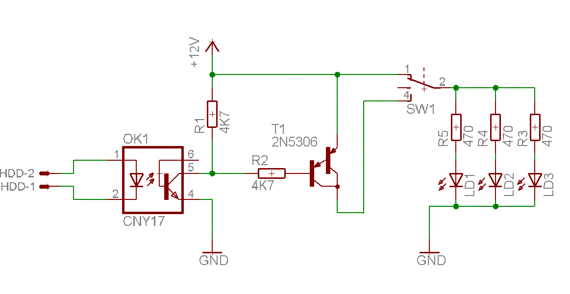

Hi. I'm new here and new to this whole making of electronic "stuff". I have this little project I'm trying to get underway. Basically, I want to wire up some UV LEDs for the inside of my computer. The only thing is that I want them to flicker along with the HDD LED. I know I just can't wire a string of LEDs right to the HDD jumper. I'm pretty sure I need a relay with a secondary power source. I want to wire a 3-way switch also that will allow me to turn them off, on, and strobe. I know how to wire everything. I just dont know what to use. I don't know jack about power ratings and stuff like that so I need some help. First,... some stuff I do know. My PC has a 500w PSU with +3.3VDC@28A, +5VDC@30A, +12VDC@34A. The HDD jumper when active gives off ~1.9V@.0 - .1A. I went to Radio Shack and picked up some stuff. I don't know if I can use them but I got them to get the info off the back that I don't understand. I got a 3-way and a 2-way switch. The both have the same ratings, "Rated 10A@125VAC, 6A@250VAC". Can I run the power from my PSU through this? I dont know how to calculate the rating in VDC if I even have to. I think I can but I am not sure. I also got a 12VDC Reed Relay that is normally open. Some info on that,... "Voltage:12VDC, Coil Resistance: 1050 ohms, Contact rating:1A@125VAC, Nominal Current: 11mA". what does all that mean? I think the voltage is what operates the relay or closes it. Contact rating is how much power I can run to it or through it once the relay is closed. Nominal Current is the power thats eaten up by the relay? Is any of that right? How do I know what the equiv for the A@VAC?!?!? Am I using the right relay for the job? I need a realy that can keep up with the HDD jumper and will live for some time and not die out. Thanks.

That HDD pin has got to be a 5V logic level with a series resistor already on its board. The main question is if it's a high side or low side drive... I'm assuming it's a sane low side drive.
You can use the signal to drive either a N-channel MOSFET gate or an NPN transistor's base. The base may require another transistor, but I think the resistor on the supply is sufficient based on what you said. It would probably go up to 15 mA or so. From there, you get a +5V tap off the power supply cable and put the LEDs each with their own series resistor all in parallel, one end on +5V, the other on the drain/collector. You can drive any number of LEDs like this.
i just measured an Led on a motherboard..it read..
2.08V while connected to the motherboard
but it measured 4.90 v at the connector..
perfect for the gate of a N-channel FET..or the input to an opto-isolator..

How many led's are we talking about? Do you have information about the led's you want to use (forward voltage and forward current?).
I wouldn't use a relay as it will be to slow to follow the blinking of a harddrive led, it will also wear down quickly because it has to switch so often.
As samcheetah said, an optocoupler is the way to go.

Thats the specs for the UV LEDs I have. I have to read up on this optocoupler. What is it and what does it do?
you can add more led's in parallel with the 3 on the drawing, all of wich need their own 470 series resistor.
you need to get the 12V and ground on the secondairy side of the optocoupler from a power connector (the ones you plug into your cdrom or harddrive)
Black is GND - Yellow is 12V
The 2N5306 should do fine upto 50 leds
