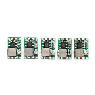

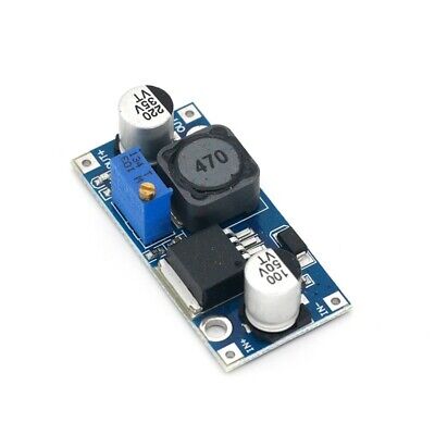

I have a gadget that uses 2 AAA batteries. I want to run it on AC. I have loads of 12v power supplies from external hard drives, old routers, etc.
1) How would you recommend I get 3V out of those 12v power supplies?

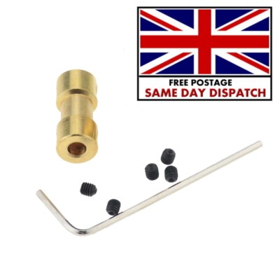

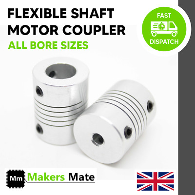

4) maybe appropriate to ask here? A different project has an electric motor (think sewing machine motor) with a thin shaft. I need to attach a longer rod to it (to effectively extend the length of the motor shaft). Anyone know where you'd get a coupling or similar to connect the motor shaft to the extension. haven't measured both yet, but likely something like 1/8" diameter for each. The extension is only a couple inches.
I am envisioning a sleeve with a hex set screw at each end? I have no idea where to get something like that.

For the coupling, just search "3mm shaft coupling" on ebay etc.
Examples - rigid:
Flexible, for eg. if the extension has its own bearings:
Imperial sizes are less common, but you should be able to drill a 3mm to 1/8" if needed.
For the 3V unit, what current does it need?
There are numerous versions of buck converter modules available, that could be used - but be aware the power or current ratings in adverts like these are often rather exaggerated, eg. possibly the current they can stand for a fraction of a second. Always use one that is advertised ate 2 - 3 times higher than you actually need!
Also, if a motor is involved, the initial current can be far higher than the measured running current, so you need a power supply that can take at least five times the normal current, for a short time.
This type is OK for very low currents, but I've had one fail at well under 1A...
This style is fine for possibly a couple of amps:
If it's using AAA batteries then the current shouldn't be high and the buck converters linked above should suffice. Do you have a meter to set the output voltage?
