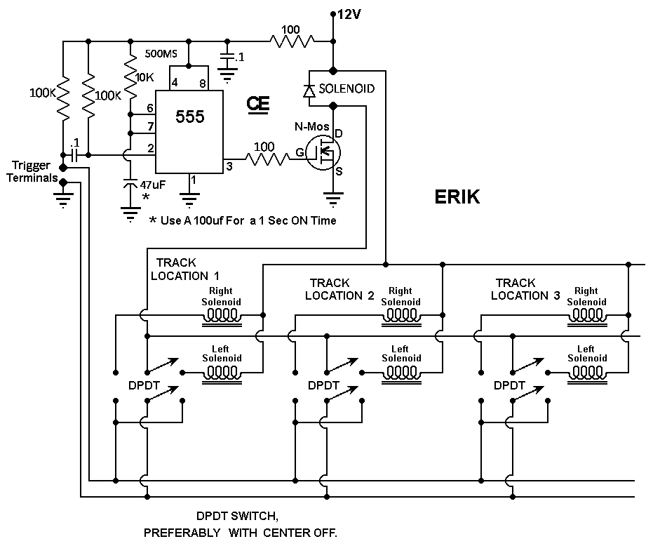

Hi chemelec, thanks a lot for this diagram! Somehow I did not get notified of any postings since October 15, sorry for the delay in replying!
Now how would you add an "OR" gate to the trigger so that for example an external circuit with 1. potential free contacts or 2. with a voltage trigger of 5V (high impedance output) would also have to be able to trigger specific solenoids? I am thinking of adding automation, so that solenoids would be triggered by either the DPDT switches, or by external control circuitry (for example Arduino controller).
The external circuit would be able to give both a trigger signal for the 555 and a signal to the solenoid te be dtriggered.

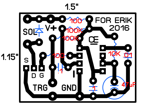

I am offering him the PCB for Free, Including the Postage Cost, just sending it in a Letter.
I Could supply him with the PCB and All Parts, Including up to 20, Center Off Switches, But than it becomes a Parcel.
Between the Higher Cost of Shipping and all the Parts, I Can't do that for Free.
That is very kind of you. But please let me know your expenses, I will be glad to return the favour.
Erik, The Circuit Board was Mailed on About Oct 21, along with the Parts Overlay and Schematic.
Your should get it fairly soon.
NO CHARGE!

chemelec, the board arrived last week; when it is populated (will take some weeks though) I will post a picture :cool:

Meanwhile arrived, many thanks!
To chemelec, or others: how would you add an "OR" gate to the trigger so that for example an external circuit with 1. potential free contacts or 2. with a voltage trigger of 5V (high impedance output) would also have to be able to trigger specific solenoids? I am thinking of adding automation, so that solenoids would be triggered by either the DPDT switches, or by external control circuitry (for example Arduino controller).
