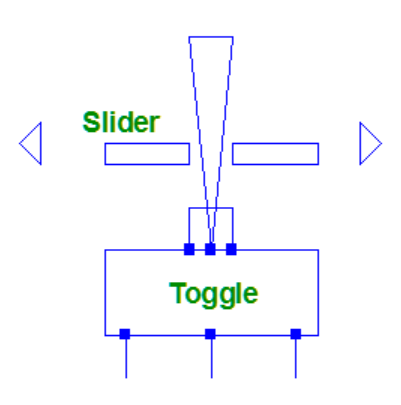

If you want a turnout left/right indicator for use with a centre-off switch, perhaps you could make something like this (excuse my graphics) :-
A slider with an elongated aperture could provide a certain amount of 'lost motion' so that it remains in the last operated left/right state even when the switch returns to the centre position.
Brilliant Alec,
I have thought of a few schemes but, none are as neat and simple as that.
