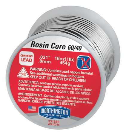

I'm with rjenkinsgb on this one - rosin-core solder is really the best way to go for a hobbyist learning to solder. It's very easy to use and just works - no need to apply external flux, which means you don't have to go through the process of finding the best flux to match your application and the solder you plan to use. Just buy a spool of 0.015" rosin-core solder and that'll work for a wide variety of electronics projects.
Do they even make rosin cored solder any more?, obviously all electronics solder is flux cored, but wasn't rosin removed on health grounds?.
Oh, I'm not sure. The solder I use at home is labeled as "rosin core", but maybe the name just carried through. I don't recall off the top of my head exactly what type of flux is in it.

I wonder if "rosin" when referring to solder flux cores is like saying "pencil lead". It used to be made out of a certain material but due to health and safety reasons, it was changed to something else. Regardless, a lot of people still call it by the old name.
