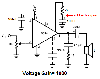

My hard drive shows an LM386 with no capacitor between pin 1 and pin 8 but instead with a resistor in series with a capacitor from pin 1 to ground calculated with a gain of 1000 times above 73Hz. Since it reduces negative feedback then distortion is increased and the high frequency cutoff is reduced.
You have power numbers for different LM386 ICs but at a horrible sounding 10% clipping distortion. Any LM386 produces 450mW into 8 ohms only at 1KHz at a level slightly below clipping with a 9V supply, not 700mW. The LM386 N4 produces 1000mW into 32 ohms (does anybody make a 32 ohm speaker?) only at 1kHz when it has 10% of horrible clipping distortion with a 16V supply. The distortion is higher at lower and higher frequencies.

Does the 1000 Gain circuit work on any LM386 ? I will build a 1000 gain circuit today to see how well it works I hate to waste my time if this will not work with LM386 n-1.
The 1000 gain circuit calls for a 10K variable resistor should that really be 100K?

All the LM386 ICs have a gain of 1000 with the RC shown from pin 1 to ground without the capacitor between pin 1 and pin 8.
All the LM386 ICs work with a 10k volume control when the source impedance is low like from a low impedance dynamic mic or a player.
All the LM386 ICs work with a 100k volume control when the source impedance is medium like from an electret mic.

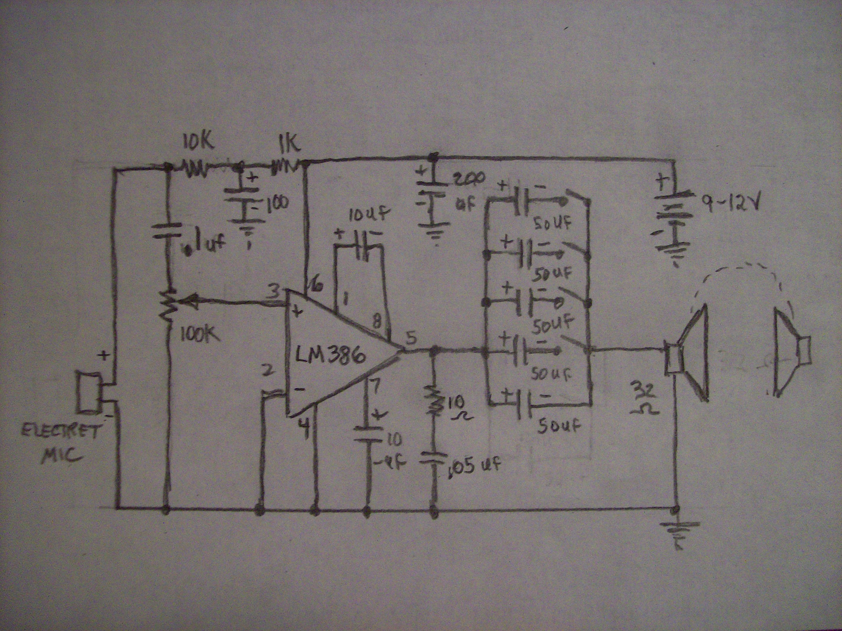

At the bottom of page 4 you show a 3uF capacitor driving one 32 ohm earphone parallel with another attenuated headphone. Then the frequency response reduces the mid-high frequency of 1975Hz and all lower frequencies to sound squeaky. Use 150uF.

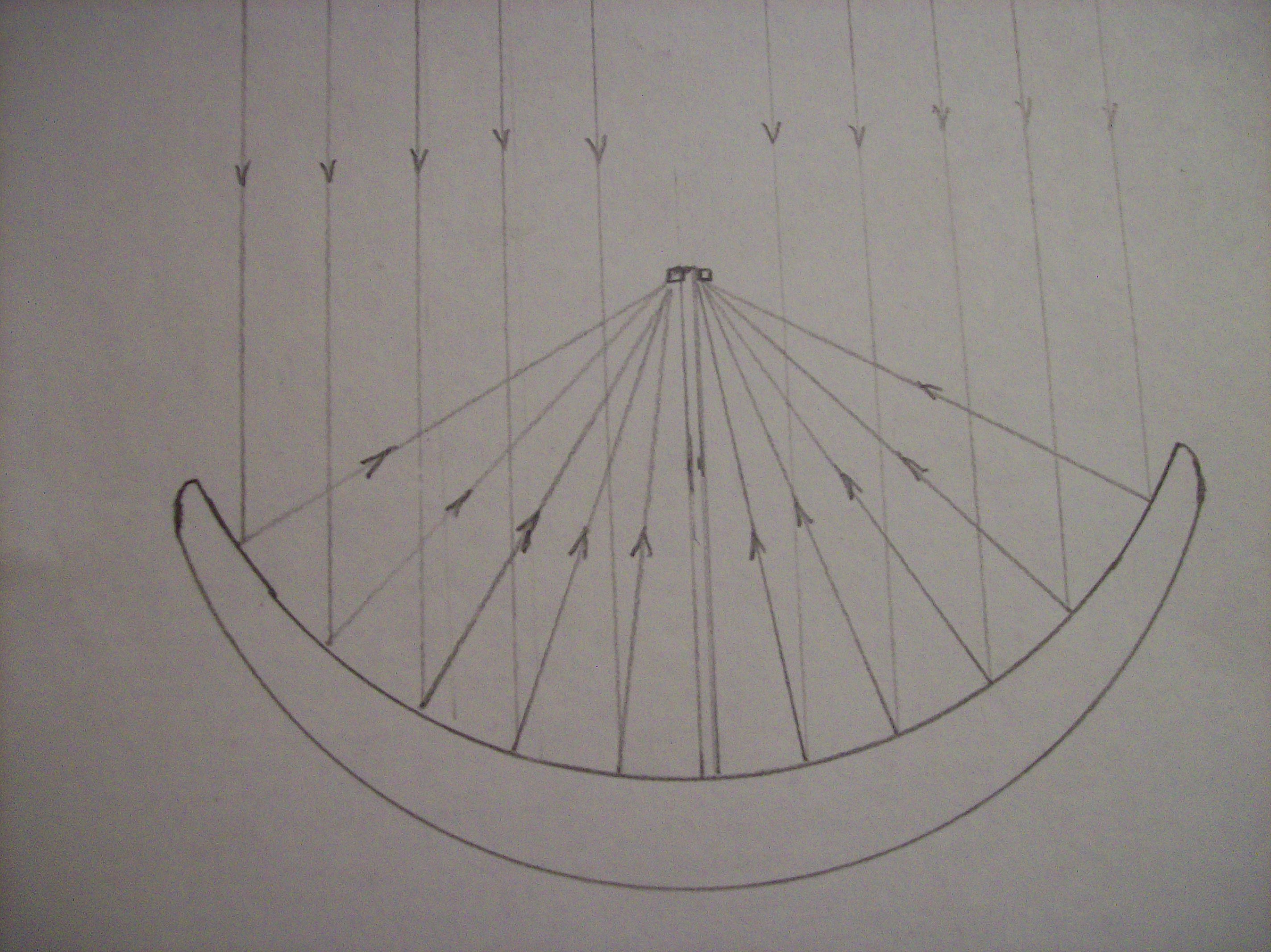

I drew circuit fast had lots of errors, I think errors are all fixed now. I have built model airplane for 40 years I can build a RIB dish that will be strong in 50 mile per hour wind with balsa wood. I will never have it in high wind there will too much noise for amp.
It's not whether the dish is strong enough to stand up to wind forces. It's whether the structure, particularly the sound reflective surface, is acoustically rigid across the frequency range of interest.
You told me to use 2.7uf here is the math you did.
Since you are not listening to hifi music down to 20Hz or earthquakes down to 1.69Hz, then calculate a capacitor cutoff frequency of 30Hz or 40Hz, certainly not 1.69Hz. C= 1/(2 x pi x 30Hz x 2k ohms)= 2.7uF.

1(2 x 3.14 x 30Hz x 32 ohms) = 1/60288 = .00001.658 = about 1.6uf and 150uf will sound better. I though I was starting to understand now I am confused. I experimented with output capacitors the larger it is the better is sounds. A 10uf capacitor makes it sound like all the sound is coming out of a metal bucket.
I have an idea that will make it easy to add and remove capacitors to listen to the sound difference so I came up with 5 caps in parallel with 4 switches to add or remove another cap. Equal value caps make it easier to add up in my head than odd numbers caps. After I finish the 1000 gain circuit I will build this.
