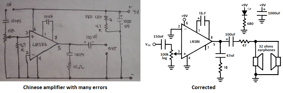

The 4.7K resistor is to make the linear volume control more logarithmic.
I presume the two 100pF capacitors are nothing of the kind?, and presume they are 100nF instead.
The Chinese amplifier or your observations have many errors:
1) The 10k input volume control feeding the 4.7k resistor and parallel with the 50k input resistance of the amplifier produces a total input resistance of 3k which is too low for anything. They probably added the unneeded 4.7k resistor to convert a wrong linear variable resistor into a logarithmic volume control.
2) They used a 100pF input capacitance that is completely wrong since a simple calculation shows that it cuts all audio frequencies.
3) The 100pF capacitor at the output pin 5 should be 0.05uF (500 times more!).
4) The 100uF output capacitor value is too low for a speaker but is fine for attenuated earphones.
I would replace the 10k variable resistor and remove the 4.7k input resistor then replace them with a 100k log volume control. Then a simple calculation shows that an input capacitor of 150nF (0.15uF) would pass most audio frequencies. I would also replace the 100pF capacitor at pin 5 with 47nF (0.047uF).
The output power is too high for earphones and will damage them and your hearing. If they are 32 ohms each then connect them in parallel and add a 47 ohm resistor in series with them as an attenuator.
Your calculation of 4.7k for the LED results in a very dim light, I changed it.
A linear variable resistor is marked "B" and an audio logarithmic volume control is marked "A".

Perhaps you should try reading previous posts?, I already explained all those points in the post above yours, and that Gary has put the wrong values on the diagram. The zobel cap should also be 0.1uF, in my opinion - but isn't in any way critical.
As for the speaker coupling capacitor, I knew you'd comment on that - as you always do - and as always you're 'wrong' to some extent, the amplifier is intended for feeding tiny little speakers, which as they have little bass response doesn't need a large coupling capacitor, and will use less power because of the smaller one.
As for input impedance, it's obviously perfectly fine for feeding from an opamp or similar, but I would imagine it's intended for feeding from a headphone socket (hence the 3.5mm input socket), so is perfectly suited.

Sound is not good. I did not put the 47 ohm resistor in the output there is no easy way to solder it in place. I have 9vdc inverter power supplies but they all have the wrong plug. I have a 12vdc .75ma that I am using. I did not change 10k volume control because I don't have a replacement. With volume turns all the way up I have to talk directly into the electric mic to get sound from the ear phones. Sound is good quality and loud. Mic is not sensitive enough to pick up sound from the TV or me talking 1 inch from the mic. I double checked mic is connected the correct way. 10K resistor is soldered between +9v and the .1uf cap & + side of mic. The .1uf capacitor is ceramic not electrolytic I wonder if that makes a difference. The cap in series with 10 ohm resistor is ceramic too? Sound at ear phones is same volume as me talking.

A 0.1uF capacitor feeding the 10k volume control parallel to the 50k input of the LM386 cuts low audio frequencies below 193Hz so it cuts a man's voice level but passes voices from squeaky little kids.
Also the low value of the 10k variable resistor "loads down" and reduces the output from the fairly high impedance electret mic. Try the amplifier with the 10k variable resistor removed.

The 4.7k resistor should not be there when a proper volume control is used. I calculated a 0.15uF input capacitor when the 4.7k resistor is removed and the volume control is 100k.

Your LM386 circuit has a gain of 200 times. Your TL071 circuit has a maximum gain of 1+ (220k/4.7k)= 47.8 times which makes it a little less sensitive than your LM386 circuit, but its load on the mic is only 50k while the load on the mic with the LM386 is a heavy load reducing its sensitivity.
