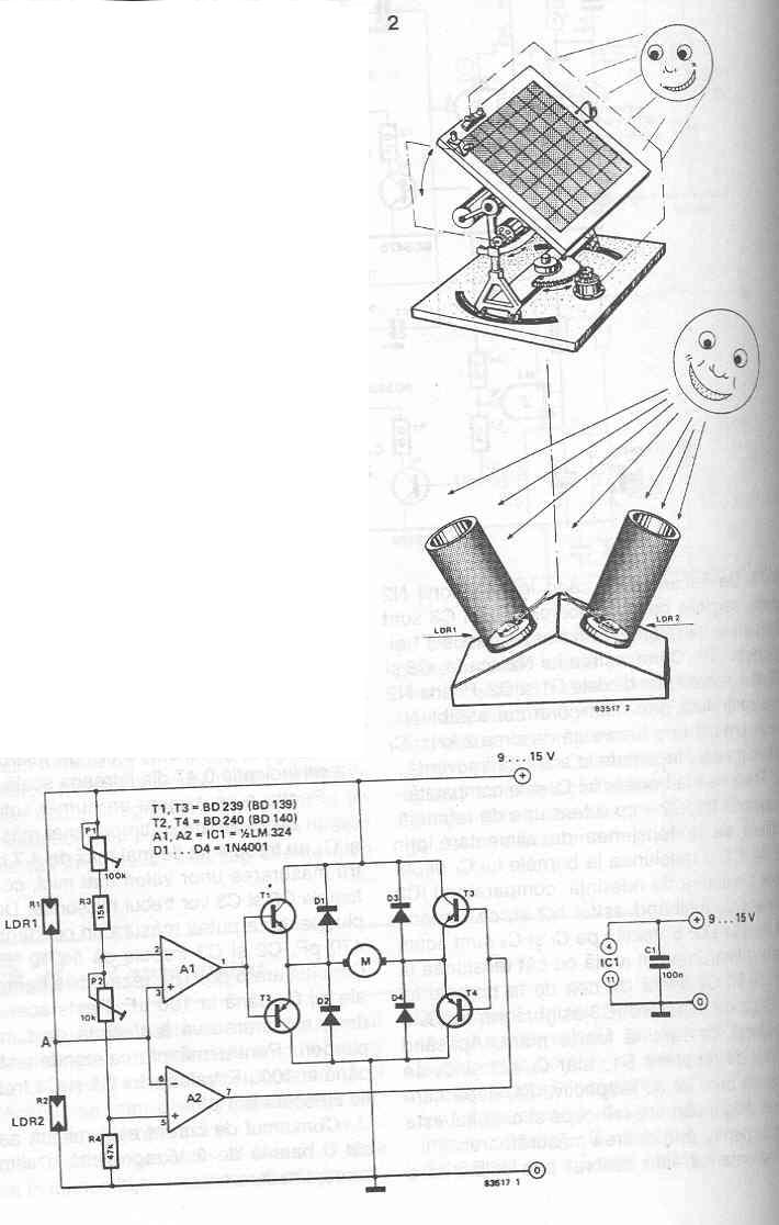

some people requested to post this circuit for the solar tracking system
the circuit is simple. the circuit is a window comparator wich controls the motor until the same light falls on the 2 LDR's

Johnson777717, can you post some pictures after you finish it?
What happens in the morning, when the system has been left pointing West and the sun comes up in the east? It does not appear that either LDR will have light on it.
BTW, nice drawing!
That is an interesting way to do it. I've always seen the control system use dithering. It moves the panel slightly and then measures the power output. If it increased then it moves a little more. If not, it goes the opposite direction.
Yeah, i'll post some pictures once finished. It may take me a while to semi-engineer the mechanics here, but we'll get 'er done! :D

I did some brainstorming on the circuit, to see what kind of challenges might be faced. Here are some challenges that I forsee with the system, aside from the mechanics (PS.: The worm gear idea is great!):
1. Figuring the proper diameter and length of the tubes which house the LDR's. Too little diameter, or too much length, and the circuit may spend it's time adjusting to a light amount that cannot be reached by the resolution of the LDR's.
2.Figuring the angle(Pitch) of the support block which is used to support the tubes. Again, too much pitch may produce a resolution point that is too fine for the circuit to "zero" in on.
3. What is the "A" point marked on the left side of the schematic?
4. Figuring the resolution, or output ohm range for the LDR's. LDR's are sold in different models, which output different ranges of ohms for a given light amount. Choosing which one is right is a challenge. I think I may set the circuit up on a breadboard, and use POTS in place of the LDR's to see what kind of ohms output best suits the circuit.
5. Figuring which type of motor is necessary for the axis rotation. Would a stepper motor be well suited here? Too many RPMS with the improper gearing could result in a system that is not capable of finding the best fixed point, and thus not be able to reach the resolution that the LDR's provide (Overcompensation).
6. Figuring the logic to account for the opposing axis operating simultaneously. For instance, axis A may be in the midst of finding the best light point, while axis B is in the midst of finding the best light point. Thus, will the simultaneous operations send the logic of the device to a point where no real zero point is found, and the system sends itself into a perpetual adjusting cycle? I think there needs to be some sort of switch which allows only one of the axis to find the best zero point. Once this is found, or the switch times out, the other axis is allowed to find the best point. So on and so forth until each axis is satisfied.
Any thoughts?

Johnson777717 said:
Good point Klaus.
I do not think it is that critical, just enough to create a different output from each unless their combined centreline points towards the sun.
Again, I doubt its too critical, perhaps 30 degrees to start with? What's more importantis that there is nothing reflective nearby to upset the system;-)
Just some reference for circuit measurement I guess. It should be exactly half the supply voltage for 'on track' condition.
Idare say that it is not at all critical what range they are, as long as they are reasonably sensitive. The circuit is like a comparator, comparing a fixed input to the op amps to a variable one and wether the variable one is more pos or neg than the fixed input.
I think a stepper motor is way overkill, it needs a dedicated drive board, not the 'H' bridge drive shown. Try an old windscreen wiper motor, they usually have a worm drive ( at least some old ones did). It will also run both ways if you disable the parking switch inside it.
I frankly would not bother to try this with two axis resolution. The mechanical effort is very unlikely paid back in an sufficient increase of output unless you plan to do this on a very large solar panel.
Any thoughts?
Have fun.
Klaus

Does the whole control and steering system consume more power then it gains from increased solar cell output? If so what is the point, just keep it fixed and manual adjust the declanation a couple of times a year. I guess it depends on the size of the solar array being manipulated.

I recently built this circuit, and it works nicely. The only question I had for my self at the time was how to make it go back east and the answer I found was a simple curved mirror I found in the junk pile. I just place it by the east sensor in a manor that will start it rotating east, and by the time the reflection runs out the tracker finds the sun.
