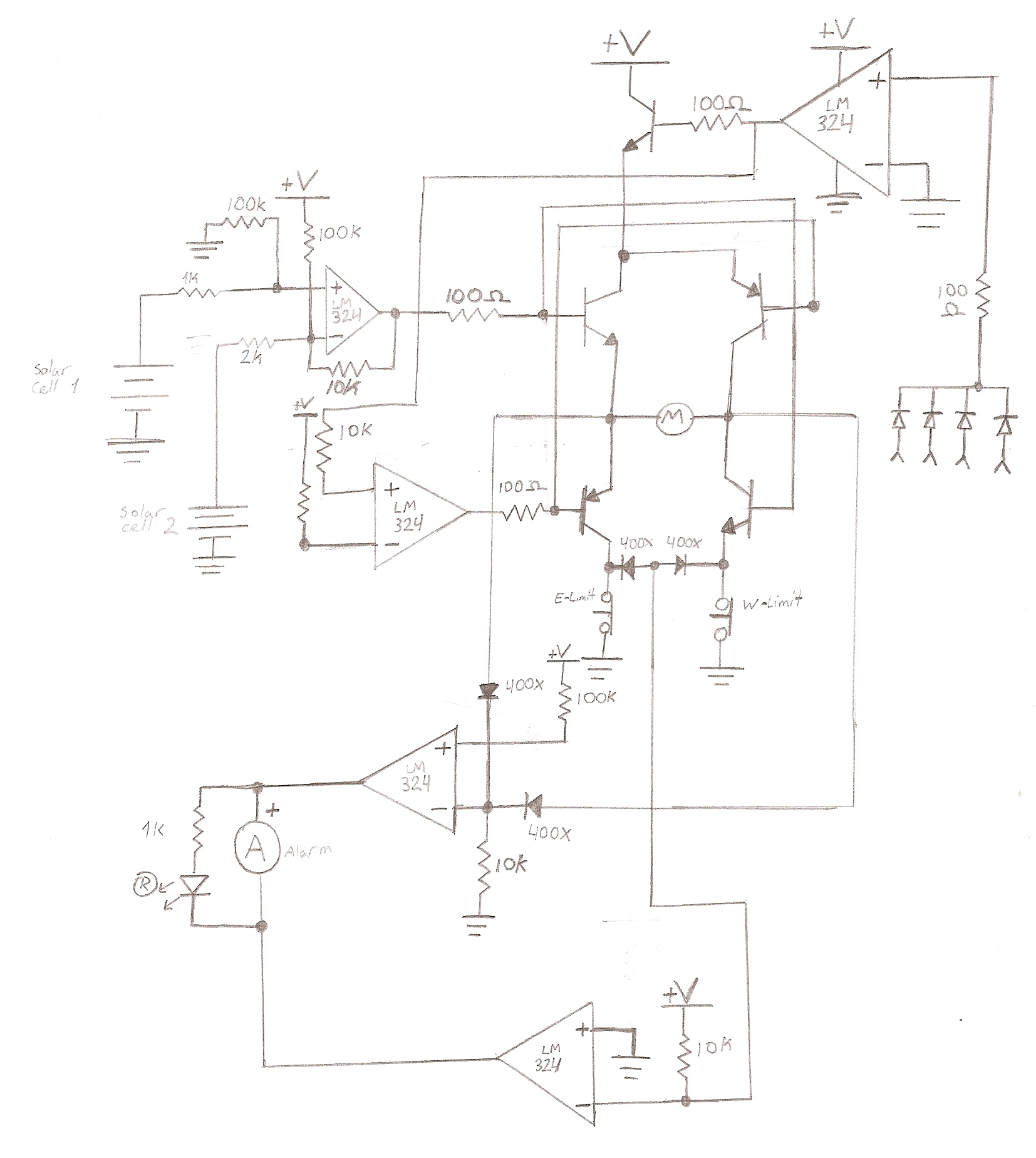

If you don't mind I'm going to post my circuit of a solar tracker. It has a variable voltage on the motor so that as the sun moves, it will modify the voltage by either sinking or sourcing more current to the motor.
Here is the circuit that I have come up with, I tried to work out some of the design flaws, however there are likely to still be some more issues. I haven't had the chance to test it yet, I'm working on my own thread. If you find any issues, the just correct them as needed (by the way, this one has a return to east function built in).

Is there anything more beginner-friendly that we can use to replace the BAT54, as I just got 20 of them in the mail today and was amazed at how small they were?
What I did to allow me to use it on the breadboard is just solder wires to the 3 leads (only needed to do it for 2 leads), but that was a huge hassle because of the size of the BAT54S. Currently I've wired the entire circuit on the breadboard but I left out the BAT54S as I knew the circuit would still work without it, but it helps protect the motor, so that's just temporary, but so far the circuit works fine. I will be installing the BAT54S in the circuit in a moment to see how it does and get back with you, but it would still be great if we can find a larger component that gives the same effect the BAT54 gives so it's easier to work with.
Although the 1N4148/1N914 isn't a Schottky, it should work in this circuit in place of the BAT54.

No need to worry about the actuator. BAT54 is to protect the transistors, and is only needed if the comparators aren't hooked up right.

I have an idea for your circuit, if you want a return to east function, tilt your photocells about 45 degrees away from each other, and your circuit will return to east in the morning once there is enough light for the circuit to work properly.
You could also add a resistor to your compartor that senses the light for the east solar cell to make it think that it is lighter on that part of the circuit.
If someone would please explain the schematic for me, then I can understand it and help you a little more.
