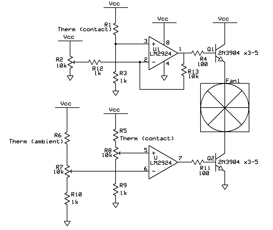

I have made the fan for the circuit if your still interested in it. It doesn't even interact with the solar tracker circuit, it does it's own specific duties (with relative efficiency). You can even add a simple solar activated circuit to turn the fan and the IC's off at night so they do not waste power. The circuit can be arranged for several different configurations, but this is the best because it will cut the power to the fan if the fan is not needed. It will differentiate between the temp of the heat sink on Q4 and the ambient temperature. R2 is to adjust the speed of the fan. You can use any op-amp with this circuit, but it must be an op-amp. R12 can be replaced with a higher resistance value, but the gain will not be as high as it is currently set to (a gain of 11). If you have any questions just ask.
