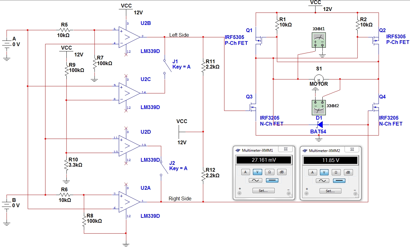

U2 C/D shut the motors down when it is dark. You cannot depend on U2A/B to be "off" when both inputs are 0V.
So how about this idea mneary:
What if we placed a limit switch on both outputs of U2 C/D that becomes activated once the solar tracker has returned as far east as it can go and hits the limit switch.
Once it hits the limit switch, this turns back on U2 C/D which as you said, shut the motors down when it is dark.
When it's light again, U2 A/B will move the solar tracker off the limit switch again once the tracker starts following the sun again, which in turn, deactivates the limit switch (deactivates U2 C/D), and once it is dark again, returns back east until it hits the limit switch.
Refer to the image below I quickly sketched up:
The limit switches would do the job of stopping it before it got too far. I'm not understanding how the circuit would seek East in the morning.
Well correct me if I'm wrong, but doesn't U2 A/B determine rather or not to turn the solar tracker left and right? The only problem they have is, if it's night time, you cannot depend on them stopping the motor from searching for sunlight at night.
So as long as U2 A/B are still active this whole time, the tracker can still follow the sun east or west in the morning time. My understanding is, U2 C/D's job is just to prevent the dark issue of the motors running, thus my reason for picking around with it's outputs. :)
Okay, so here is my new implementation which may be wrong, but from the virtual test performed, in theory it seems it would work correctly, however, I remember mneary saying in order to see what is fully going on I need to hook up the Multimeters across Q1/Q2 to see if they are turning on and off which I haven't done yet.
Note that I couldn't find the limit switch symbols in multisim so I just used 2 regular switches. That's the only thing I changed in the circuit was placed two switches on the outputs of U2 C/D
You would place one limit switch from the output of B&C to ground and the other from A&D to ground. Remember, you won't be at both limits at the same time.

Okay I didn't really try to comprehend your post the other night because I was tired, but after re-reading it, I'm not quite sure I understand why we would want more than 1 limit switch in the circuit?
As in the sketch I drew up as you can see there is only 1 limit switch that determines if the solar tracker has returned to the east postion. So it wasn't a mistake that I made when using the same limit switch in the schematic, but rather thinking about it from a constructional point, as when limit switch U2 B/C enable, so should U2 A/D.

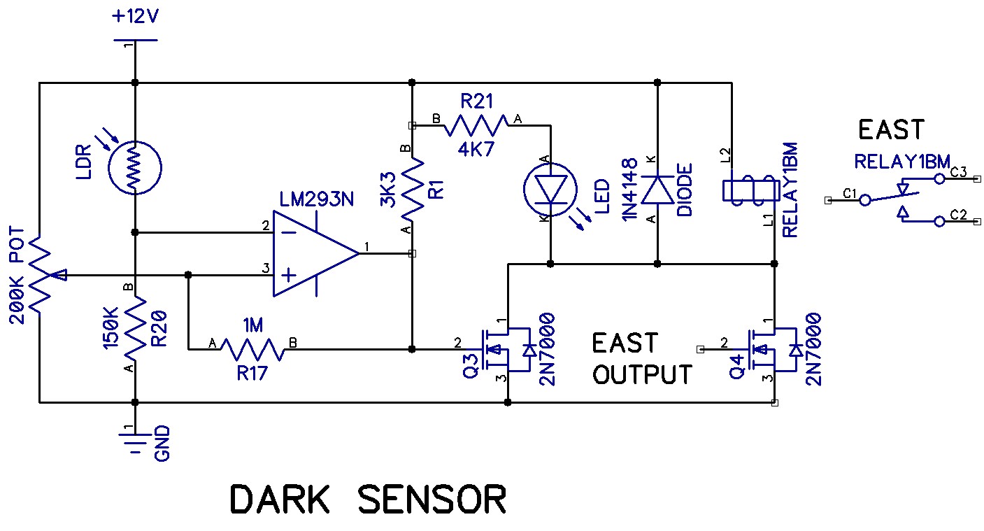

Here's your basic dark activated circuit for the return to East function. It would depend on the limit switch, with a resettable fuse as a backup, to shutdown the motor. I am looking at using signal transistors that will OR together the dark sensor and normal East motor activation circuit. I like the clicking of the spdt relays, and may try them since they are on hand.
Yeah the only problem I has is how to implement it into the current design. We're so so so close to creating a single axis tracker, but I'm still not sure how to implement your design (dark sensor) nor mneary's at the moment.

If you have an extra comparator and ldr (or photodiode) laying around then breadboard the Dark Sensor circuit, less the transistors and relay stuff. Have the comparator output light an led for confirmation of the dark state. Now you are ready to OR the output of the Dark sensor to say the East (U2A/D or U2B/C?) output. Please refer to the LM339 data sheet for OR'ing outputs, it is very simple and clear.
I am thinking that the East output and the output of the Dark Sensor should have 1n4148 diodes so as to not interfere with each other, comments?. Also, how about putting NC limit switches "inline" with the circuits output to the Nfets, as opposed to grounding the outputs? Guessing it depends on best practice, or which type of switches you have (i.e. NC or NO).

It's possible that the dark sensor circuit could be pulled from an existing photodiode. So, just another resistor divider and comparator, haven't tried it that way. For my relay version, servicing a two axis tracker will take 6 comparators ((1) LM239 and (1)LM293), six signal transistors, light sensors, and some passives, not so complex by itself.
