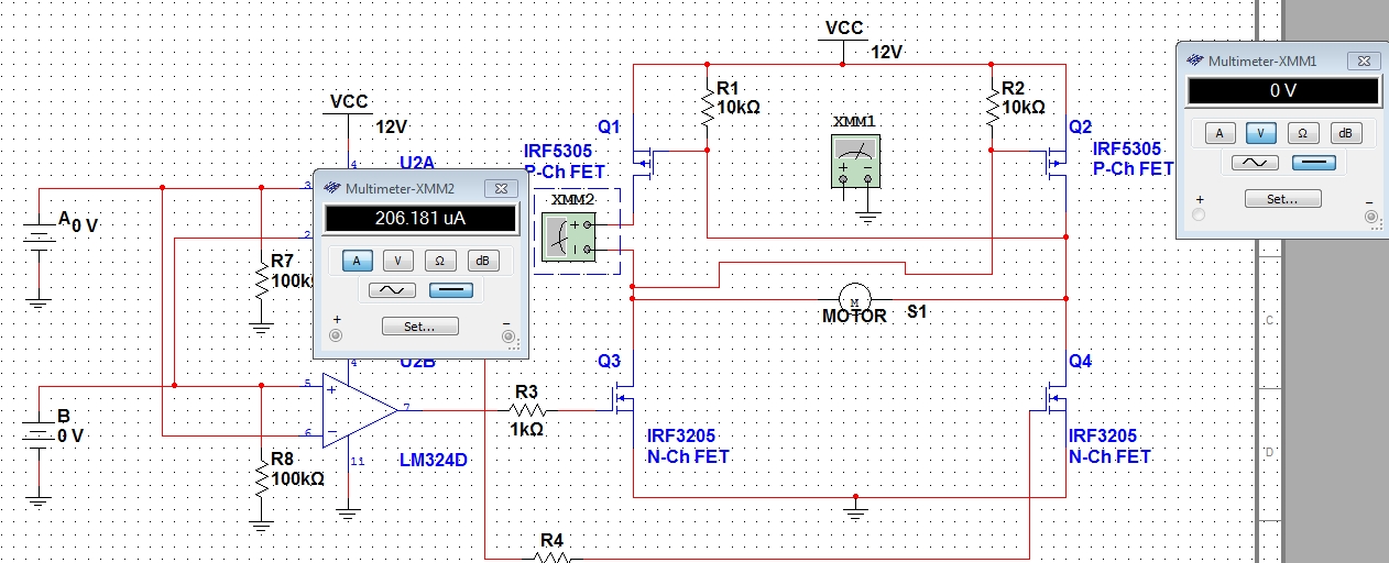

Solar Tracker Circuit Is Giving Me Issues - Appreciate Anyone's Help
Well, right now everything would work except that the circuit doesn't have a definitive state when in darkness. Is there a signal elsewhere in your system that could cut motor power off when there's no solar power?

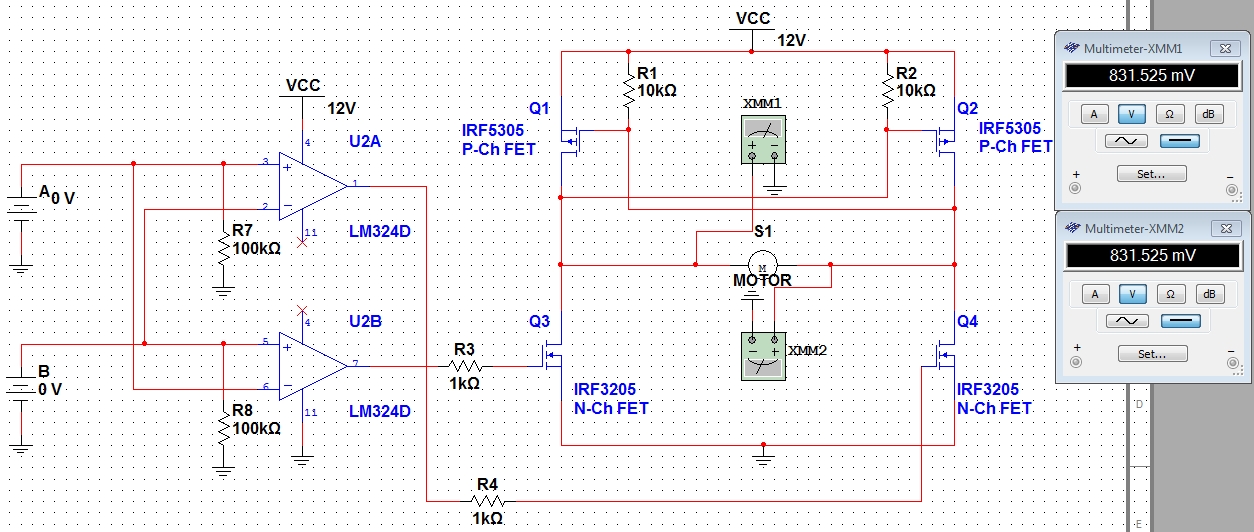

hmm interesting, so your saying from this schematic, Last One, since they are both showing the same voltage that really the motor is OFF, or is the motor working against itself? I mean my logic behind it is like both sides (polarities) of the motor are fighting against each other like they are in a tug of war match lol ?
So if that is true, will that damage the motor over time? My logic is surely wrong but that's what I think of when I actually see a voltage reading, and not two 0 voltages for both digital multimeters when the solar tracker is getting equal sunlight.
The motor doesn't know what the voltage is on any of its terminals. It only know the difference between them.
Ohh okay I think I understand now.
So the motor will never react until it senses a difference in voltage from either side, and if both sides have the same voltage, rather that's 50v from the right side and 50 v from the left side, or 0v from the right side and 0v from the left side, the motor will not move?

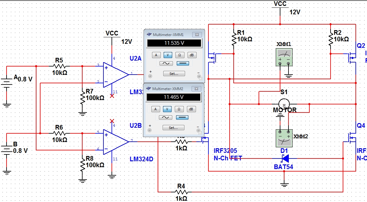

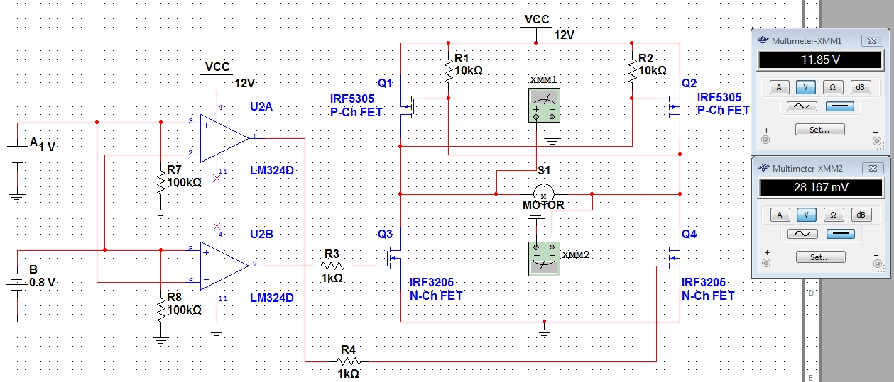

Okay, I made some changes to the circuit, and from a series of test, it's working perfectly, but I believe someone said something about it was wrong, but from my test, the circuit works exactly like we want it to.
A > B
A < B
A = B (as you can see the voltage is the same. That's what we want)
A = B (dead zone, again, the voltage is the same. That's what we want)
Lastly, I even did a test using LED's as it's a lot easier to see what is going on, and again, the test passed with flying colors!
Both when A = B (dead zone & when the sun is directly in the middle of the phototransistors/diode) the voltage to the motor is so low that it will not even turn on (saving power) which is good, and as you can see from short clip I made, the LEDs DO NOT turn on :) .
So my question is, what exactly about this current circuit creates an issue where we need all the other components I had before?

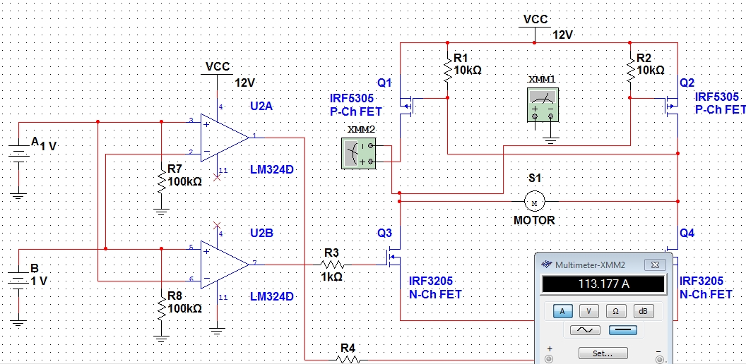

The third case where there's sun on both photodiodes is a problem. You'll find that Q3 and Q4 are both on, which would be OK, but they drive the gates of Q1 and Q2. The reason you're measuring 832mV on both sides of the motor is the N-channel transistors are stronger than the P-channel. But the P-channel transistors are still fighting really hard and are sending a lot of current through. Put an ammeter in the drain of Q1 and/or Q2. You should see 50 amperes going through each IRF5305.
Both nodes being at 11V+ is not a problem because this leaves the P-channel MOSFETs off.
Another problem is logical. The motor will run whenever the light isn't exactly the same, and moves to track the smallest of illumination changes. That's why I designed a range of 0.2V (we can adjust it later) where it's "close enough" and the motor isn't hunting. If there's no stopped range, the motor will jump back and forth whenever the light on one of the diodes changes just 0.05%. This is what the 10K resistors were there for.

ahhh okay...back to the drawing board again I guess lol, but before I convert it back, can you tell me what I'm doing wrong when I'm trying to check the currect on Q1 as I know you have to break the circuit when you check the current, but I can't seem to get it to display the 50A you are referring to, so I know I did something silly in the schematic below:
Okay it seems my multimeter was turned in the wrong direction I'm assuming, but now it's showing like 113A LOL!!:
I'm going to switch the circuit back to the original and check that part again, as I had no idea what you were doing was effecting those two FETs.
