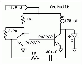

i give up for now. i have done everything. redid the ferrite, re did the whole thing from scratch and nothing works. still only getting 1.5 volts at the LED.

Did you use a flashing LED with the voltage step-up circuit?
When the LED turns itself off then there is no load on the voltage stepup circuit so the voltage skyrockets to a very high voltage that destroys the transistor and the LED.
I hope you know that the two coils must have the proper phase for the oscillator to work.
Did you check the phasing on the coil?
Try swapping either the feedback or driver connections round and see if that works.
Make a center-tapped coil which is easier to wind because it has only 20 turns of doubled folded wire, then its center-tap is obvious, the two ends have the correct phasing and it doesn't need a pcb.

You mean a bifilar winding?
That won't help because the middle tap will need to be broken and the oposite ends of the each coil will need to be connected to each other.

I see what you mean. The two coils must be in series for them to be a single coil with a center-tap.

He wans to combine the LED flasher circuit previously posted with something like this circuit.
I was going to add Bill Bowden's LED blinker's slow oscillator to my solar garden light circuit but I don't think it works without an additional resistor.
When the transistors finish conducting and then try to turn off, the capacitor doesn't help the transistors turn off and there is no timing. So I don't think it will oscillate.
My modified circuit uses a resistor to ground for the capacitor to discharge then charge in reverse before the transistors begin to conduct.
Since the timing capacitor sees both polarities then it should be non-polar.
