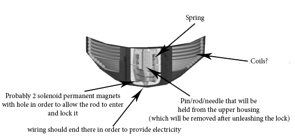

1)First, I am pretty sure that I need a solenoid magnetic latch like the one shown below:
The problem is that I need a customized solenoid magnetic latch because it needs to be small (let's say around 3 cm) and secondly, I want to avoid any cables to be show externally from the housing. So probably I have to buy 2 permanent magnets with a hole at the middle (correct me if I am wrong, I have gaps in electromagnetic theory :) ) and add a spring at the top of them. Metallic rod/needle will be passed through this hole and the magnets will keep this locked.
So probably I have to go the wiring around the magnets+the spring (around the customized magnetic latch) and fit the endings of the cables at the bottom of the housing (but inside the housing).
**broken link removed** **broken link removed**
After that, I have to make an external device where I have to hide a pcb that will allow me to transform it in IoT device and communicate with my app, an rfid reader and a circuit that will be able to provide sufficient current to the cable endings in order to neutralize the permanent magnets and unlease the spring (so this device should have a well made and accurate position on which I have to plug the lockers and to allow them to have electrical contactivity - device male endings and locks female probably).
So when the RFID reader confirms the ID of the lock, I will send a reply from my app in order to allow the circuit to provide current to the lock and done. I provide security for my belongings but mostly is something I want to make it because I liked this idea.
I hope that it is much more clear now to you on what I want to make. Probably I need to buy spare permanent magnets, a spring, a metal housing to place at the bottom the 2 magnets and at the top of them to add the spring + the RFID tag. Then I have to assemble all these in solidworks in order to be able to use 3d printer for lock's housing and for the "unlocker" and that's it.

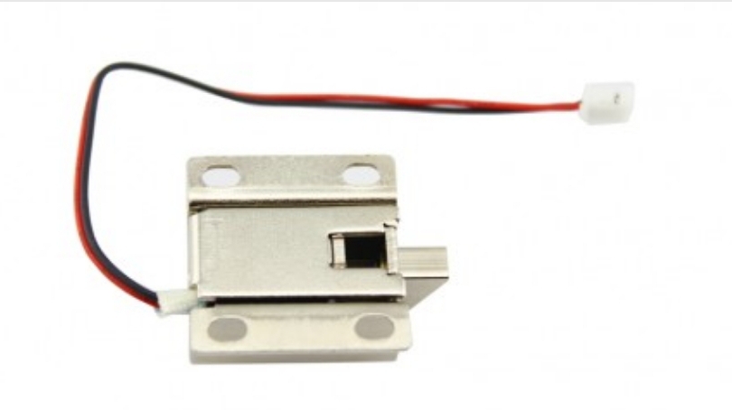

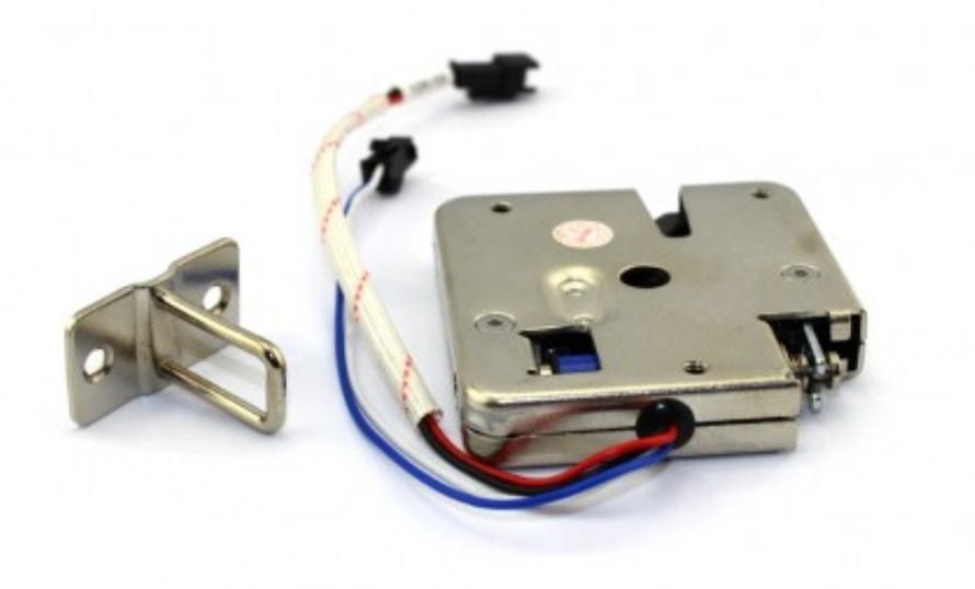

Here are a couple lock mechanisms you may not know about. These are from Elecrow but they're common on ebay too.
Yes mate, I have seen that. The problem is that I have seen a lock mechanism similiar to the one that I want to make by myself. I will send you a photo that someone sent to me (he knows what I want to develop). I couldnt figure it out how it works. I am posting it below in order to have a look to the mechanism and if you know how I can create such a mechanism for my needs
Because of my restricted knowledge on electromagnets, I am not sure what exactly do I need to buy and what to do in order to make this work the way I like.
I will write down my questions:
1)do they need solenoid permanent magnets?if yes, how do I have to place them (regarding their poles)
2)I think that I have to build a customized armature (two permanent magnets,spring + the metal housing for the magnets and the spring). If I am totally wrong let me know
3)Do I need coils around the armature inside the housing? Do I need to connect on magnets (or whatever it is needed) the endings of the coils or I just need to let electricity flow through the coils in order to neutralize the magnets and release the armature?
