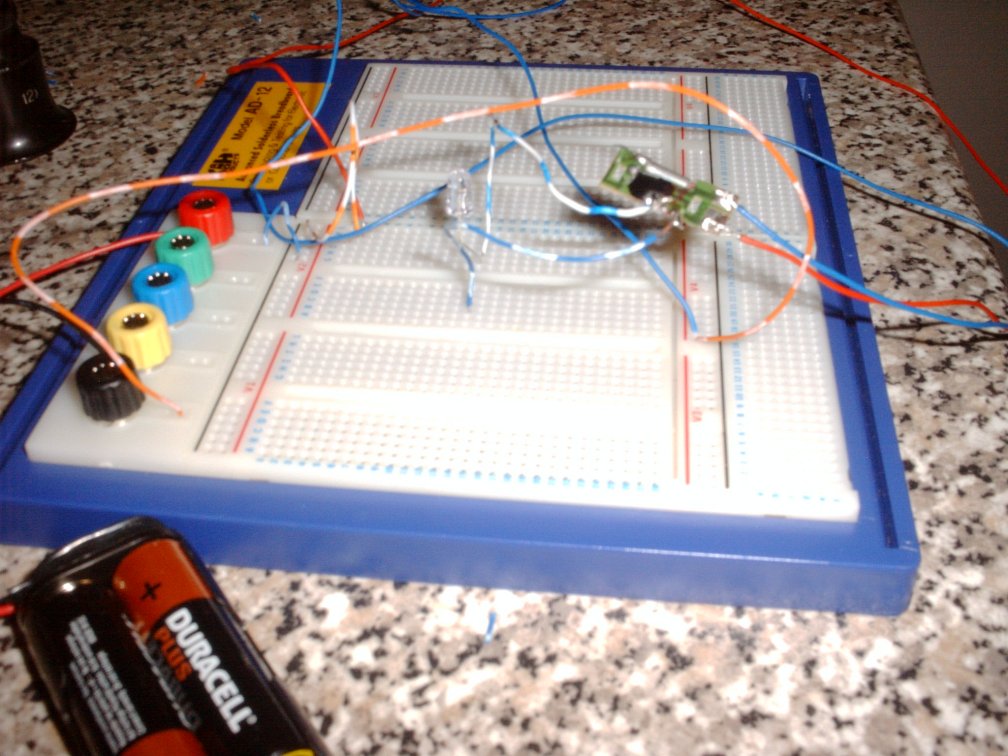

Hello

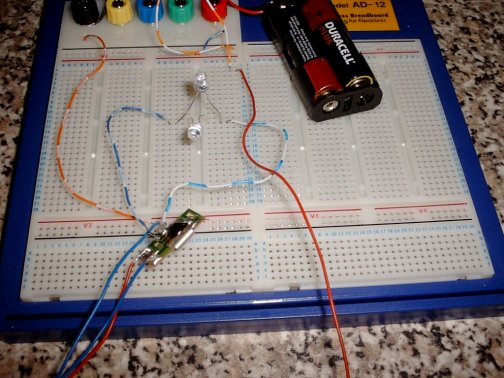

May be off from what you are requiring but while trying to get my head around electronics I decided to take apart a quartz clock movement of 1.5v.
Inside the case of the movement you will find the very small circuit it consists of a watch crystal and all the parts required that makes the clock tick. If you very gently take this out from the housing remembering where the battery connected to the circuit now throw away the case.
You now have the circuit with the electro magnet attached. Gently remove the coil cutting the very fine wires.The coil output can be used to light your led's. You will have to solder wires to the circuit where the battery terminals once touched. solder one wire on each for + and - these can be now connected to a battery of your choise.You will have to solder wires to the circuit where the coil wires were, these can be for the power to the LED's.

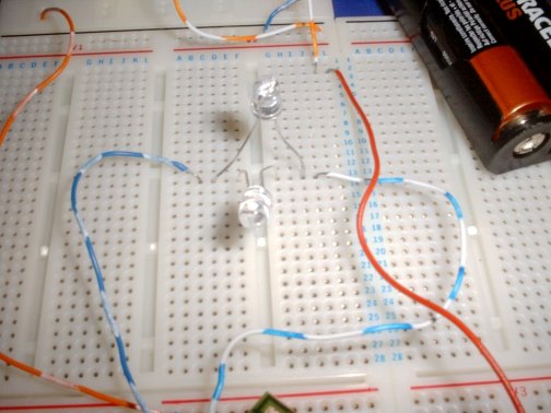

The good thing about these circuits is they are bipolar so you can wire the two LED's up to opposite supply with this you will get one led flashing and the the other.
I include a photo but it does not show much detail. In the photo I only have one led but you can use two wired up opposite to give alternating flashes.
Hope this is of use.If you require any more info please ask.

You will find theirs not very much at all to the circuit and is quite small about 20mm x 10mm The hardest thing is soldering the wire's that replace the coil , the circuits quite fragile and I destroyed three trying ( but i'm not very experienced with soldering) With my demo I wired two led's up in opposite polarity and working from three volts they flashed very happily.
One thing that I also found was while touching the circuit the led's stopped flashing but then started again but they flashed very quickly.I think this was due to static and it effected the frequency of the tiny crystal.
I don't know how small you want to go but this is quite small, don't know what alternative power supply you can use.
Regards wombweller
PS. You can buy many of these quartz clocks on ebay for very little cash and the circuit is already built, it's just a case of is it suitable for your needs
