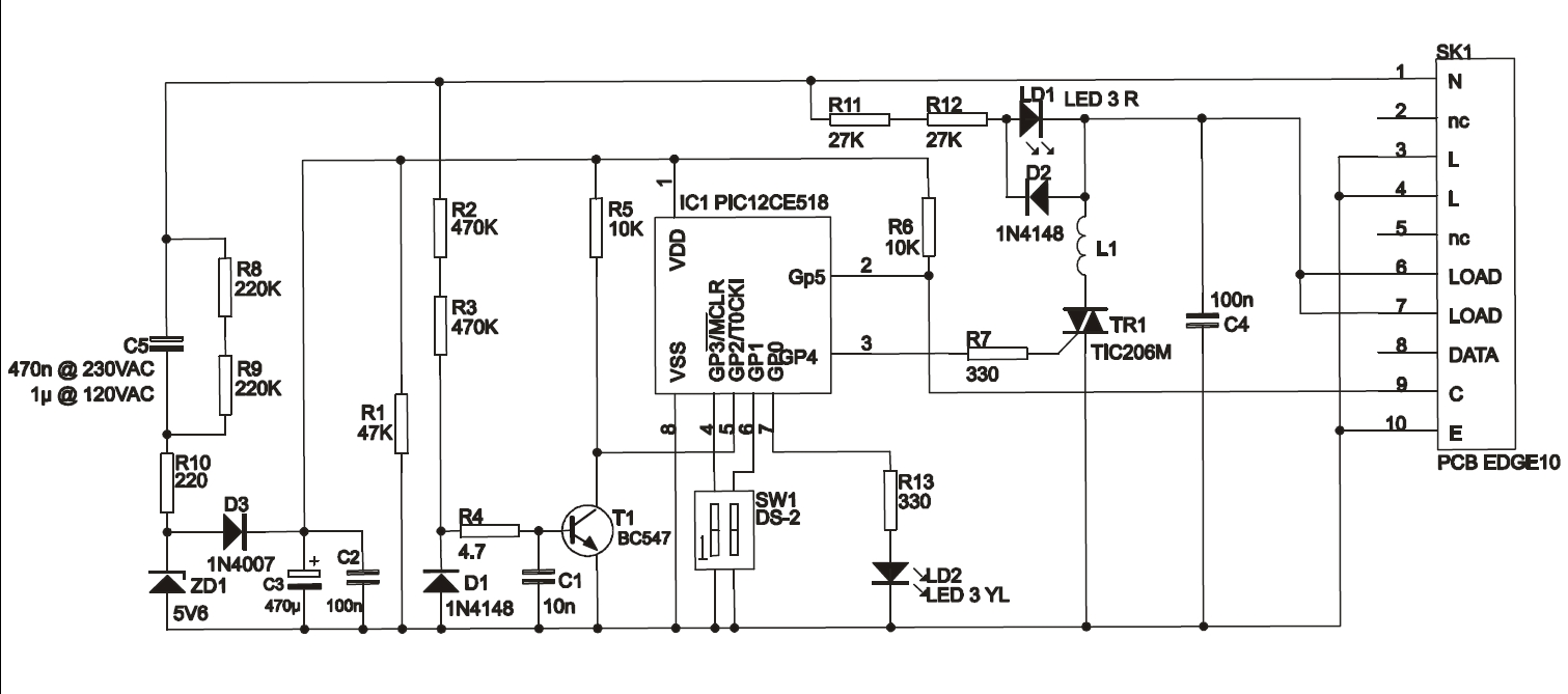

but the main thing I need now, is the circuit that will let me set
a 2 second analog voltage ramp up from .5v -to- 10 volts, run,
then activate a 3 seconds ramp back down to .5 v upon the
closing / opening of a limit switch... I would like this to be
adjustable to within a 2 - 5 second range on each side.
I have found many user adjustable ramp up / down circuits, and
this one so far is perfect in programming design and output pattern.
Welcome to Jameco Electronics! Great Products, Low Prices.
Here is the manula where it shows the adjustable ramp up / down
pattern of output ... ( Page 14 )
https://www.electro-tech-online.com/custompdfs/2009/10/manual_k8029.pdf
but I am unable to figure out how to modify it to be powered with
24v DC ??? and so far even though I have got two emails about
this circuit from the design company, they have not told me yet if
it's output is analog voltage shift, or Pulse Width Modulation ?
but even if it is pwm, I can use a simple "Frequency -to- voltage"
converter to fix that :)... and there are a few OpAmp setups
I have found to change voltage range "A" into voltage range "B" :p
if someone could help me figure out how to get that soft on /off
dimmer kit to be powered with 24v DC I would have that challenge
about 80% done !!!
I have had a good time researching and learning for this project !
and really hope to learn and teach what I can from here ! :)
// Tom \\

I will not be sure until I have the rest assembled and hook up my
resistor bank box to it. but I am not putting much time into that
since I am hopefully trying to convert the Velleman K8029 from
120v AC to a DC Supply ??? ...

I hope to find a way to convert this kit to use in my project.
it is awesome easy to program the ramp up and down settings as
you can read in the little manual ! ( pg 11 )
https://www.electro-tech-online.com/custompdfs/2009/10/manual_k8029-1.pdf
1st hurdle is to figure out where to inject a DC supple between the
existing 120v AC section and the working parts of the circuit.
since it is a micro processor circuit, i am sure it is not a 120v
AC powered MPU ?? :p ... weird ... so somewhere at some
point, the circuit is 5v I suspect. so, here is what I am already
doing...
The 24v DC supply from my batteries is turned into 5v DC by
these very convenient DC Supplies... I always have a few on
hand, Switching voltage regulators - 7805 replacements
so, from my 5 volt supply, where do I power the K8029
Velleman kit with DC, ??? and what parts then can I toss out ?
I have one but I may have damaged the MPU already trying to
extract the AC Supply parts / Insert the DC parts... I ordered 2
more that I should have by friday hopefully :) the next one I
will get DC / AC Voltage Meter readings at every single juction first.
attached is the circuit I need to power with a DC supply... also, the
primary circuit output, at R7 feeding a Triac, I want to translate
into a .5 -to- 10v analog output signal. I don't need the triac :)
// Tom \\
Ok, that manual's a bit more informative than the brochure I saw. I don't have time to work it out at the moment, but you can probably connect a resistor from U3-2 pin 5 to 12V, which will give you acceleration and deceleration control. I'd try a value between 270k and 470k for starters.
Better yet, replace R16 & R17 with 220k. Use a 10k pullup from U3-2 pin 5 to 12V. That should give you roughly equal acc / deacc. rates adjustable up to ~6seconds.
Might not work if you set the speed pot too low (i.e. <6V), but otherwise should be ok..
