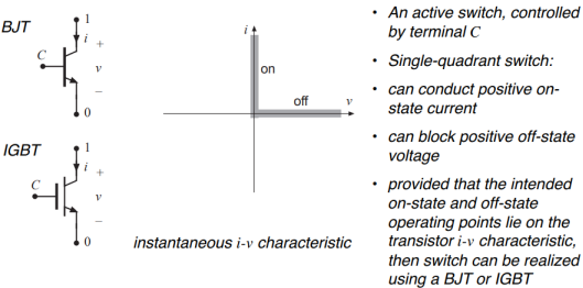

I was reading up on quadrant switches and need your with some points.
I was using this text: **broken link removed**
(or, use Google drive PDF: https://drive.google.com/file/d/168CHus1Rzm4fCViEJdFnOA845f_R3PsN/view?usp=sharing)
Question 1:

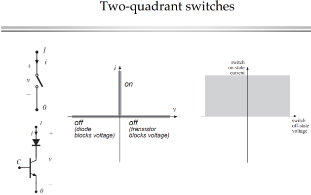

In Slide #8 it says that a BJT is single quadrant switch which can block positive off-state voltage. Does it mean a BJT cannot block negative voltage? The shown BJT is an NPN. In Slide #19 it shows how an NPN could function as a two quadrant switch. Doesn't it suggest that a NPN cannot block negative voltage on its own? Where am I going wrong?
Slide #8:
Slide #19:
(edited after rjenkinsgb post to substitute the correct slide; previously this slide was mistakenly used)

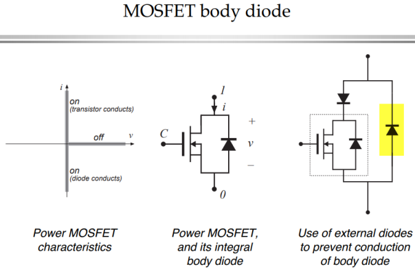

Question 2:
Yes, the body diode won't conduct but the diode in yellow would definitely conduct reverse current. So, what's the purpose of bypassing body diode?
Slide #14:

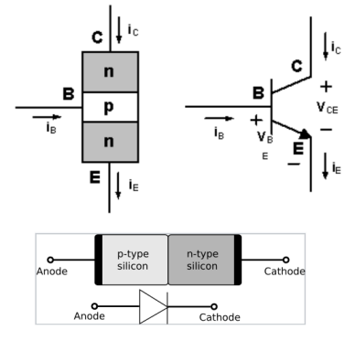

Back to the original question:
If you reverse the voltage across a bipolar transistor, current would flow through the collector-base junction as if it's just a simple diode. An external series diode prevents that.
