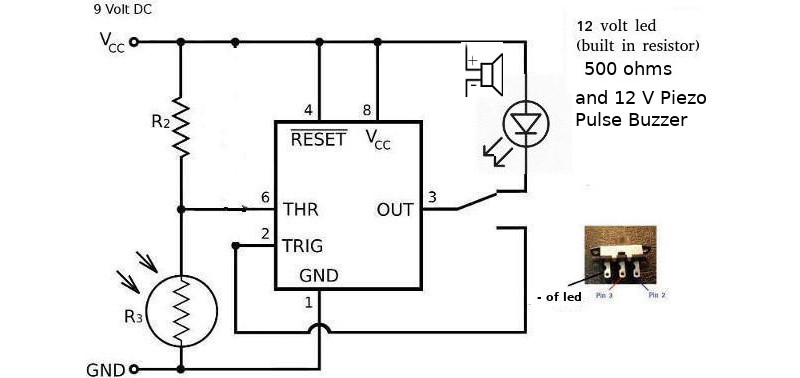

Please post your circuit diagram.

I did the best I can with Gimp. I am looking for a circuit drawing program for Ubuntu.

This thread is about a pot but your schematic does not show the pot and does not show how you connected it.
Resistor R2 does not show its resistance.
Pin 2 is the trigger pin on a 555 but yours is connected to nothing. Interference picked up by the pin 2 wire might trigger the 555 to turn off the LED and beeper.
Pin 6 is the threshold pin on a 555 used as a timer but yours detects darkness to turn off the beeper.
The switch does not turn off the circuit, just the LED so the battery will slowly run down.

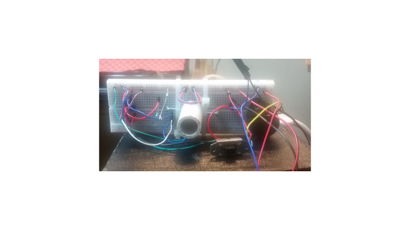

I put a piece of PVC pipe around the LDR. It stopped the sunlight from having a detrimental effect.
But then it is overcast. I will test it when the sun comes back out.
If it has trouble in direct sunlight, painting the inside of the tube with flat black will help.
