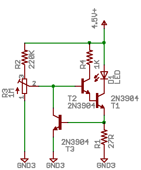

You can if the pot is designed to handle the LED current. Most carbon "Audio Pots" are not and will go intermittant after a while. To get around this, you can use the following circuit: (I didn't put any resistor values in there because you don't mention what voltage your supply is)

Thank you this is currently how I have it set-up. Unfortunately I won't the pot to serve as a switch as well and cannot find anything small enough. Any recommendations on where to get a pot switch that can handle the LED?
If you use a 1M pot and a 6V battery then with the pot turned down the current in the pot is so low that a battery will last for a very long time, it shelf life. The transistor will need to be two connected as a darlington or use a darlington.

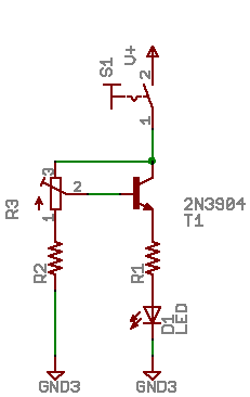

The only problem with a 9V battery is that it won't light your LED for very long. (About 1/20th the time as 3AAs). Here is a circuit that'll work from apx 3.5-5V. It's a little more complicated that the previous one but will give you better brightness over the life of the batteries. The max LED current is apx 20-26ma (At low currents Vbe will be 0.5-0.7V) and is set with R1.

The POT feeding the transistor is probably your best bet.
