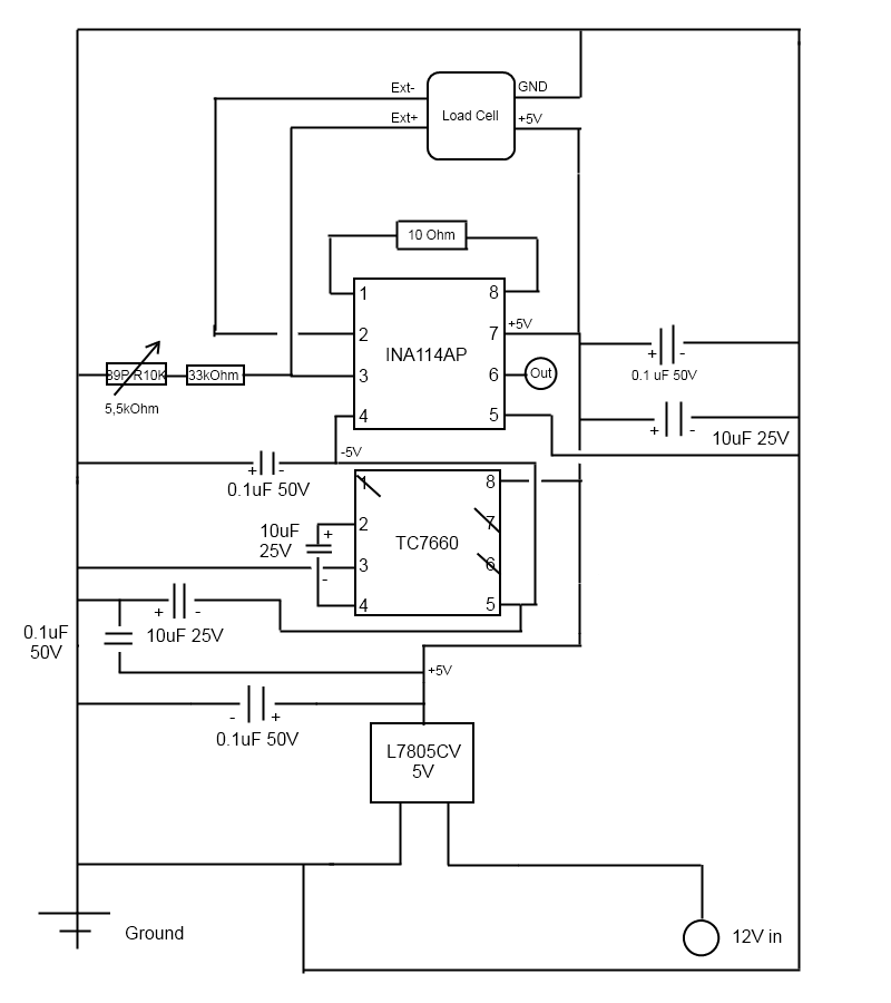

Simple load cell circuit with Ins Amp output to arduino.
The working schematic is wrong, it's very tightly put together so it's hard for me to see where do the legs go, i'm inspecting the circuit closely again to draw more accurate schematic.
Resistors on Vin+ are 10K ohm one (set to 5,5K) and a 33K ohm.
I'll check the voltage on monday, i don't have the access to the load cell at the moment.
The original schematic is wired exactly as shown.
Ok, i've corrected the schematic, and i found out that i've falsely wired the schematic. With this circuit:
i'm finally able to get proper readings from load cell. But now i have a different problem, the 106 tantalum capacitor that goes between pins 2 and 4 on the 7660 starts to smell after a while and has already changed colour to a bit darker tone.
I don't want the circuit to fail soon so i'm thinking of replacing the 7660 part of circuit with 2 diodes, is this still possibile, and what would the circuit look like?

Same schematic as in post #22, the gnd is from arduino and instead of 12v it's the 5v that arduino supplies and out is connected to analog0 pin...
Just failed, leds turn on when it has power, but is not recognized by any pc using both Windows & Linux
Your circuit in #22 is incorrect.
The load cell excitation should not be connected to the IA amp input, but to the 5V/0V supply.
The L/C output common mode voltage at the IA input should be ~2.5v.
The 10K pot and 33k resistor are a simple way of nulling a L/C offset, in one sense only.
As the IA is powered by +/-5V , it is possible that the IA output to the Arduino could swing negative. This could bias the clamp diode in the MCU to be biased 'hard on' which could damage the ADC input clamp,

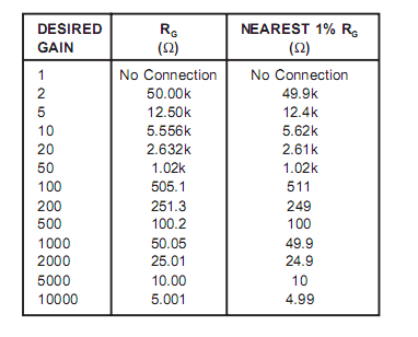

BTW: with a 10R on the gain pins the gain is ~5000.!!!
What do you mean, it is connected to the 5V and GND...

the Load cell i'm using has 120ohm bridge, so i need to use 10ohm gain on IA to get decent values.

Your diagram clearly shows the excitation points of the bridge connected to the input of the amplifier, the excitation of a bridge should be connected to the supply voltage

As the 'variable resistance is connected to only one input of the IA, means its only across one arm of the bridge. which means you can only reduce the effective resistance of that bridge arm.
The IA output is always 2.90V - 3.10V now no matter if the load cell is pluged in and stressed or not.
The output of the IA, with Vref connected to 0V, if the bridge is correctly balanced, without any load, should be close to zero volts.
The value of the bridge arms [elements] has no effect upon the gain setting.

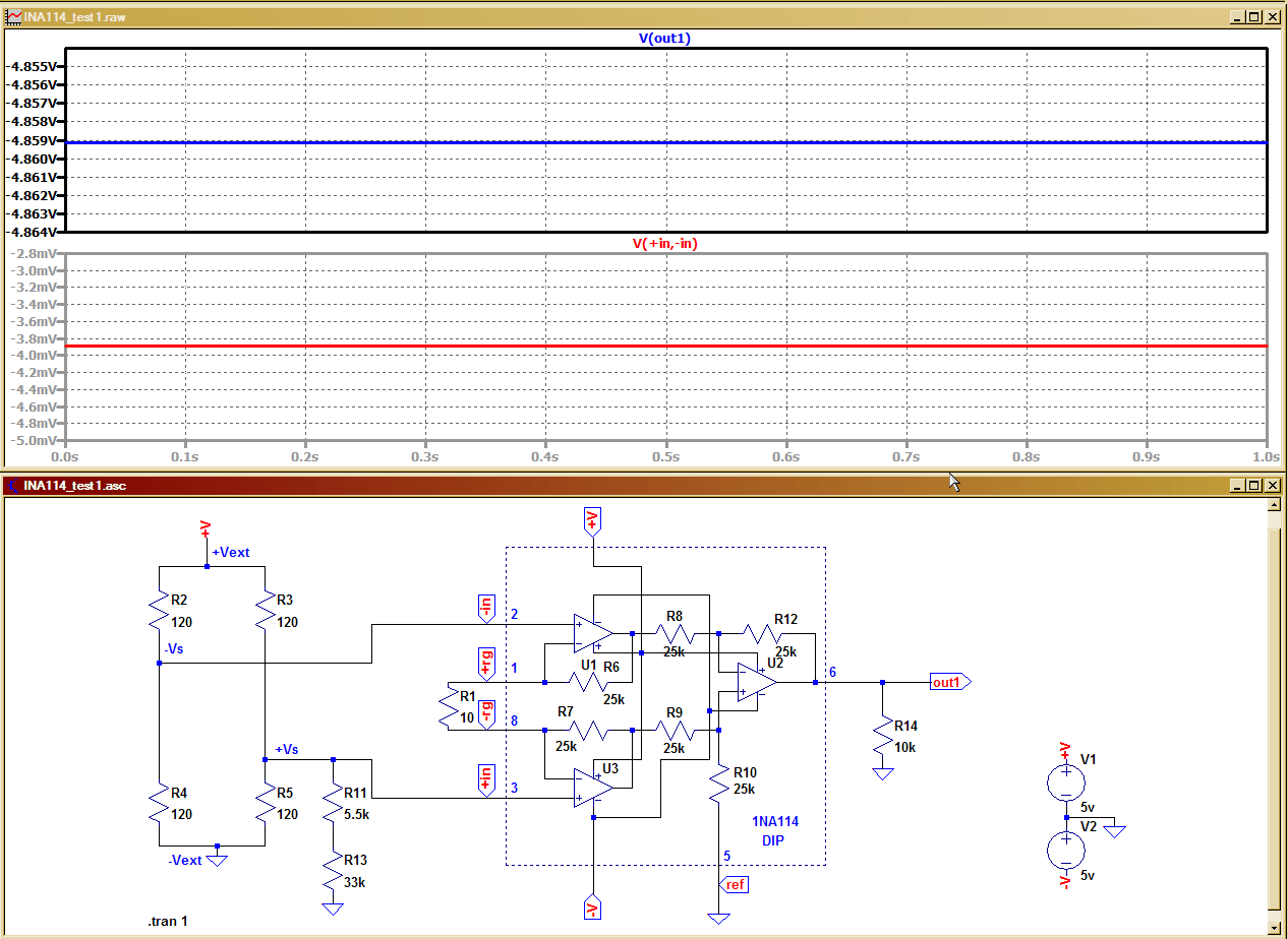

This is a LTSpice sim of your circuit, I have modelled the 1NA114 [ its inside the dotted box]
Figure #1:
With the 33k and 5k5 Pot connected the inputs signal is -3.9mV which drives the IA into negative saturation at ~ -4.8V.

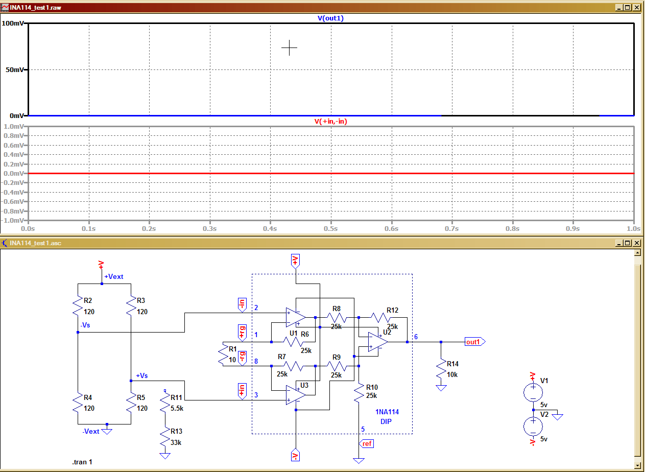

Figure #2:
With the 33k and 5k5 disconnected the IA output is zero volts, which it should be.

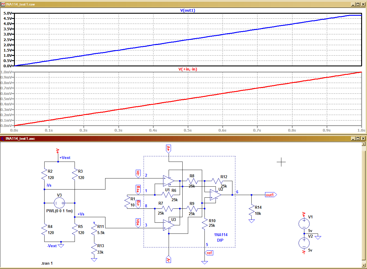

Figure #3:
With V3 source simulating a 1mV input signal, even at 1mV input the IA is driven into saturation.
Reduce the Gain and remove the 33K/5k5 and remeasure Vout.
TIP: keep the bridge connected to the IA input, then add a shorting wire across the IA input pins, the IA output should be close to zero volts.
