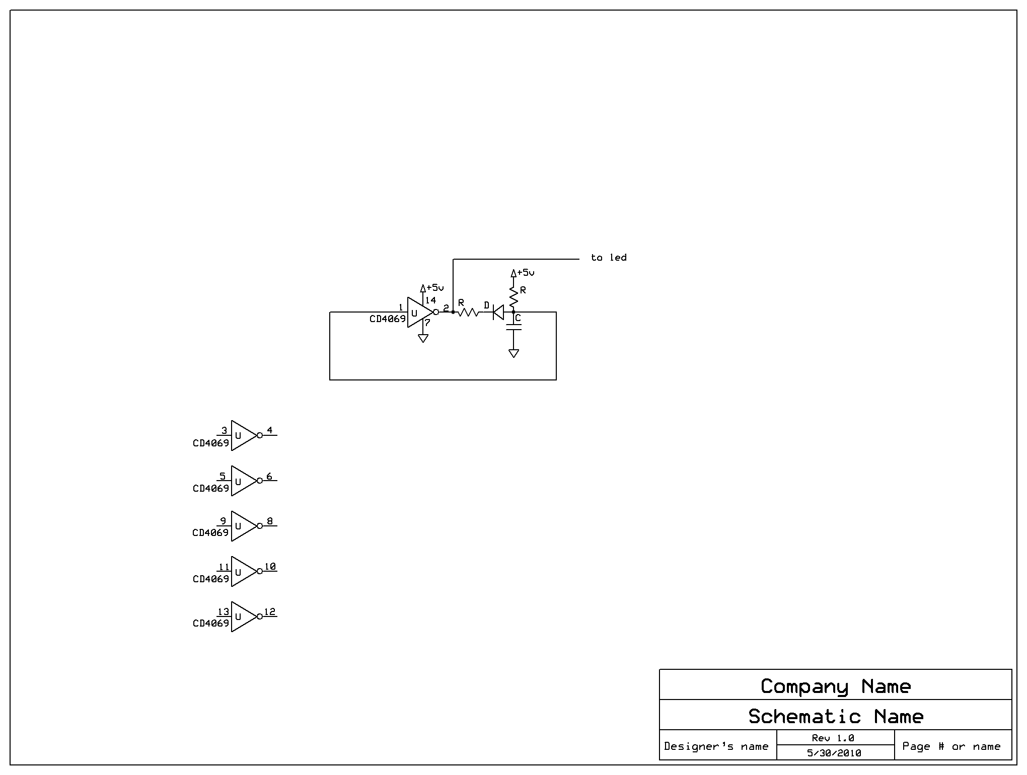

I've been trying to design a very simple repeating timer without an IC555. Unfortunately, I'm not versed in electronics enough to fully design it myself. The concept is similar to an astable multivibrator and goes like this:
A cap charges off of a battery, and as the capacitor nears fully charged, the circuit switches and allows the cap to discharge through a secondary device (LED, relay, etc) until the capacitor is discharged. The circuit then switches back to charging the cap.
Any help would be appreciated.

Osc.
Attached is an oscillator circuit you can tune up.

The 555 helps with this, by choosing dependable "discharged" and "charged" decision points at 1/3 and 2/3 of the power supply voltage.

Dkaine, what's with the attitude, mneary isn't trying to win an argument he's trying to point out a misunderstanding you seem to have, which I did as well in a private meesage. The 555 timer is probably one of the most common flexible and useful IC chips you could ever learn to use and for basic timing circuits like this requires less than a half dozen components. Apparently you'd rather insult experienced users here rather than listen to advice and look this up on Google yourself though as there are literally thousands of circuits already in existence fully described with component values that do exactly what you're talking about. The inverter based circuit that ronv posted will also work but is more limited.
