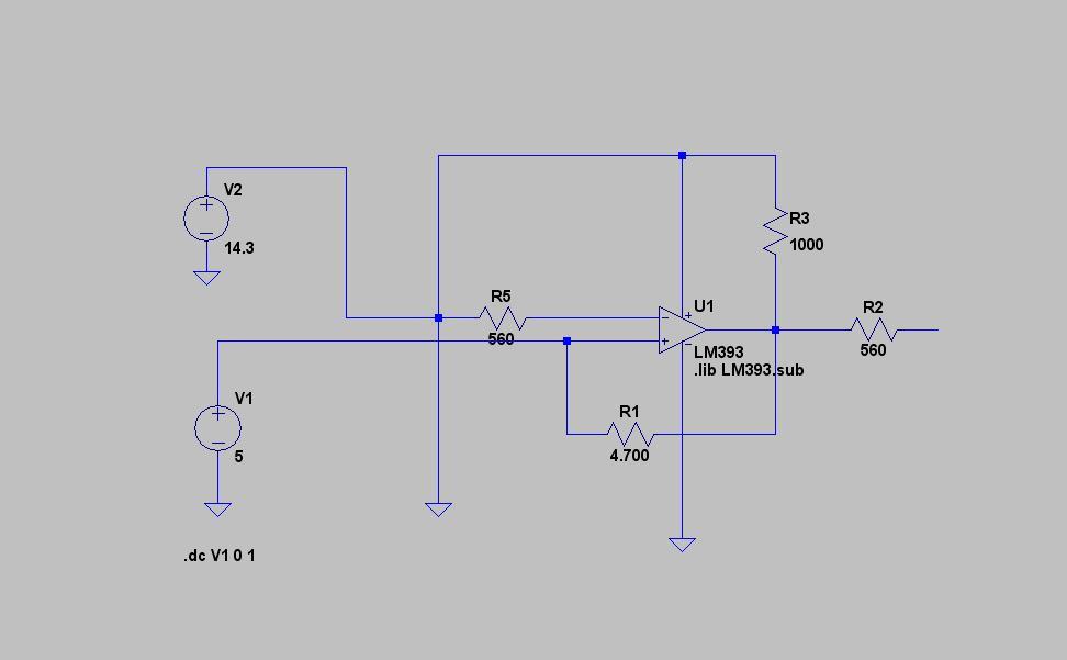

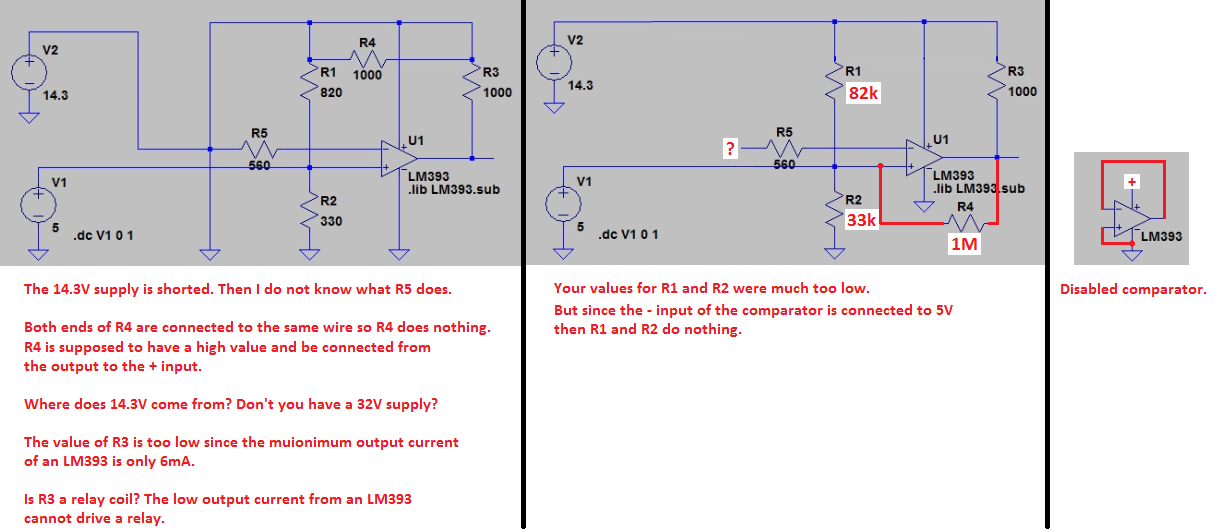

I do not know what the comparator will drive.
You made many mistakes on your schematic that I fixed except for R5.

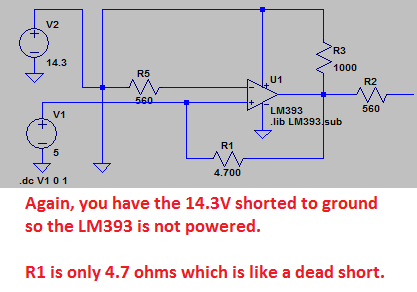

Comparitors usually have open collecor or open drain ouputs, so thay can't source current. See the datasheet here: https://www.google.com/url?sa=t&rct...=ZFfSvCgmjZNjfhsK0J5DSw&bvm=bv.78677474,d.cWc
You have to design for 6 mA or the minimum sink current thats guaranteed.
Disabling, basically means you should pick inputs which would result in 0 output in this case. Because of the high input Z, you should have the comparator inputs somewhere. Vcc and ground would be fine, but you would RATHER the output transistor to be off, not on. Usually a resistor is inserted in series with the In+ and In- lines as well. Whatever you have handy or used elsewhere in your circuit, e.g. 10K
As it doesn't go to the output, then no it's not :D
Connecting it properly to the output would work, but your resistor values all seem rather low?.
Have changed the circuit as below.
When i run it and use the red voltmeter to take measurements i only have 1v ?
What have i done wrong? I think it has to do with ltspice config...
Your circuit is still completely wrong:

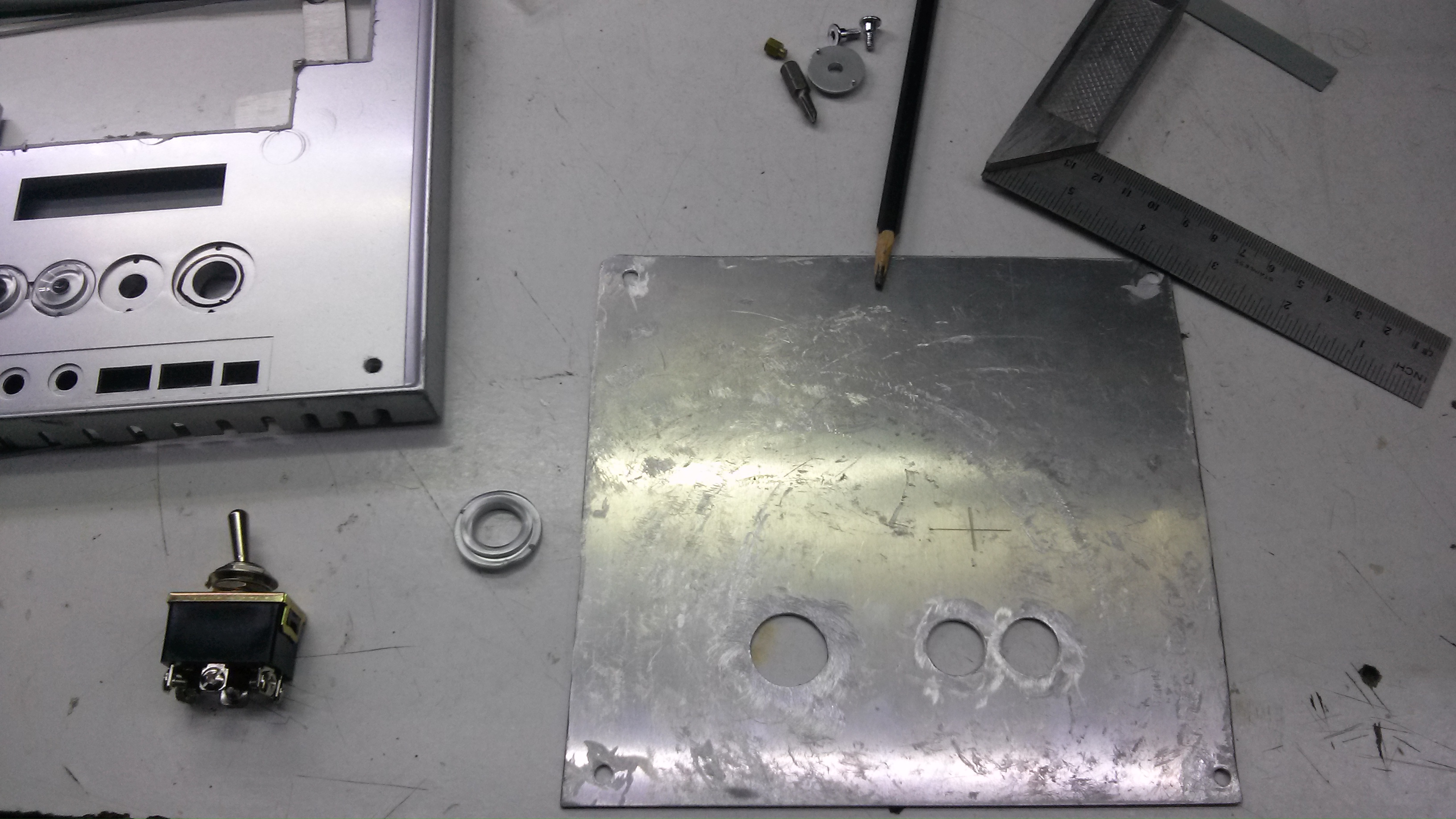

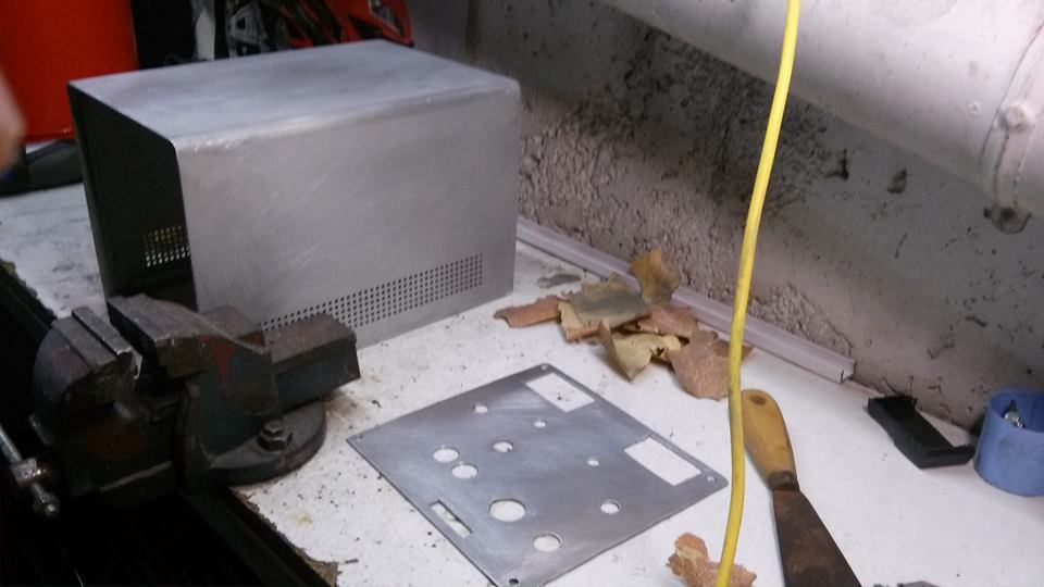

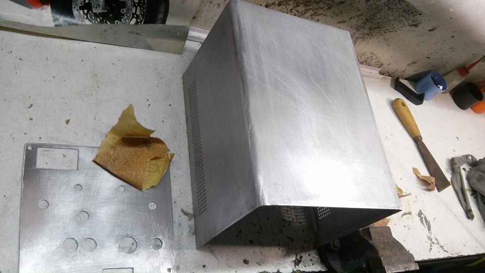

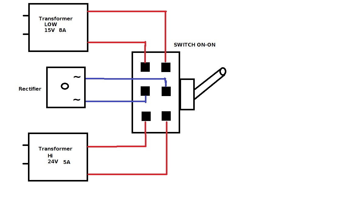

So as i have described at earlier post i will use the switch for low and hi voltage transformer.
Below is a little progress i have done with it today !

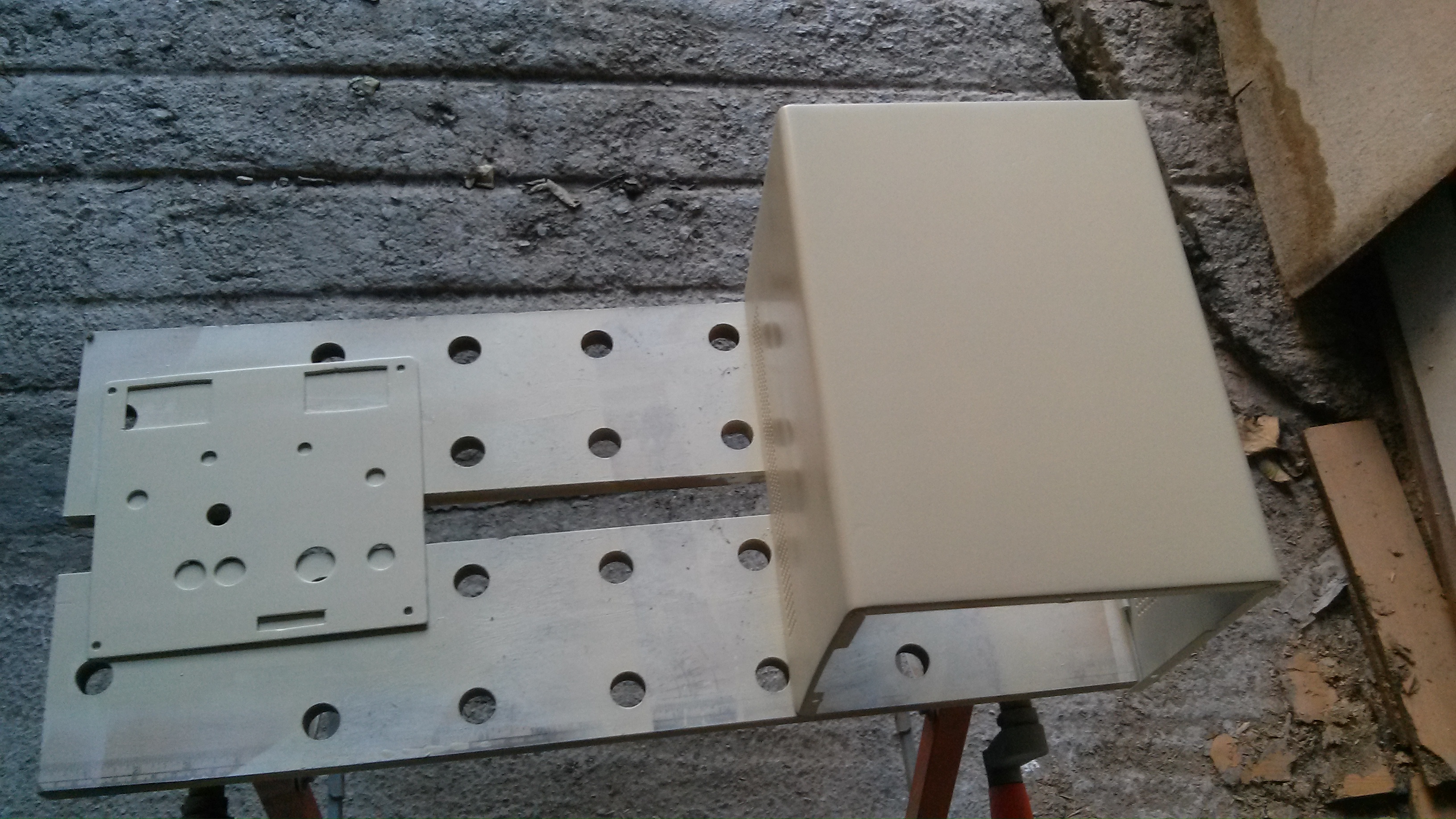

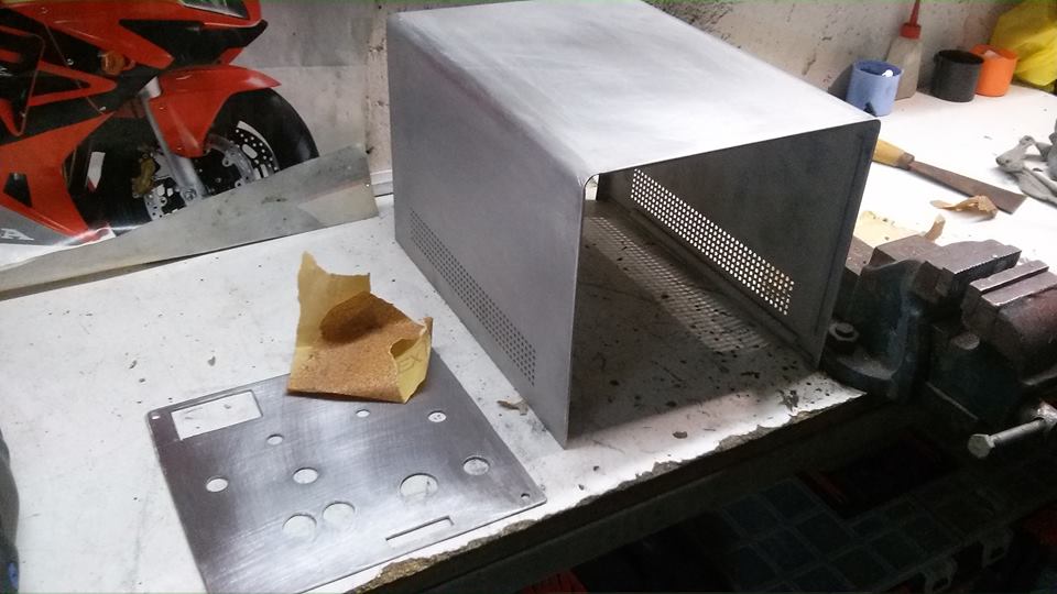

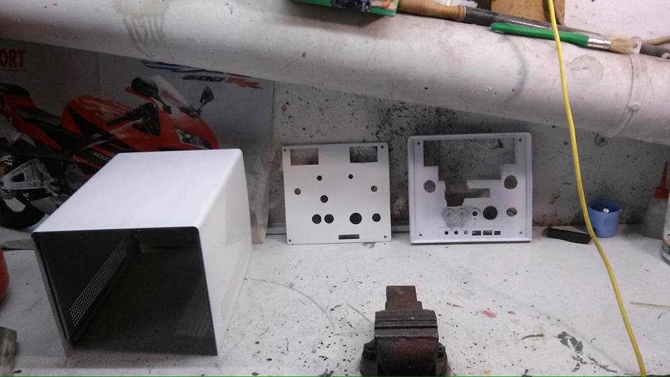

Must mention that i did not drill the holess yet for the potentiometers...
Have it in mind to paint it but haven't decided the color
Any ideas what color to paint it ?
The comparator isn't needed for hysteresis because the relay has hysteresis. Alternatively you can get positive feedback using one resistor from the unregulated DC to the base of the relay drive transistor.
Magnetic relays do have hysteresis, but make/break delta is very wide, and probably not useful for this application.

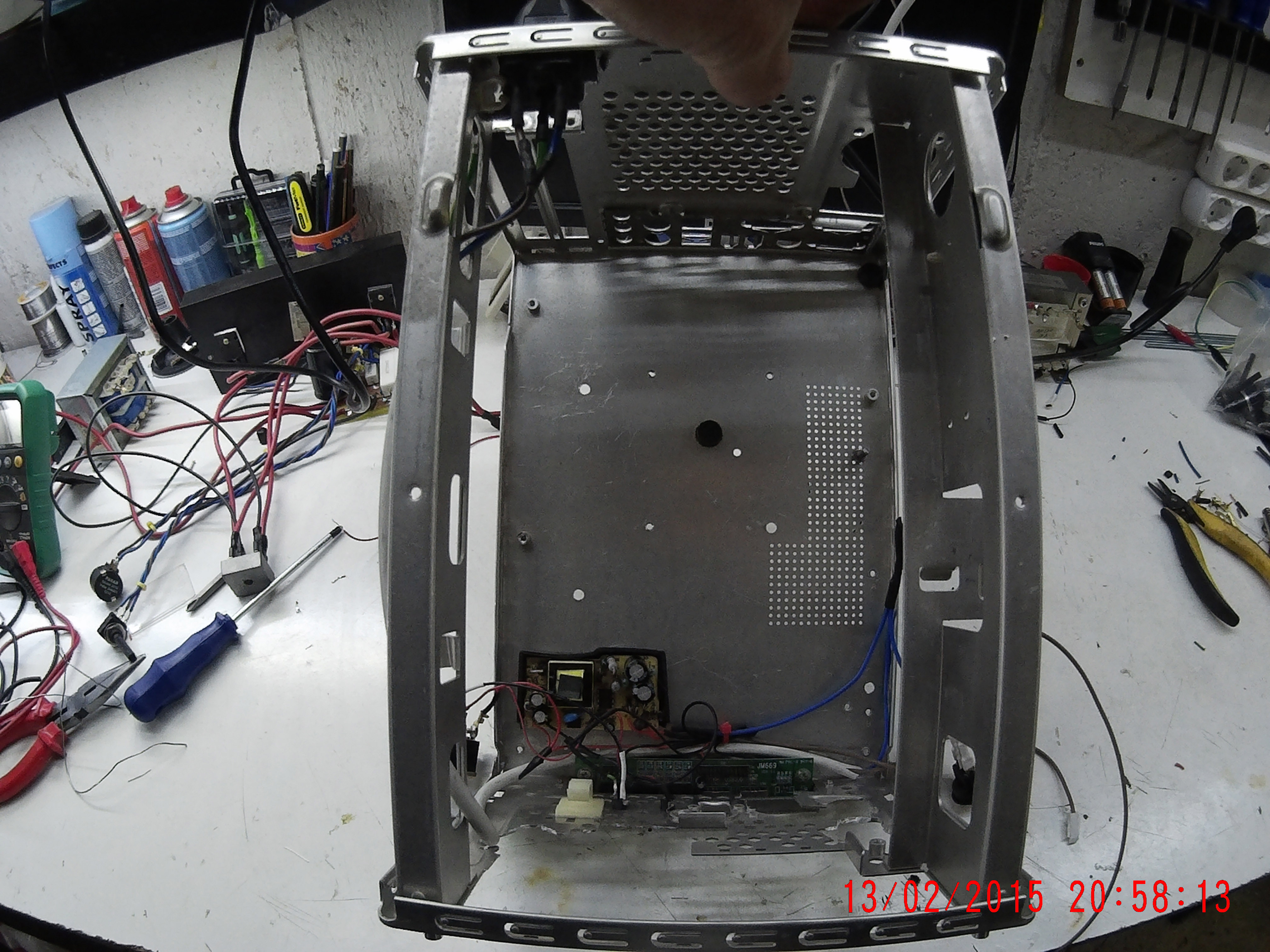

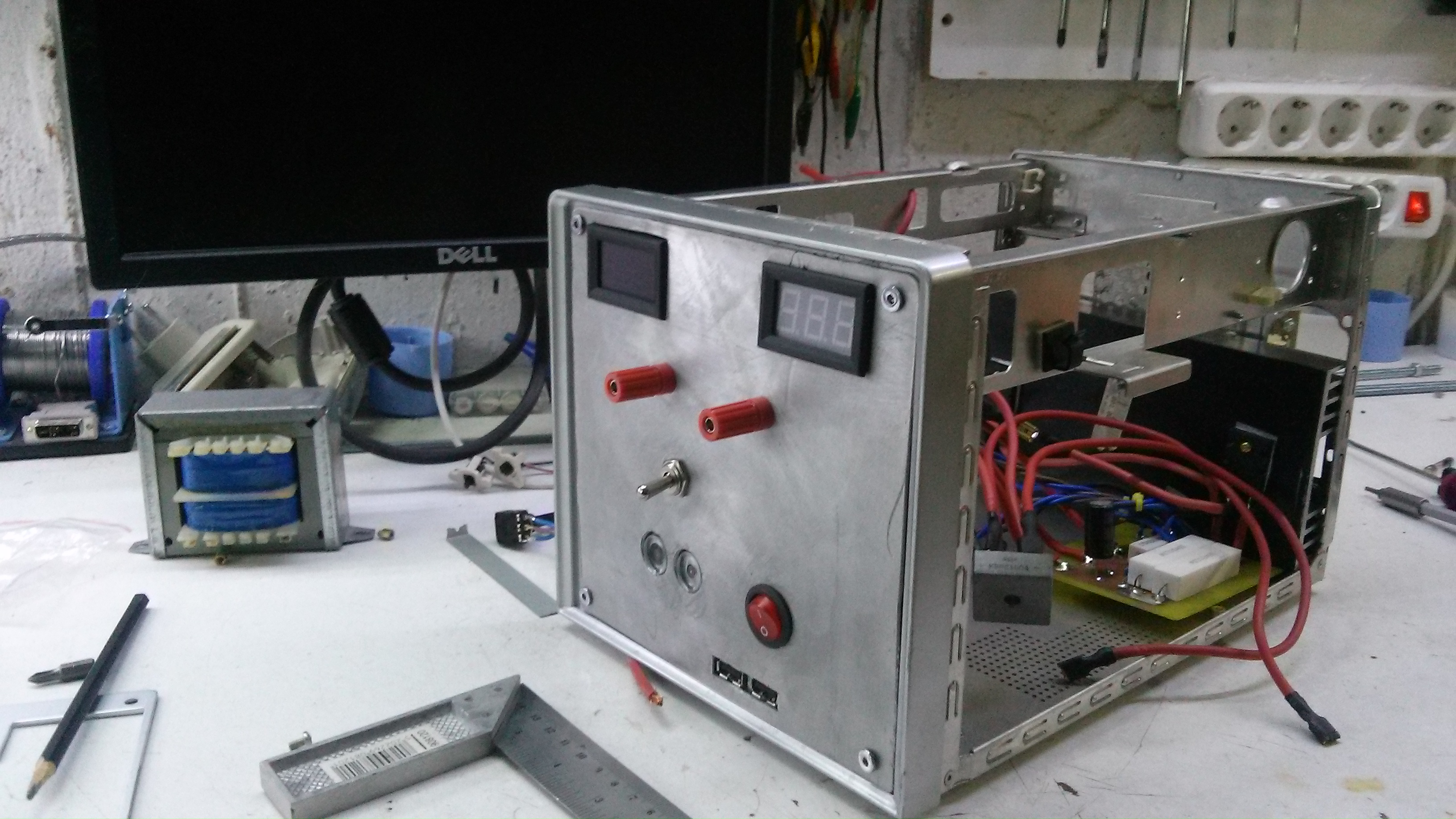

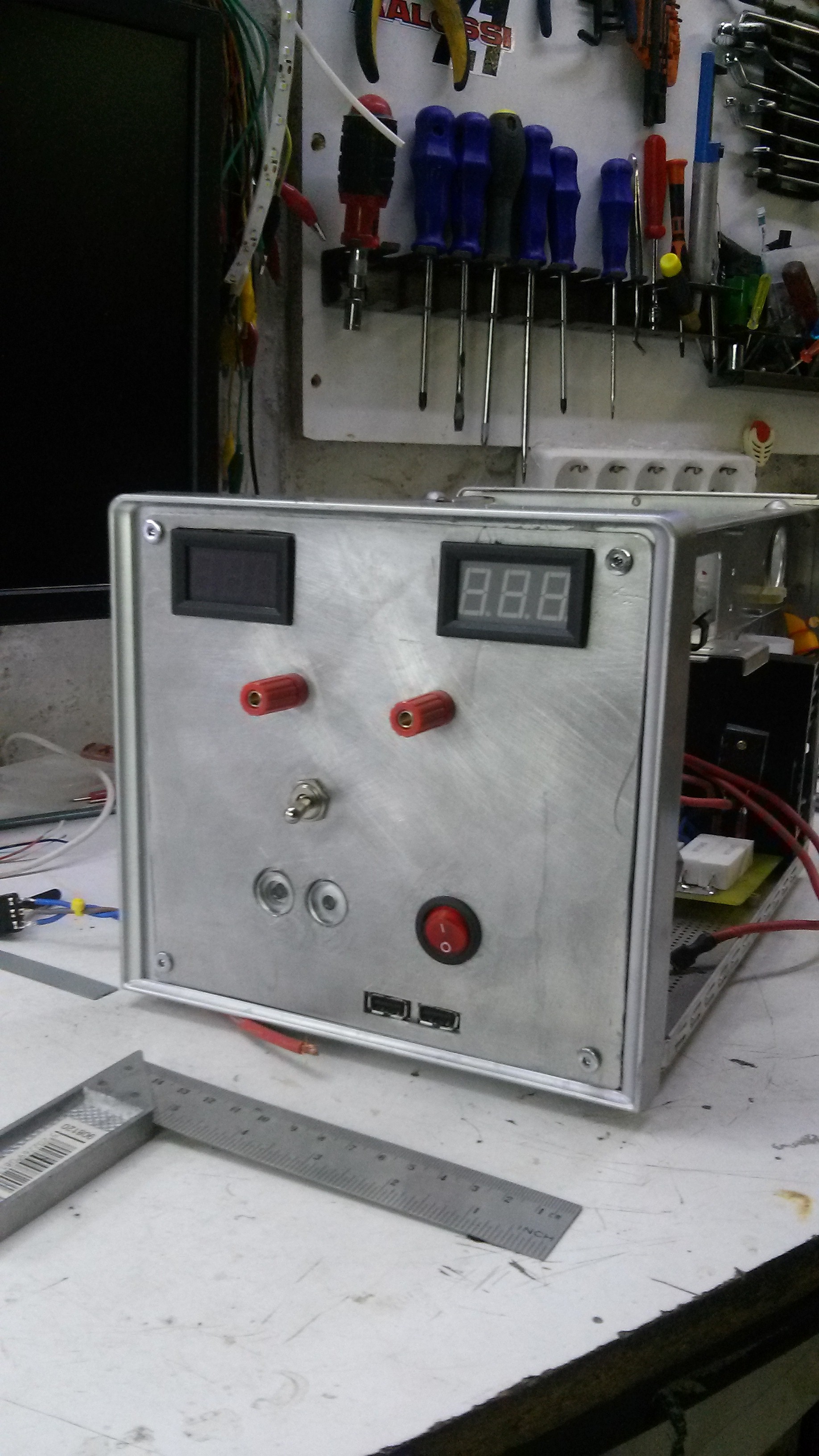

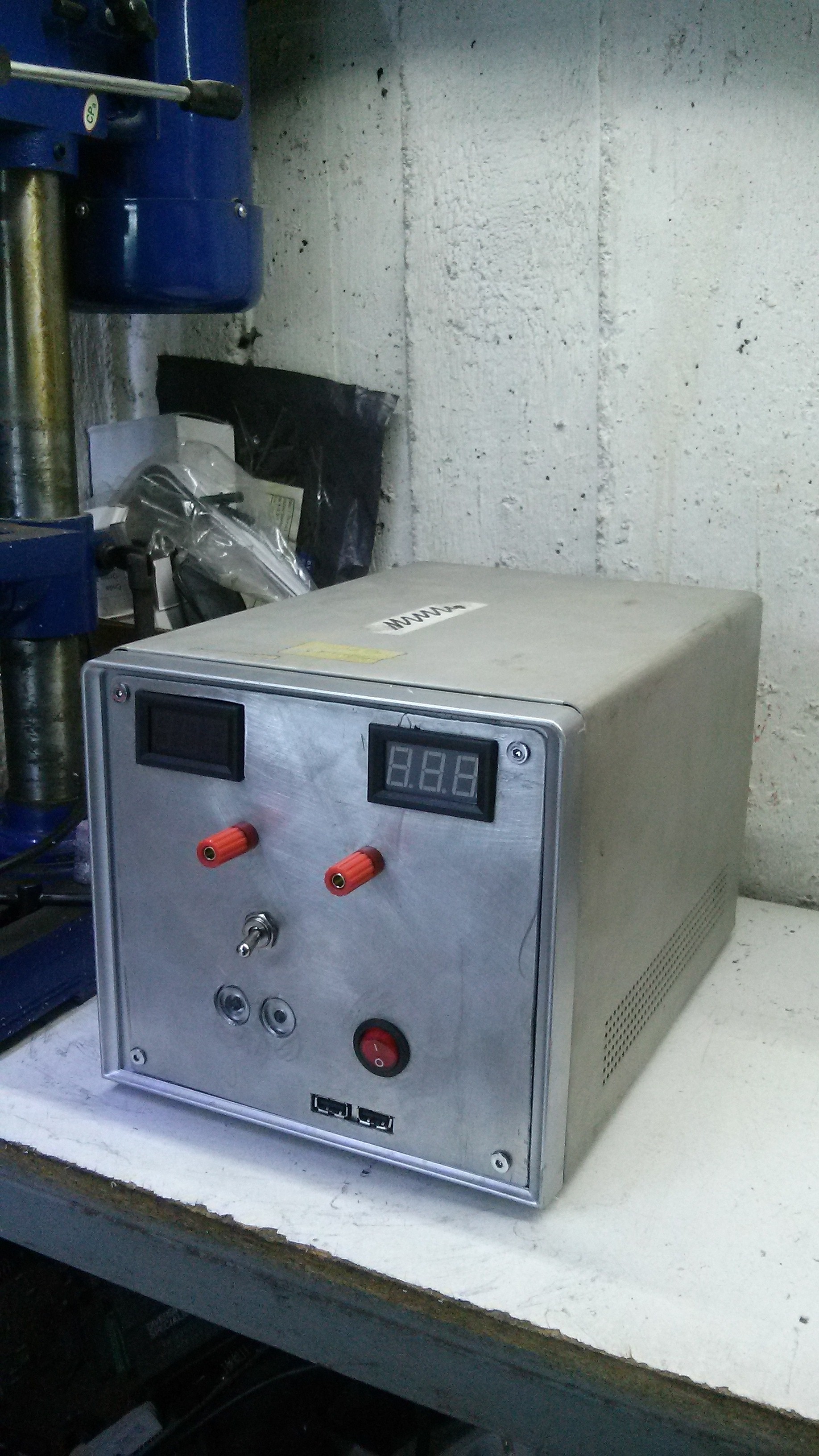

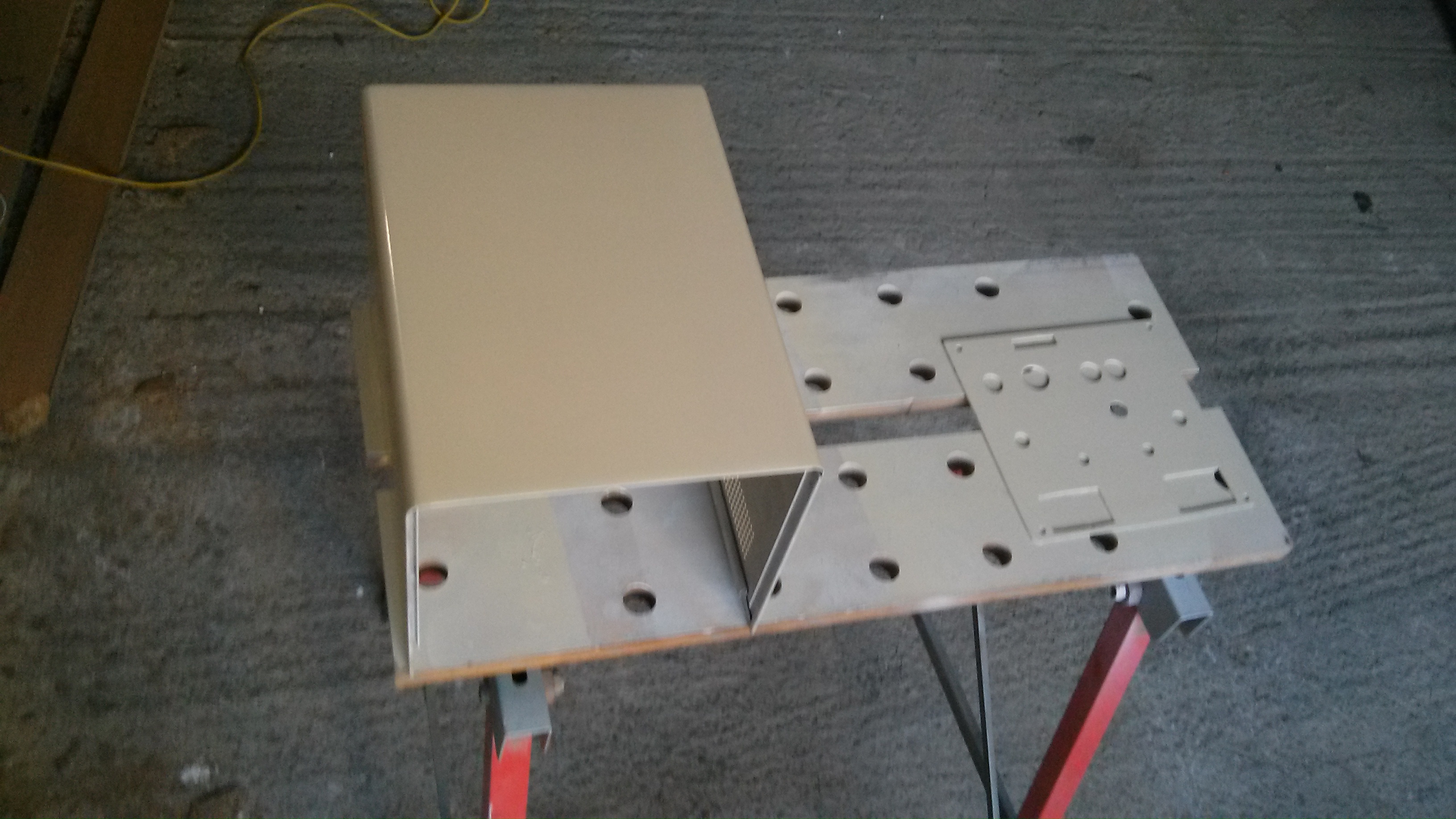

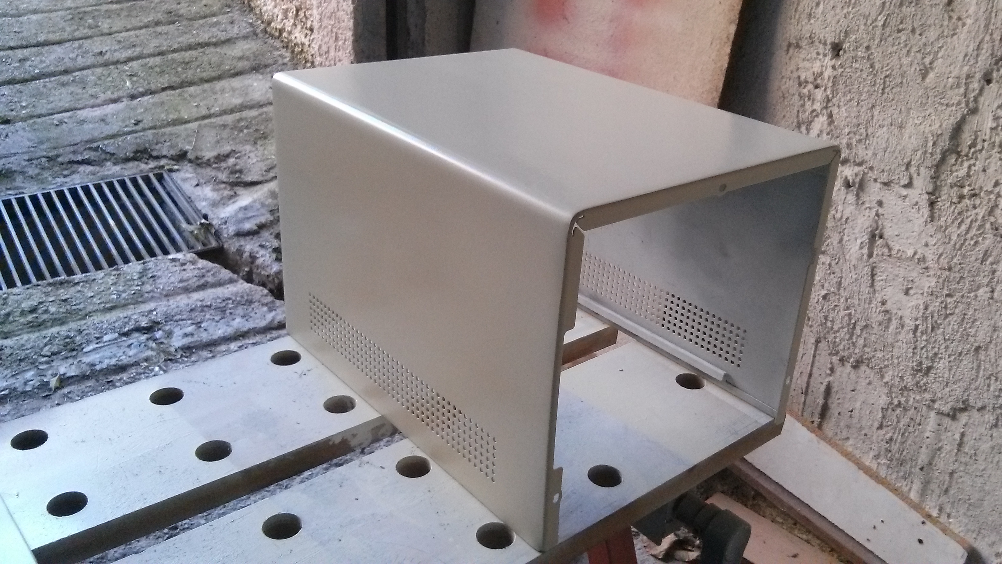

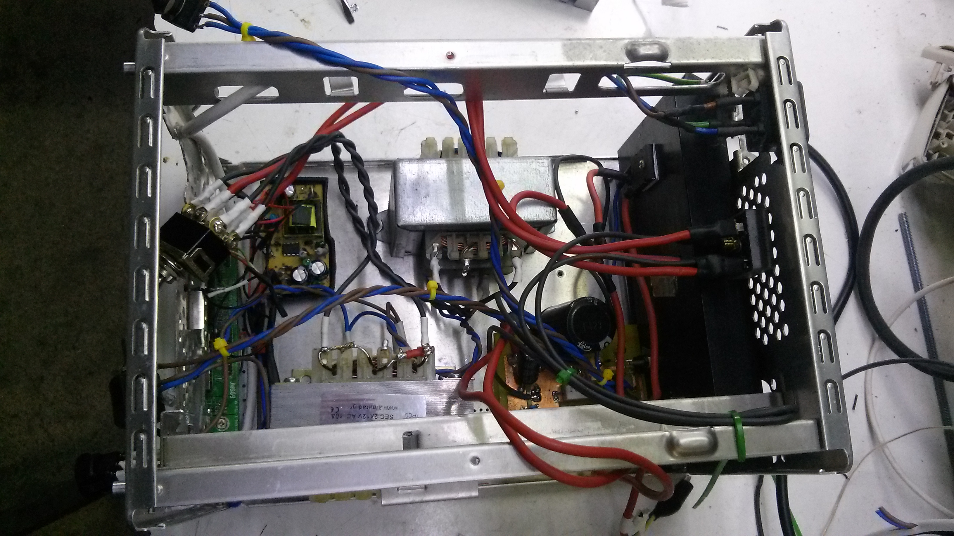

Have installed the switcing power supply for the 5V usb ports and led's Hi Low indication
Have put almost everything together and soldered 220V wires to the transformers,power switch, fuse transformer switcher...
And Video from the Hi Low LED indication :)
I hope to finish this soon!

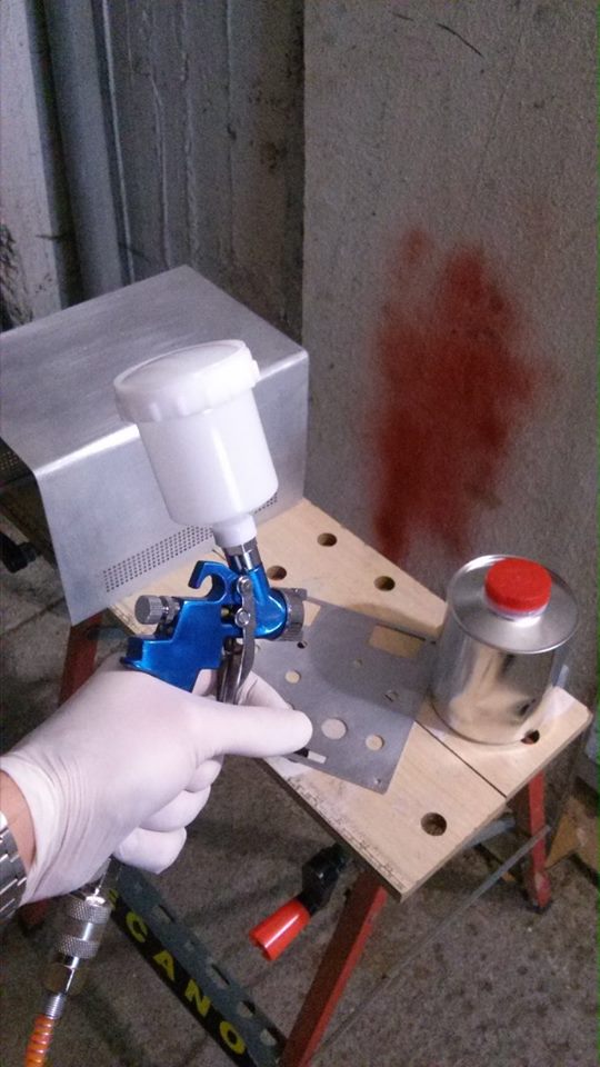

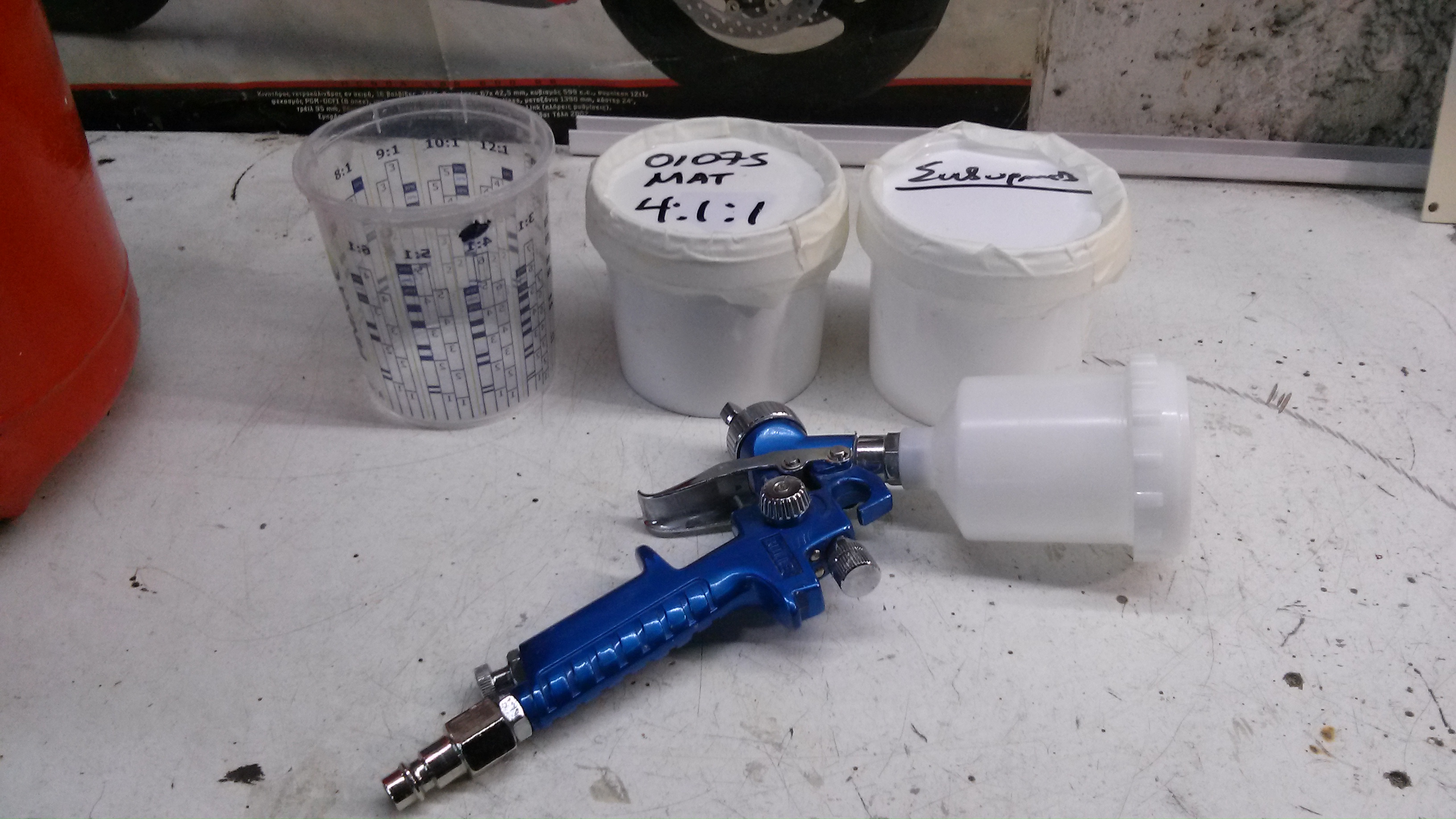

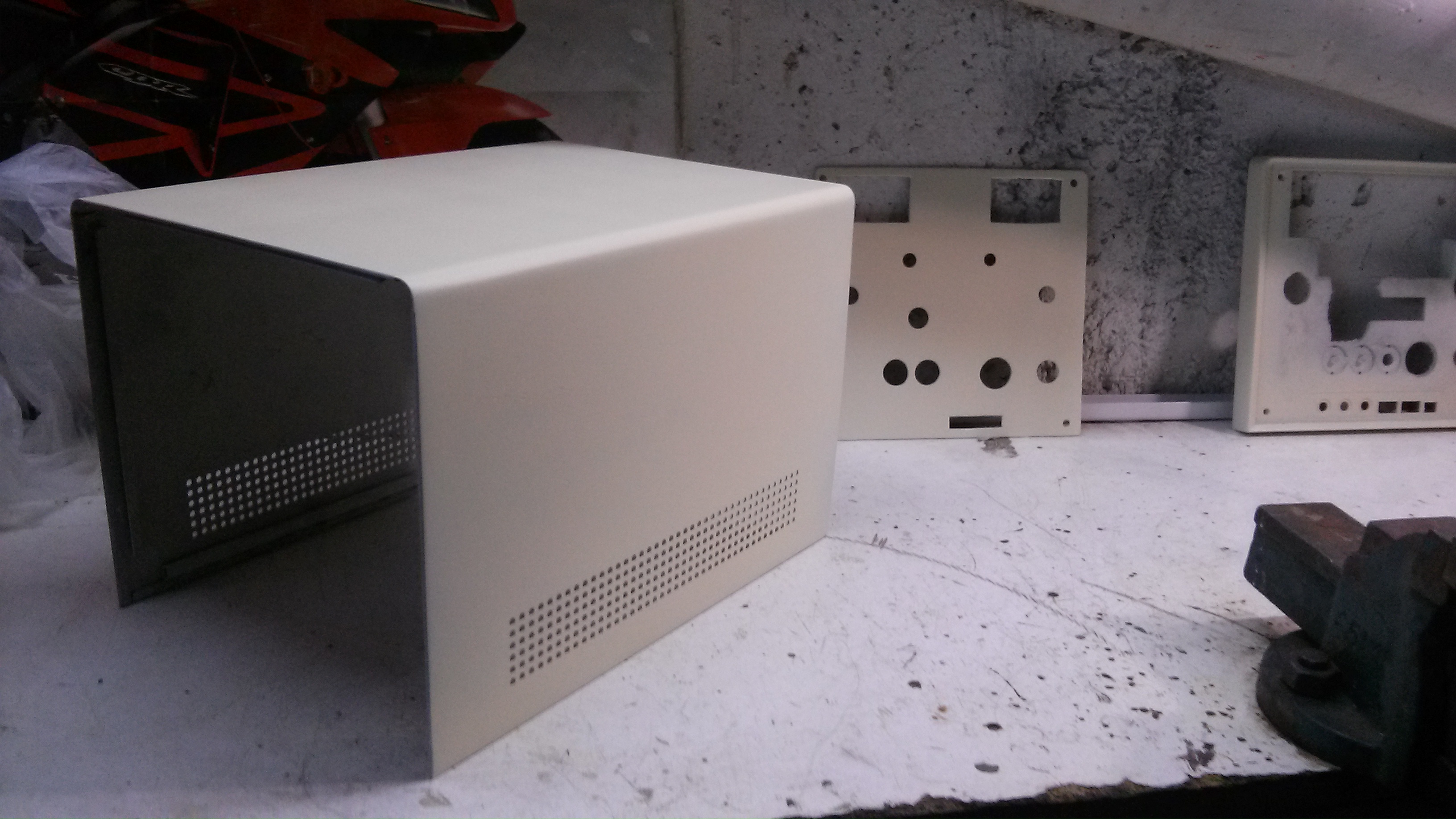

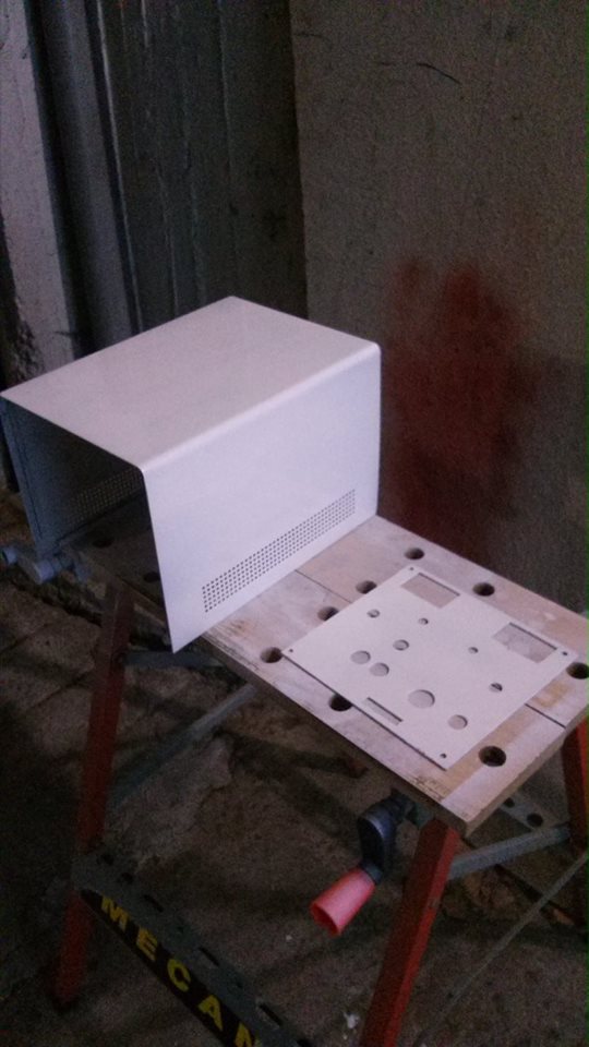

The PS front panel and cover will be painted tomorrow i hope. Will post the results
Very nice. Where did you get the case?
