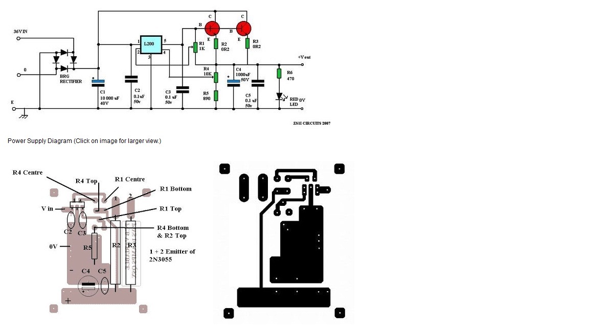

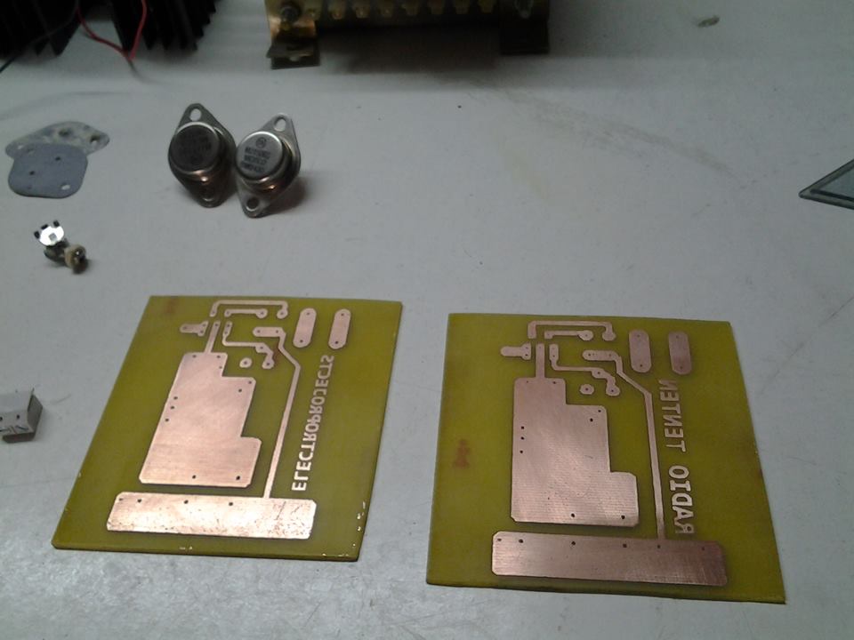

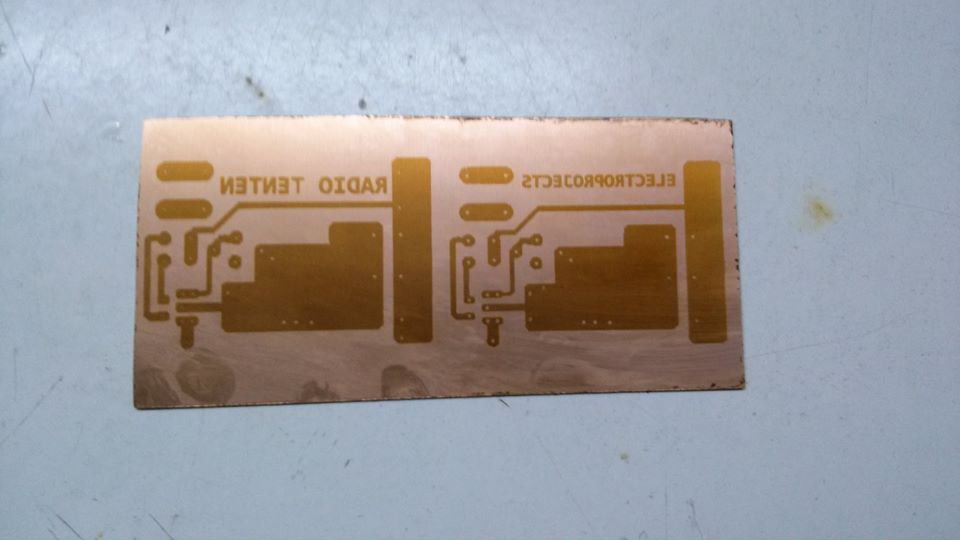

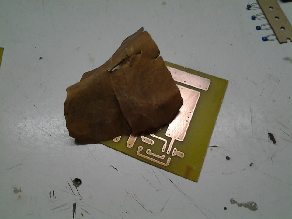

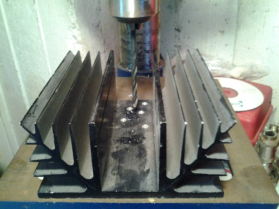

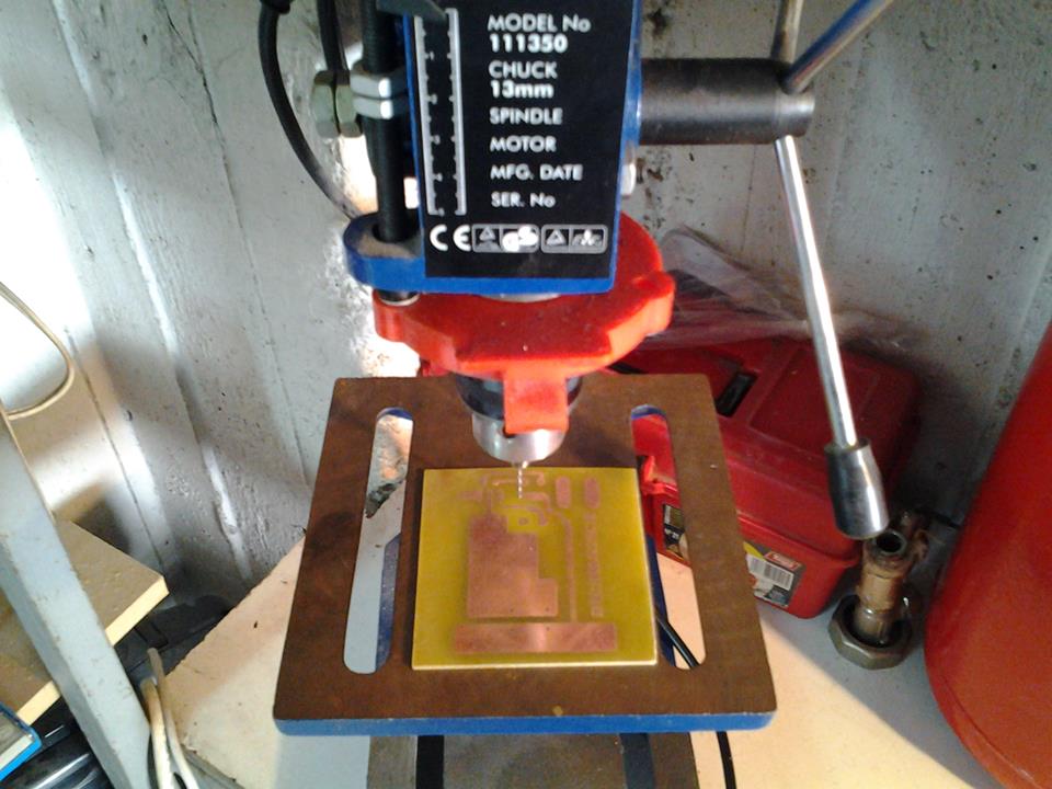

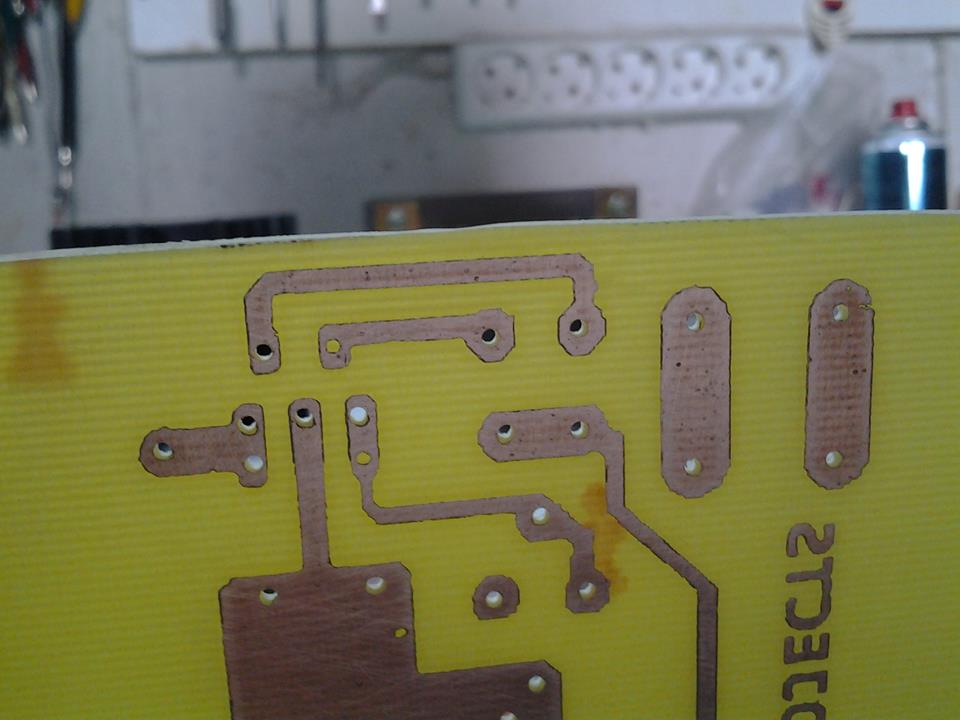

Hello this is my first post and thought to start with a project...
I have started and almost finish the PS i will present below

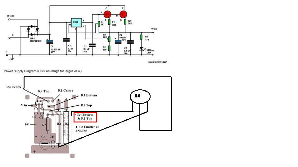

Main thought is to make the simplest circuit i could find and have a 10A power supply for my lab needs.
Any ideas or suggestions to make it better are welcome
Will start with circuit that is not mine design.
That was found at

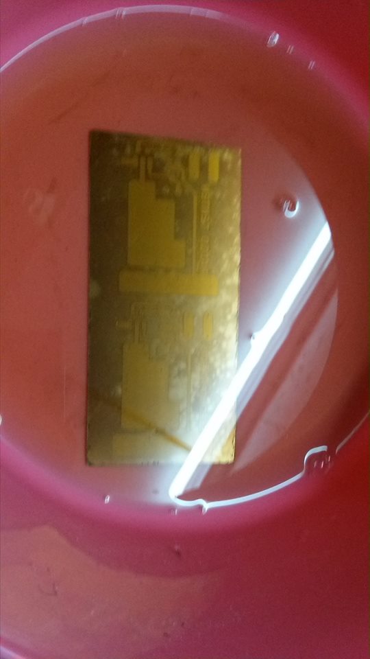

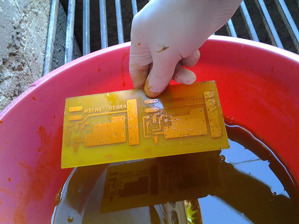

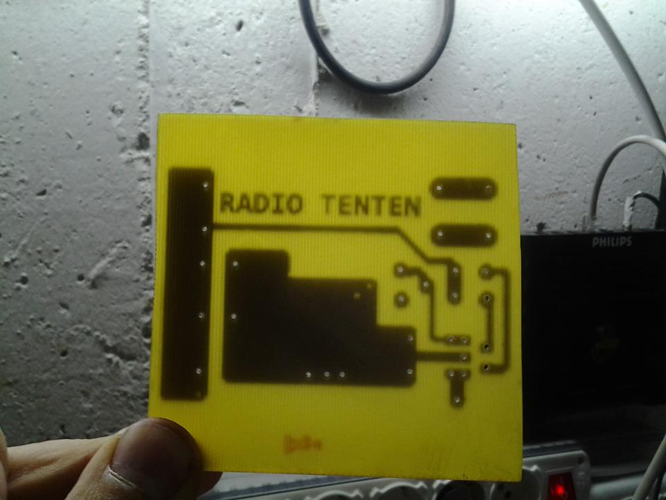

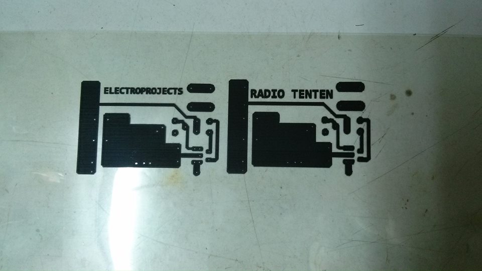

10606485_525123250924472_2137030186550613613_n.jpg I had the transformer and thought to make something with it
and i did...
10606485_525123250924472_2137030186550613613_n.jpg pcb.jpg pcb.jpg 10606485_525123250924472_2137030186550613613_n.jpg 10320425_525123357591128_4830321213342133084_n.jpg 10609577_525123377591126_3299348537425137009_n.jpg 10410547_525123757591088_8351452807682665078_n.jpg 63725_525123807591083_7442641732179557926_n.jpg 10462648_525123907591073_2736289206230154110_n.jpg 1653977_525124080924389_1561720960081989537_n.jpg

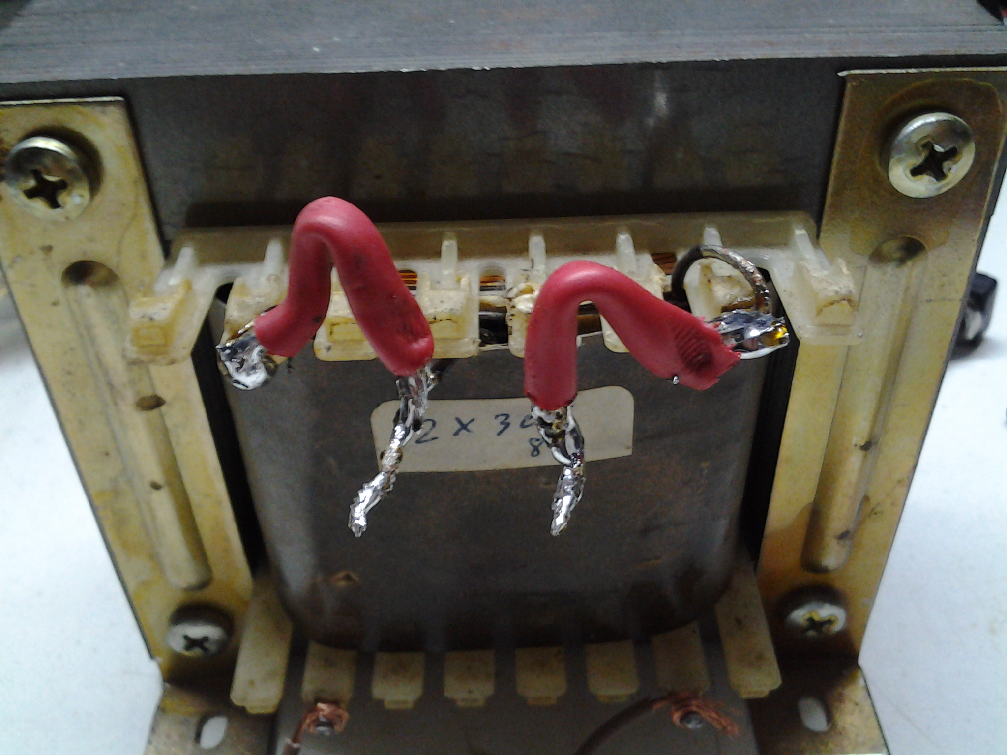

Very nice, but you are going to have problems.
36v AC input, when rectified and smoothed by the capacitor will give you about 50 volts DC.
The 10,000uF electrolytic is rated at 40v
The L200 regulator is rated at 40v MAX input.
You are over running this devices.
When you draw current from this PSU, the pass transistors will get very hot as they will be dissipating:
Dissipation = (50volts - OutputVolts) x OutputCurrent Watts
Let us know how it works when you have finished it.

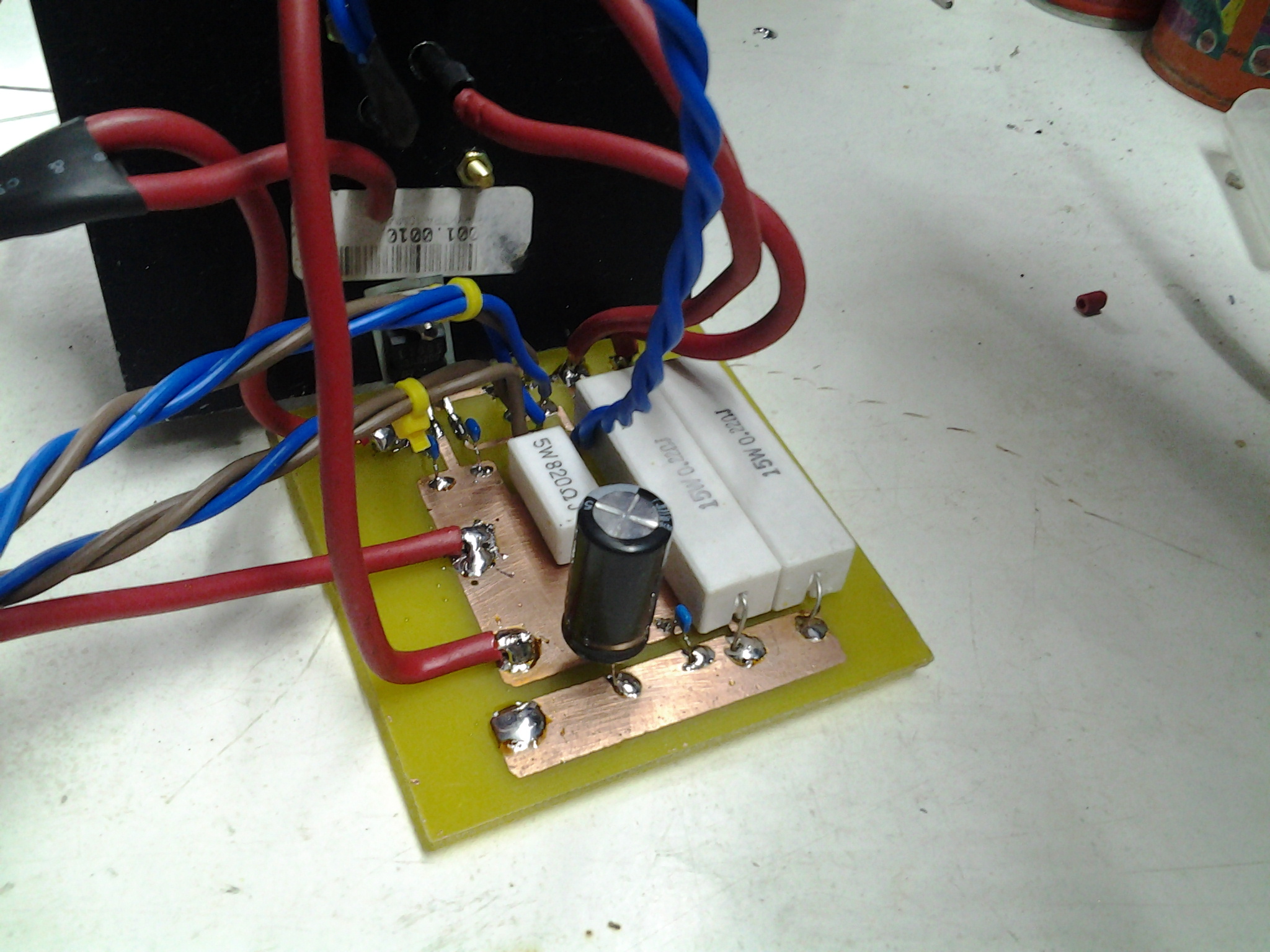

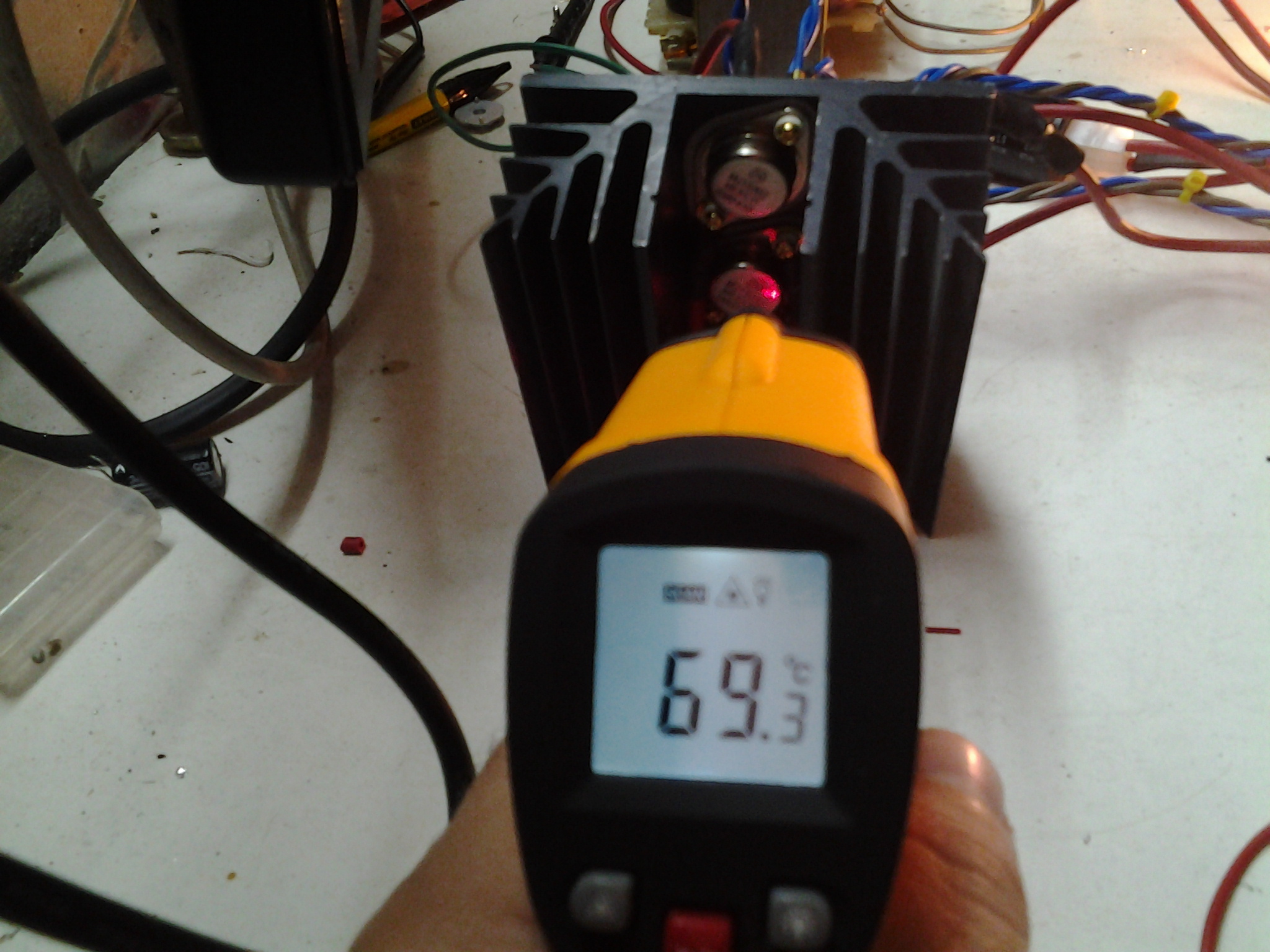

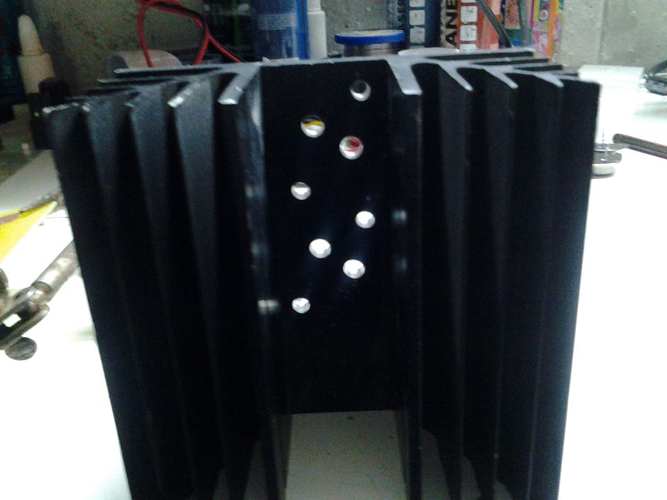

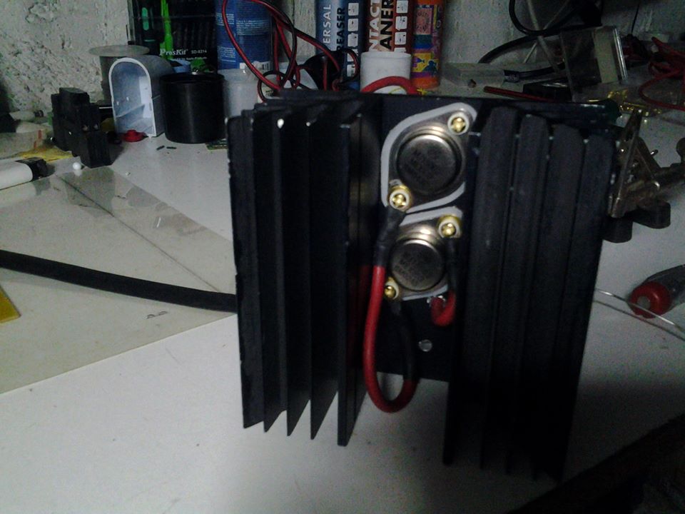

After that i connected everything to test and the test rezualts were very disapointing... :(
with 4A load in about 30sec the MJ15003 gets very HOT :mad:
Only the transistors get very hot.
Not the L200 either the emitter resistor.
Except the above problem with a very slight movement of the potensiometer the voltage changes very fast.
Maybe i have made a mistake with connections but i have double checked it
I found out by searching the circuit that i have a mistake with connections of R4
As written from the author R4 and R2 top i thought this must be connected parallel....
Below i have drawn the connection and will make changes this afternoon :)
Hope this will solve the very short changes of volts with very small movement of the potentiometer.

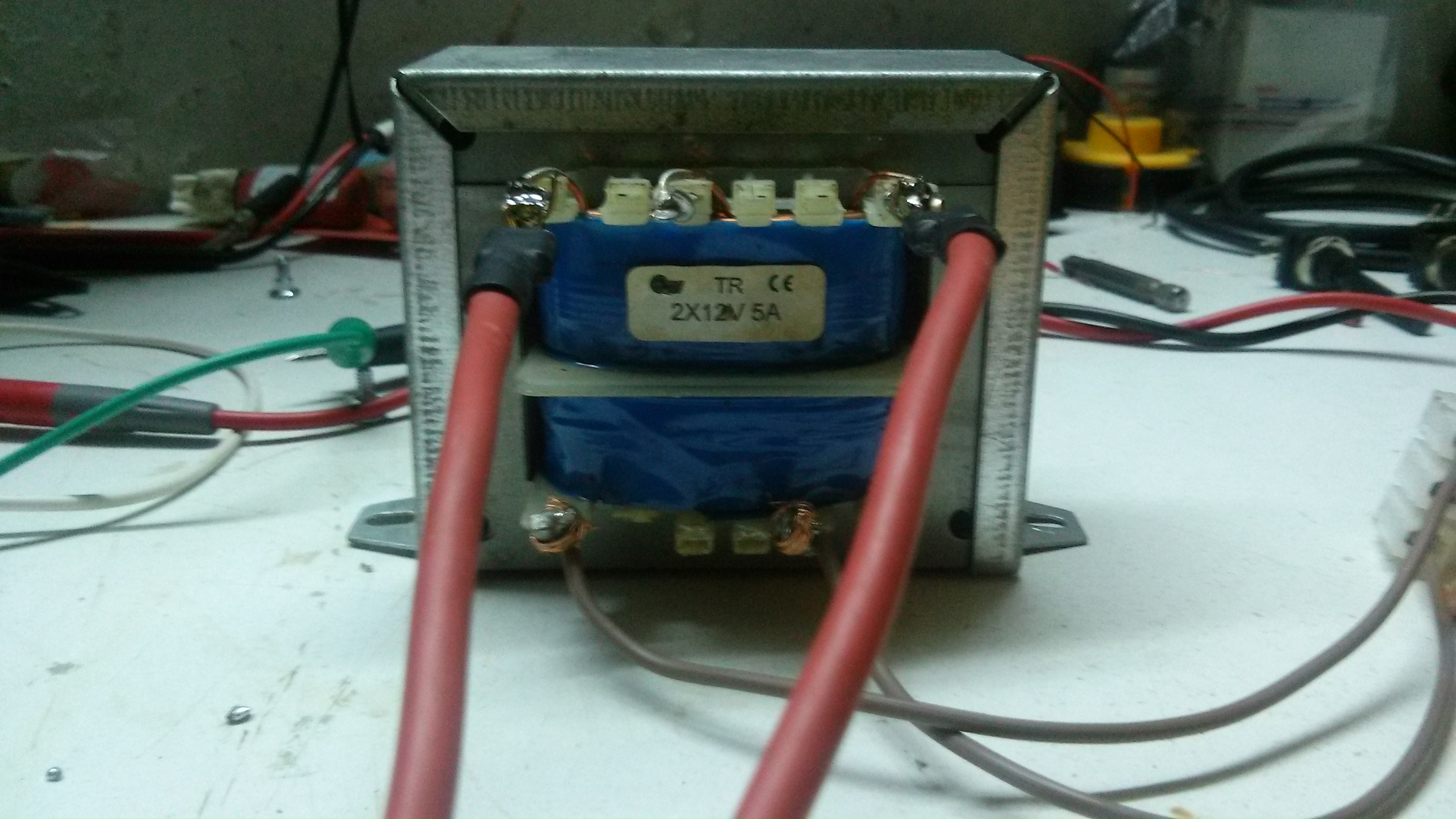

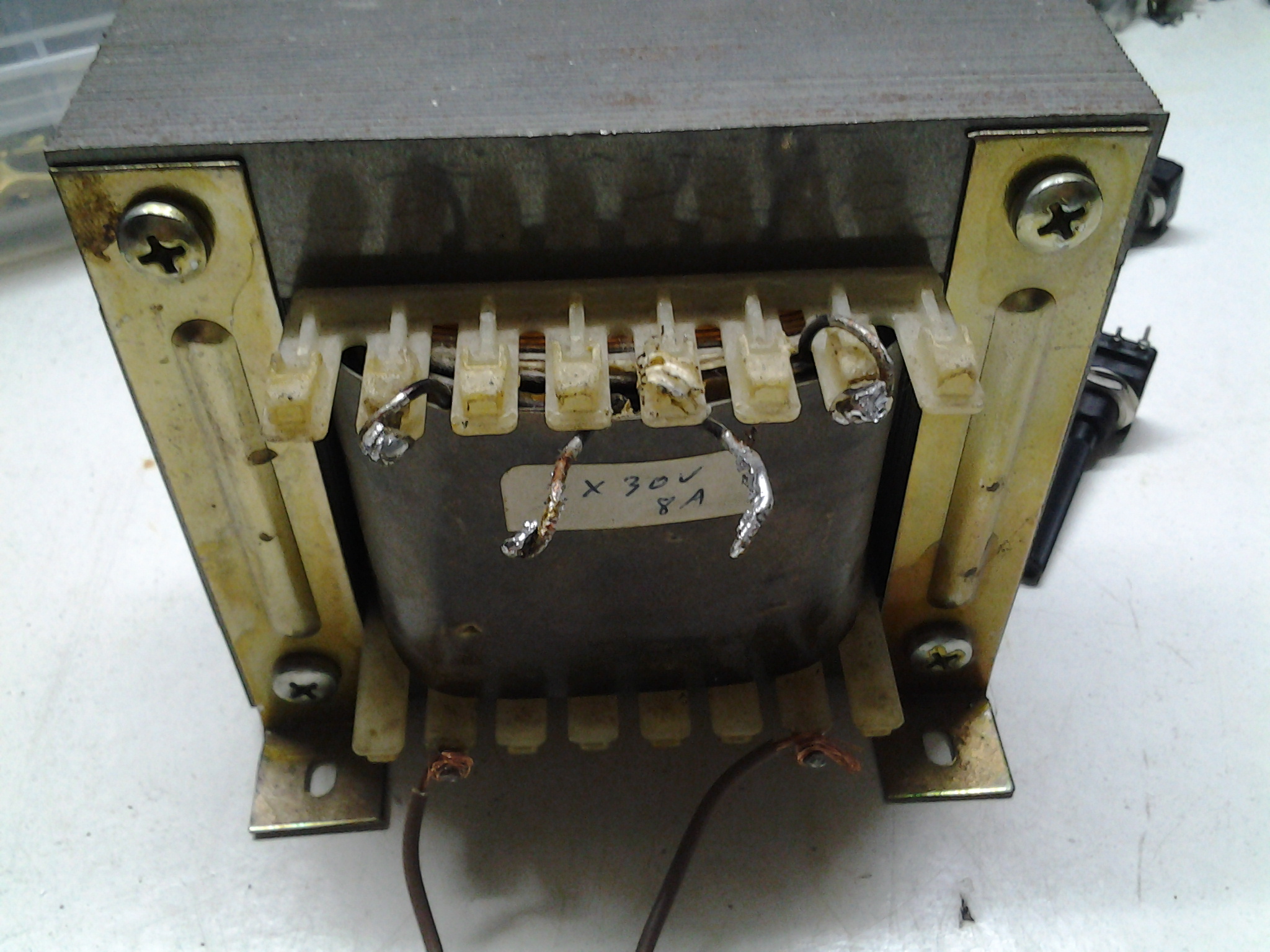

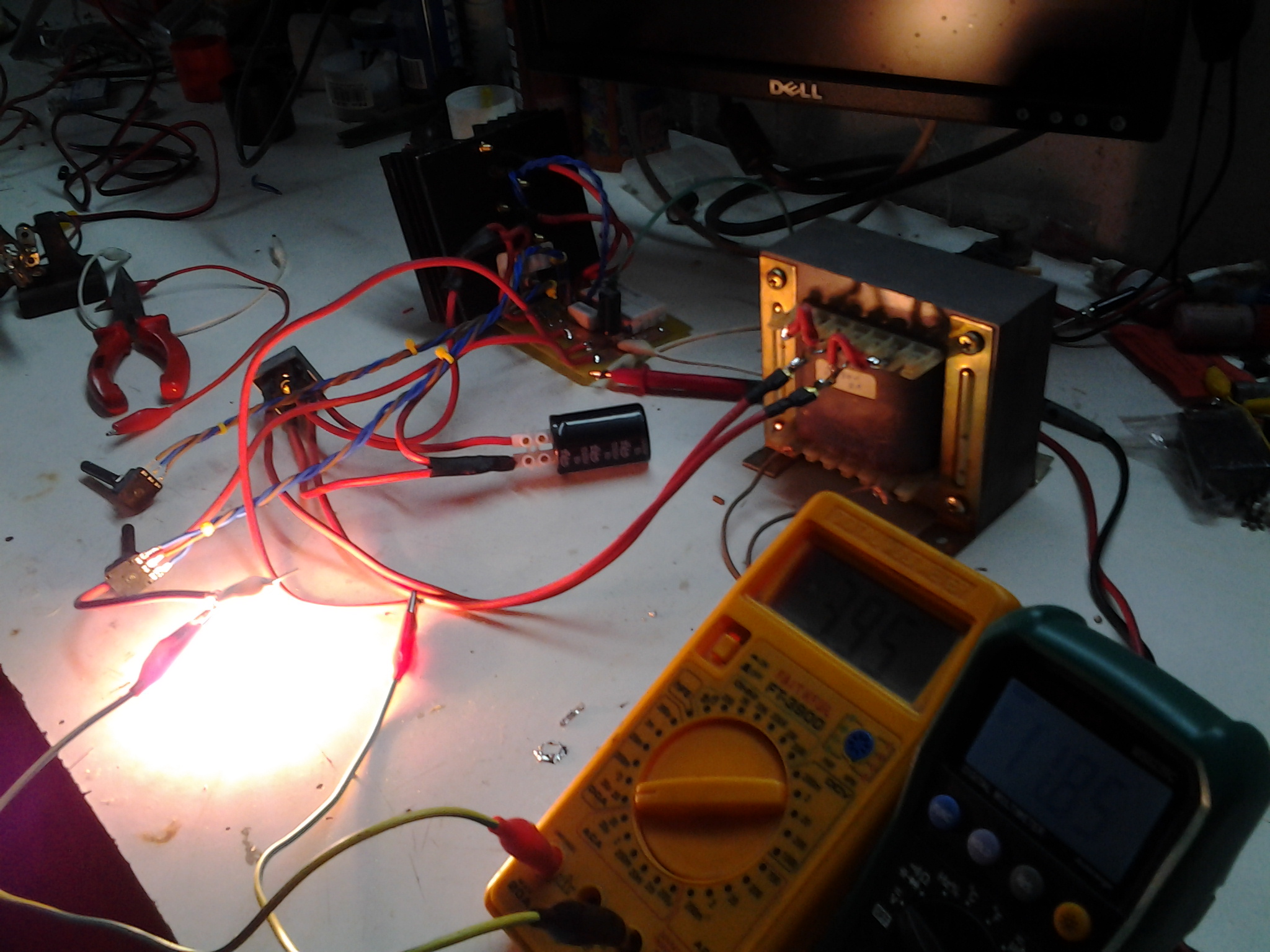

I decided not to use the big transformer and use this one at below pic.
It is 24V and i have the desired voltage. Not more than 32V dc
Tested again with this transformer and everything ok.
I found out that one of the transistors get very hot when i drain 4A and the other one is barely hot...
The Mj15003 connected to R3 gets very hot
Is this normal?
Those transistors should really be matched for Hfe. Take a look at the voltages across the emitter resistors. If the Hfe is vastly different, you could see this problem.
Is this normal?
Probably - you can balance them a little better by increasing R2 and R3, try 0.33 ohms instead of 0.2 ohms.
However, it doesn't really matter - as one gets hot the other will start to take up the load - that's how the balancing works.

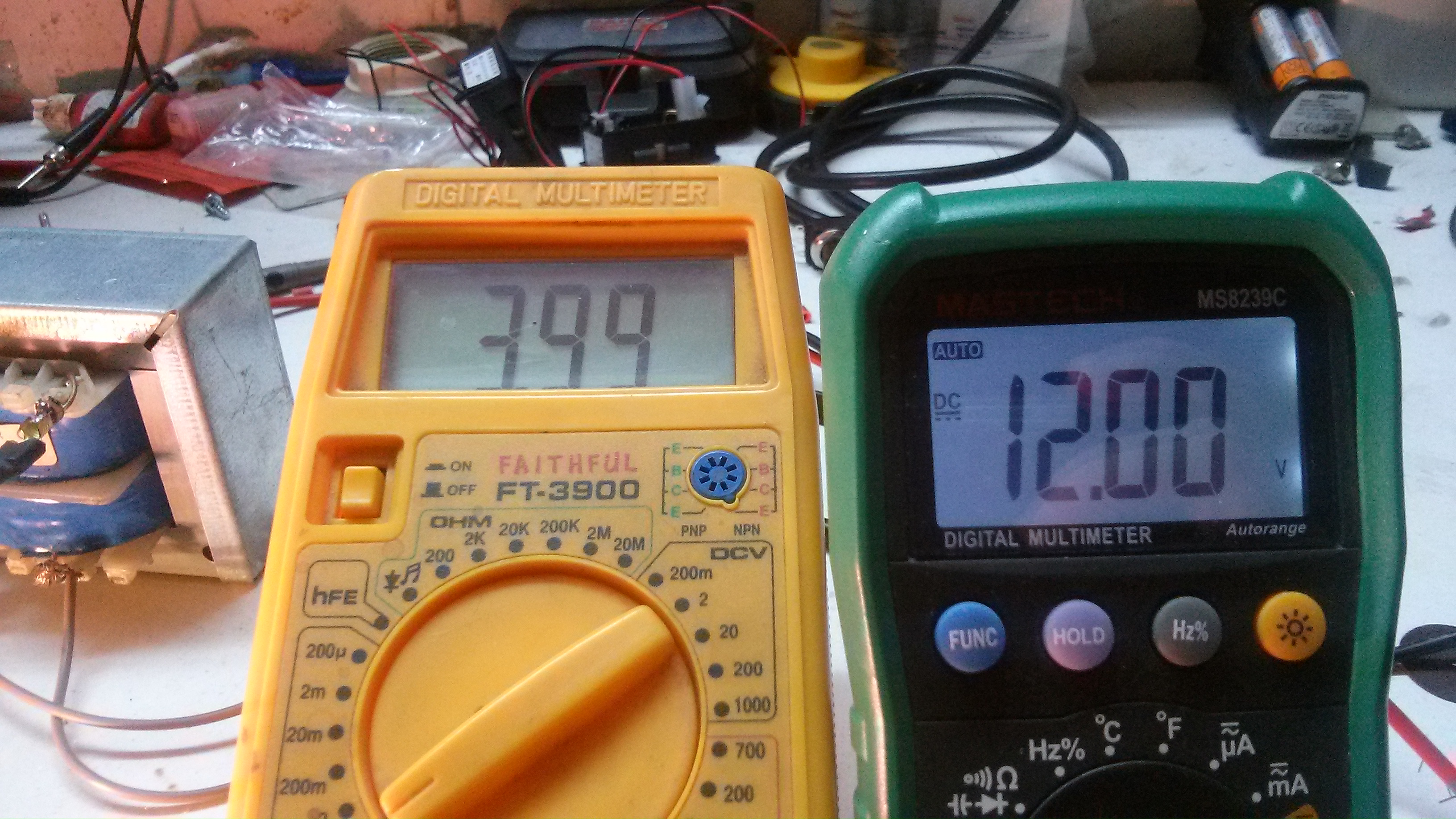

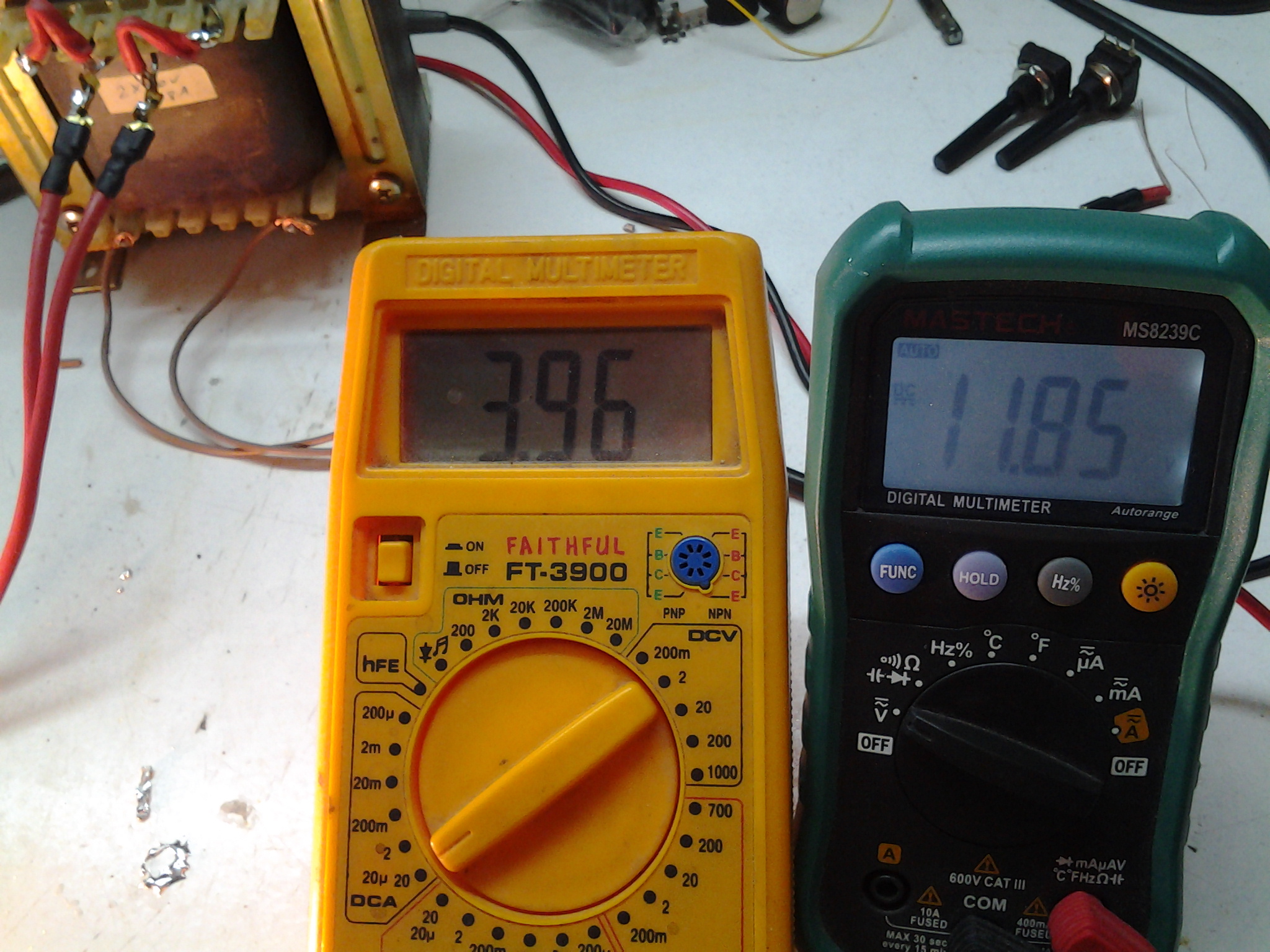

I made this significant changes with the toshiba transistors and tested the PS again but the test results were almost the same as with MJ's...
one transistor connected to R3 starts to get very hot with load connected and the other is not hot
Have some pics with the temp of eatch 2sc5200
2014-10-23-20-42-44-jpg.74548
and the other connected emiter to R2
2014-10-23-20-42-55-jpg.74549
The voltage of the one that gets very hot on emiter is 13.77V
and at the other is 14.10V
The resistors on emiters are 15W 0.22Ohm
