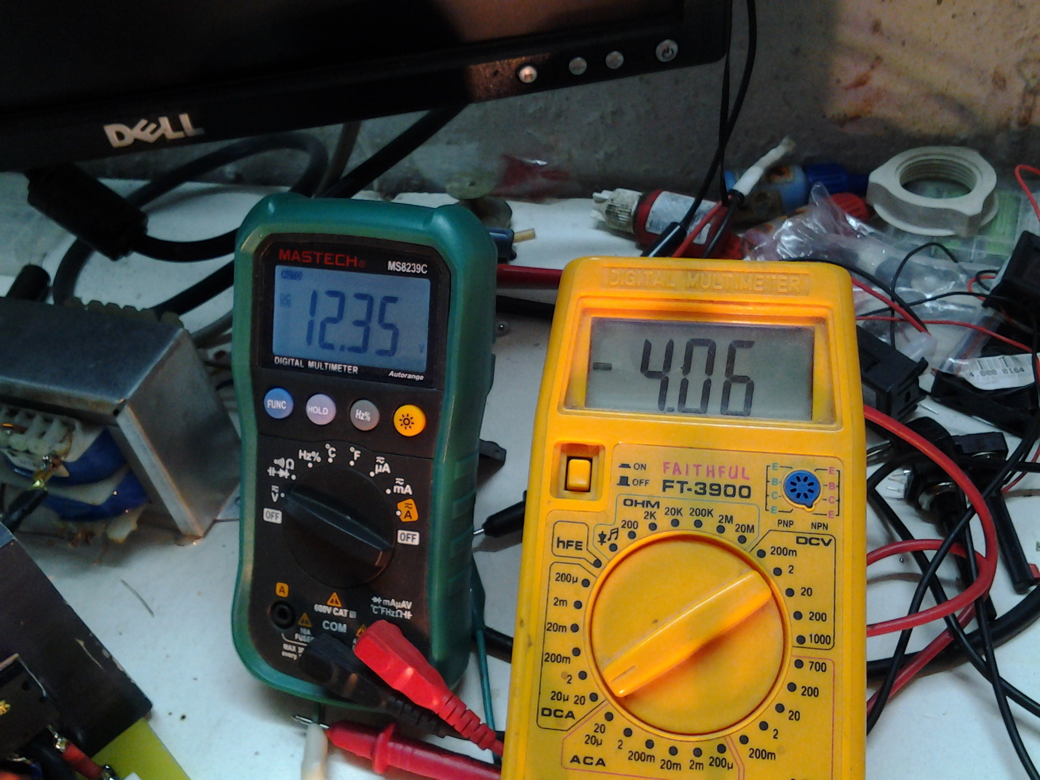

You want to look at the voltage ACROSS the emitter resistors. This is directly related to the current each is passing. The schematic says 0.2 ohms (0R2).
You changed transistors and there was no change.
One emitter is 0.4 volts higher.
Please exchange the two emitter resistors and see if the other transistor gets hot. The problem might be in the resistors.

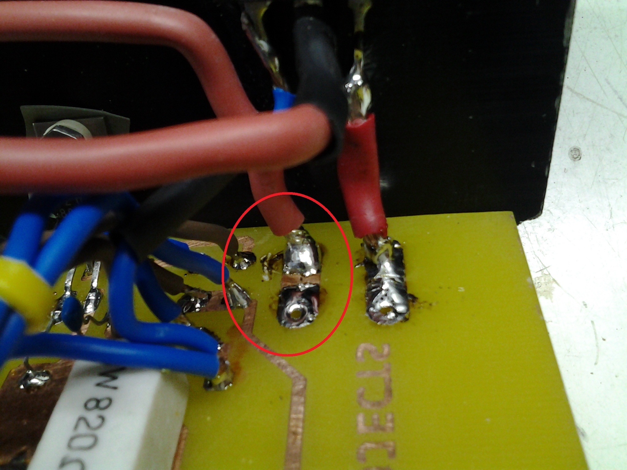

The problem of one transistor draining all the current is resolved and as in most cases it was very simple...:)
Stupid me forgot to soldier the junction between the emitter and resistor :mad:

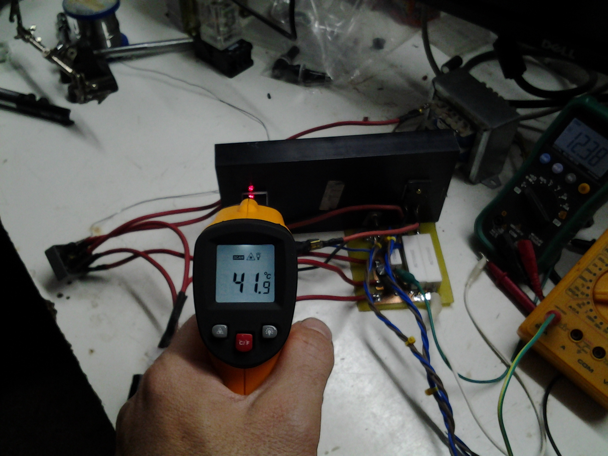

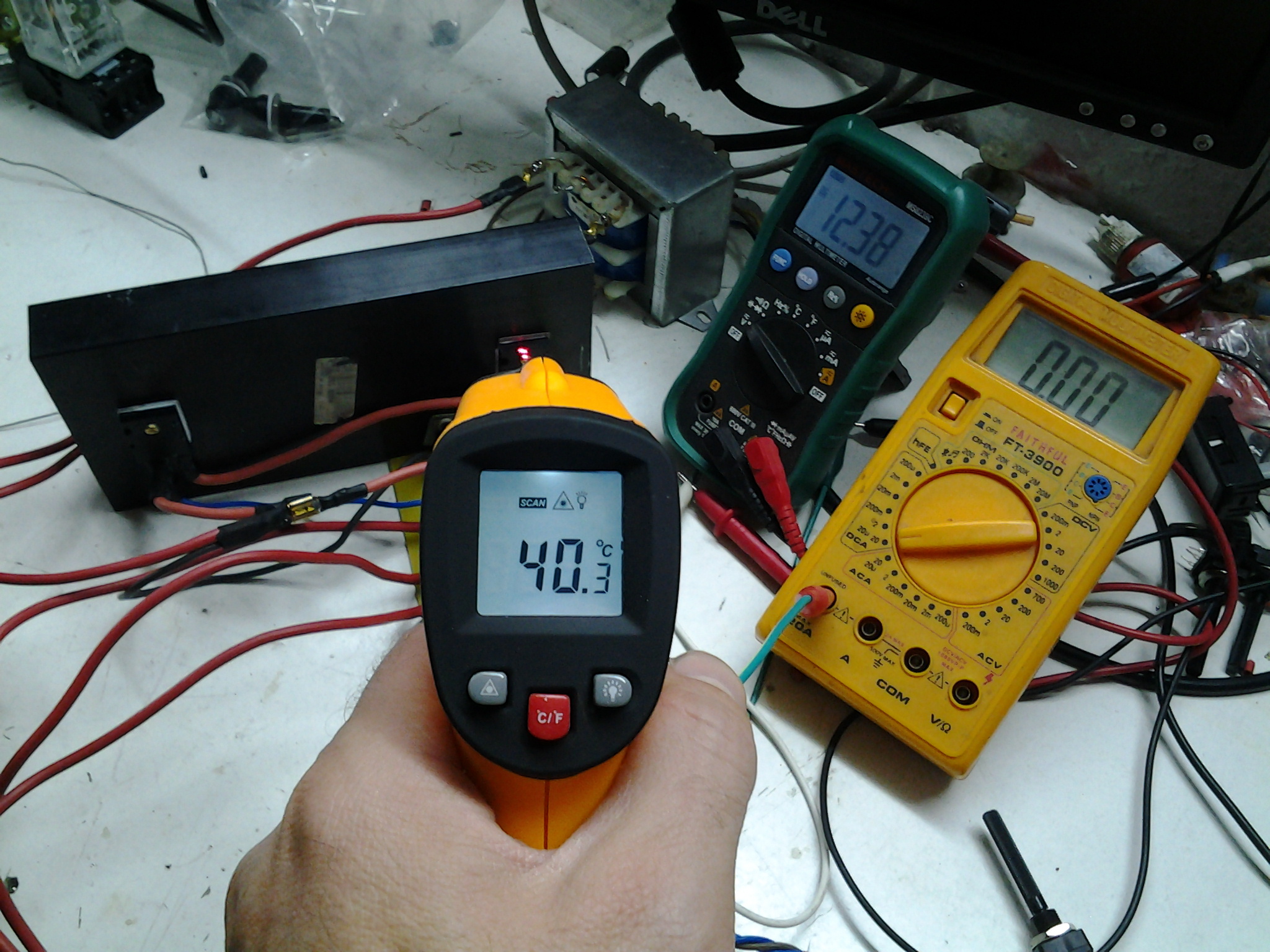

Now the temp is equall and both are running more cooler ! :cool:
Transistor 1
Transistor2
And runing with lamp load...
Very happy that it is working as supposed to

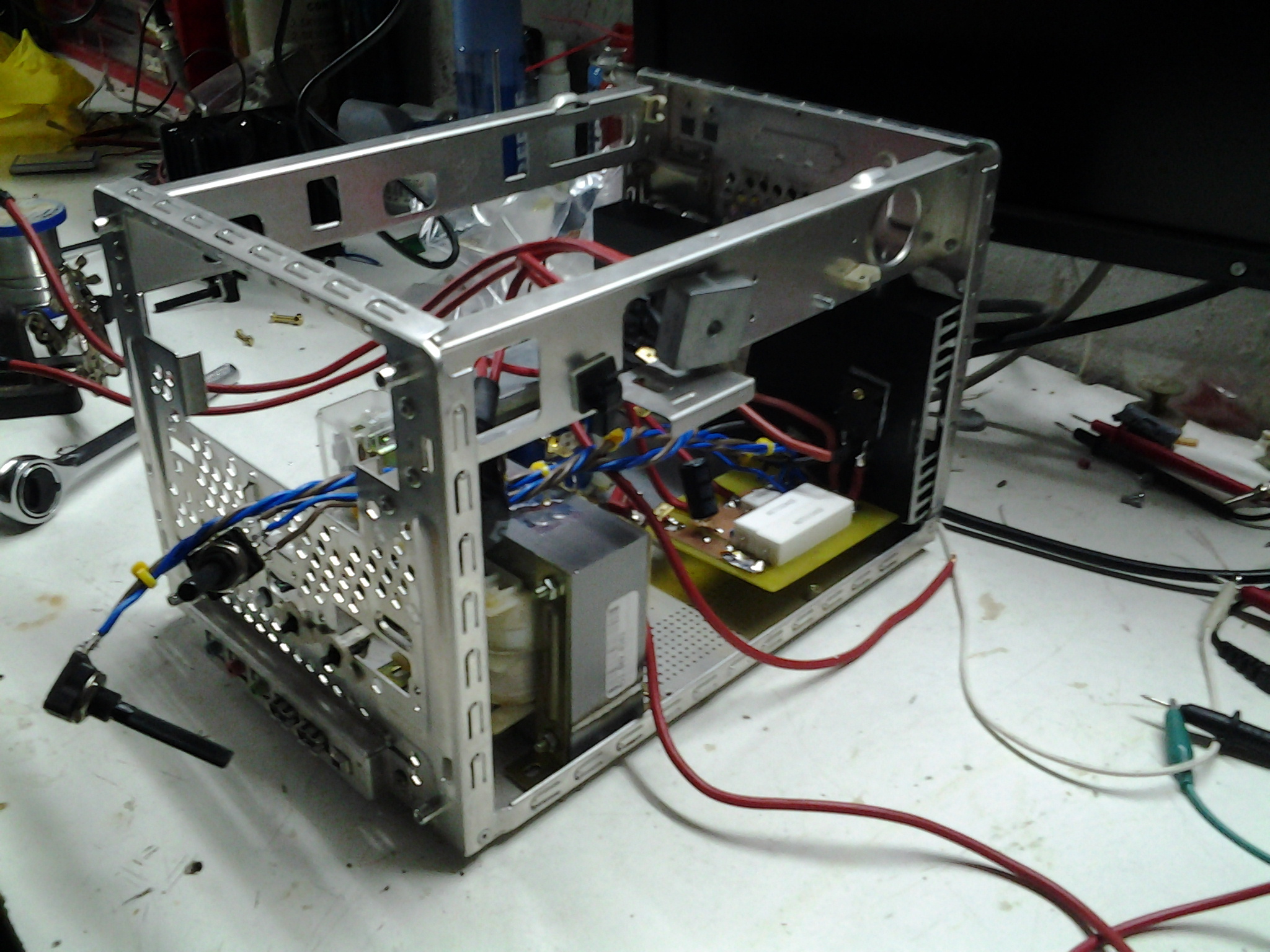

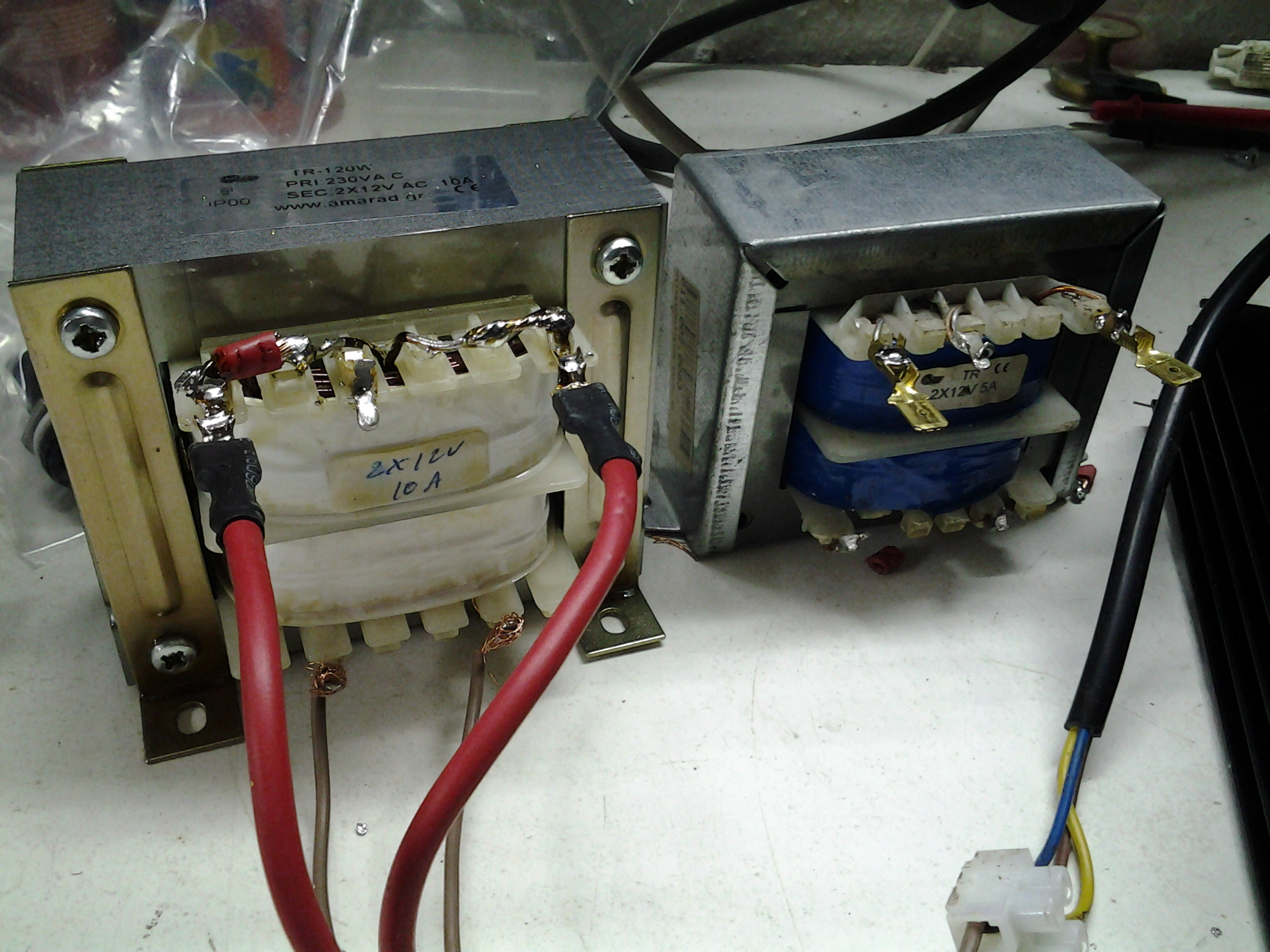

Changed planes for this PS and will use two transformers for non heating issues.
I have purchased a 12V 10A that will be used for low voltage and have kept the 24V 5A in the case for 15 Volts to 30 Volts
Tested the 12V transformer PS under 4A load and it dosent get hot at all.
The internal of the case will be like this:

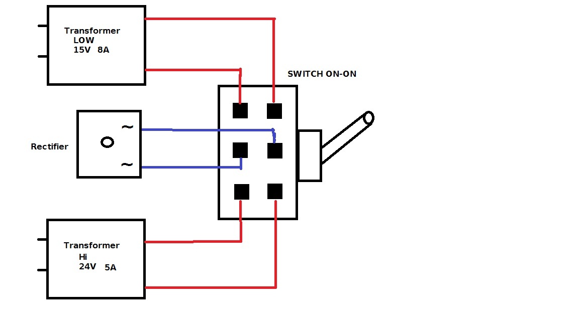

The transformer selection can be done with a simple ON-ON switch but i want to use a 10A relay that i have for the transformer to be selected automatically by the voltage change from potentiometer
Problem is that i can't figure how to switch on the relay when 15V are selected from pot.
My relay is 24 Volts and it changes state from 12V...
Simple Switch connections:

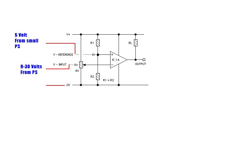

Maybe if i use a transistor as a switch will do the job to activate relay at 15V dc ?
something like this :
!5 is probably a bad number. You might also make sure you have some hysteresis. e.g In at 18, out at16 V. or whatever, so you may want a window comparator.
I would stick with the high voltage low voltage switch. Sensing the voltage and switching the input to the regulator may be heartache.
I agree that automatic switching should have some hysterysis in the switching voltage.
Also, I think that you may find the auto switching a bit of a pain at times, I cannot fully justify this statement, just a gut feel that I have.

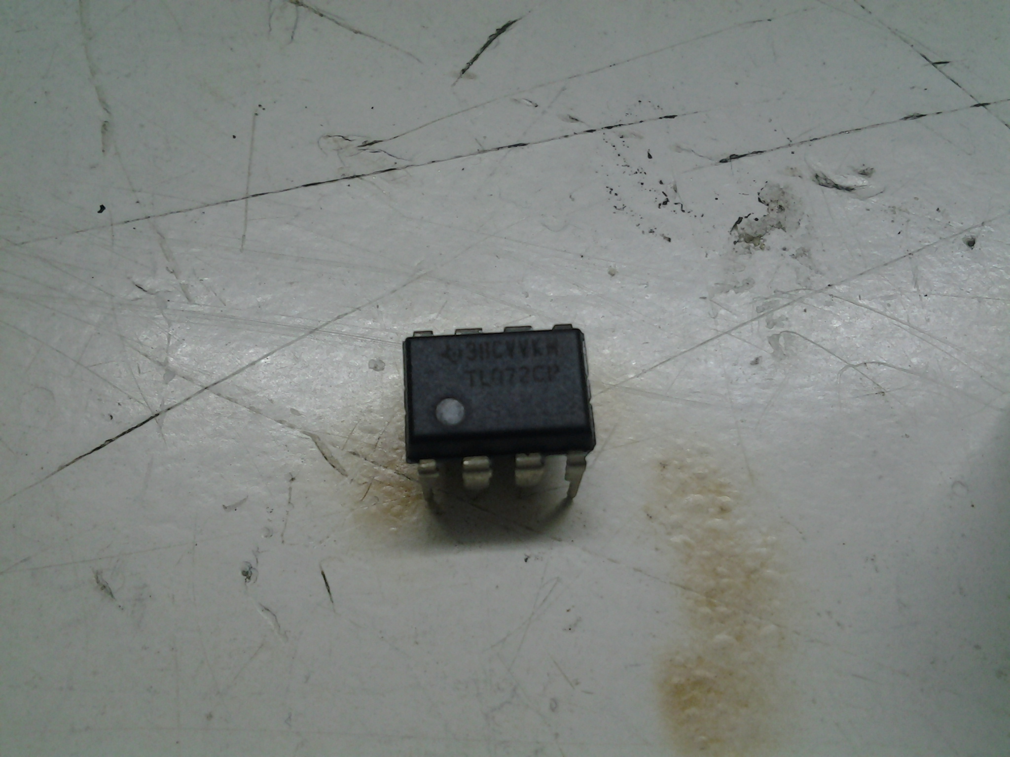

I found in my bench drawers the TL072 and planning to use it as voltage comparator...

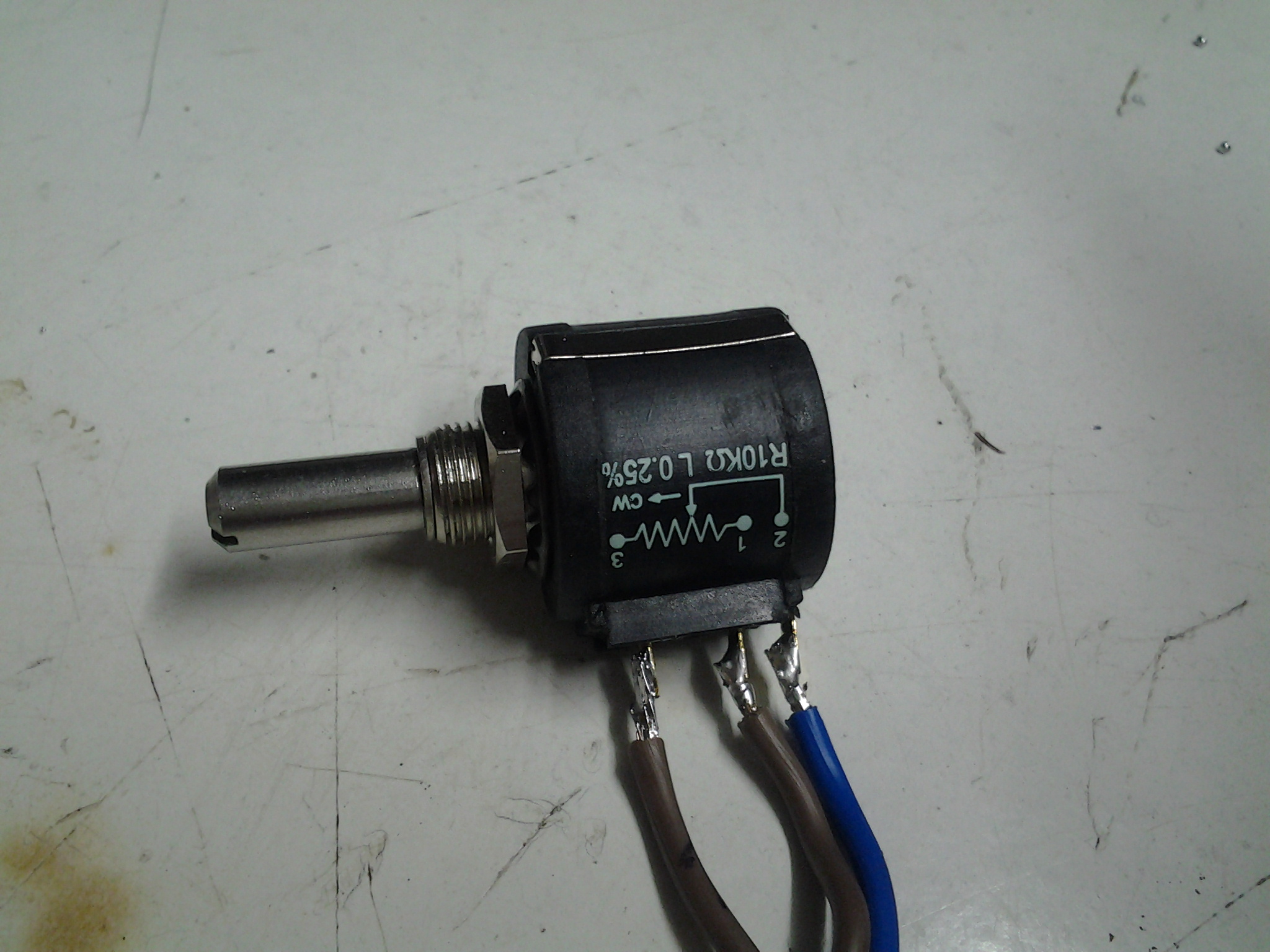

will do a research for how it could be done.
Any ideas or suggestions are of course welcome since i have never used an opamp as a voltage comparator
Is that a series 3590 pot? I use the same one for my PS and i get a nice adjustment because it is ten turns.
If you look up the TL072 and similar IC's you can get a better idea what to expect. They might be faster than the typical LM324 for example, but they might also require stricter input/output/V+/V- relationships.
On the contrary, I would imagine it should be simple and flawless in operation - as you say, it needs hysteresis - so apply positive feedback to the comparator that's doing the switching.
You want a fairly high degree of hysteresis, so (for example) that it switches to the high winding if over 25V, and switches to the low winding if it's under 20V.
Personally, I'd probably use a PIC to do - and use the PIC to display the output voltage and current on an LCD display - as you're monitoring the output voltage to display it it's simple to switch transformer windings (using relays), you could even switch multiple taps easily as well.

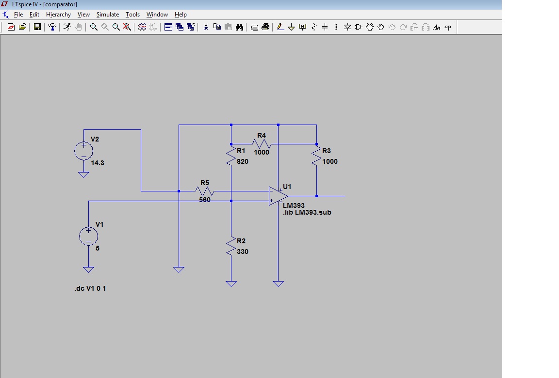

I have been trying to simulate the circuit to LTspice.
The Resistors values are for reference
spice.jpg .
I don't have any expirience with ltspice and althought i managed to upload LM393 from this link https://www.ti.com/product/lm393 and run the simulator of this circuit i don't know if this is ok

Can someone more expirenced help ?
  • comparator.asc
Many LM393 comparators cannot be used in your circuit because its minimum output low current is only 6mA. Your circuit has an output current of 14.3mA.
It is a dual comparator. Do you know how to disable the unused comparator?
