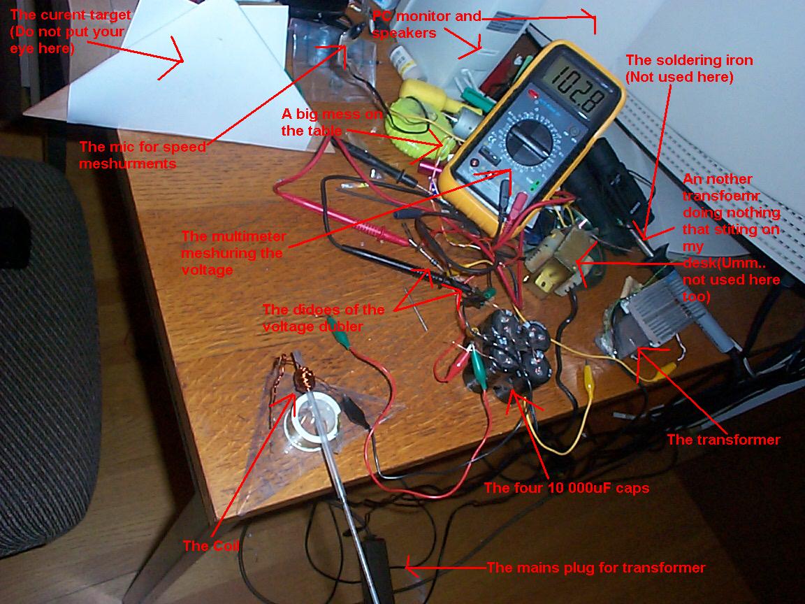

This is the mess on the table i made today whith my coilgun experementing.
I got an 2 x 45 mm iron rod flying at 30km/h
The mic is conected to my PC to record the fireing sound and the sound of the rod hiting the traget.The les miliseconds it tock the faster it went.(Thats how i caculated the speed)
The 4 caps are in a voltage dubler so its the same as one 20 000uF 128V cap.
Yea that rod goes damn fast.
In one fire i almost hit the light bulb. :oops:
The coil is 0,2 Ohm and the caps are charged to 100V.So mr. Ohm says there is 500A going trough it
I didnt use that fancy SCR and timing stuff. I just had an mechanical switch that makes an REALY bright spark.

Thats how I measure speeds! You should if working with high speeds however, put the mic centrally between the muzzle and target plate, to equalise sound travel times. I have a LEGO thing that uses 3 of the the little ink cartidges from inside biros, empied of ink to form a 1mm diameter barrell. Then, I use the LEGO pnumatic system to release compressed air into it. Using a suitable size piece of wire inside that barrell and a bit of water to seal it, it can travel at 190kmh. Its incredibly light, but zips through grapes, makes holes in sheets of paper balancing on edge without knocking them down and leaves one hell of a mark :lol: . Obviously, care is taken using it. Range is suprisingly large, it takes a very long time to come back to earth if fires upwards, I might time it, should be easy to do.

But this rod is heavyer.If it hits an solid object qite a lot of force is made.It can probobly crack an window if yoi fire at it.It once bounced from an plastic box in to an glass of juce on the table and it made an afuly loud ping.The glass is luckuly still on one pece.It it was a direct hit it wod mostprobobly break.
I had to make the fiering platform heavyer to becose the recoil moves the whole thing.
It may be interesting to put an nedle in it to see if it wod enbed it self in frout or styrofoam.
Il do some more testing tomorow.
Oh and wen i fire the triger switch I can feal the heat that is made in the spark from about 15 cm! So thats a lot of IR made by that spark.
I didnt yet try to fire screws.Since i have it "calibrated" for that iron rod.
I wont go any lower whith the coils resistance since 0.2Ohm makes an huge sprk on thurn on.
The rod got magnetised after the first shot.(This shod be able to realy screw up TVs and monitors)
Anyway heres the diary of the speeds:
first atempt: 11 km/h
beter coil : 24 km/h
more caps: 30km/h
Yeah, 30kmh is good going for coilguns, they are generally regarded as very inefficient. If you are just experimenting, thats cool, but if you really wanted to make an improvement you should try an SCR. You can get a suitable one for just £3 or so (400A peak, 1000v) and they are very easy to use. That heat from the spark is essentially wasted energy, an SCR should stay pretty cool in use.
I would like to experiment with coilguns, I think the beauty of it is how it can be totally silent. They can get pretty expensive pretty quickly though, those capacitors are costly. Where do you get your 100volts from by the way? I wouldn't like to try it with the mains, thats always put me off, the fairly high voltages needed.
We have 220V mains over here.
I use an trasformer used in a VCR.It has many voltages including an 50V winding that was used for an VFD.
I have them wired in an voltage dubler that makes it 100V.This also makes full use of the cap.(Simply wiering then serial halfs the capacitence and that is bad)
The caps ware $13 in US cash.
Anyway i made the switch beter my giving it a much biger surface therfore making less resistance over the contats and les voltage loss.
Also the fire is not that loud.Expecialy wen puting it in a box.So the fireing is not all the loud.But it is realy loud wen the projectile hits the target()
I also had an coil out of 0,4 mm wire and it got prety hot after one fireing(Almost too hot to toch)
Also the original crocodile clip wires ware certanly not up for the job so i replaced then whith much thicker wires.
Anynyway its completly isolated from the mains.And not a lot of wires exposed.
I also once got a good leson from an 10 uF cap charged to about 250 V.It felt like i got stung in my finger by a nedle.
Oh and 100V is not so high wen talking about coil guns.Some use up to 1kV(Prethy big caps too)
A guy made an coil gun that worked of an batery and was able to fire an projectile right trough an soda can like nothing.And he had lots and lots of caps.
But coil guns are pretly cool is you ask me.There is just an iron rod adn then a pop and its gone.Its just like magic.
