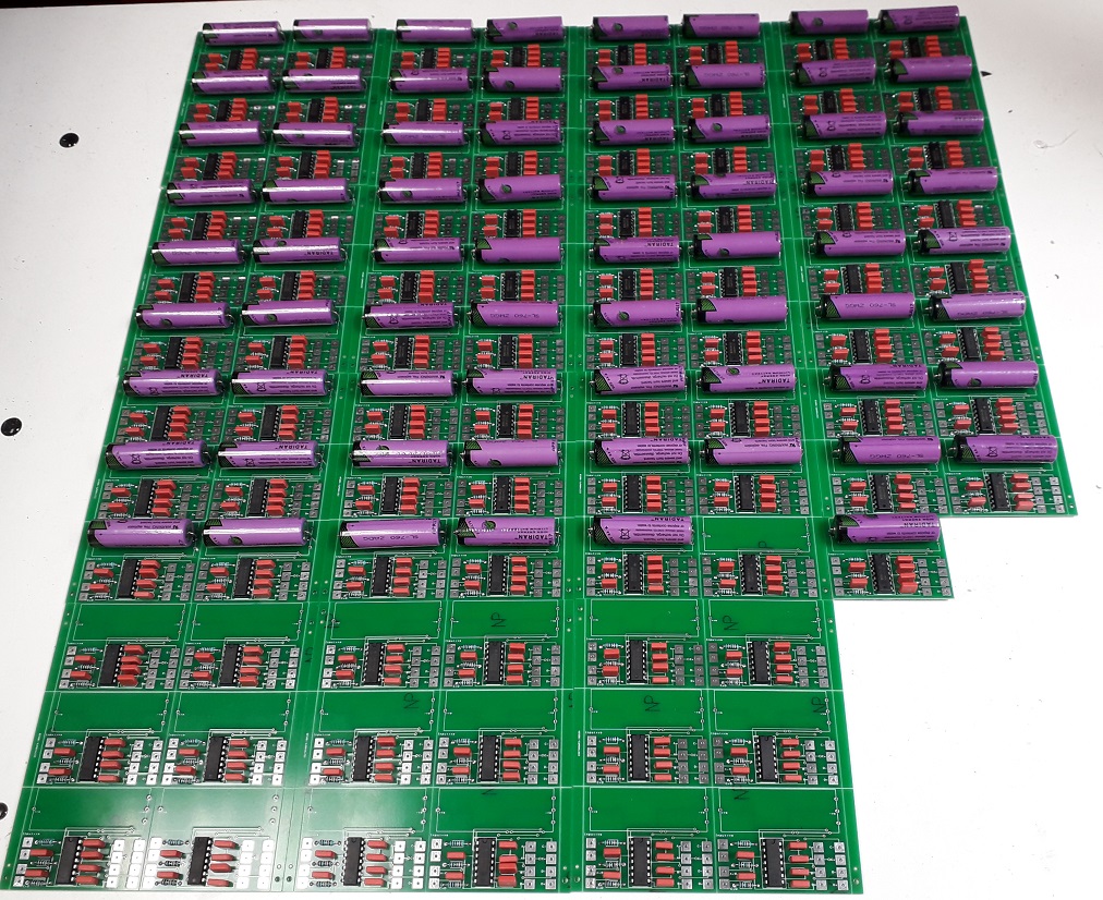

Here's some I've used today on some boards I've been building up:
These are Tadiran batteries, Lithium 3.6V, 2.6Ah and used for their long life (in excess of five years) and good in cold conditions - the boards will next be fitted in boxes, wired, and then potted.
The boards with no batteries are because I used all we had - but I think we ordered what we needed for this job? (it's hard to be sure, as we've already supplied part of the order from ready made stock - and I'm not sure how many that was). But I started populating boards until I ran out of 100K resistors, on the grounds we'll have some ready in stock for next time, rather than bothering counting the boards.
Nigel, please swap the two boards in row nine so my OCD is happier.
The RHS one is a single board (which I rather foolishly fitted the battery to first), the rest are all 3x2 panels.
Anyway, I've split them all apart now, and dropped them in the boxes (and wired 5 so far), the boxes have been drilled already, and the correct number - same as the number of batteries I had.
