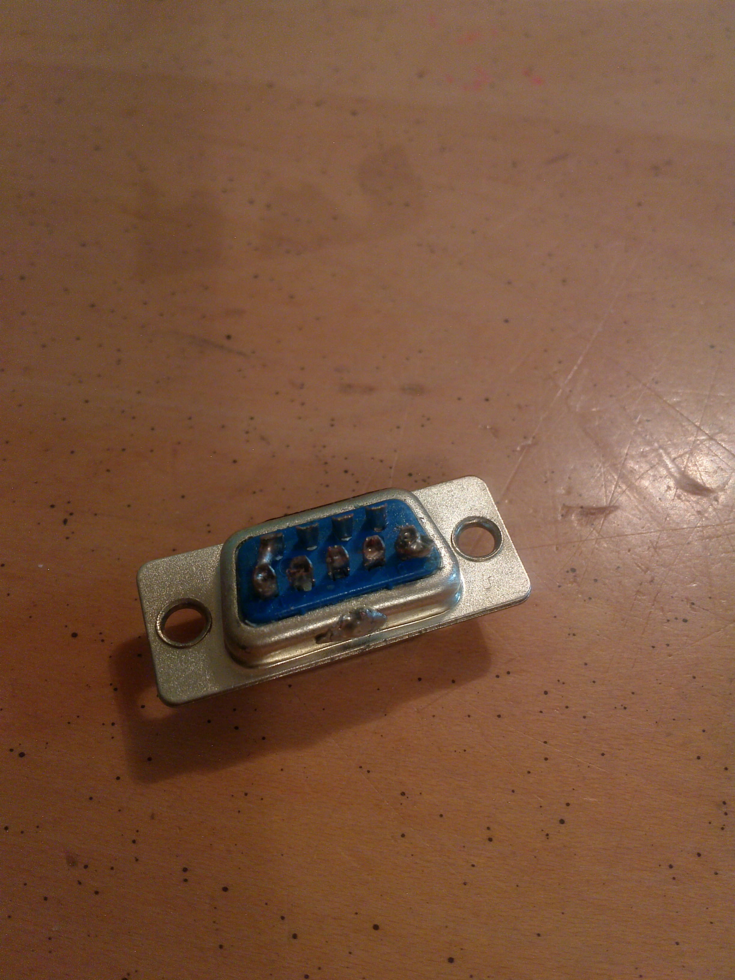

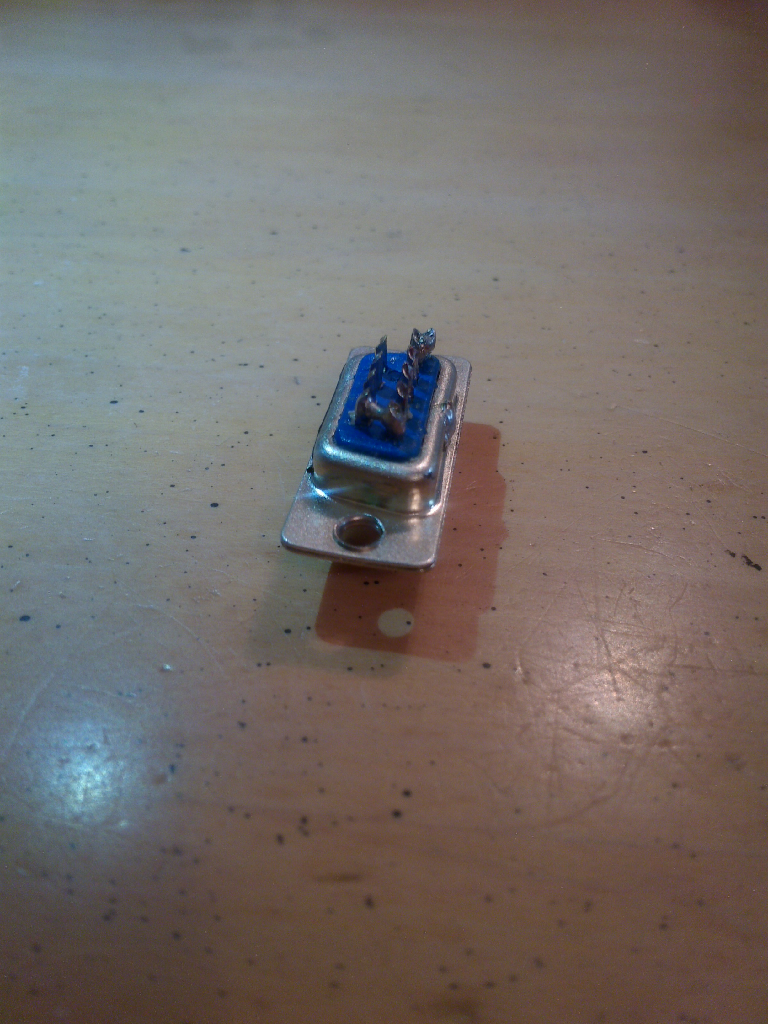

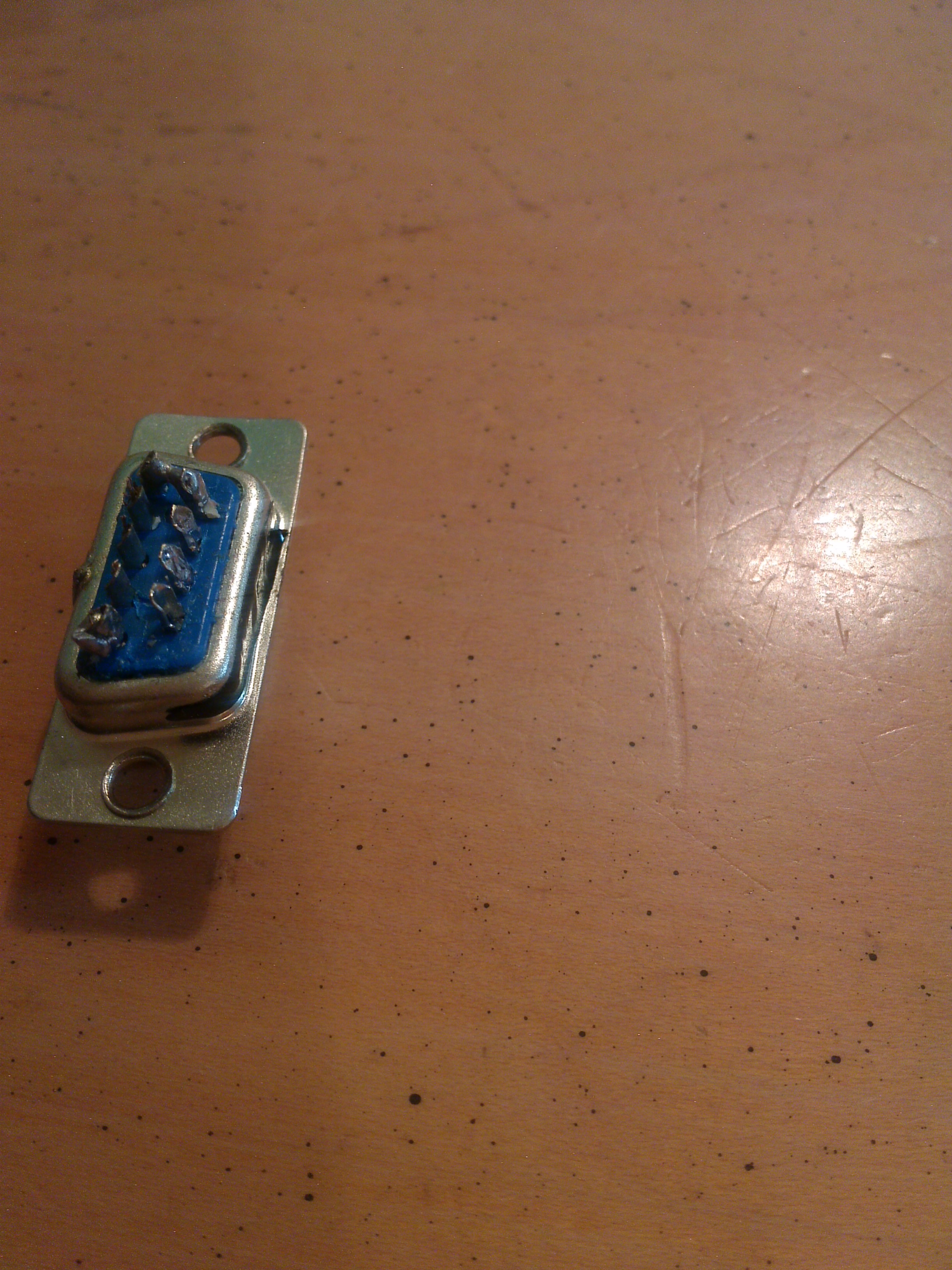

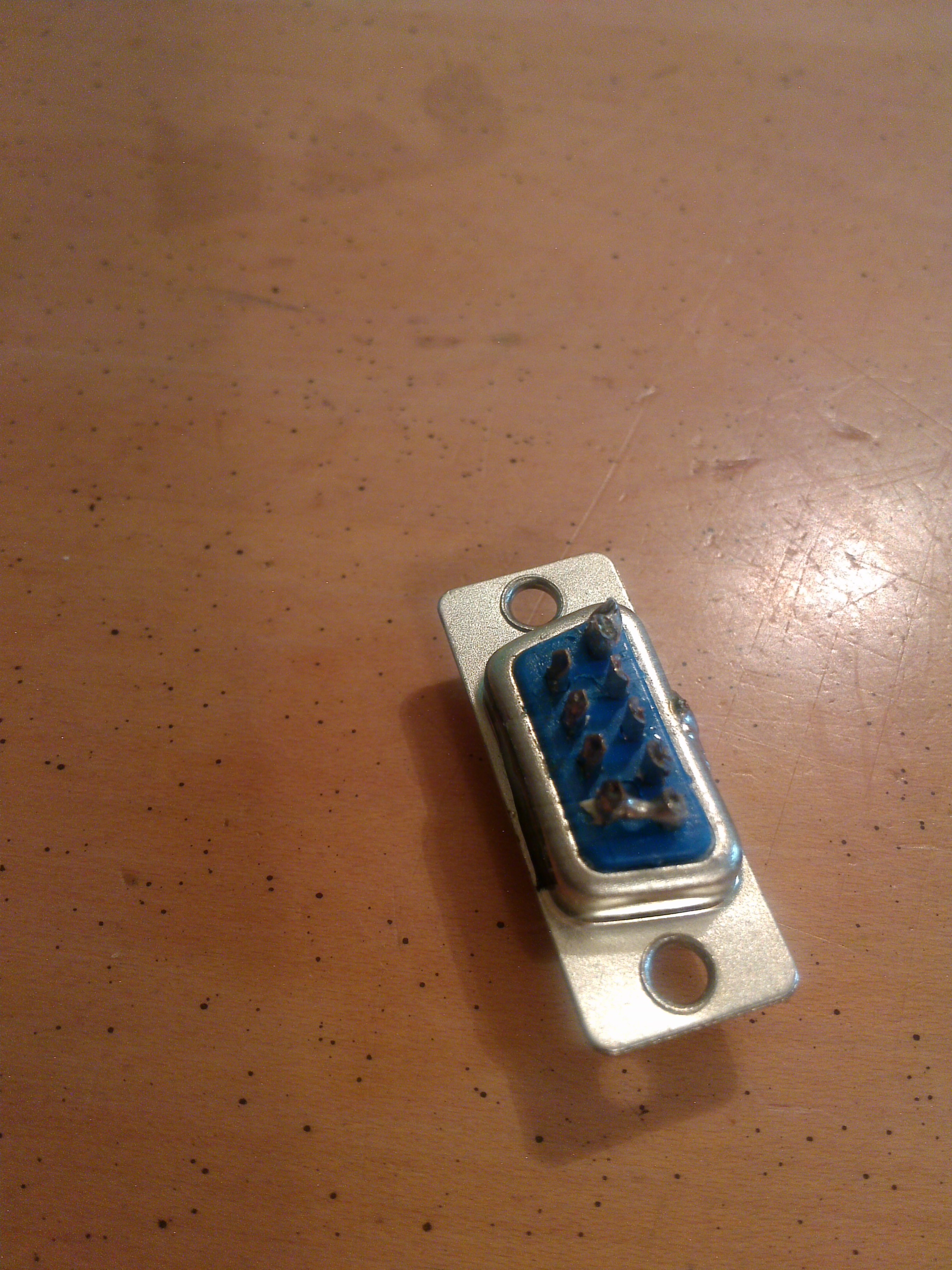

Here is a pic of the old end notice a blob of solder almost looks like it is grouned to a pin also appears to be a bridge between 6 and 7

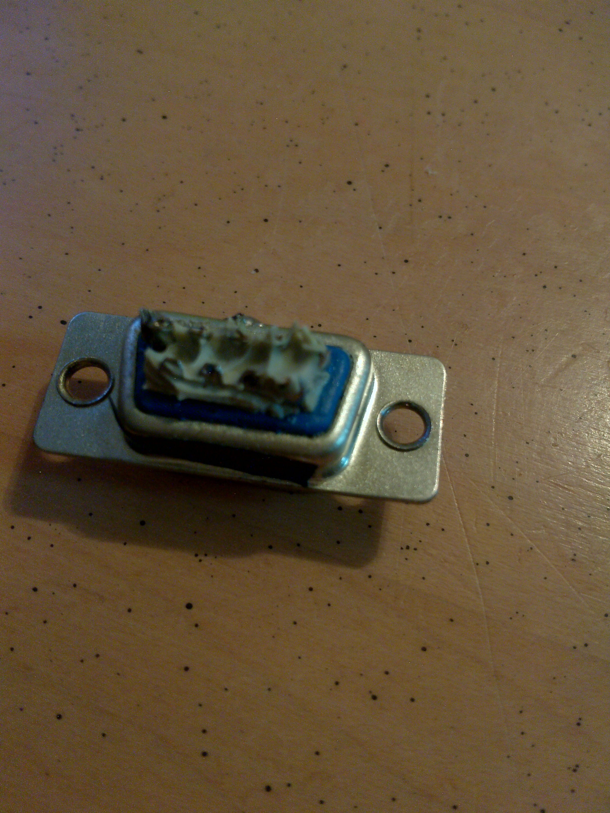

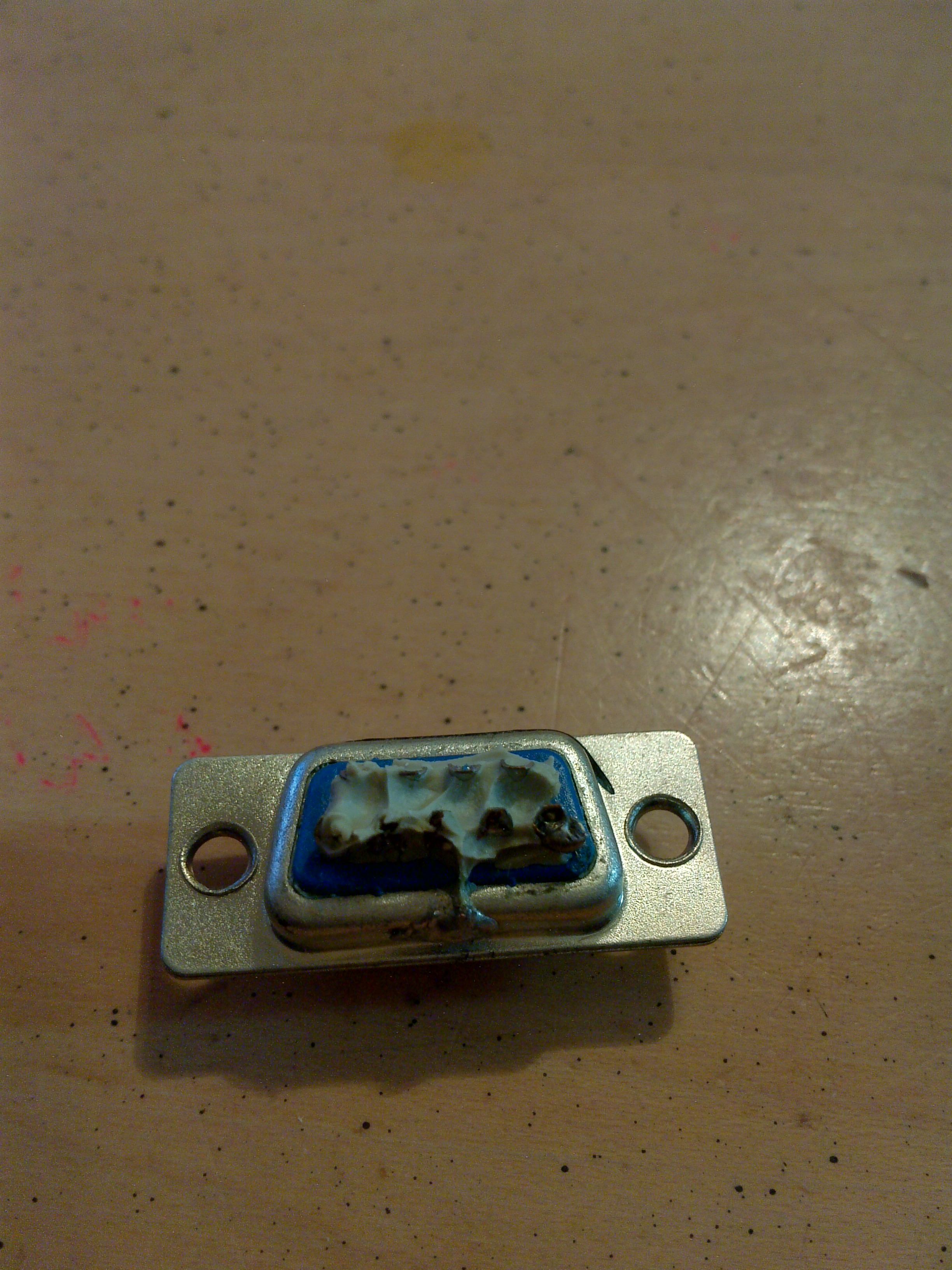

Here are some better pics of that plug that broke...might help a bit will try to clean it up a bit and take more

The pic is way out of focus.
Sometimes if you use a flash, you can put a piece of paper in front of it to diffuse the light, but it's best to illuminate the object and not use a flash.

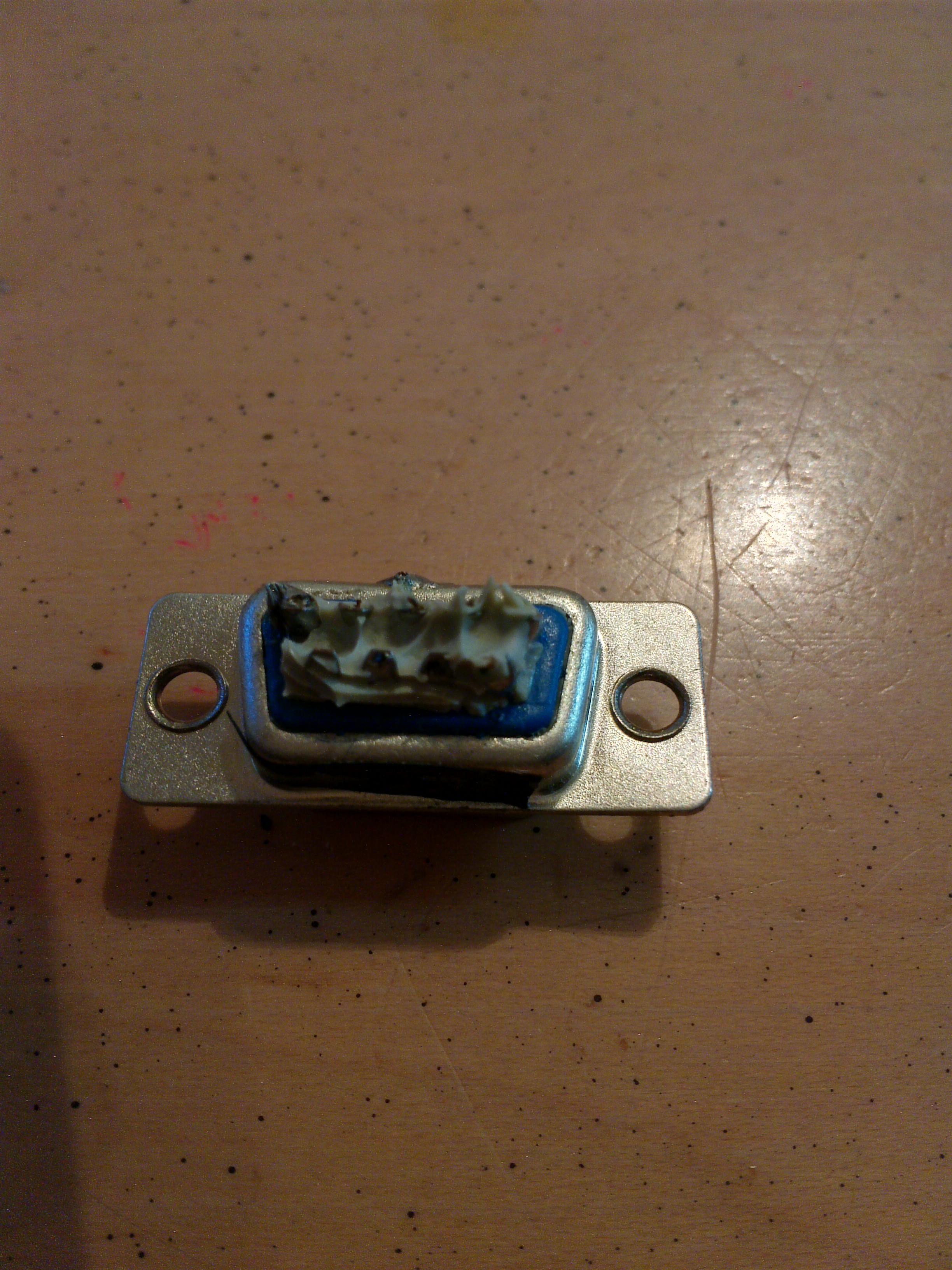

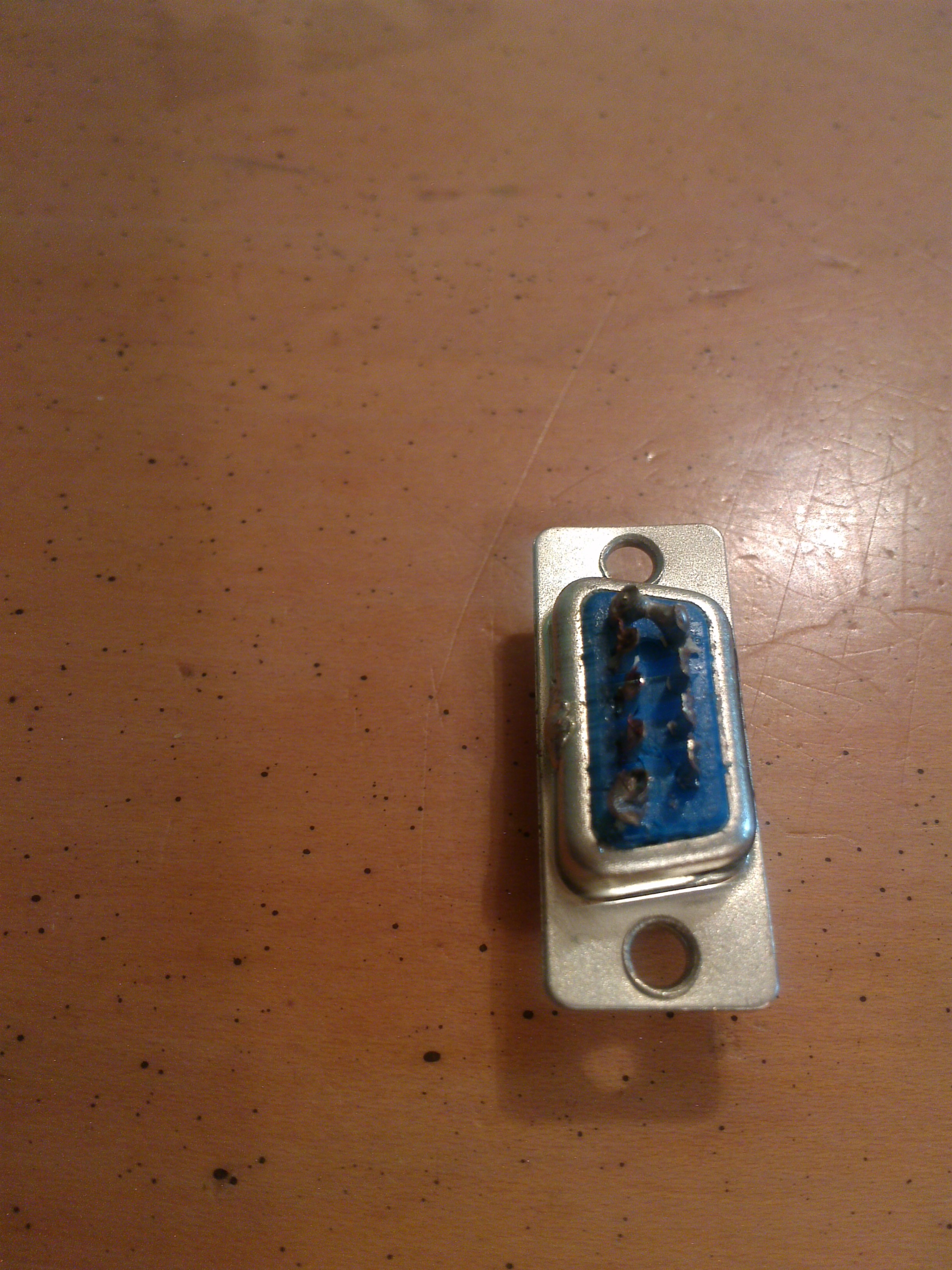

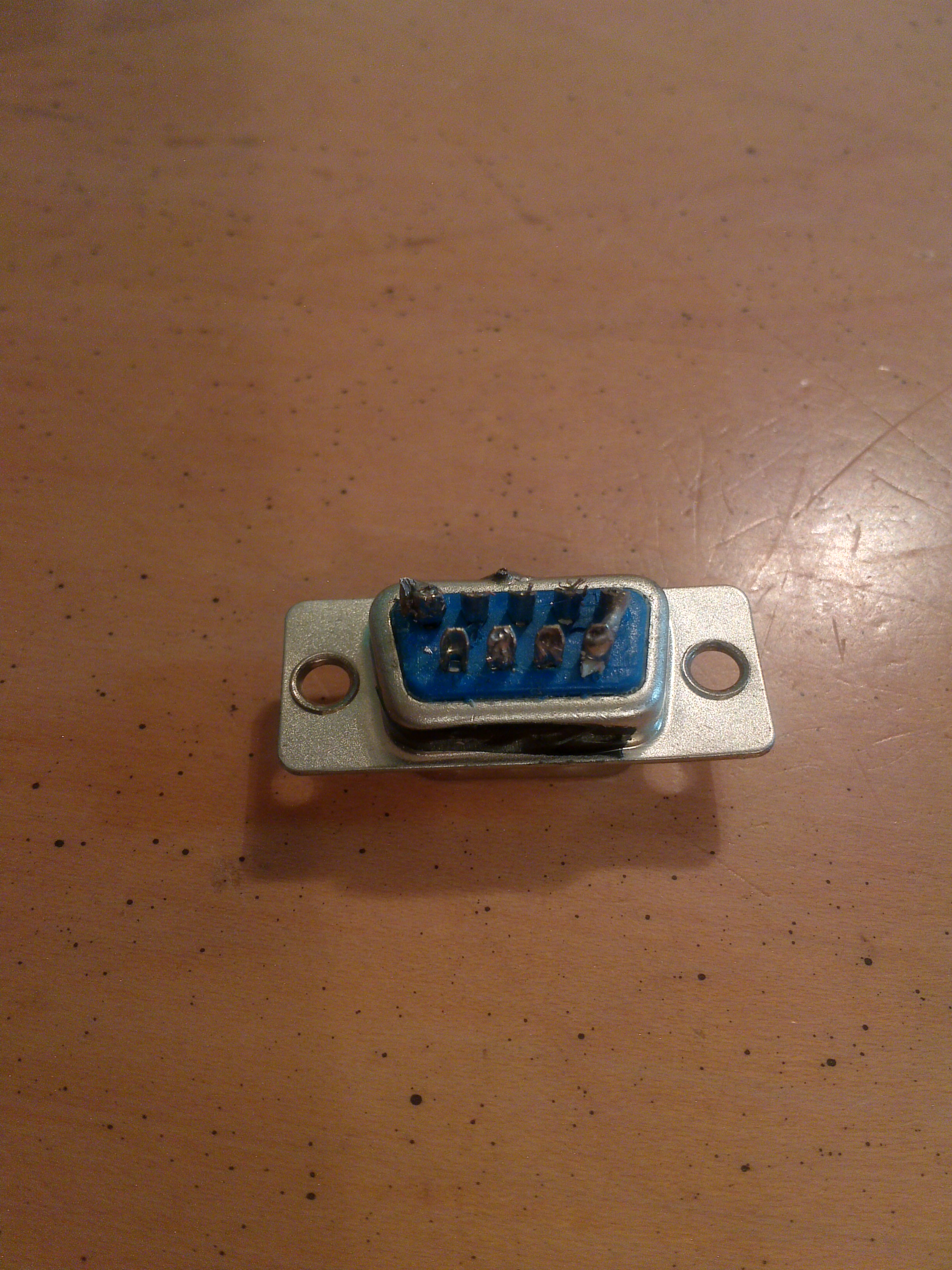

Cleaned up

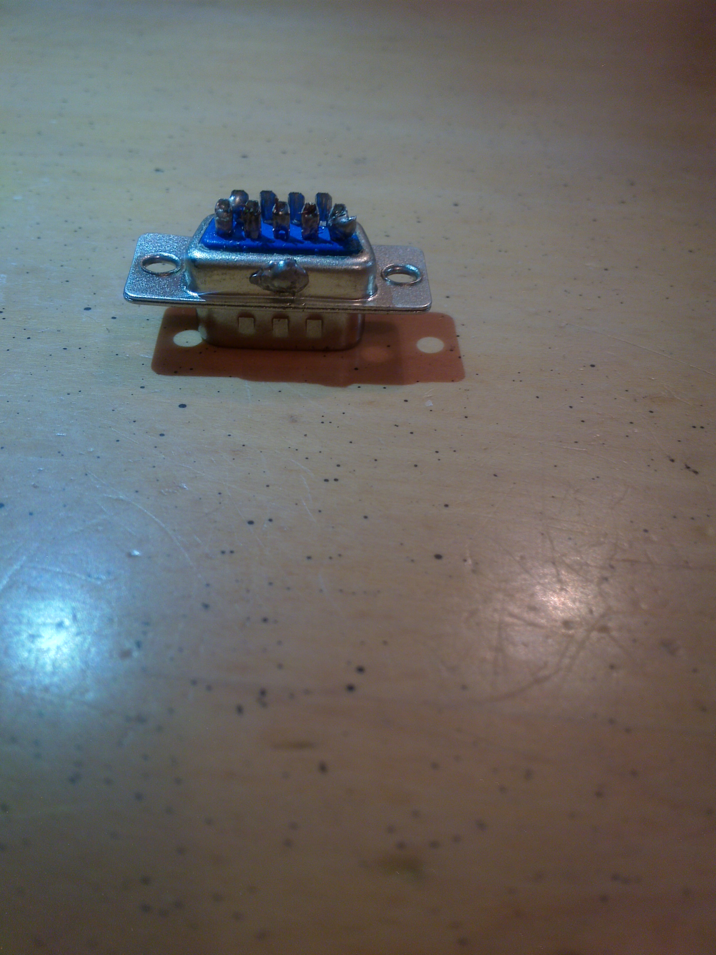

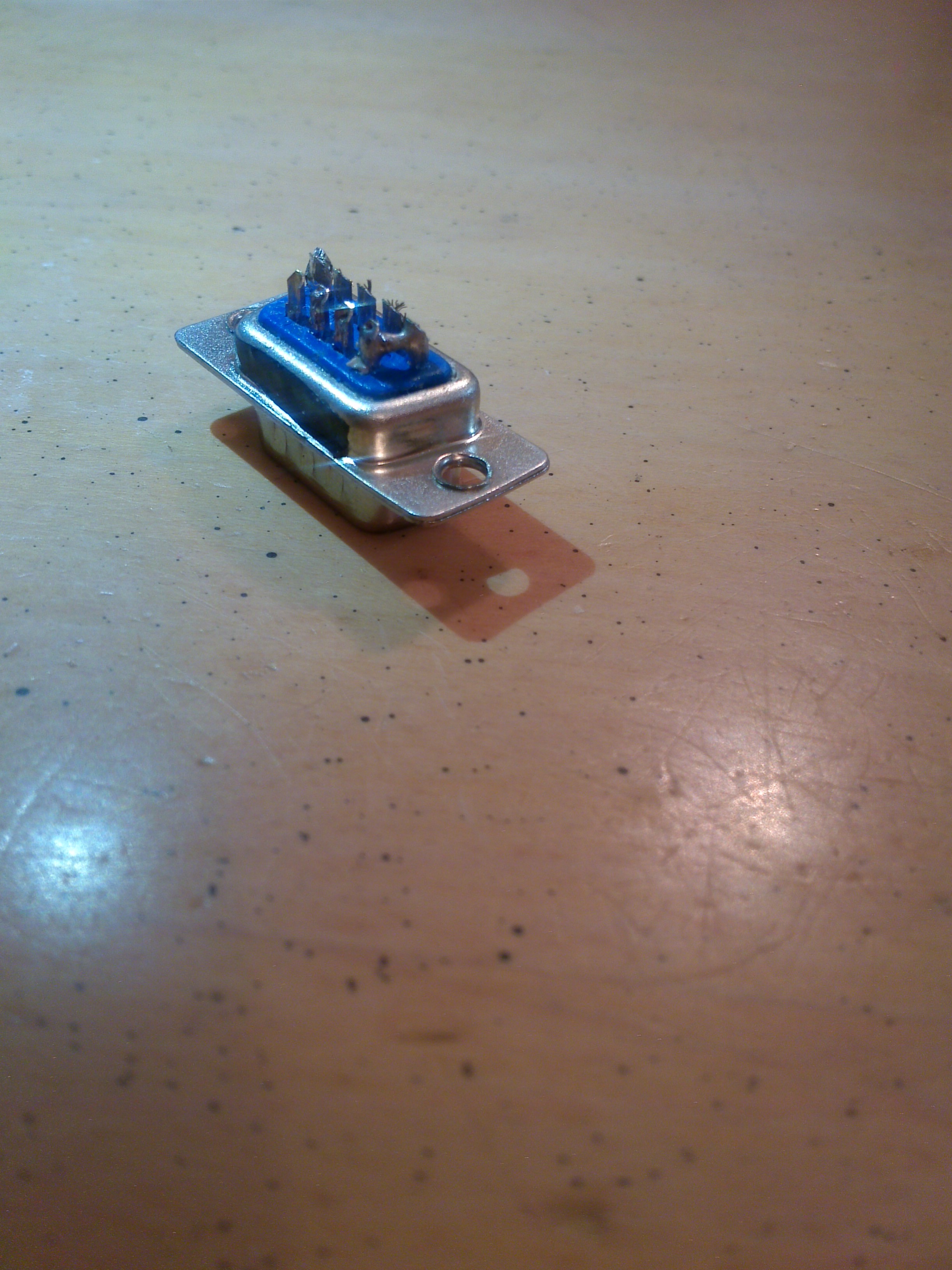

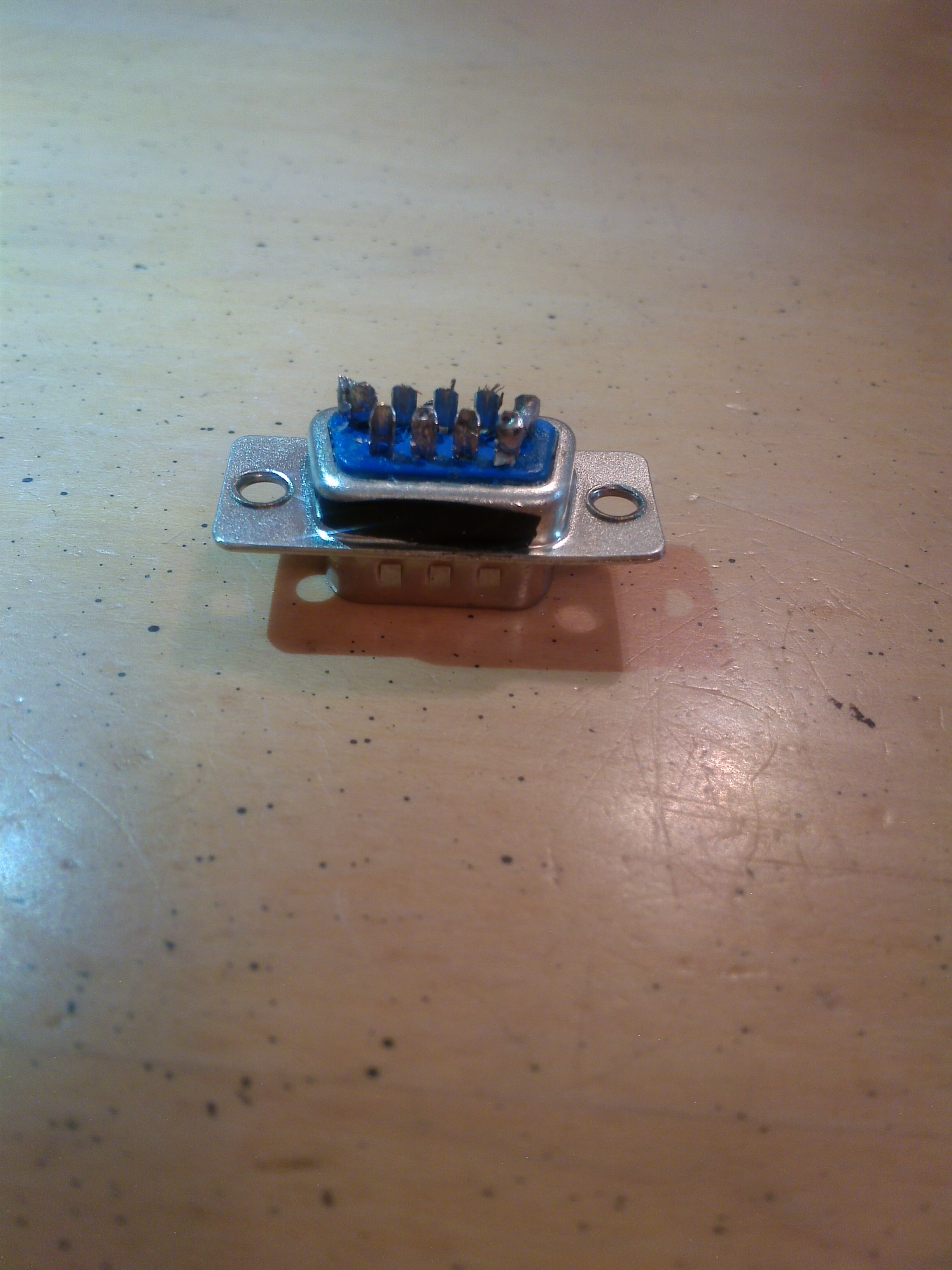

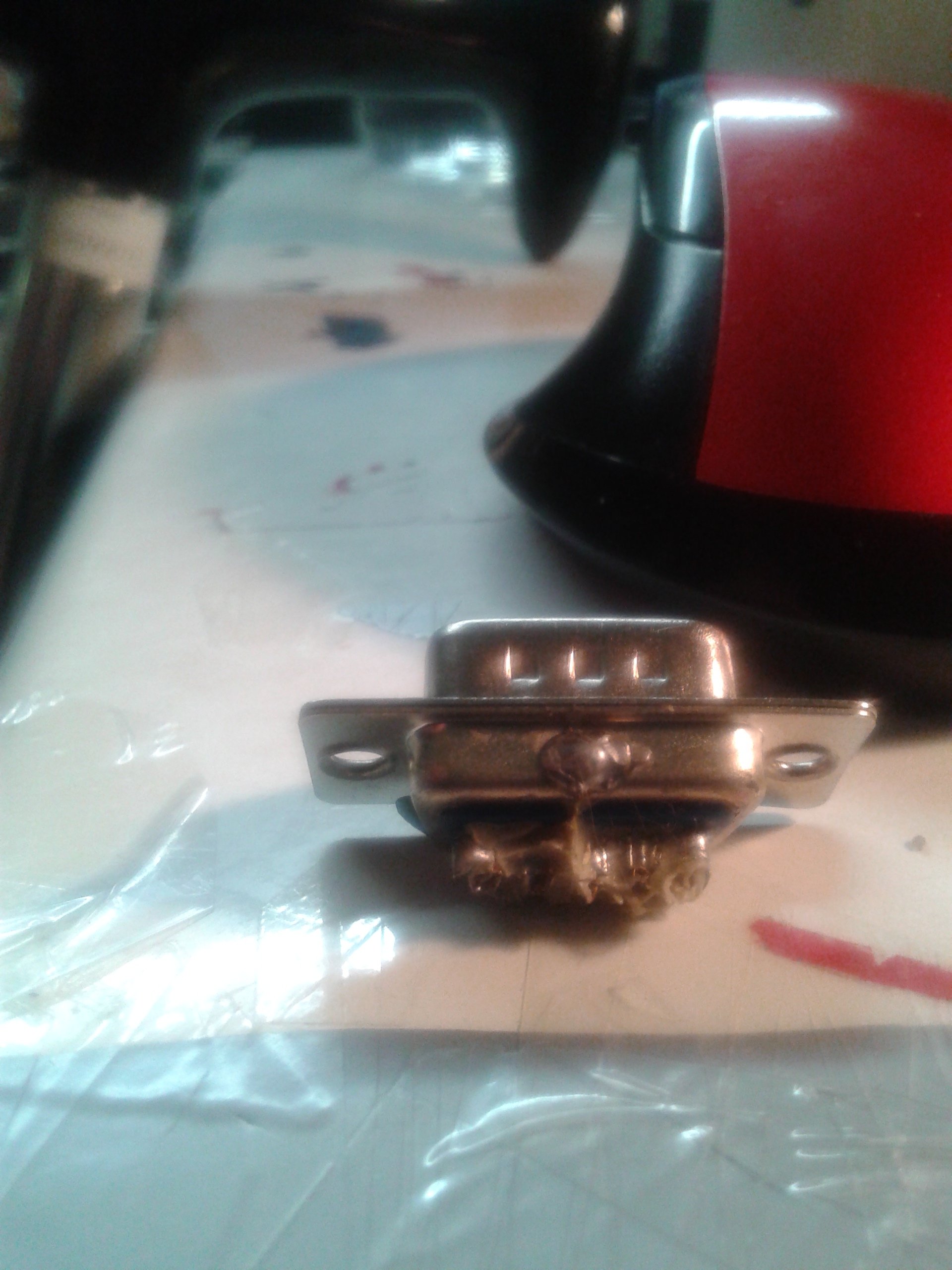

OK few more with more light

So you have a bridge between 1 and 6.
SG and the solder blob are likely connected together.
With the cutter turned off, you could measure the resistance from SG to any metal exposed part on the cutter. They should be connected.
and/or
The shield of your cable is connected to the blob on one side.
OK haven't tried last configuration in post #61 yet. Should I go ahead and give that a test or does the close ups of the old plug change things?
Les's suggestion is essentially the same as what I suggested.
SG really should be connected to chassis ground. Shielded cables are sometimes used, but rarely.
If you just do the 2/3 swap and connect 5 AND set the software to no flow control rather than hardware flow control, you LIKELY (not sure though) can send a really small job to the printer.
That's why it's so nice to have a breakout box.
Confirm again: You basically have pins on the cutter and pins on the PC so your cable is Female to Female. This generally would confirm a null modem cable.
