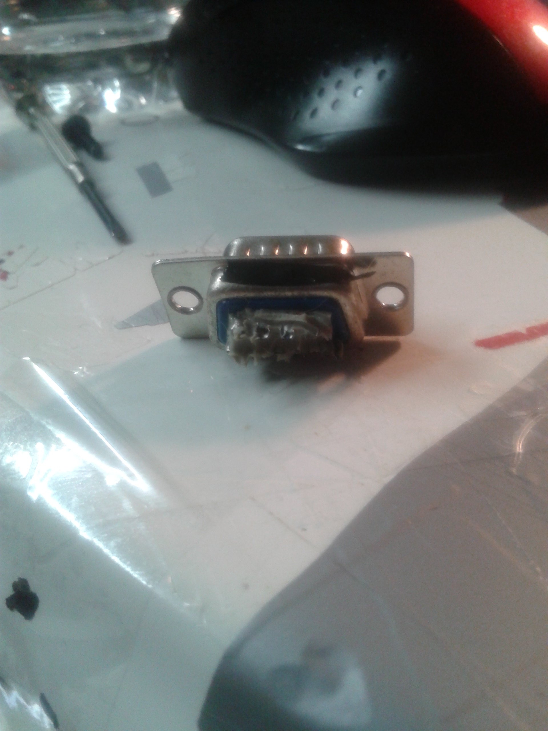

Hi BryWY,
I assume the picture 002926.jpg is the original cable that you damaged and the connector in the picture is the female end that plus into the computer. Start by using your multimeter on a low ohms range to identify which pins the wires go to on the cable and make a table. You have not given any information on the nature of the damage to the male end. Unless it has been totally destroyed it should be possible to identify which colour wire goes to which pin. You may have to very carefully cut through the plastic moulding with a craft knife just shaving of a bit at a time until you can identify which wires go to which pins. If this is not possible for example the connector has been totally destroyed under a 100 tone press then I suggest this approach. Measure the voltage both at the PC end and the plotter end with respect to pin 5 (Ground.) of all the other the other pins on the connector and make a table for each end . (Include the polarity of the voltages.) When you have done this post the two tables. From this we should be able to tell if it is a straight through or crossover cable.
Les.
here is a pic of old one tried carefully peeling back layers of old one but it was like a blob of tar impossible to tell which wire went where
OK got neg reading on blue yellow and brown previous ost was able to determine pin config to wire color using ohm meter

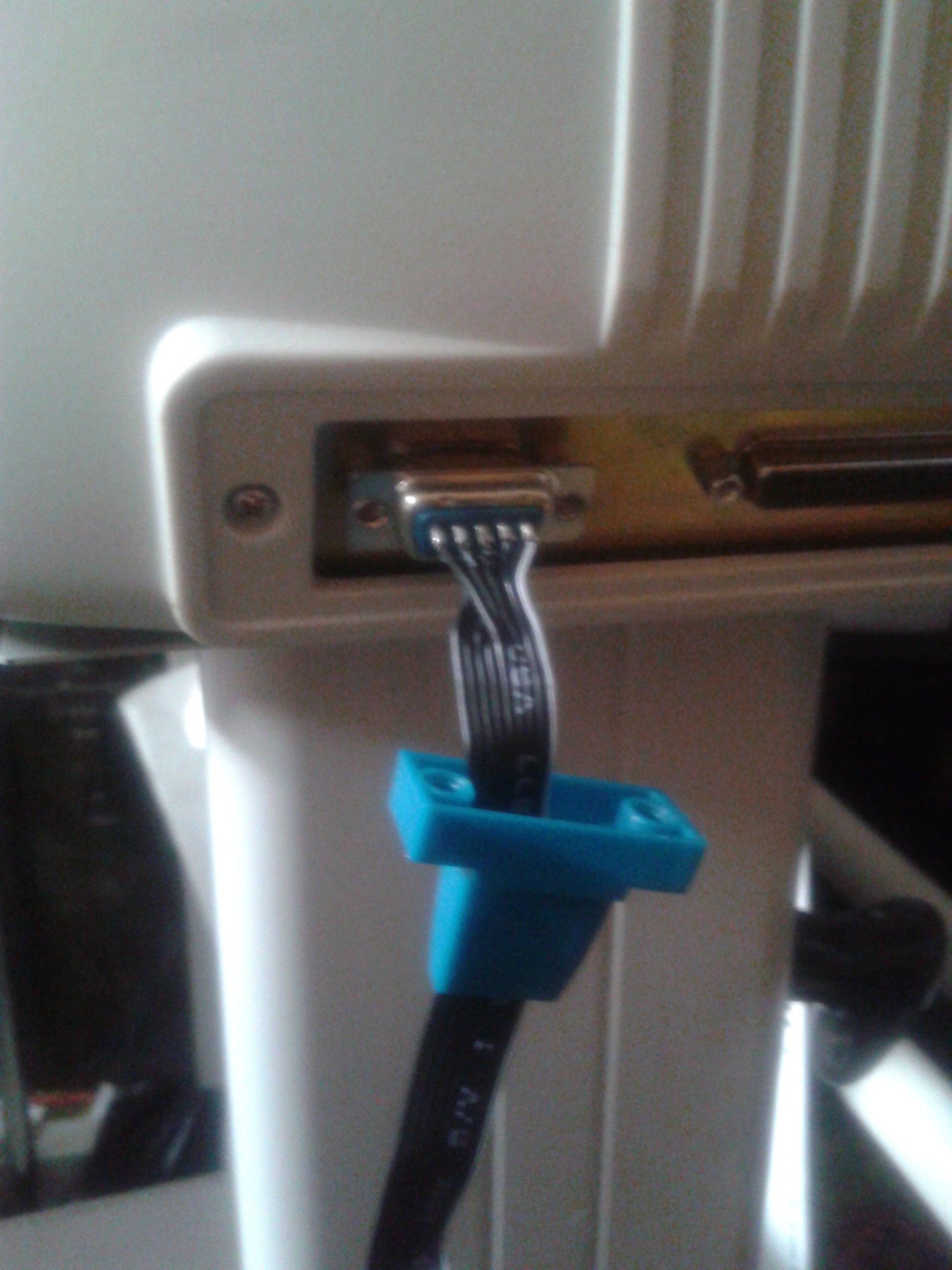

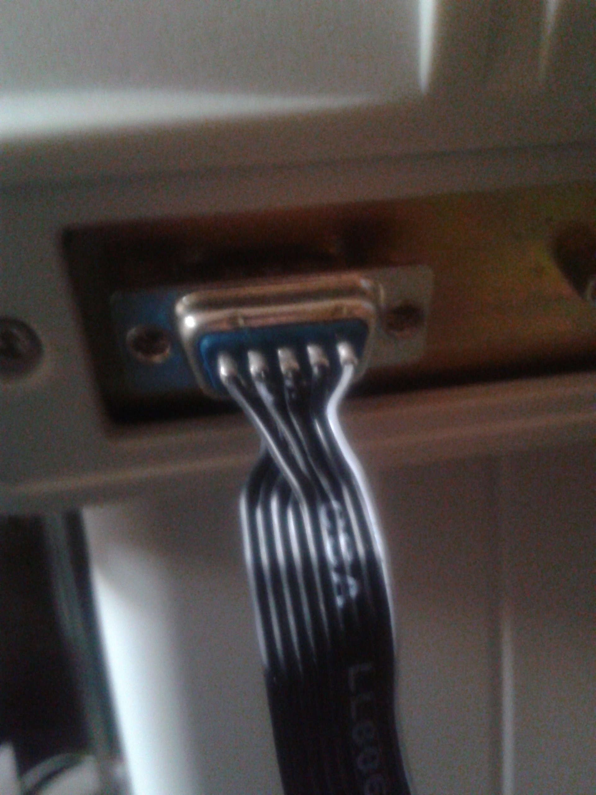

With reference to post #25 I was hoping to identify the colours of the wires going to the pins on the male end but it looks like they have broken off right at the pins. In post #27 I mean to use your old cable (Still with the female end attached.) and solder a male connector to the end of the cable that has broken off from the original male end.
Les.
I have a male plug with a ribbon cable attached
You made a couple of measurements that to me indicate a NULL modem cable.
I really want to warn you how the pins go. Pay attention to the numbering.
The top one, is probably the most likely to work: **broken link removed**

A Guy emailed me and told me The serial cable is null-modem crossover 9-pin to 9-pin serial cable...if that helps
yes.

From your test in post #23 it is not a full null modem cable that provides full handshaking. This is because on the female connector (Computer end) you say that pins 1 (DCD, 4 (DTR) & 6 (DSR) are connected together. This means that the connector on the computer end is cheating the full handshake . Ronsimpson in post #2 gave you the wiring diagram for a null modem cable. Normally a null modem cable would have a female connector on both ends. In post #24 I asked you to measure the voltages on all the pins with respect to pin 5 (Ground) at both ends. We know that at the computer end that pin 3 will be transmit so it will be between - 5 volts and -20 volts with respect to pin 5. If we knew the voltages on pins 2 and 3 at the plotter end we would know definitely if a straight cable or a null modem cable is required.
