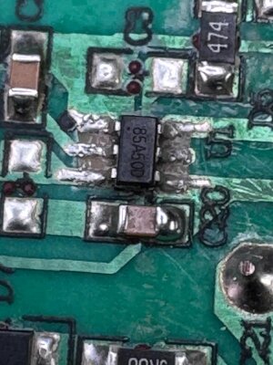

I have a quad charger that is split into 4 separate sections and one section doesn’t charge anymore. I have located what I think is a thermistor and on the shrink tube it says 125degrees C. I cut the shrink tube and it s a 33ohms resistor. I am including pictures of it. Please help me identify it. So, it should test at 0.4 ohms and probably go up in resistance with the rise in temp, instead it's OC

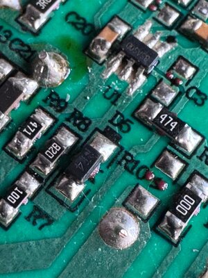

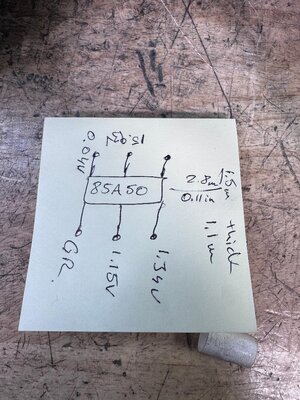

I have another component I need help with it's an IC it has a U underneath on the pcb and it's marked 85A50D.
I tried to identify it and cannot find it. It was part of short to ground that caused a few issues. I measured it in circuit while plugged in to get some voltages. From ground to pins 1,2 and ?3 I get diode voltage drop 0.5V
