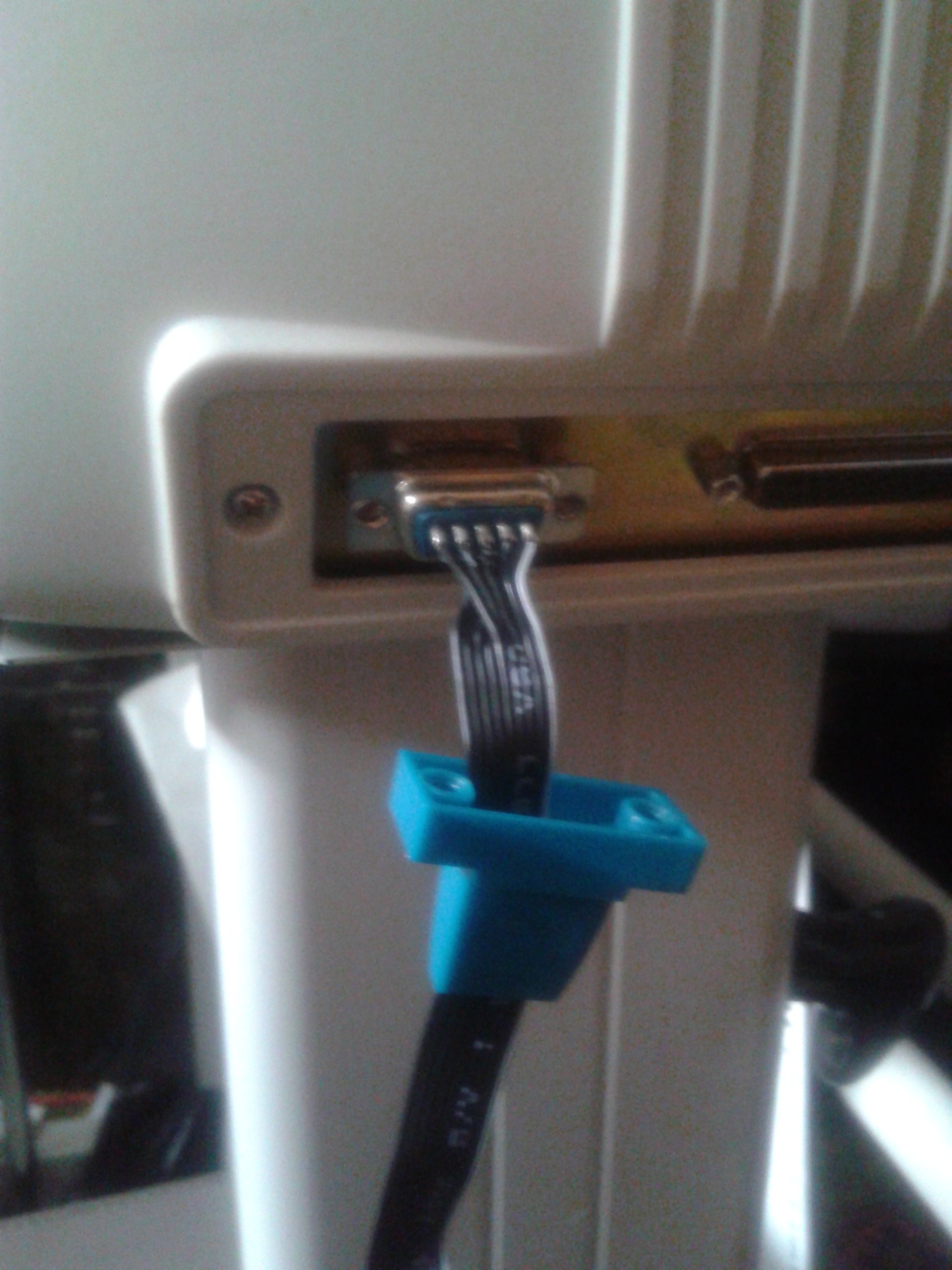

I am wondering if you could take a few minutes to assist me as I am in a bit of a bind ...I live in a remote area where I do not have access to a computer outlet where I can go out an buy a replacment cable for my Desay master vinyl plotter which I have pending jobs get done asap.

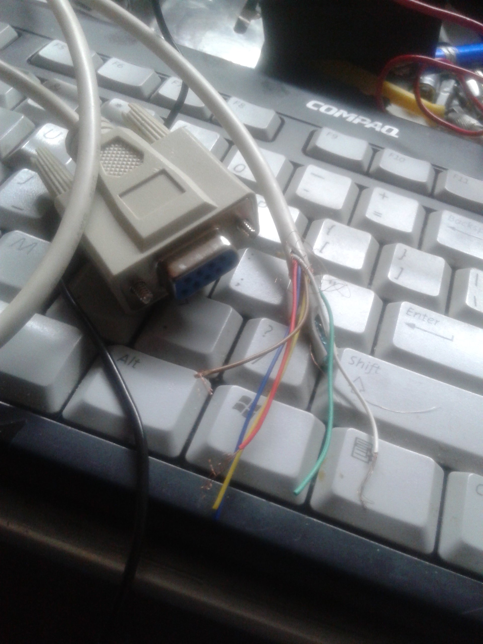

I accidently broke the male end going to my plotter off my cable. I found a generic male end all wires one color I would like to use. So I spliced the cable and found there are 7 wires in the cable red white brown green blue yellow and copper on outside.
I am wondering where I can g to find the correct wiring configuration ...any assistance you could provide would be much appreciated.

Believe it or not, the wires may actually have numbers written on them. Look carefullly.

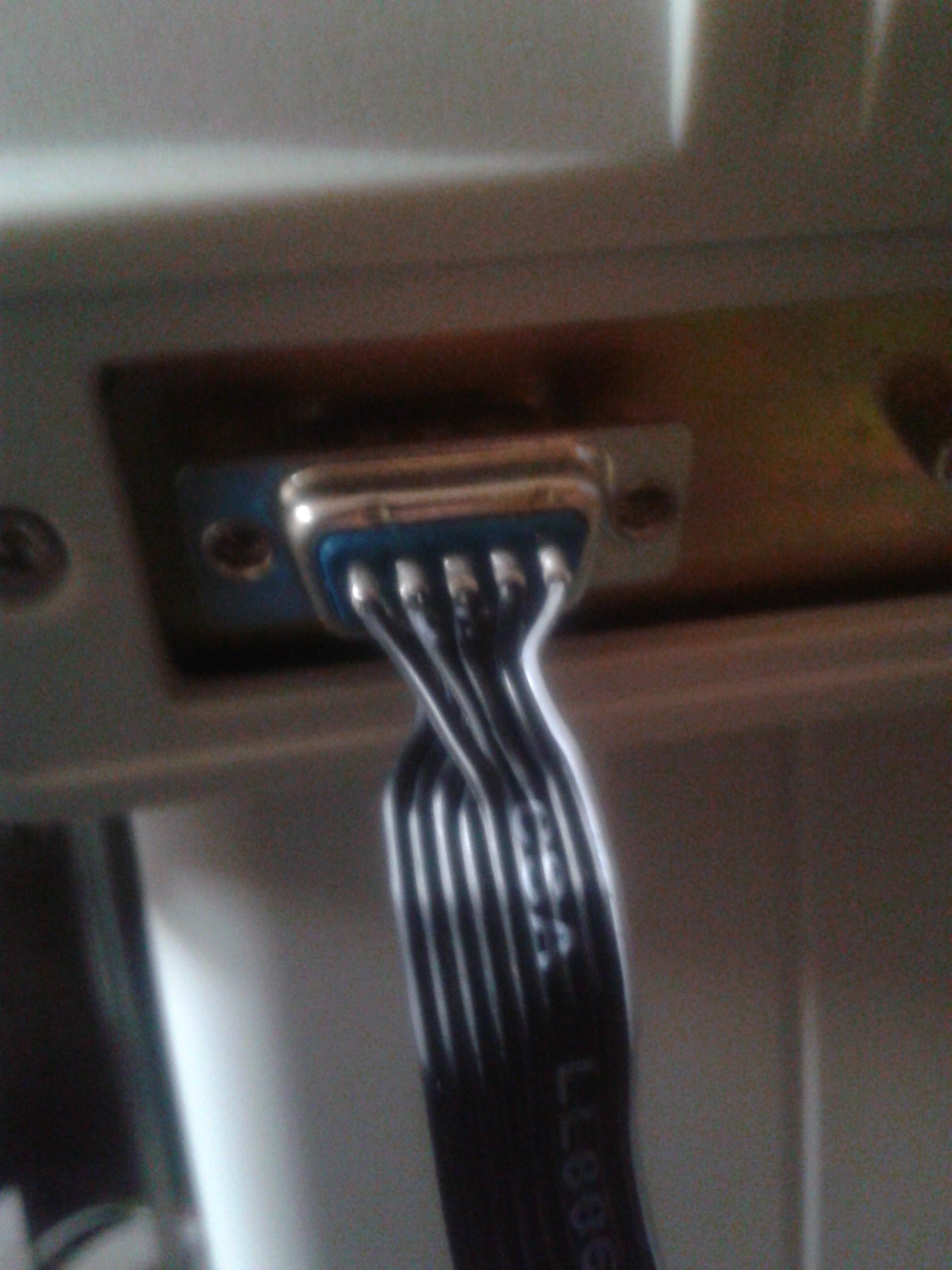

It is 9 pin ...male from plotter to pc 9 pin female (I would like to convert it to usb eventually) to use it on my laptop.

Your empty pins should be one on one row and one on the other at opposite ends. (diagonal).
my little ribbon cable that i plug in plotter male has number one pin with white stripe...now what configuration would you suggest i try?

I'm initially interested in pin 5 to 4 and pin 5 to 6 on the plotter. Pin 5 is likely connected to chassis. No cable attached, but plotter on.
We definitely need a couple of pictures. There is an Upload a File.
So, your plugging in a 9 pin ribbon to a 9 pin ribbon with D connectors on them?
Basically, they are meant to be squished together because they are IDC or Interdigitated contacts. They don't make very good null modem cables.
the cable that worked and the ribbon cable temporary fix
