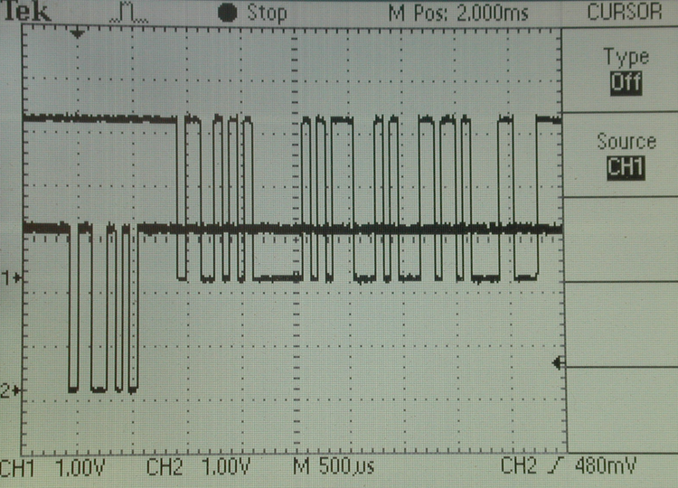

I have a device (electronic level) with a control board/readout and a sensor board. They are connected with a 4-wire cable. I would like to use wireless communication between the two boards, but know close to nothing about serial communications. I have used Linx Technologies wireless Rx/Tx for encoded communications. I would like to avoid using a microcontroller just for simplicity sake.
Here is a tracing of the communications between the controller and sensor:
oscope_level_150-png.52551
The bottom trace is sent from the controller to the sensor. The sensor response is shown in the upper trace. With the various modules available, for example these: https://www.digi.com/products/wireless-wired-embedded-solutions/zigbee-rf-modules/
How does one control the timing and recognition of the request data? Can anyone suggest a good introductory manual wth maybe some examples?

Several things to consider:
> This is command/response so both ends need to tx & rx. If command overlaps response (as trace image implies), you'll need 2 frequencies for full duplex communication. Otherwise, 1 frequency as half duplex will work.
> Either way you'll be way ahead using micros to manage it.
> You don't "Need" to break the protocol, just keep the pulse train exact. But, it's way easier if you do, they're probably using a std baud rate and format. I'd try asking the mfgr, they might surprise you.
> Going wireless, you may want some sort of block check / error detection scheme. Again, a micro is basically required to manage this.
Good Hunting, I've found RF to be a lot easier to say than do. <<<)))
Thanks for the response. I don't see any overlap in the request and response signals. They are about 350 uS apart. Request is the lower trace. I was hoping to find something like a "pass through" OOK transceiver. By pass through, I mean a transmitter that simply duplicates the on/off signal it gets. The receiver would just pass the signal through to the existing circuit (following inversion, if needed).
I was worried about the delays mentioned on the datasheets. As best I can tell in playing with the sender and display units on my bench, the response must be received within a certain window after the request. I don't believe the window is too tight, but some of the delays mentioned were in the 30 to 50 mS range, which might be a problem.

Got a couple of xBee's this week and they look promising. Baud is 14,400. I used a PIC 12F509 to generate the query code (0)11001010(1) and the sensor sends nice data packets. The received and sent packets are almost identical. The control unit responds, but because the data to and queries from the control unit are out of sync, the linkage is not real stable. I am working on flow control at the control (receive) end and don't understand the RTS pin operation as described here:

As you might know, Sears puts all its tools on sale constantly. I paid about $24 for it last Spring. The actual sensor element is a Memsi MXD2020E/FL, Both the sensor board and controller board have microcontrollers on them. The sensor I believe is an 8051 (marked F301) -- not completely sure of either. I show what the data looks like in my earlier post. The display board is a COB glob.
The 12F509 directly interrogates the sensor (i.e., no RF link). That was done for development purposes. Once I get the control module timing solved, I can probably do away with that. I suspect the sensor simply sends raw PWM and temperature information in digital. The control module seems to do all of the calculations. I have not decoded the data, except to know that the first 8 bits are a repeat of the query and the last few bits look like noise.

Prompted by 3V0 (post#7), I wrote a little Assembly code to generate what is apparently a 7-byte data stream. (I can generate 8 bytes, if needed.) The first byte seems to be the handshake and repeats the query byte (0xCA). The second byte seems to be temperature: 0xF8 = 20°C and 0xF9 = 21°C. I am too tired to work on the other bytes tonight and have a busy day tomorrow. So, I won't be able to get to it until later. Anymore suggestions, help, etc? I still suspect the duty cycle is transmitted essentially raw without correction for temperature. Are there any common ways to transmit duty cycle?
