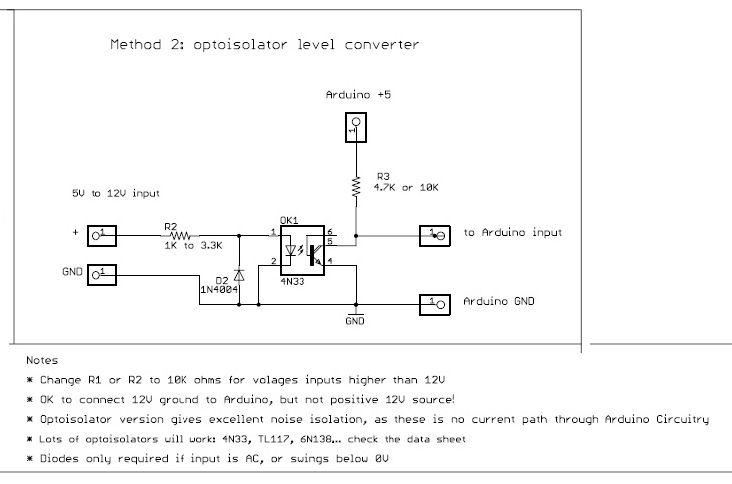

I need to know if the 120 VAC line is hot and get an isolated 5VDC output.
I googled up two design ideas (please see images). I would like something like them.
I like the first one because it uses a 4N33 (which I have on hand) but it may not be the best one to use.
Please advise. Thanks.
The first thing will provide a pulsating output. The second one will provide a somewhat steady DC voltage. But that same filtering action will hold the output high for a few dozen milliseconds after the power is removed.

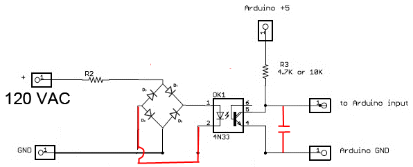

Circuit #1, R2 needs to be much higher value for 120V. Needs a capacitor on the output.
Circuit #2, Probably needs a diode across the input of the isolator. I like the capacitor in the output.
I can't find the part number(s) now but some time back this question came up and I found parts that have two diodes in the input. So plus or negative current will work.
You can make a full wave bridge, 4 diodes, ahead of the isolator so current will flow in the + and in the - half of the cycle. This really helps the output.

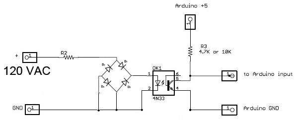

Based on the comments above, the following image is my suggestion.
My electronics knowledge is quite basic.
What value and wattage should R2 be?
I have lots of diodes for D1, D2, D3, and D4.
They are 1N715, 1N829, 1N914, 1n4005, and 1N4004.
Which one do you think or something else?
Should I add a cap from the rectifier output to ground?

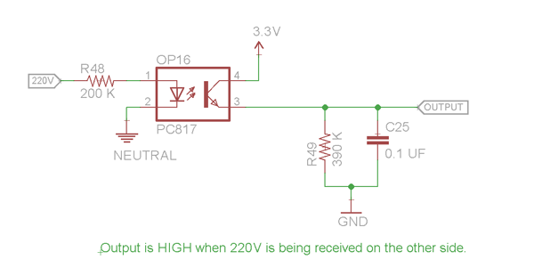

As an afterthought, I wonder if a neon light and a phototransistor combo might be a simpler, cheaper, better solution. If you think so, could you please suggest a part number for each.

A capacitor on the input or output of the OK1 will help.
I changed the diodes connections.
Use any small low voltage diodes. They will only see 1.5 volts. 1N914 will work fine.
R2: Many small resistor can not handle line voltages. You might use two resistors so each resistor only sees 1/2 of the line voltage. Put one resistor on line-1 and the other resistor on line-2.
R2: Value?? Pin 4/5 current is 1mA. The CTR for the 4N33 is 500% min, but that is at one point. At low current (and temperature) the CTR might be as low as 100%. So you need at least 1mA on the LED. 120k ohms will get you 1mA. (use two 68k resistors)
1mA * 120V = 120mW

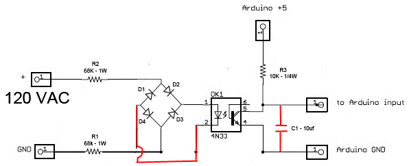

For Resistor placement, do you mean like this?
Do you think placing the cap on the input may be better?
