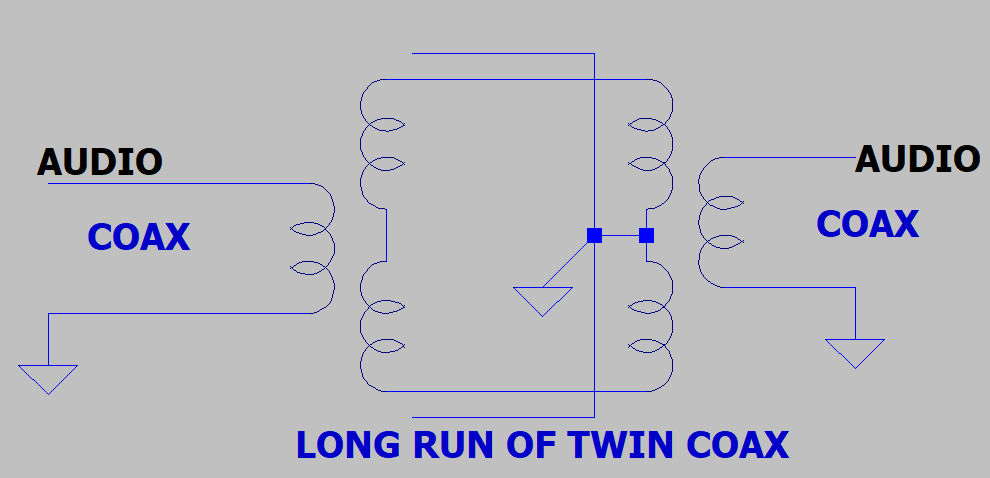

You have hum and noise on the shield of the coax.
Search for "audio isolation transformer balanced unbalanced".
There are little boxes that on the receiving end may remove the hum. "balanced to unbalanced"
If that alone does not work then you may need the opposite on the end of the cable.

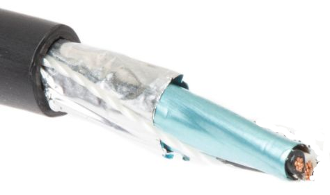

Audio cable for long runs: Note two shielded wires.
For long distance audio we use a coax with two wires inside the shield. The first transformer takes the "audio" & "ground" in and makes Ground, Audio & Not_Audio. (signal and the inverted signal) On the receiving end noise is on all three wires. The transformer takes the Signal & Inverted Signal and substrates them to get 2xSignal with out noise. The noise on the black wire and noise on the white wire are also substracted and = "0"
I think the microphone preamp has a balanced output signal plus a grounded shield but your TV cable has only one unbalanced wire inside its shield.
Microphone cables usually have two wires inside its grounded shield.

YOu are right. All the devices got the same DVR unit (Cameras, MIC signal etc..)Please see my drawing.
A 1:1 audio transformer in line with the mic input at the recorder, should get rid of the problem.

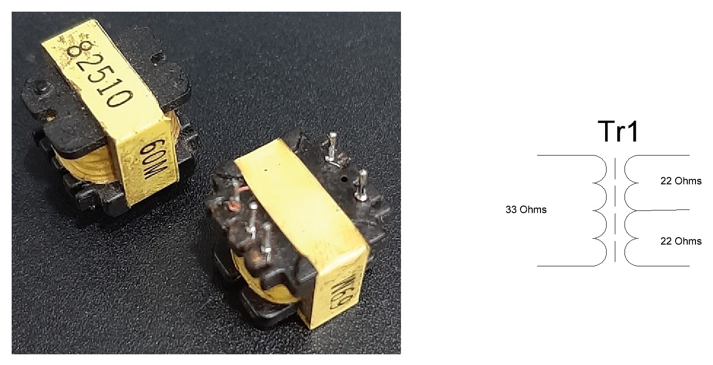

Or, the line transformer from a scrap dial-up 56K modem will work very well for general (though probably not HiFi) audio isolation - I've used those for years, until they became hard to get.
Very Nice Idea. I found this transformer from a telecom PCB board. I measured its resistance from a multimeter. Will it suits for my job?
