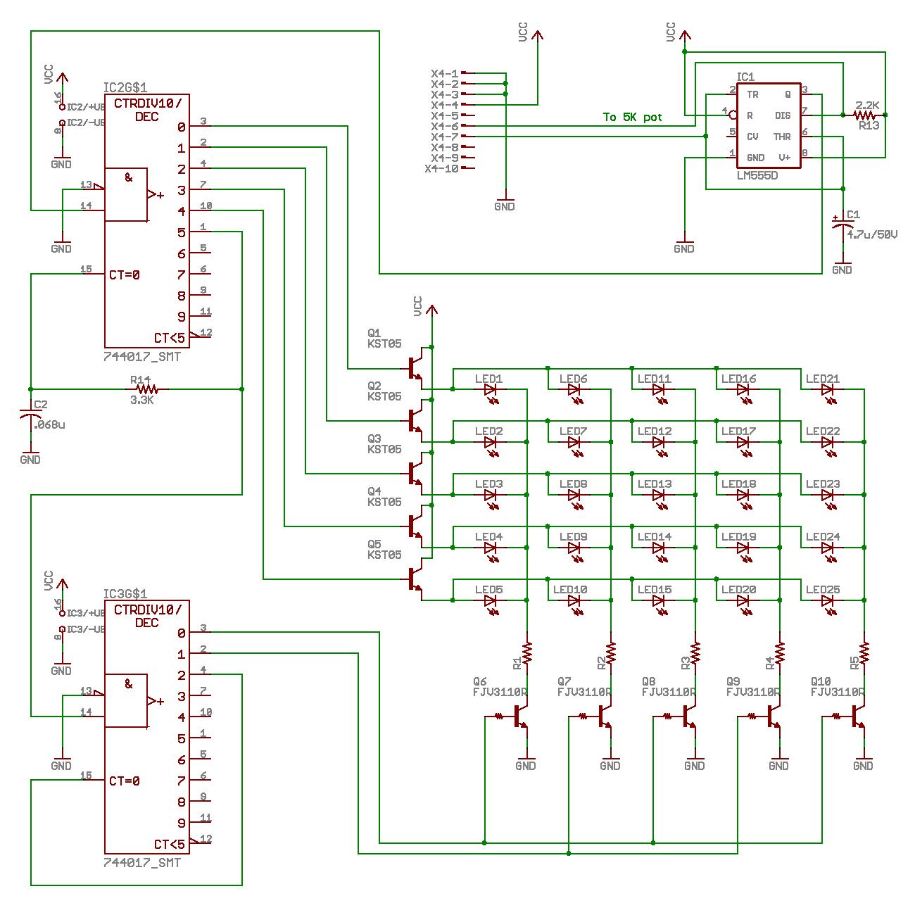

OK, so I did a little testing and found some interesting results. I hooked up my prototype circuit (schematic attached) to 8 AA batteries and measured the supply voltage. It was around 11.5 V. The circuit was working fine. To simulate the extra loading that the extra LEDs would place on the batteries I placed a 10 Ω power resistor in between supply and ground. So that should have drawn about 1.15 A (about twice what the extra LEDs will draw). When I measured the supply volatge after hooking up the power resistor it was about 8.5 V So the extra current draw dropped the supply volatge from 11.5 to 8.5 V. I figured that if the 555 and 4017s could still do thier jobs with this much of a voltage drop then the actual voltage drop (which should be smaller) from the extra LEDs should be OK. Well, it didn't work. When I hooked up the power resistor the pulsing stopped and whatever LEDs were lit at the time just flickered. So I disconnected the batteries and reconnected the prototype to my bench power supply. I then varied the voltage on my power supply to see at what voltage the circuit would stop working. From 12 - 9 volts it worked fine. Then from around 9 - 5 volts the pulsing stopped and I got that wierd flickering. Then from 5 - 2 volts it worked fine again. There was obviously some wired resonance thing going on here so I decided to try the circuit with out the .068 µF capacitor (shown as C2 in the schematic) and the circuit worked fine at all voltages. I then hooked the prototype circuit back up to the 8AAs and tested it with and without the power resistor. It worked perfectly. The 555 and 4017s still did their thing even when the supply voltage dropped from 11.5 to 8.5 and then went back up to 11.5. So it appears I will not need a voltage regulator or a capacitor to smooth out the supply voltage but what is the purpose of C2? The circuit seems to work fine without it. Could I just leave it out or should I replace it with a different value that will work between 11.5 and 8.5 V. Thanks for everyone's input so far. I'm almost there.

Look at the datasheet for the 74HC4017. Its absolute max supply voltage is only 7.0V but 6V is recommended. You have 12V or more? Don't they smoke?
Use a CD4017 instead. Its absolute max supply voltage is 18V to 22V and it might be able to supply enough current to your transistors.

I'm not sure. Where did this schematic come from?

I made the schematic on Eagle but the idea came from here:
I copied it almost exactley. The above attached schematic is just of my prototype circuit. It does not show all the extra LEDs that will be part of the final project. I can attach a schematic of my entire project if you're interested. I just thought the prototype circuit was enough for people to get the idea of what I'm trying to do. Thanks.
Please do not call an ordinary CD4017 a 74HC4017 that is very different.
Your schematic shows 744017 ICs that do not exist.
The bottom CD4017 is directly driving the bases of transistors that have their emitters grounded. Then the current from the CD4017 is too high and it might burn out.
A CD4017 can directly drive the base of a transistor without a series current-limiting resistor if its supply voltage is 7V or less.
The circuit you copied has 10k series base resistors to limit the current.

Thanks for pointing that out for me the isse with the 74HC4017. I was going to order the wrong chip. i don't know why the chips I have in my prototype circuit seem to work fine without even getting warm. I checked out the data sheet for the CD4017 and it appears that it has different pin assignments than the 74HC4017. My board is all laid out and don't want redo all that work. Do you know of an IC that has the same pinout as the 74HC4017 but can handle a 12V supply? If not I'll just put a 5V voltage regulator in the circuit. I think that would be easiest. Thanks.
I think I found it. The HCF4017M013TR is good between -.5 to 22V. It looked like the pinout was the same. Still needing some help on the capacitor question though. Anyone?
An HCF4017 is an ordinary Cmos CD4017. Its supply voltage is from 3V to 18V or 22V. It has the same pins as a 74HC4017 that is high speed Cmos with a supply voltage from 2V to 6V.
Each manufacturer has their own prefix letters for a CD4017. HCF is used by ST Micro. Motorola (now called ON Semi) uses MC14017. Philips (now called NXP) uses NTE4017.

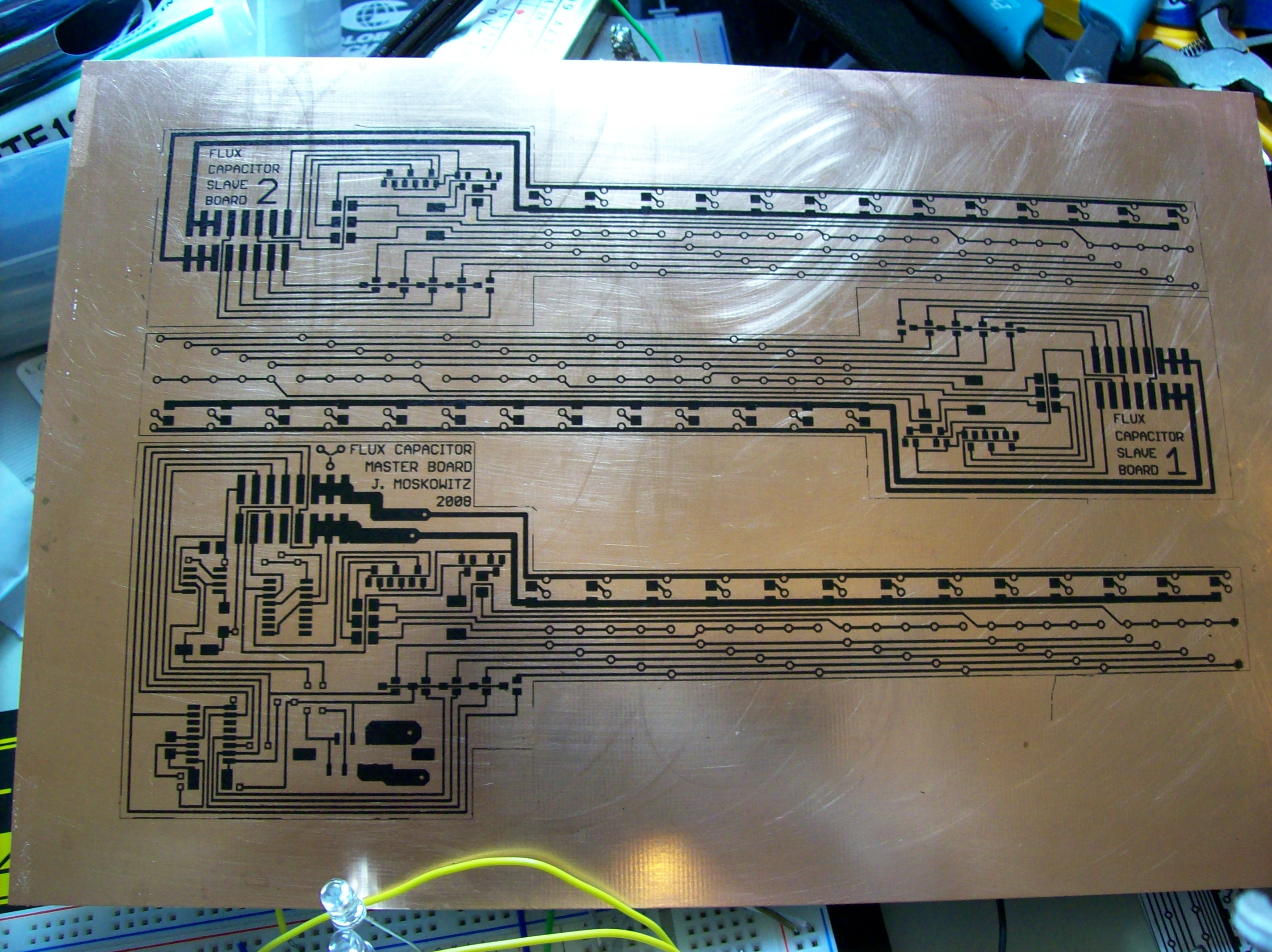

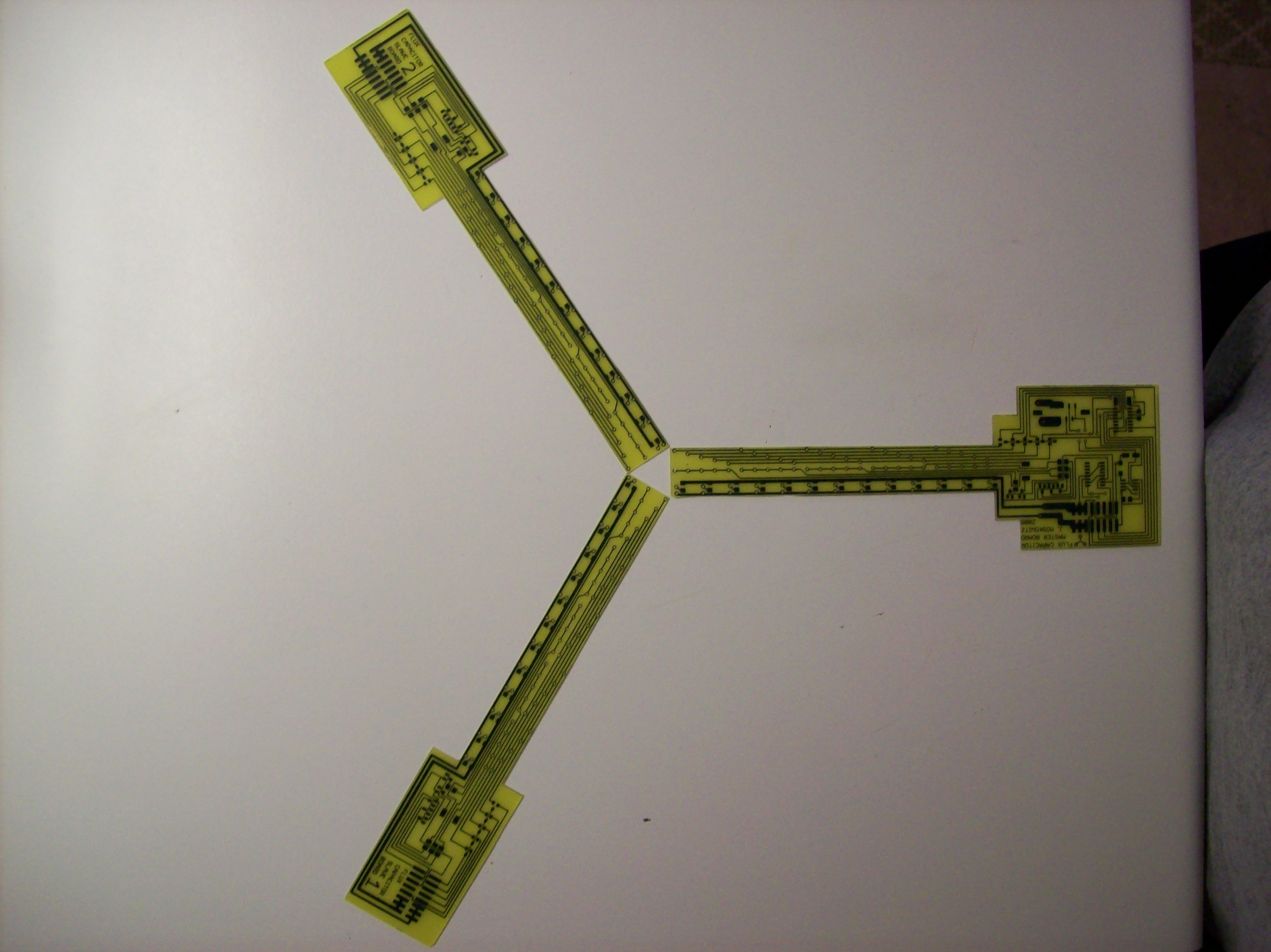

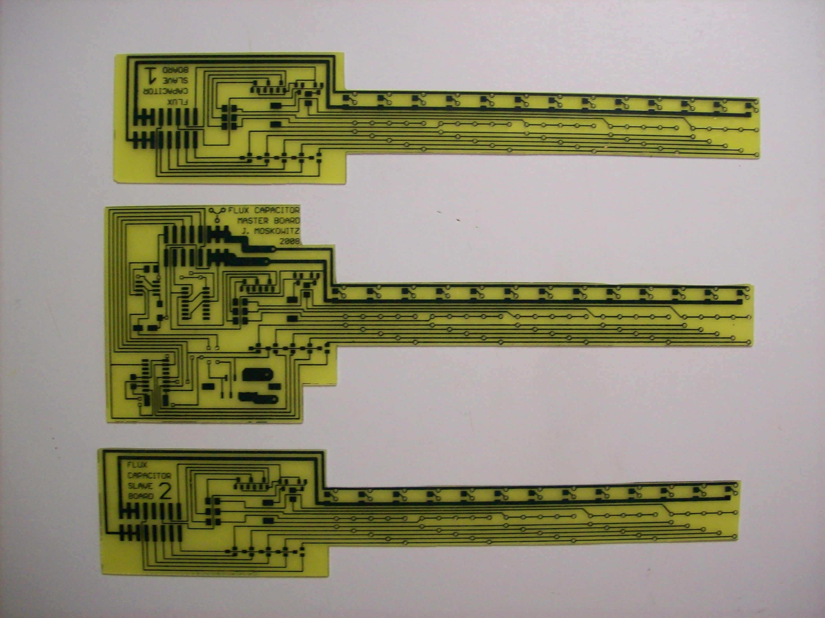

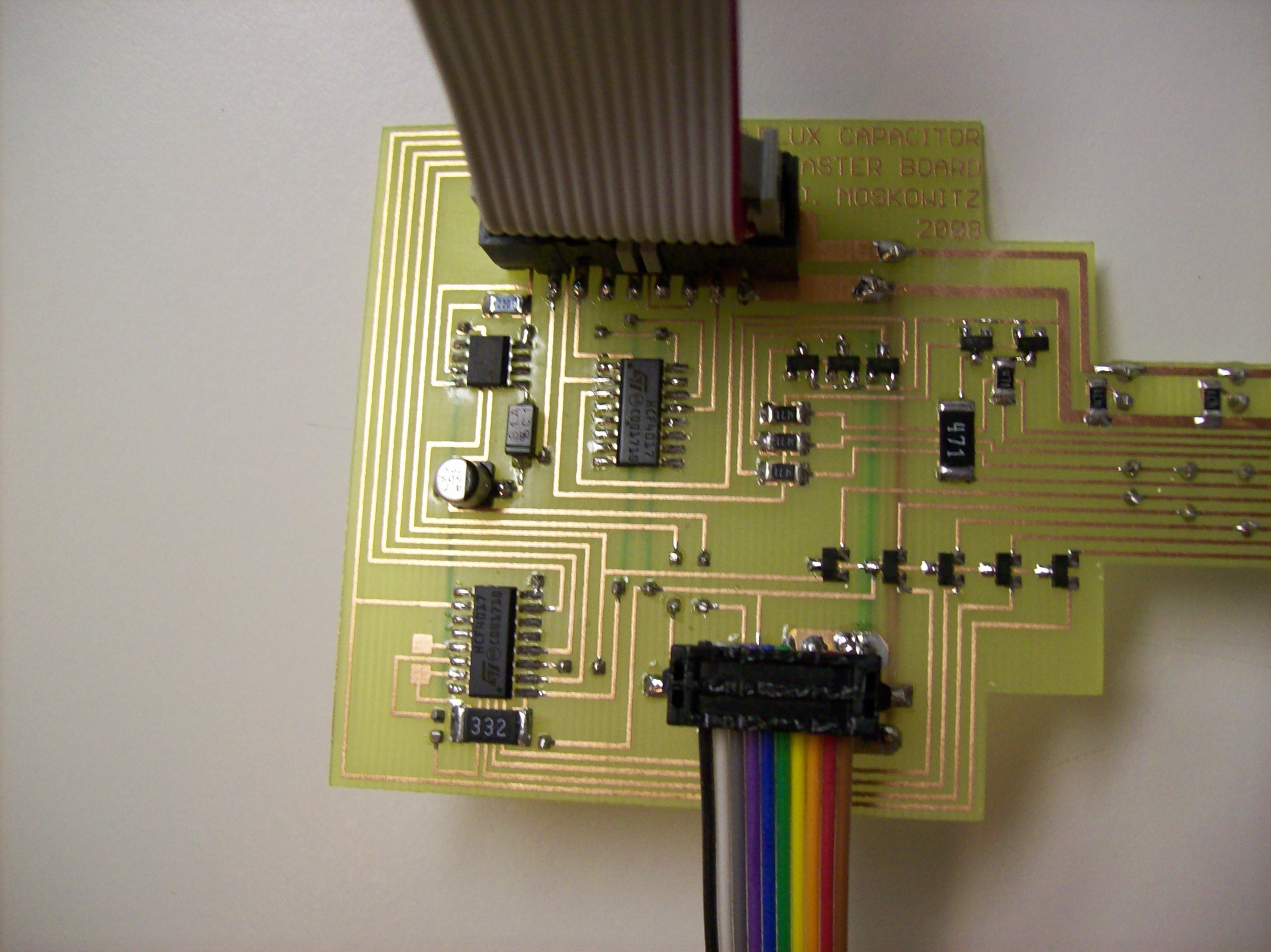

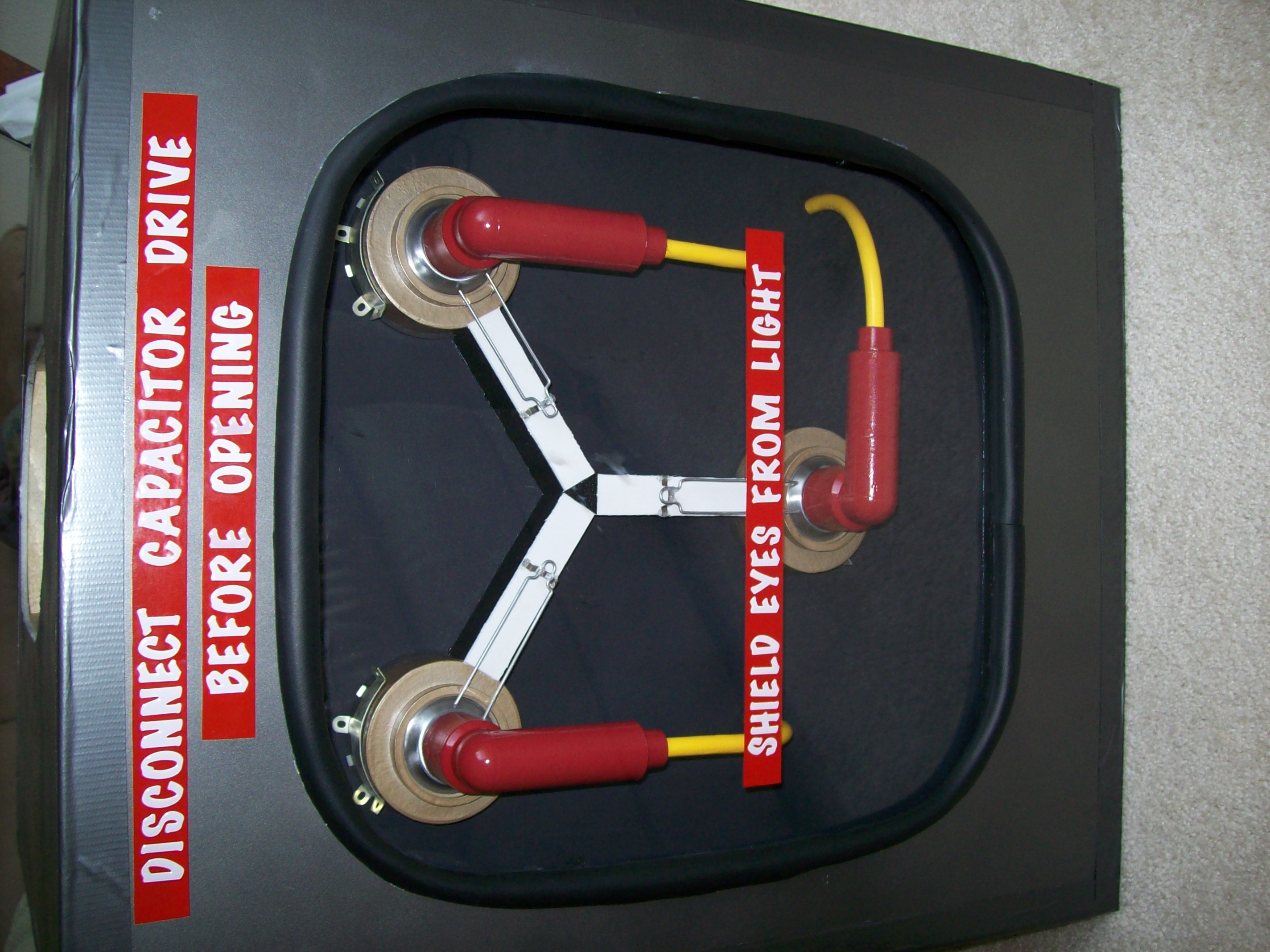

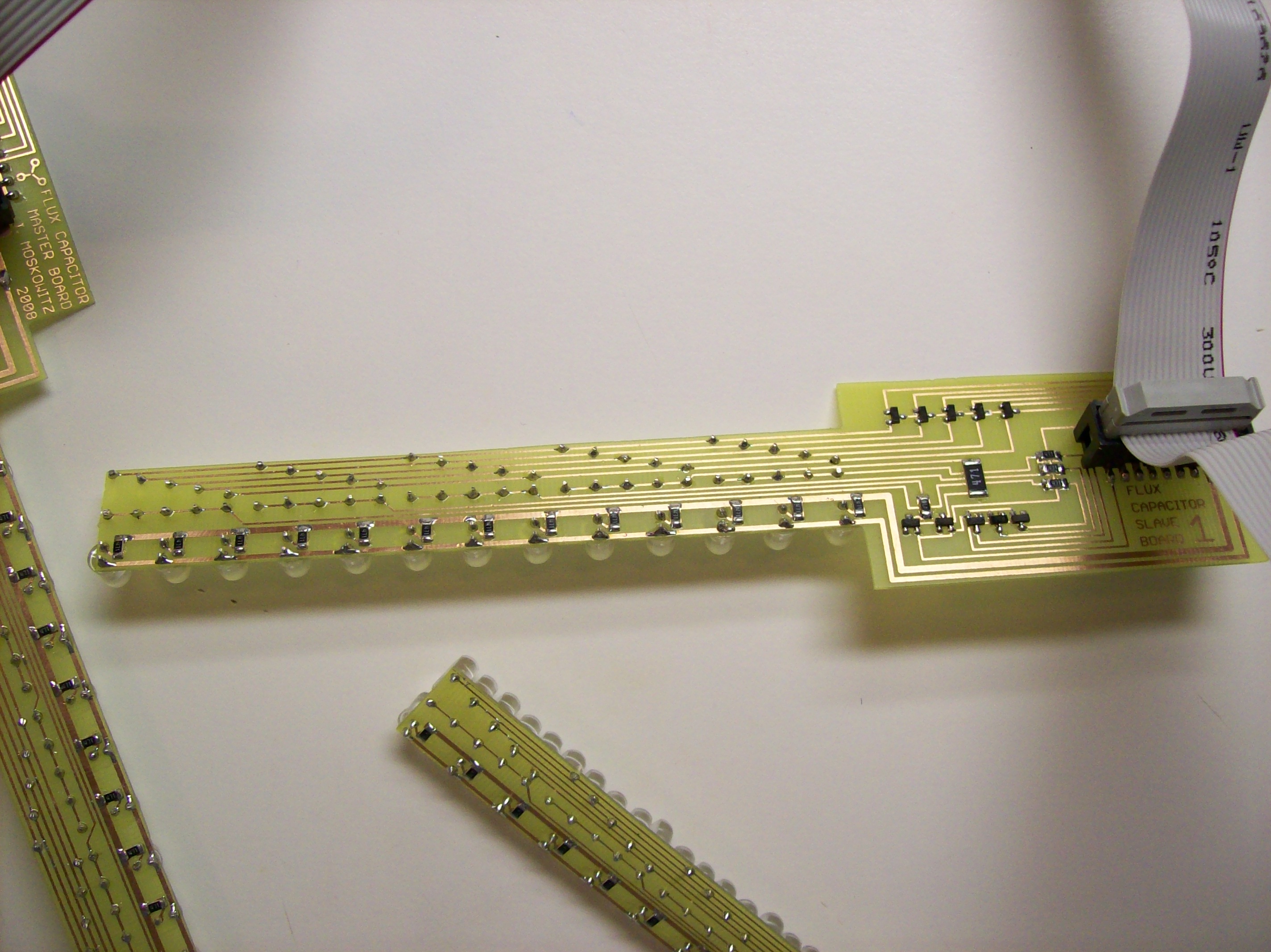

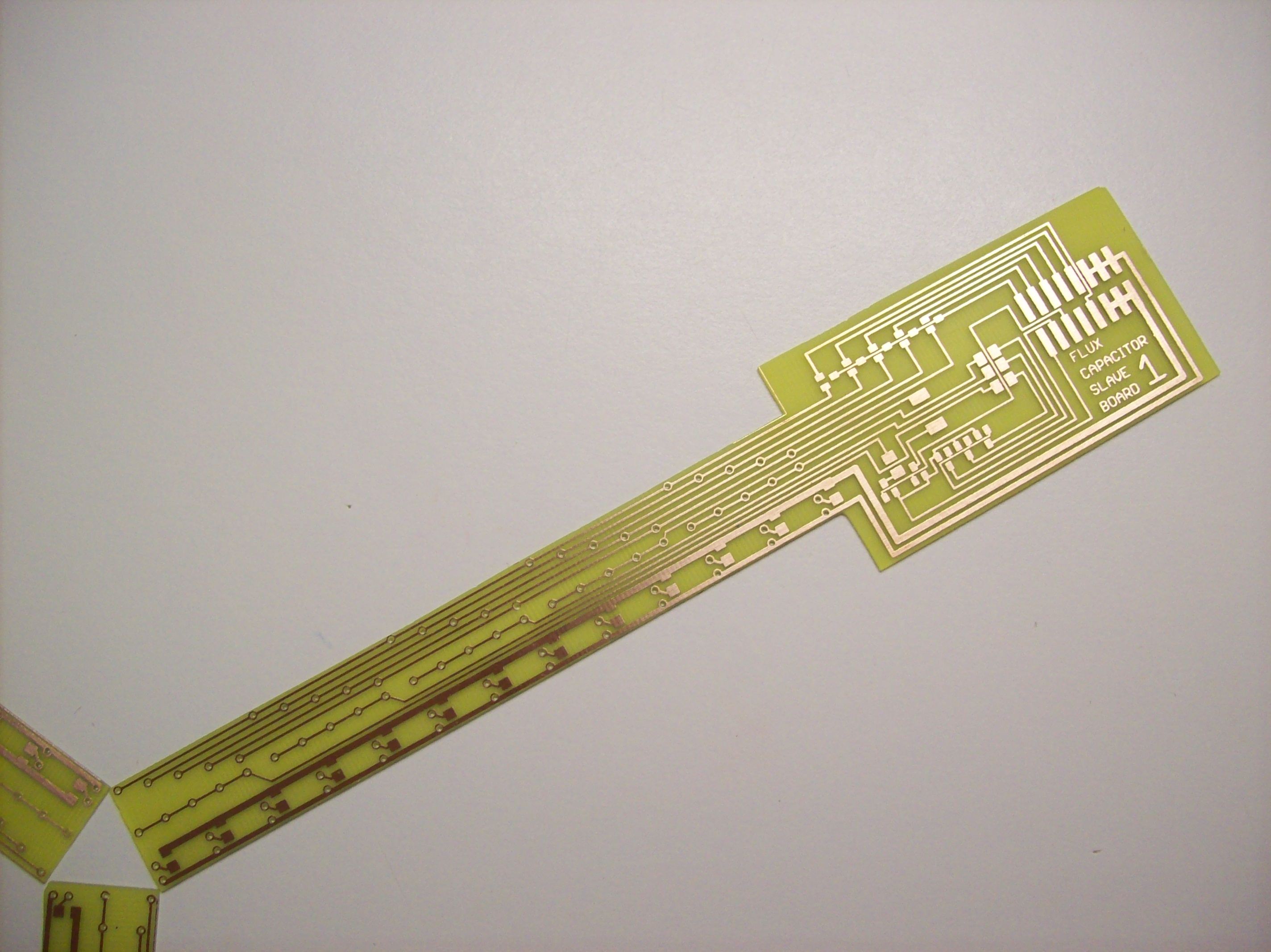

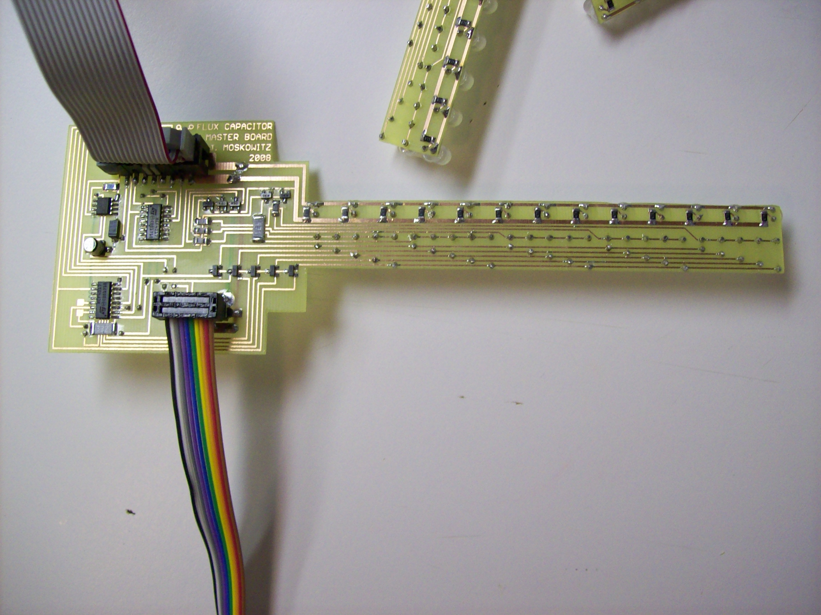

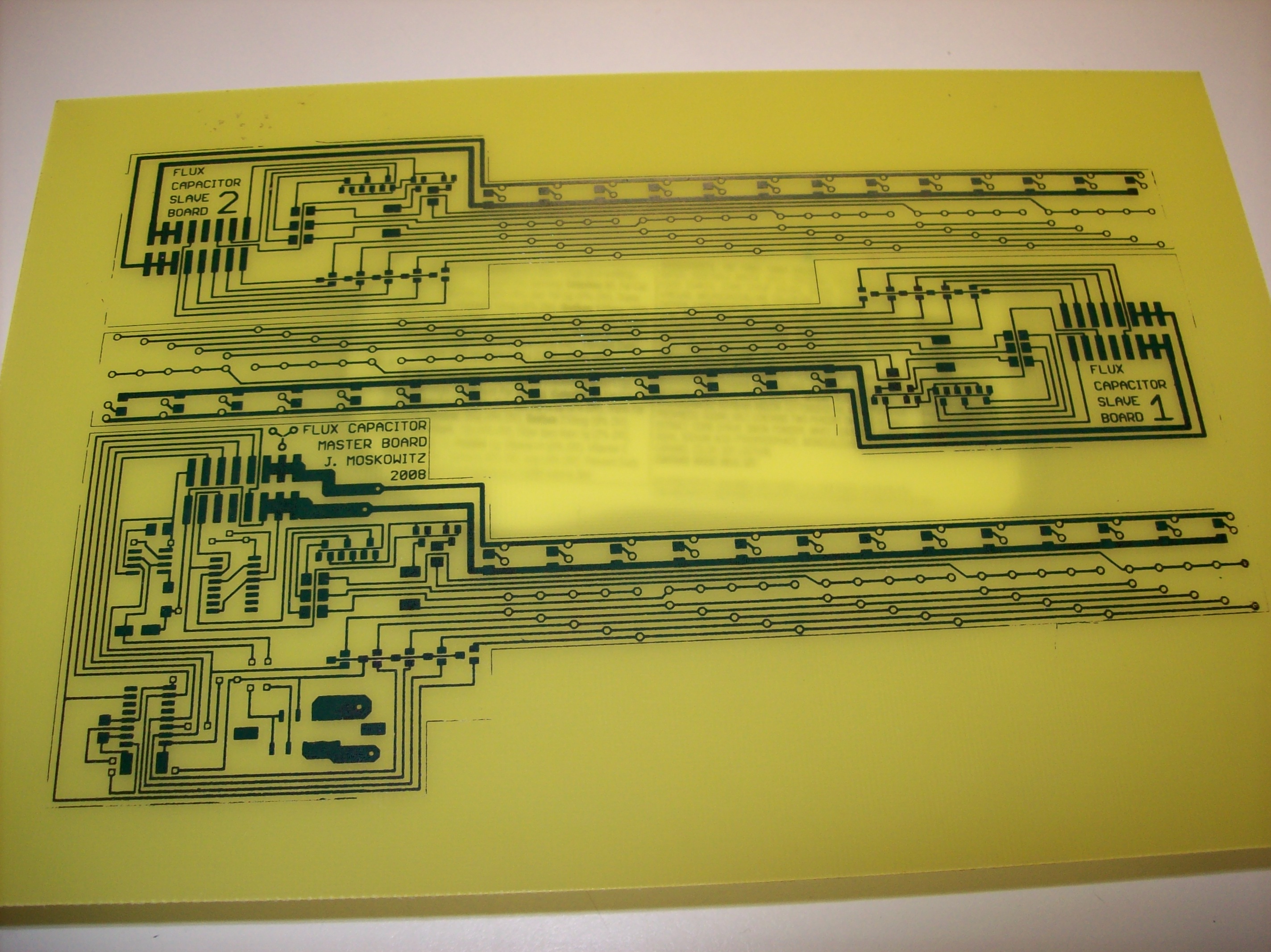

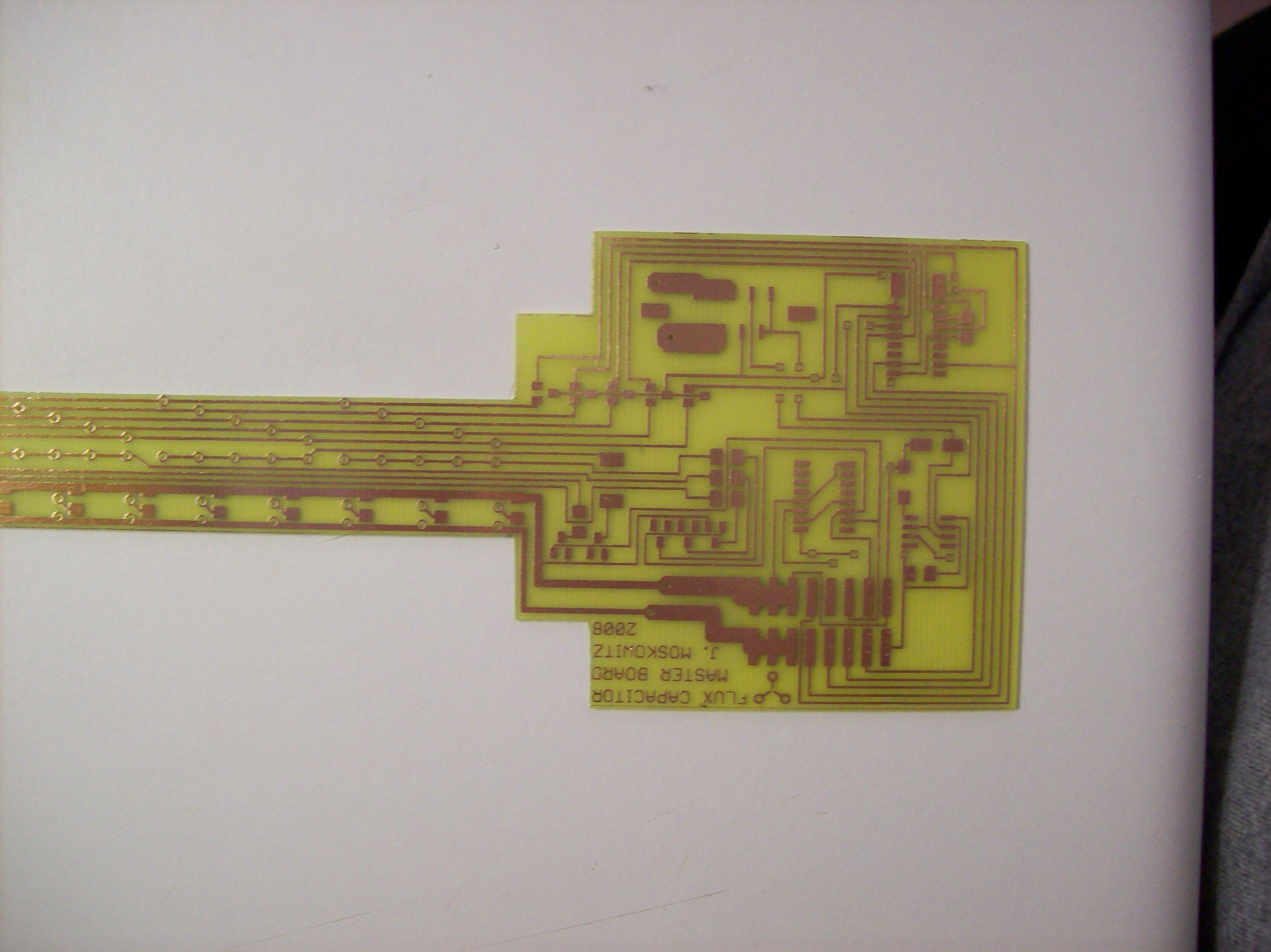

OK, so I just wanted to thank everyone again for all the help and to show off the results. The project was a Halloween costume of the flux capacitor from the movie Back to the Future. Yes, I know I'm a geek. I attached a bunch of pictures of the boards I made and below is a link to a youtube video of the project in action. Everything except the LEDs are SMT components.
YouTube - Flux Capacitor Back to the Future Halloween Costum
