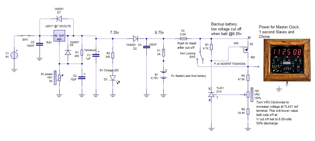

I have now built the 6volt battery backup circuit.
The batt cut off part works fine but a few problem have come to light with the charging part of the circuit.
I set the batt float voltage to 6.75volts (no battery)but when a fully charged battery is connected the voltage drops to 6.5volts.
Also with no battery connected and the circuit in lock out there is 6.75 volts across the battery but when I press the reset button (to connect the load) the voltage drops to 6.25volts with no load connected.
I thought the regulator was supposed to keep the voltage constant?
I have checked the input 12v from my test supply and this does not drop at all.

You are being fooled by the forward drop of the silicon diode. First, ignore the voltages with no battery in the circuit. The thing that matters is what the battery voltage settles to after 24 hours of continuous operation. For float charging an SLA, you should be at 2.25V per Cell, or 6.75V as measured right at the battery terminals. Each time you change the setting on the regulator, wait several hours to check the battery terminal voltage.
Hi MikeMl.
I see what you mean now. I adjusted the voltage at the battery terminations to 6.75volts presuming the volts drop at the diode would be taken into account. I did wonder why it only dropped 0.2 volts. So when I add more load to the circuit the diode drops it's full 0.6volts?
So I should add the battery in circuit and adjust the voltage to 6.75 volts and keep an eye on it and trim it down to maintain the 6.75 volts.
Thanks again for the info.
Brett.

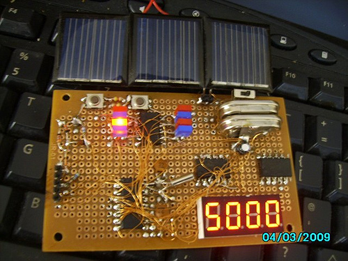

I show you one of my PIC clocks, powered by small solar cells, and 2.4 volts rechargeable battery.
it can work 24/7, the LED display is pulsed polyphase, 3 different pulsing schemes at once, and after a short moment, brightness is also dimmed.
works at 1mA average current!
it is hard to believe these small cells can power LED display 24/7 but it is true.
what I mean is, my suggestion is to pulse the display, in case power is lost, to reduce power consumption.
this could also be done with conventional CMOS logic.
maybe you do not want to use a smaller battery anyway.
Yes, just connect everything as it will be with the clock running. Let it stabilize overnight. Monitor the battery voltage, and if an adjustment is needed, make it in small increments, waiting for several hours each time, allowing the battery to seek its own level. The goal is end up with the battery being at the correct float voltage.
Be advised that the ideal float voltage for your battery depends on ambient temperature. Look at your Battery Maker's web site. They usually have an application note that shows the float voltage expressed as V per Cell (VPC) and the temperature correction vs ambient temperature.
I downloaded the pdf for my battery a while back which quotes 2.275 volts per cell or 6.825 volts. They show a very basic graph with charge and temperature but it is not realy possible to see the voltage / temp to any great accuracy. Voltage should decrease with temperature so I am presuming around 20 degrees C as the battery is indoors so have knocked it back to 6.75 volts.
