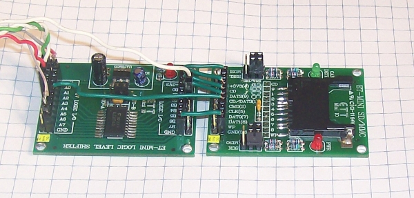

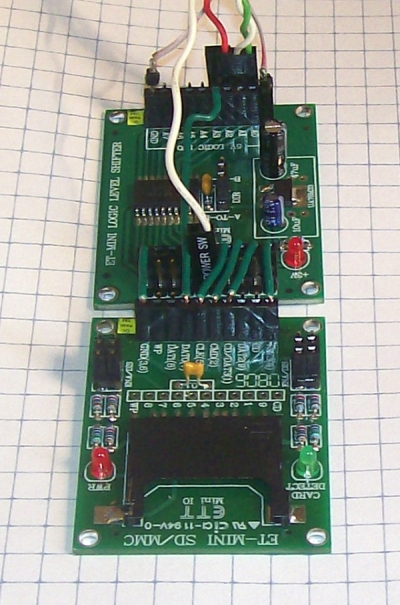

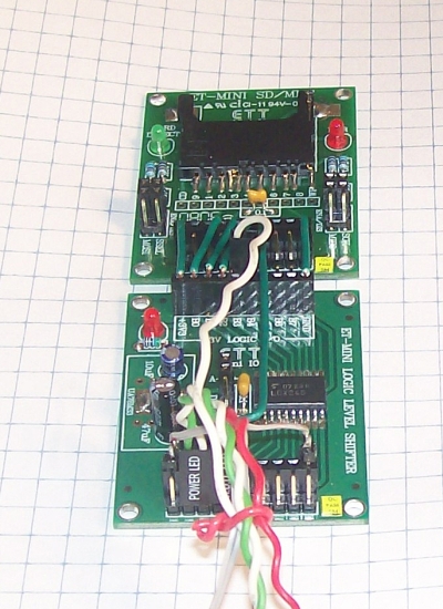

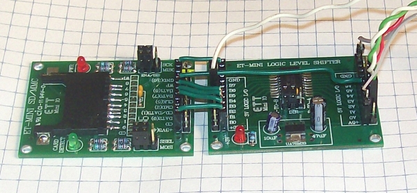

Ok i cleaned up the sd wiring and code. And will try it tonight. (Was reading the book so feel better a little) im still using the 2550 but mostly till i get a 4620. The main reason is heh i still at least need to learn spi more and how to initialize it right. Here are some pics of it cleaned up:
1-jpg.21845
2-jpg.21846
3-jpg.21847
4-jpg.21848
So far i think i got it to Initialize Without no issue.
