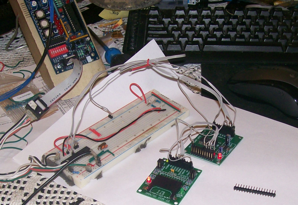

i got it lol since i wrote that actually lol. Um Here is my setup for some reason still wont initialize now.
ss_a-jpg.21680
as you can see i added a 3 color led (r/g/y)
Also changed and added:

well its Red and Green and when both on its like yellow/orange
Ah! That's a two color (bicolor) red/green LED. Gotcha.
I got it to initialize but now bad data write lol
Fun, huh? It all has to be just so or it doesn't work. I guess you don't have a copy of "Learning to Fly the PIC24"? Just about everything is pretty well explained in there.
seems to write now but stuck on read lol the issue has to be timing because i have it loop bCK ON FAIL until it passes and works
There's not much timing involved. "you will find that... SD/MMC connector, can easily sustain a clock rate as high as 8MHz." SPI is pretty fast. Basically just jiggle the clock line really quick and shift bits through the SPI shift register just as fast as it goes out/comes in. It's very reliable.
Writing 1000 sectors to flash takes quite a while. You need to be patient. Reading is a LOT faster. When my LED first turned on for writing, I thought the thing had crashed. It took forever! Then finally it blinked the success code, I halted it and looked at the buffers I had read and they were full! :D
the read data is supposed to be the same as the data1 i assume. The issue isnt writing its reading lol. I can write it out quick now. But reading sux. Ah man its 2am here time for bed i work in 10 hours.
Its weird it write and initializes ok But reading a no go?
If it writes and init's ok ten i assume wiring is ok.
You said before that writing was quick. Really? If so that probably means it's NOT writing. If you can't read, you can't confirm it anyway. But it really should take a while.
For a while there before I got things working mine made like it was writing, but when I followed it closely in the debugger I found that it actually wasn't, as the SD wasn't really initialized, though I thought it was. Watch the r variable.
EDIT: Oh, I see what your problem is! In every picture you post there's no SD card in the slot. It won't work unless there's one plugged in there. :D:D:D

lol i used the sd to take the pic lol It was there.
Oh ya, that's what you say now. :D
